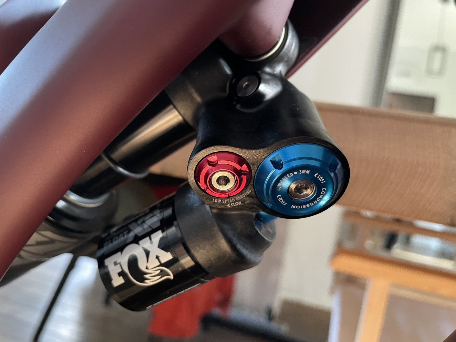

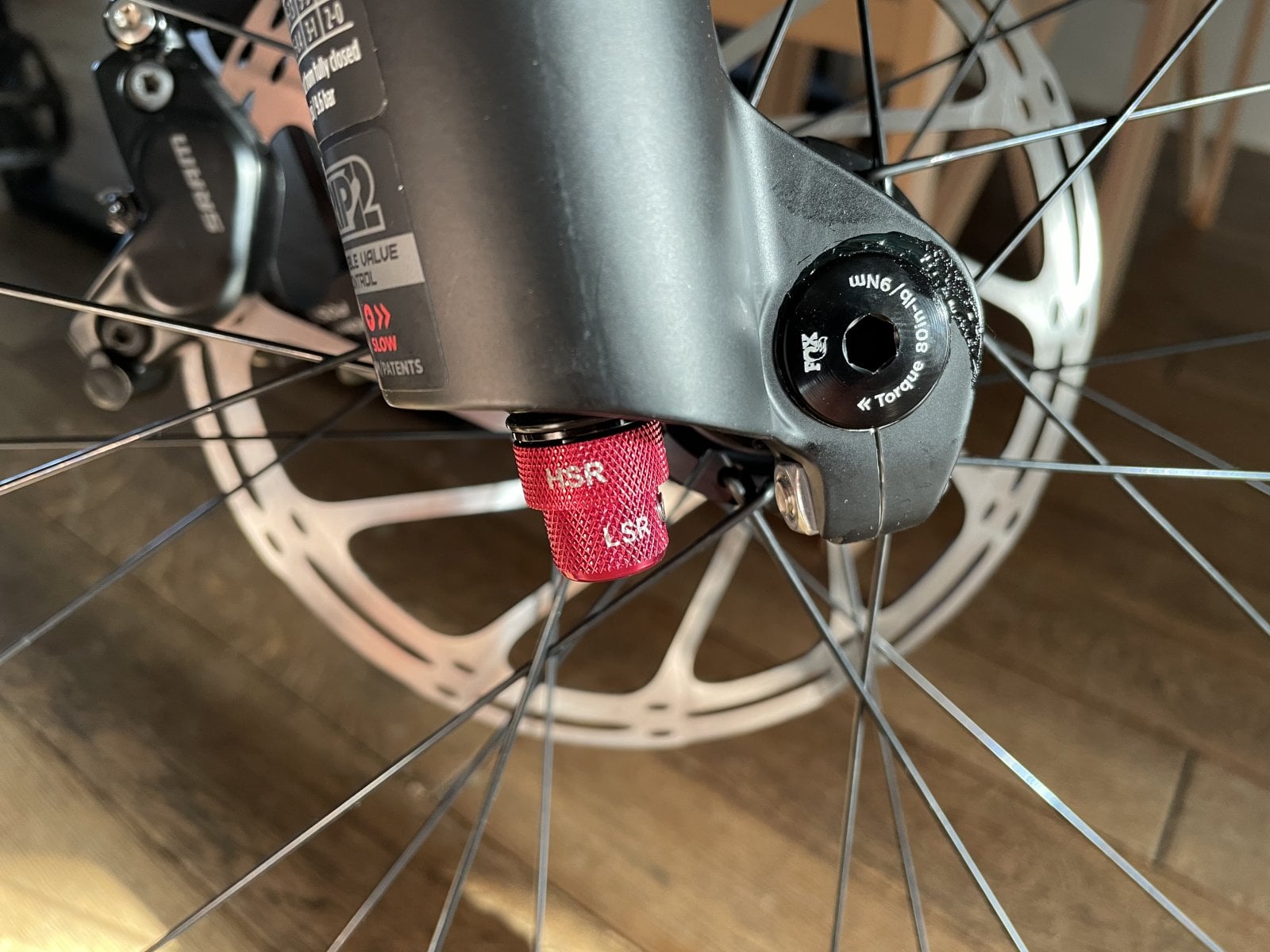

Slightly disappointed with Fox X2 shock on Expert Carbon. I thought Performance Elite line it’s literally Factory without Kashima, but it’s obviously true only for the fork - this one has all bells and whistles. The shock is missing HSR and HSC settings… Not too big of a dea, still- it’s a shame…

Slightly disappointed with Fox X2 shock on Expert Carbon. I thought Performance Elite line it’s literally Factory without Kashima, but it’s obviously true only for the fork - this one has all bells and whistle. The shock is missing HSR and HSC settings… Not too big of a dea, still- it’s a shame…
Damn! I noticed that too. I don't miss HSR but I would like HSC.
Can't trust the guy who types in specs on the website. :p
The shock is the performance not the performance elite!
Hey Specialized!!
Use a 3mm for the LSC and a 6mm for the HSC. The HSR is a dial located at the rear of the shock.
