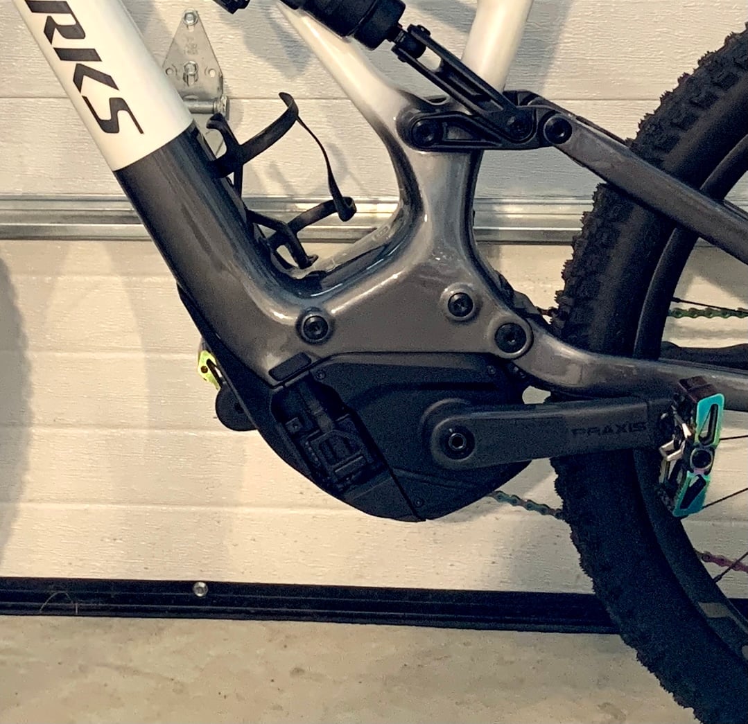

Just picked up my S3 S-Works Turbo Levo yesterday. Nice bike all around and a thrill to be on an eBike for the first time.
Haven’t put it through it’s paces but I noticed that upshifting is rough most of the time. I assume it’s a programmed momentum feature (acceleration setting?) that continues to provide power when I stop peddling.
I normally stop peddling for a brief moment on regular bikes when I up- or down-shift to negate such issues but wonder if it is expected for eBikes. I’m going to try messing with the software settings the next time I am able to ride the bike but I wanted to get input in the meantime.
P/s: Apparently Specialized forgot to include the battery charging port cap/flap with my build so I am running around without a charging port cover. Not sure what to make of it but let it be an FYI to future buyers.

Hey @Specialized Rider Care, where’s my battery recharge port cover? My bike didn’t come with it and my LBS called to place a replacement order over a week ago.
A bit of a poor show to deliver a bike incomplete esp. with a part that is supposed to protect the most delicate component of the bike.
It was probably broken by your dealer when they built your bike. It's a bad design. My dealer has ten doors on order but until there's a redesign the replacement will brake too.
Thought about that and could still very likely be the case. Gave the LBS the benefit of the doubt since the bolt receptacle(?) for the cover is pristine without signs (no threads) of attempted install. The LBS either had just lost it from the get go or broke it before it even made it onto the bike.
I can live with a bad design but would rather have a broken hinge that I can work with than my gaffer tape papier-mâché that’s attempting to keep the elements out.

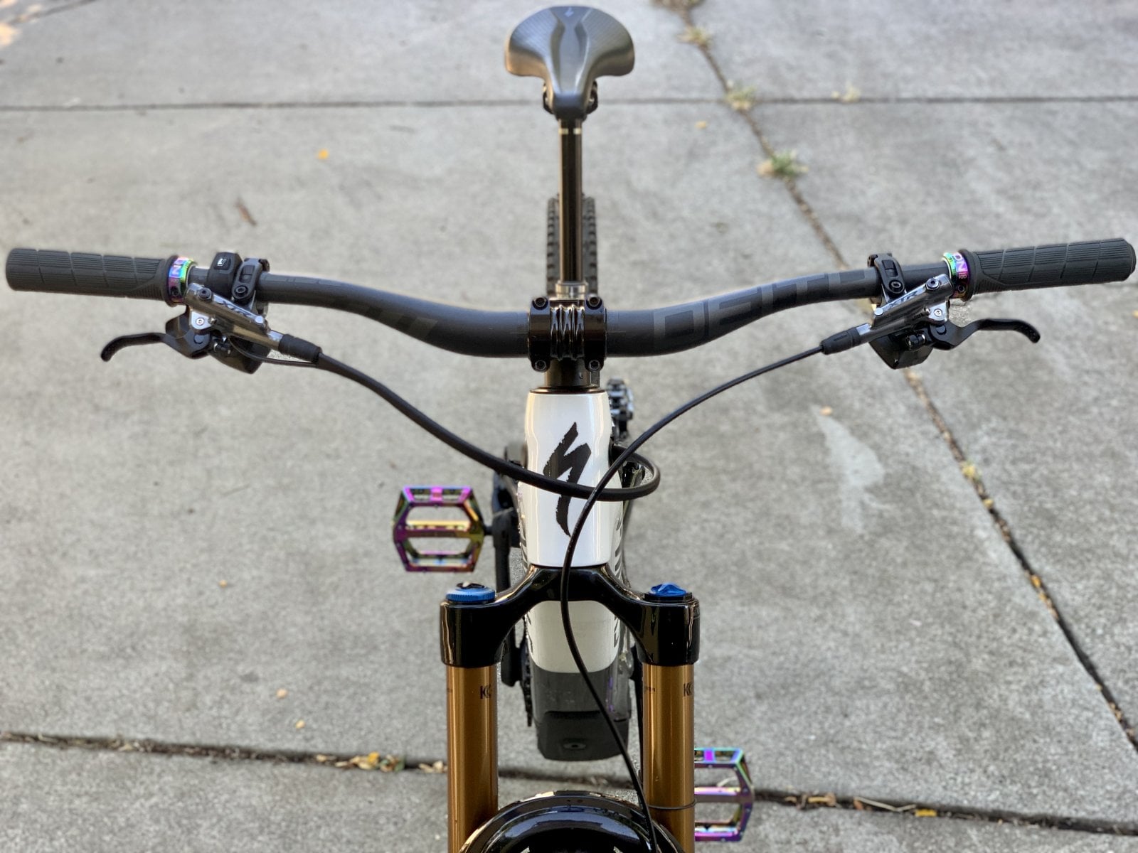

What is the clearance/fit like between the AXS paddle shifter and the Levo controller having them both on the same side btw?
Plenty of clearance with shimano xtr levers. I’m using the sram matchmaker mounts
With magura levers the axs paddle is real close to the walk assist button. Real close but doesn’t touch
i ran the same set up when i had the remote on Levo, Levo SL and Kenevo. No issues. Then I removed the remote completely and used the TCU button. If I could do it with the gen3 I would
i will eventually get a left handed water bottle cage. Right hand to control drivetrain, motor and rear brake. Left hand to grab stuff from bag or bottle cage, adjust firm on shock, etc. Better to grab rear brake in case of emergency while riding one handed….of course this set up works for mostly US riders
