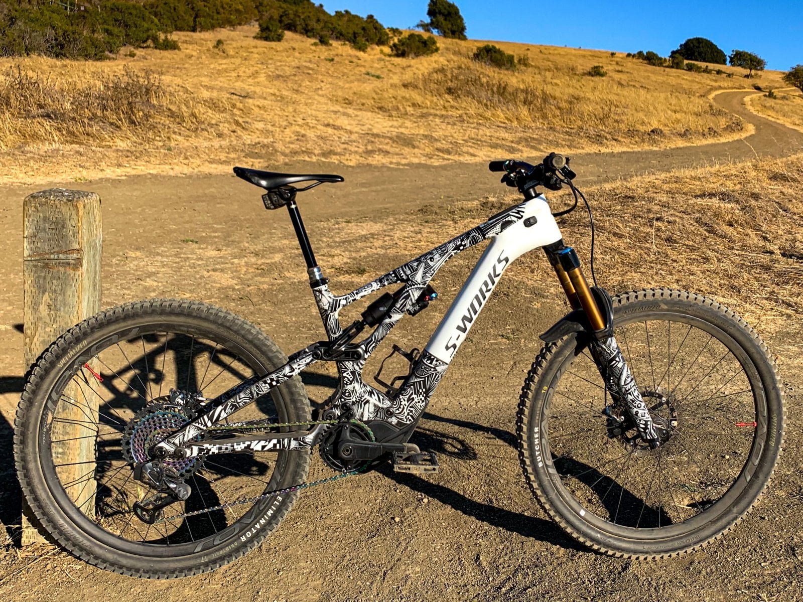

Moved my Chris King hubs from another wheelset to replace the stock roval dt’s. Levo sounds mean now. Killa ? ??
