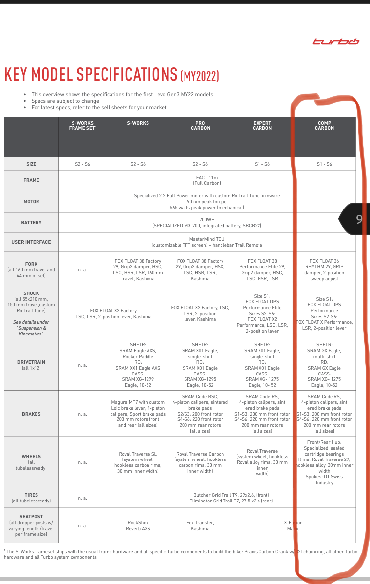

2022 Comp and Comp carbon are due for release, there is a dealer event on the 5th August in Switzerland and I viewed the pictures/specs at a dealer last week. Prices in CHF are 100 more than 21 model, colors matt black, red, blue and dark sage green, dealer commented the Oak green (I agree) was one of the nicest colors in the 21 model range and sad it wasn't continued. Can't remember the specs offhand.

Specs have been out ages.
