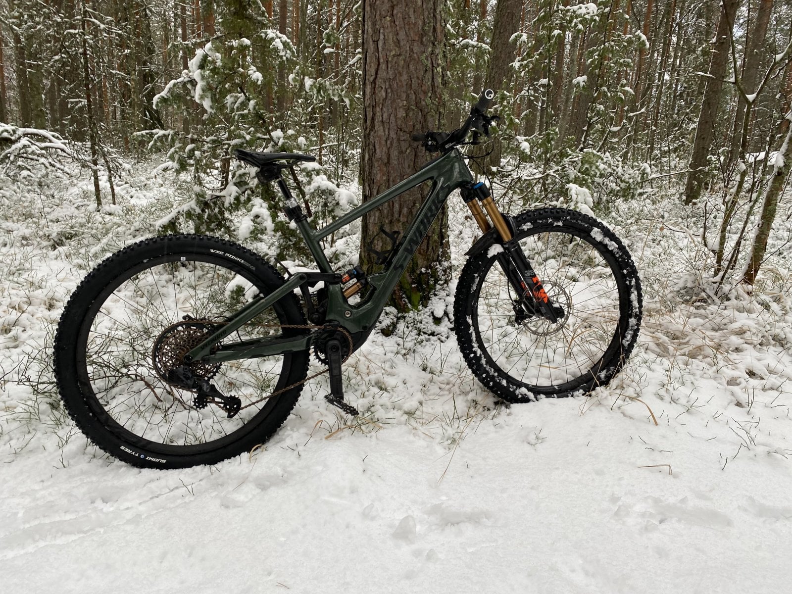

First ride in snow with KSL. It works quite well:):)

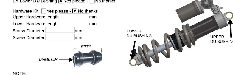

Just picked up an S5 KSL frameset and going to order up an EXT E-Storia straight away. At 6’4 230lbs the X2 shocks just don’t have enough rebound damping up near the PSI limit.
-Do I need to include DU bushings (doubt it)?
-Do I need shock hardware or can I reuse the Fox stuff?
Thanks in advance. Amped to get this built.

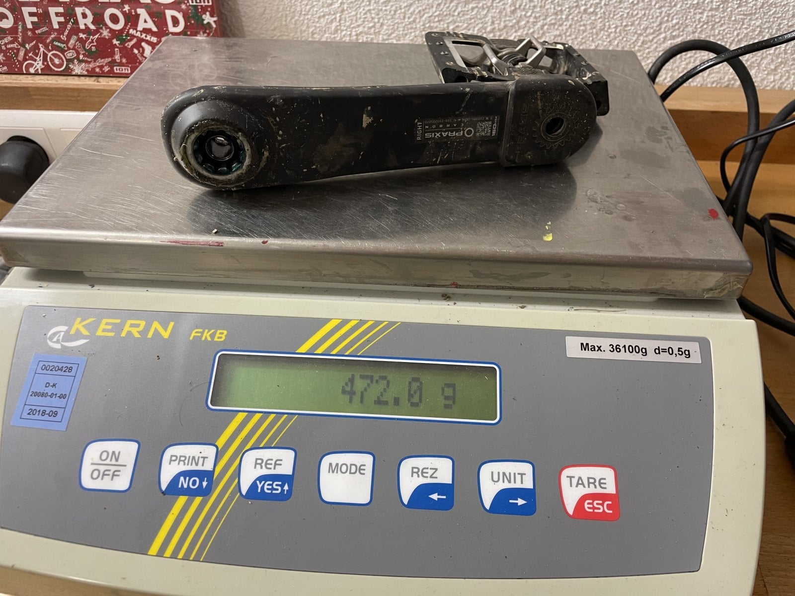

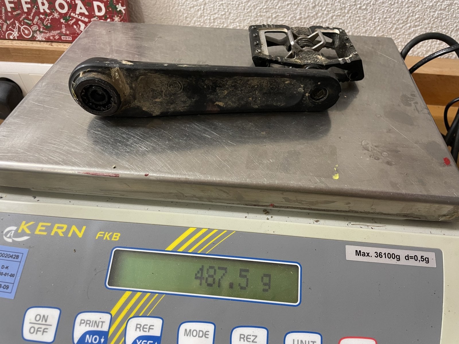

Hi !
The many threads with cracked crankarms and the actual huck-testresult drove me to swap my carbon cranks from my Levo22 SW to Alloy.
I weighed the right crankarm. 165mm Alloy from Ken22 only weights 15gr. more than the 160mm from Lev22 :oops: (if same pedals have no weight tolerances)
So for me: No chance for carbon cranks !
Best regards,
Chris
I ordered an Ext for another bike that had an X2. I did not order bushings and hardware. It was a mistake. The Fox bushings/hardware were not compatible. As much as these shocks cost, I’d order the bushings/hardware so you know it’s right. Also, I would order that new 3D printed clicker adjustment tool that is on the website. I cut down a 10mm wrench. Carrying that and an Allen wrench in your pocket sucked.
Good info thank you!
I’ve got an Arma on my enduro that came with a DU bushing in the lower mount but I had to press it out to accommodate the Enduro’s flip chip. Apparently I used the wrong type of press tool and it scarred up the shock mount. Just trying to get my ducks in a row this time.
I ordered my e-STORIA with the DU bushings and new mounting hardware. When it arrived, I removed my Fox Factory X2 and seen that it did not use any DU bushings so I just had to use my bushing tool to push them out. Also the mounting hardware sizes listed in the Specialized manual are incorrect so the new upper mounting hardware from EXT was the wrong size, I had to reuse the ones that came on my X2, it fits fine without a DU bushing in the upper eyelet. I hope this helps.
Also it's worth mentioning that the torque spec for the upper shock mounting bolt (5mm) is another thing that's incorrect in the manual, the proper torque is 12.7nm not 22.7

I passed over my fox hardware no problem. Did struggle getting lower eyelet to squeeze between the spacers. Seems like ext was fractionally wider and not rounded like the fox was. I sanded the spacers a tiny bit to get clearance.
I can confirm this. I torqued as per the manual and snapped the bolt. Specialized stood behind it an sent me an entire linkage/shock bolt package for free. I know people like to rag on Specialized, but I have had nothing but positive results when dealing with them.
Sooo helpful man, thank you!
Yeah been combing through this forum and I spotted those posts about that incorrect torque value. Yikes. Thanks for the heads up though… I’d already forgotten:).
This is SUPER helpful. So I’ll order with no DU bushings and no hardware kit and swap over the Fox stuff (with a little sandpaper massage). Thank you!

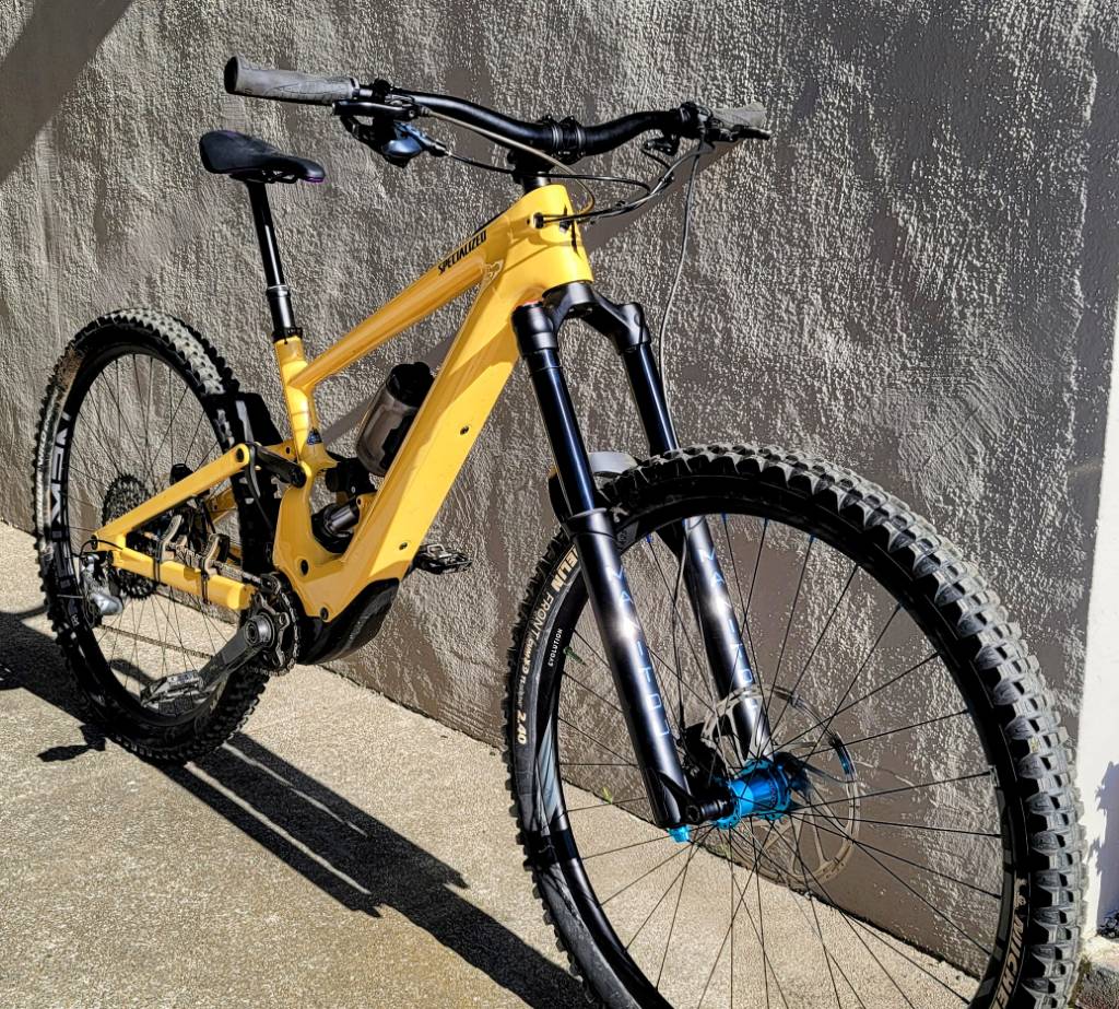

My KSL as it stands, happy to answer any questions. In retrospect I should have gone for the comp instead of expert but o well.
Changed fork and shock. I like a heavily damped ride and the fox stuff is on the extremely light side. Am much happier with the mezzer/Estoria setup for my prefferences. Springs ext sent are on soft side though so waiting on stiffer springs. 180mm from, 65mm stroke rear. Suspension ran stiff so bike rides like 150mm bike would with extra in reserve for big hits.
I like narrower (like the tire profile it gives) and compliant (160lb rider) rims so built up a set of Newmen SL XA 25mm internal with laser spokes. Running cushcore.
Also using horizon saddle which has a crazy low stack height with one up dropper which let me fit a 150mm w/ my short 28" inseam.
It's a great bike

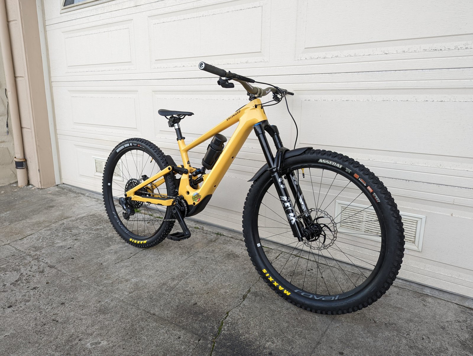

Initially wasn't too stoked on the bigbird yellow but it's slowly growing on me. Psyched on this. Changed some parts, need a 150 axs dropper, 170 just a tad long for a 30in inseam in an S3.
Question: Has anyone fitted a Kitsuma coil in an S3 or smaller frame? From the looks of the Kitsuma shock seems like its piggyback rez is longer than a Float X2 so I'm pretty doubtful itll fit. Just wanted to know if anyone's tried this shock in their ksl. Cheers.
