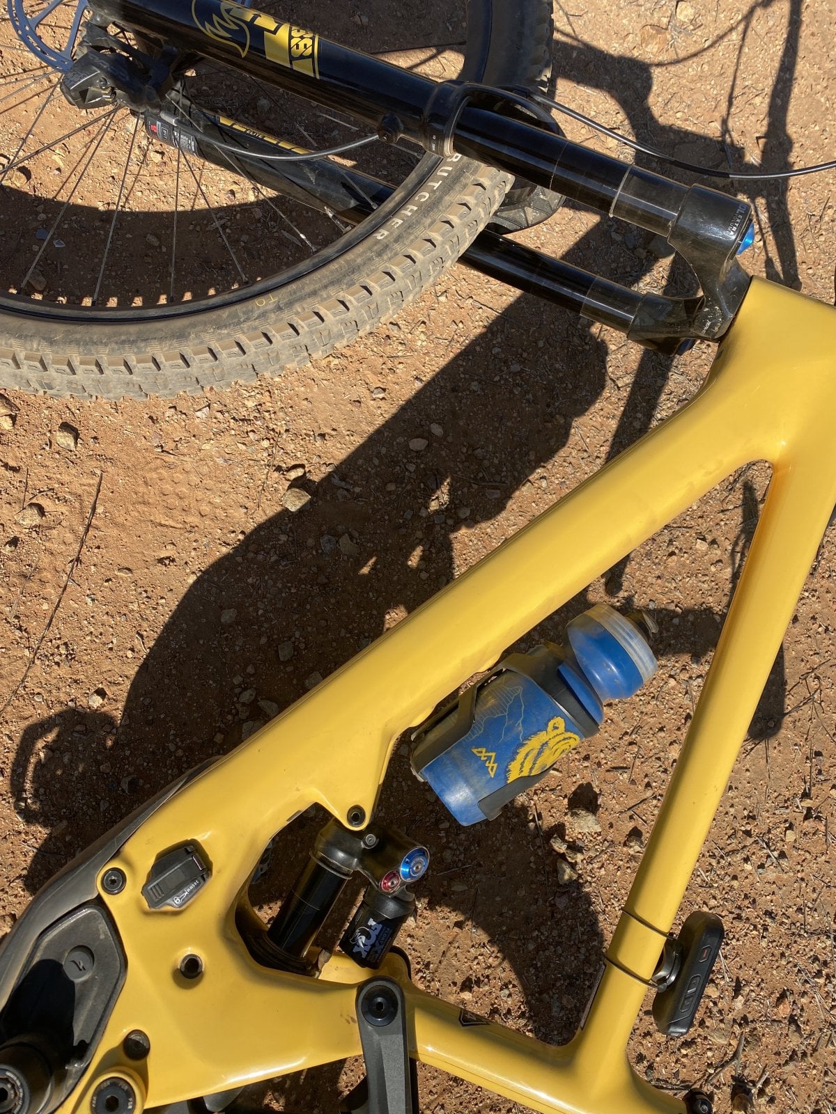

Anyone fitted a DVO Jade X to a KenSL?
Just so we're clear, the correct answer is not "just fit a 150 OneUp post"... :ROFLMAO:
Yes...FYI it's for sale as I have another shock

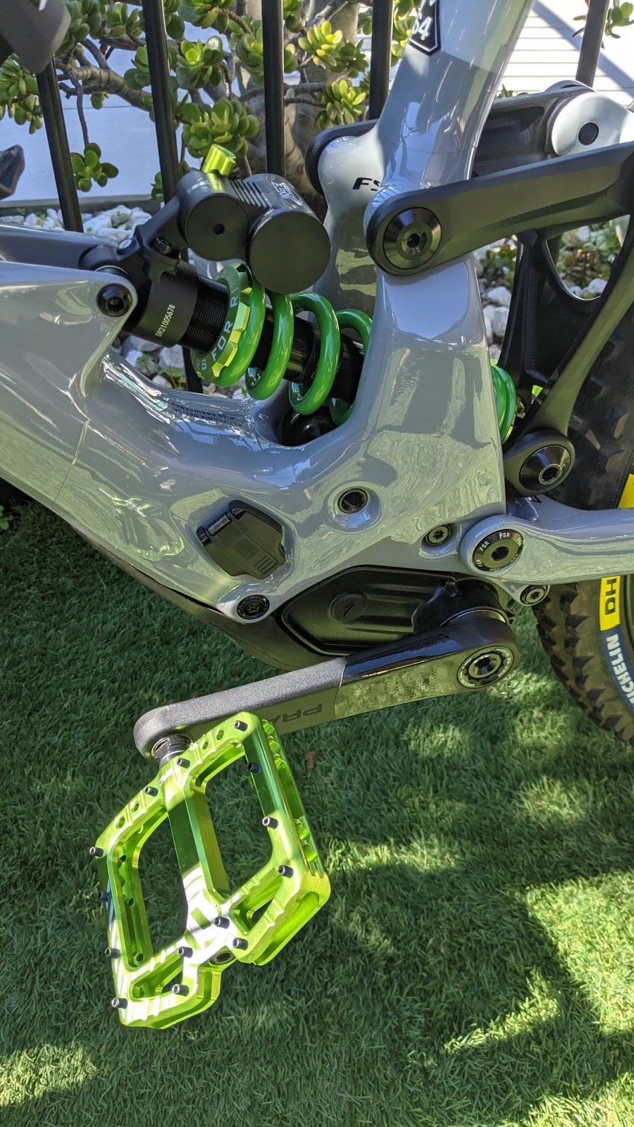

So, as the dhx2 won't fit our KSLs.. Anyone tried the Öhlins TTX(22M) Coil @230x65?

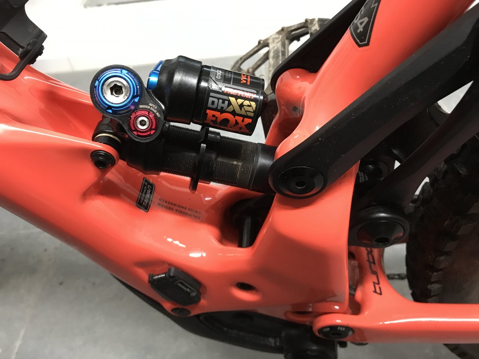

I can‘t confirm this. Just tried my DHX2 MY2021 on my S4 frame without the spring. No interferences. Everything seems to work just fine. It’s a 230x65 shock. I hope it‘ll work with the spring as well. Reaching HSR knob will be PITA, though.
Picture at full compression.
