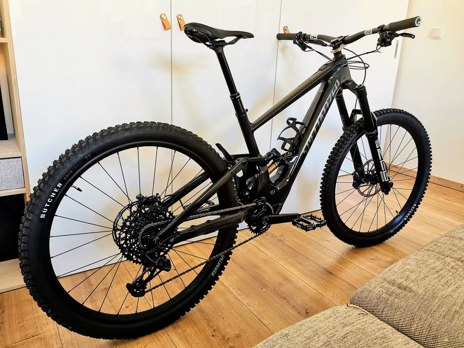

Ugly potato photo for now, but very happy with how it's starting to look so wanted to share :- ). I've been sick with bronchial inflammation for 5 weeks though, finally getting better, so zero riding, just staring at it.
KSL Comp. Added 2022 X2 Factory and Zeb Ultimate. Deity T-Mac pedals, and my old Enve DH bar/Renthal Duo cockpit. Tomorrow comes SQ-Lab Infinergy 60X saddle and will add my E13 wheelset, just need to decide on winter tyre combo. Probably keeping the T9 Butcher for back with CushCore Pro, and if that ends up being still bit weak, then swapping to dual-ply plus Cush but want to try the weight saving first.

Nice bike. My advice is to keep the front tyre Butcher T9. It's really good and well dampened.
T9 at the rear is too draggy.
I have few scenarios, it's all mainly for Winter which is very slippery and leafy (and the snowy) here, and I also bring my kid on or have my Siberian Husky leashed in front, so maximum traction is ok with me, it's e-bike :- ). For Spring I would get rid of soft rear tyre if it ends up feeling too much.
1) Butcher T9 front & Back, Trail Casing. CushCore Pro in back, CushCore XC in front.
2) My usual Dual-Ply E13 TRS LG, Soft in back, and SuperSoft in front. That + CushCore gets bit heavy... but once I tried CushCore recently, I can't live without. I just can't decide if I still need dual-ply which I really like alone.
3) T9 or E13 in back, but actual mid Spike in front like Hillbilly. I never tried that type of tyre, which seems one notch above Magic Mary so I don't know what those drawbacks look like in reality when the tire squirms..
If I had lighter carbon wheelset, number 2 would be great, but I gave it away to my wife for her LevoSL, to bring that one down to super-light territory :- ).

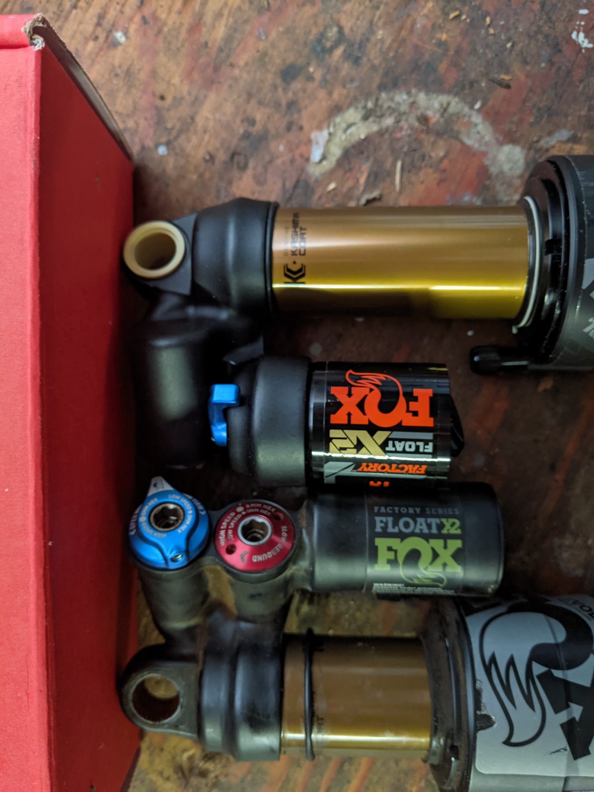

Here's the size difference between the he 2022 X2 vs older. Reservoir is certainly smaller on the 22 model. I'm gonna try fitting the 230x65 X2 to see if it fits with the smaller reservoir. If not I'll get the stroke shimmed to 62.5

Sounds crazy to put a 241 shock in this high engineered bike......or other words, it simply makes absolut no sense, even when if really fits into. The result would be horrific and your hope that 6 possible Geosettings will fix it will not work.
And the shock on top of your Pic is not MJ 2023, it's 2021 or max 2022.
And the bottom shock is 2020 or older.
Cheers:cool:
Cheers:cool:
Had a few typos in my original post. It's a 230mm x 65 2022 X2.
