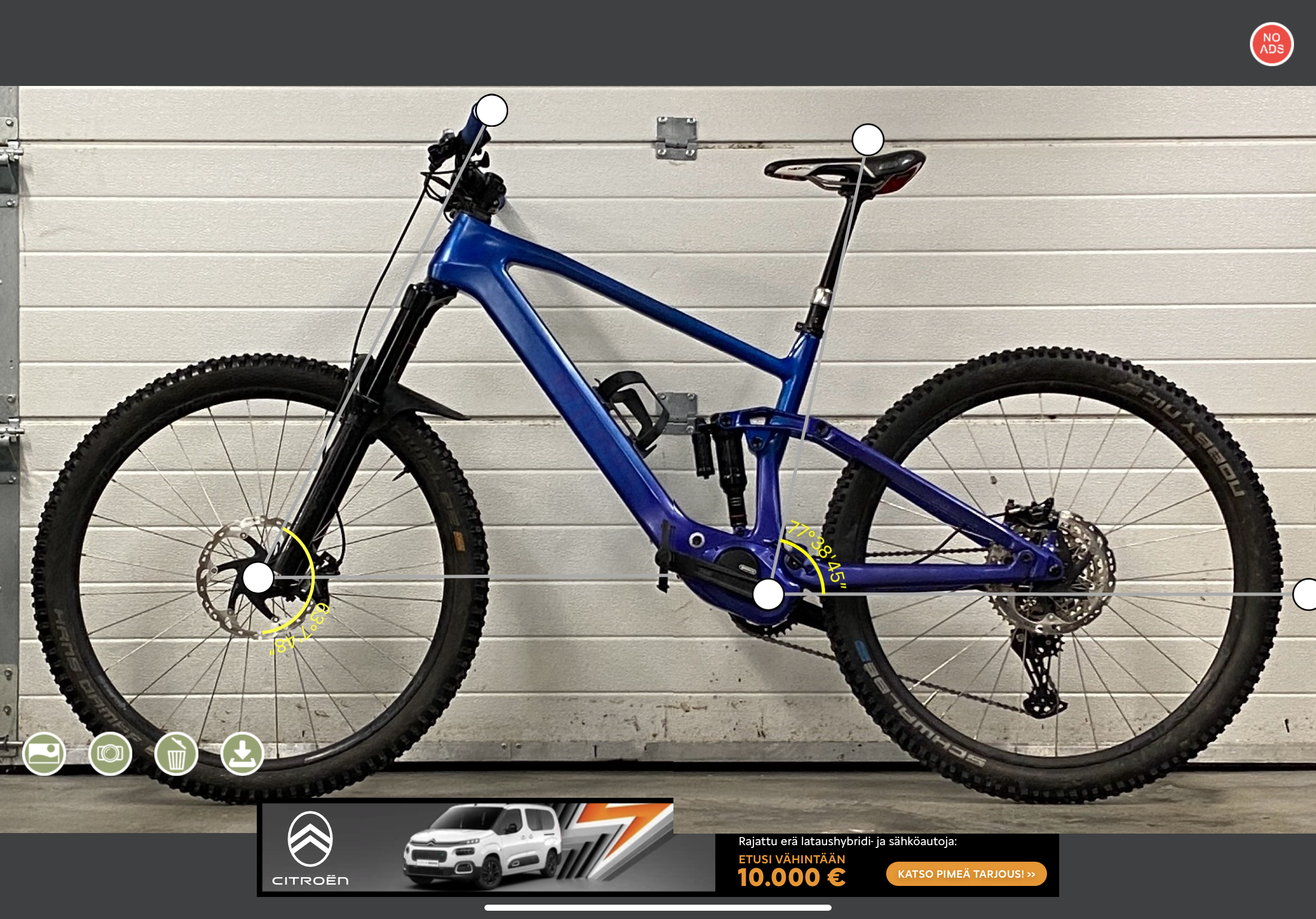

Not the CEF50, but the LCE930, so similar in many ways. Roughly 0,5-1 degree less headangle is what you get when converting any full 29" to mullet.
First one is 29"
Second is same bike as mullet, 2,8"X27.5" rear tire
After riding both I like the full 29" more, at least on trails, mostly because of the steeper seattube angle.
First one is 29"

63.2° with 2.8 rear, imagine if you use 2.4 or 2.5. On the CEF50 with 150 front travel, 210x51 rear shock and 2 x 2.9 (2.4), i mesure 63.5° and 1.3 M of wheelbase on my XL. i would prefer 27.5 rear (more light and strong), but i want not less than 63.5 and more than 1.3M. That means 29 rear mandatory for me.
My thoughts would be, I want mullet, but think it mabe too SLACK< the bike is made for 29er front and rear, I am thinking this would be the sweet spot in the HA geo of 64.5, I don't want it too FLOPPY as I turn the bars into the bend...

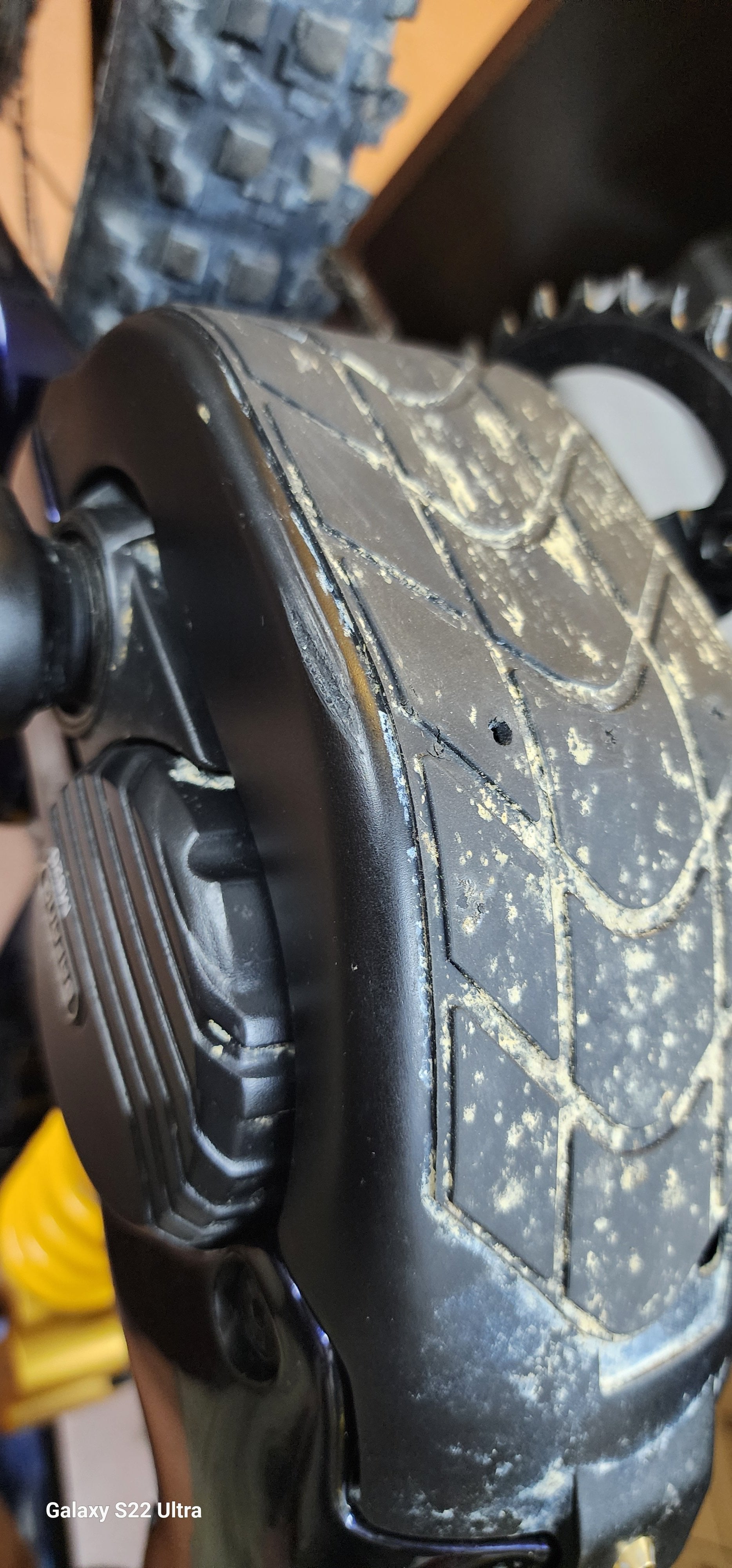

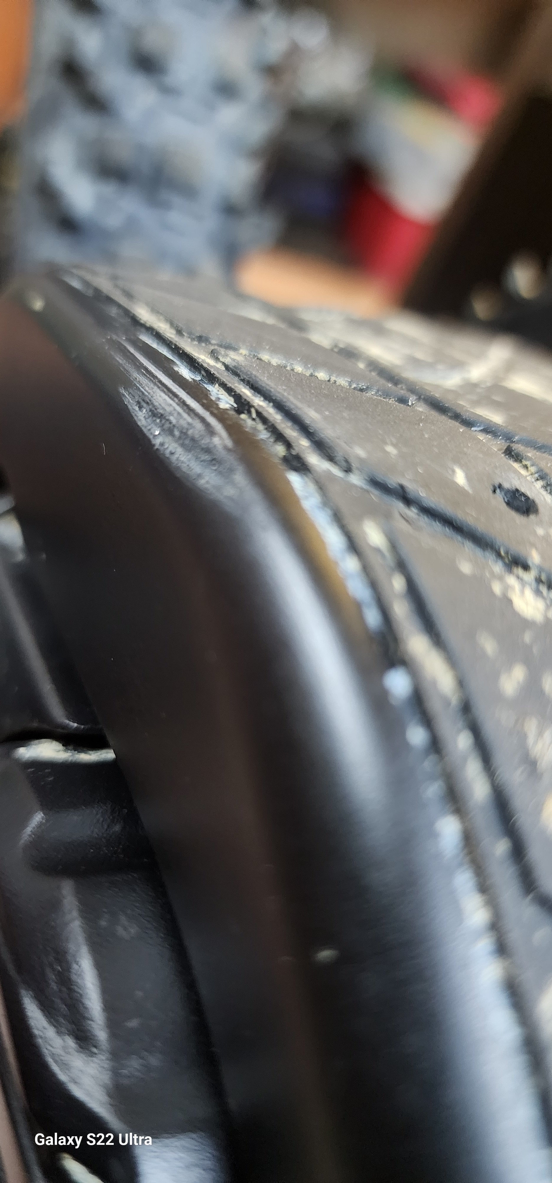

44OS for me. 51 was a little steep for a few reportedly.
I am very comfortable with my current 44mm setup so i think i better not take the risk to 51mm...
My V2 motor cover survive impact as some are asking for it quality. I am not sure how i got it.
