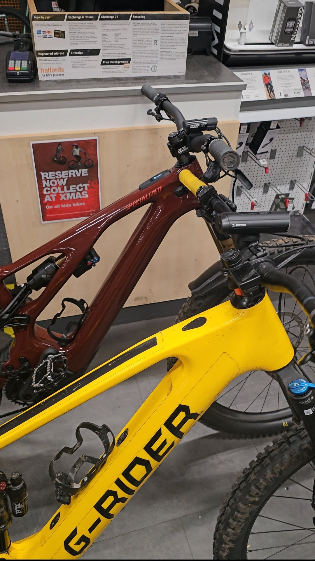

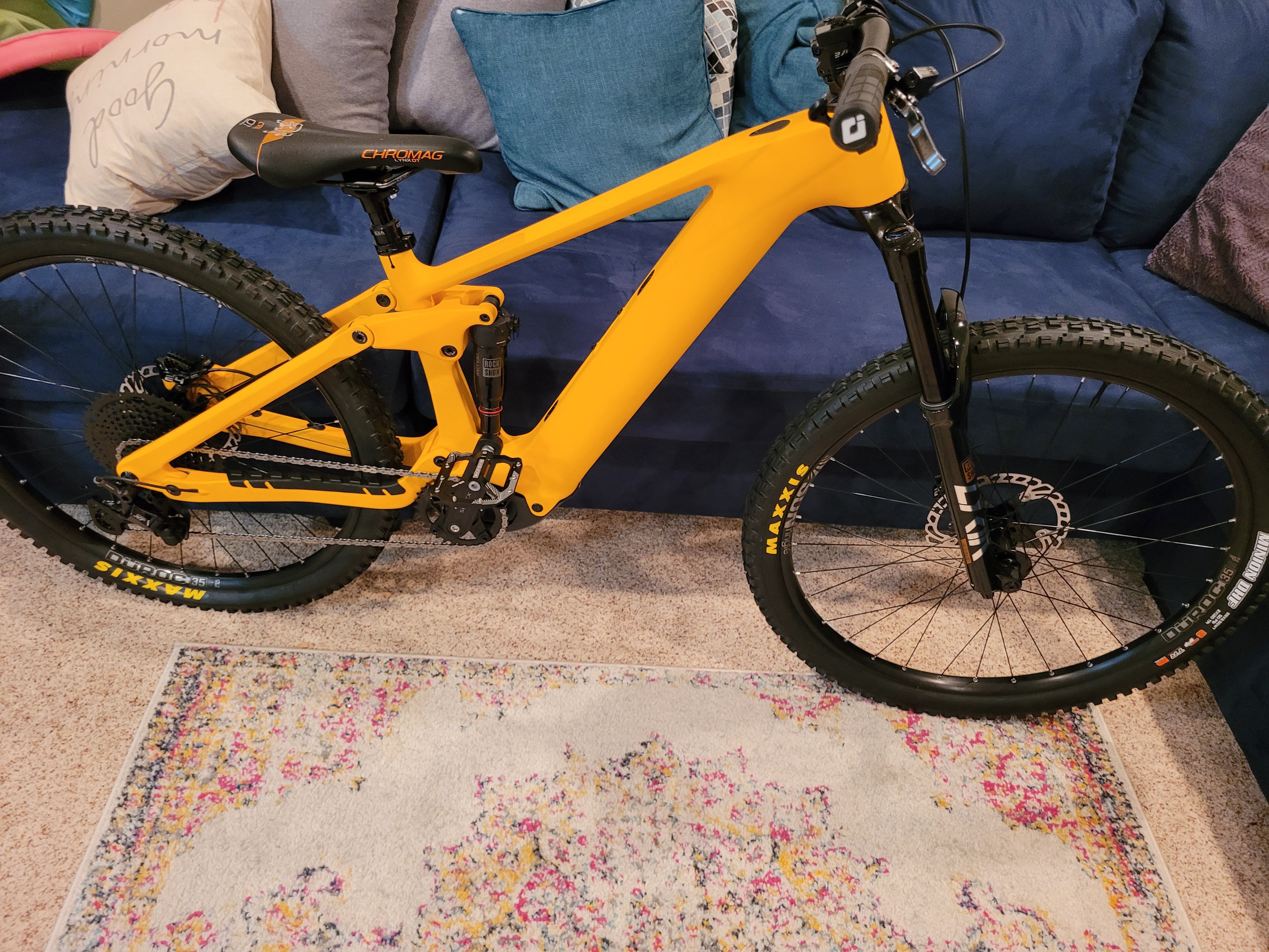

Can anyone with a piggyback shock flip the shock around to see if you can fit the shock upside down? Id like some more room for a water bottle and curious if this would fit.
temon10
Feb 8, 2022
677
570
Malang, Indonesia
no U can't flip upside down. I have small frame with Fox DPX2 piggyback only can use small water bottle (around 500mL)

This will lower the bottle cage

Yours its a v2 why u need to worry about the piggy bag? Its a coil shock competible frame.
I know the piggyback wont hit when it is on top. Im asking regarding if its upside down. I have yet to see anyone on a v1 or v2 run it upside down. This would give more bottle clearance

This is temon10's picture. Look at how close the piggyback is to the water bottle. On a v2 there is more clearance from the seattube for a coil. I am wondering if you flip the shock, now you have much more bottle clearance.

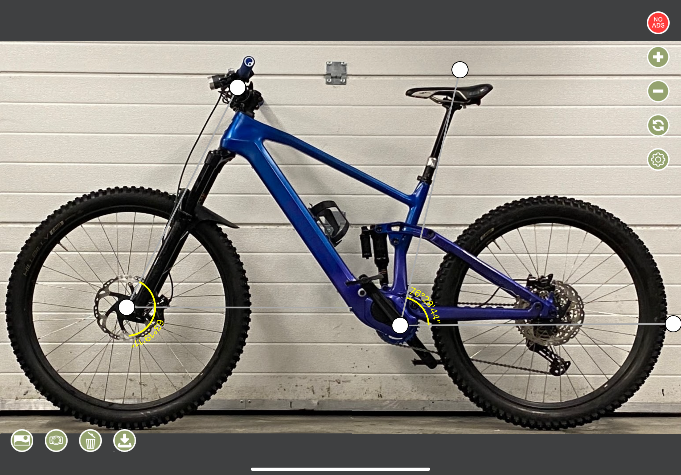

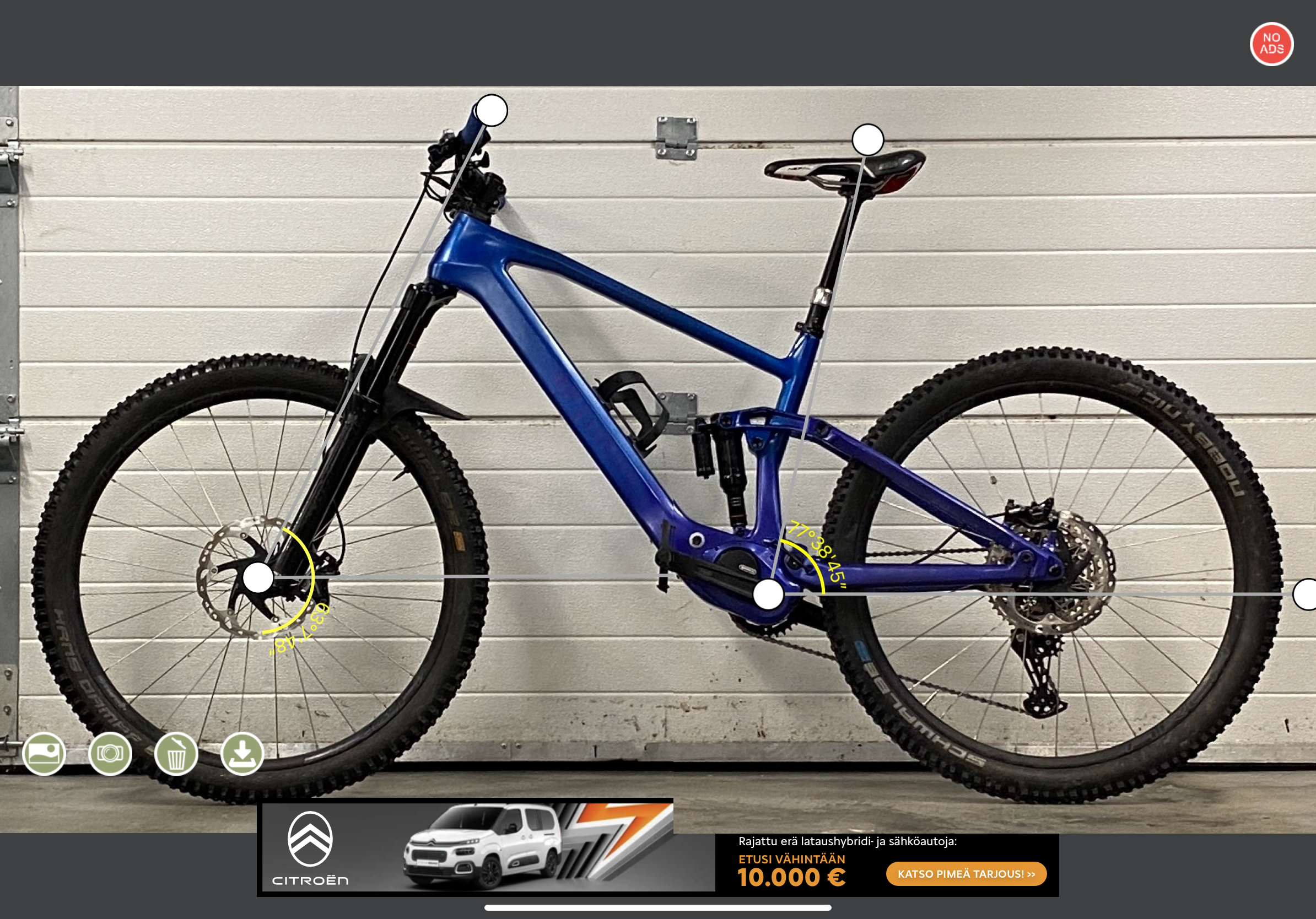

what do you think the head angle would be in a mullet setup if its at 64.5 already??? are you riding mullet setup??

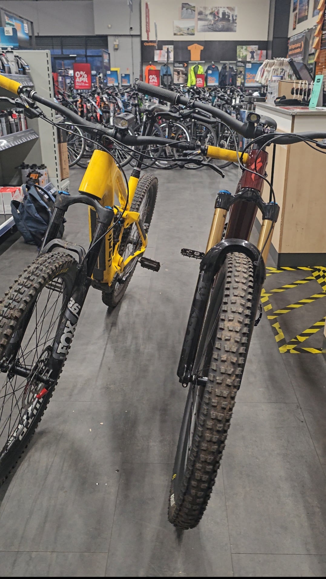

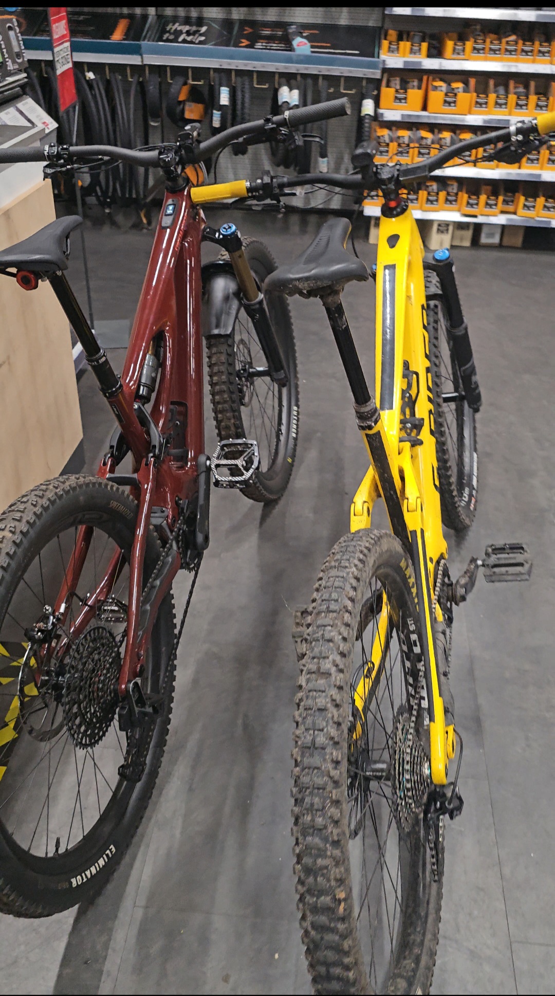

Not the CEF50, but the LCE930, so similar in many ways. Roughly 0,5-1 degree less headangle is what you get when converting any full 29" to mullet.
First one is 29"
Second is same bike as mullet, 2,8"X27.5" rear tire
After riding both I like the full 29" more, at least on trails, mostly because of the steeper seattube angle.
First one is 29"
63.2° with 2.8 rear, imagine if you use 2.4 or 2.5. On the CEF50 with 150 front travel, 210x51 rear shock and 2 x 2.9 (2.4), i mesure 63.5° and 1.3 M of wheelbase on my XL. i would prefer 27.5 rear (more light and strong), but i want not less than 63.5 and more than 1.3M. That means 29 rear mandatory for me.
