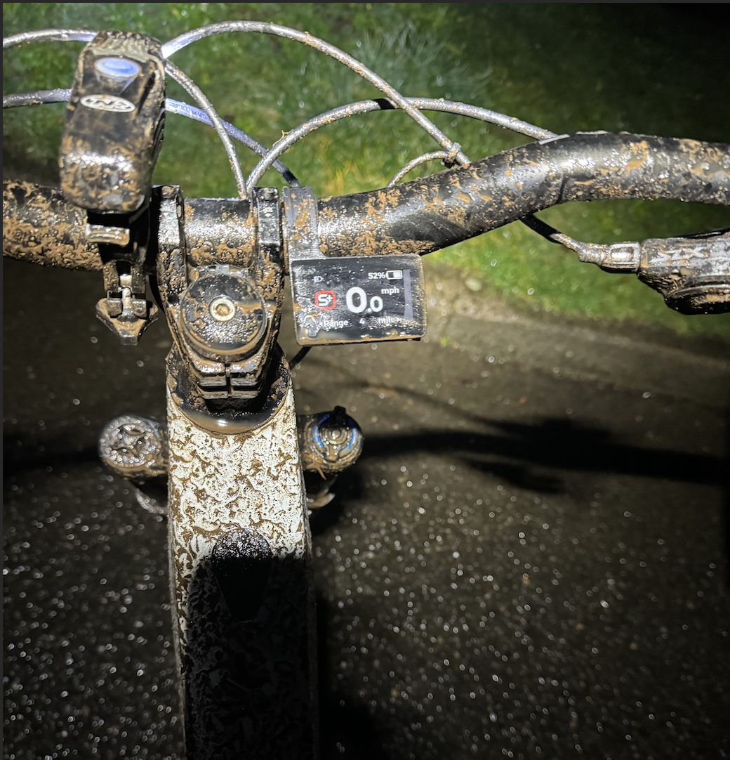

Hi all.
I need some help.
I'm mounting my own cef50. I have one problem.
I buy a Shimano rotor with integrated magnet. But, if I spin the wheel I get 0 speed.
Anybody has the same rotor working?
Any help about troubleshooting this problem?
If not works I will have to buy a centerlock magnet¿?
Regards
How close is the magnet to the sensor? Pics please.

How close is the magnet to the sensor? Pics please... and the sensor can rotate on the dropout. Make sure it lines up with the magnet on your rotor and then lock-tite it in.

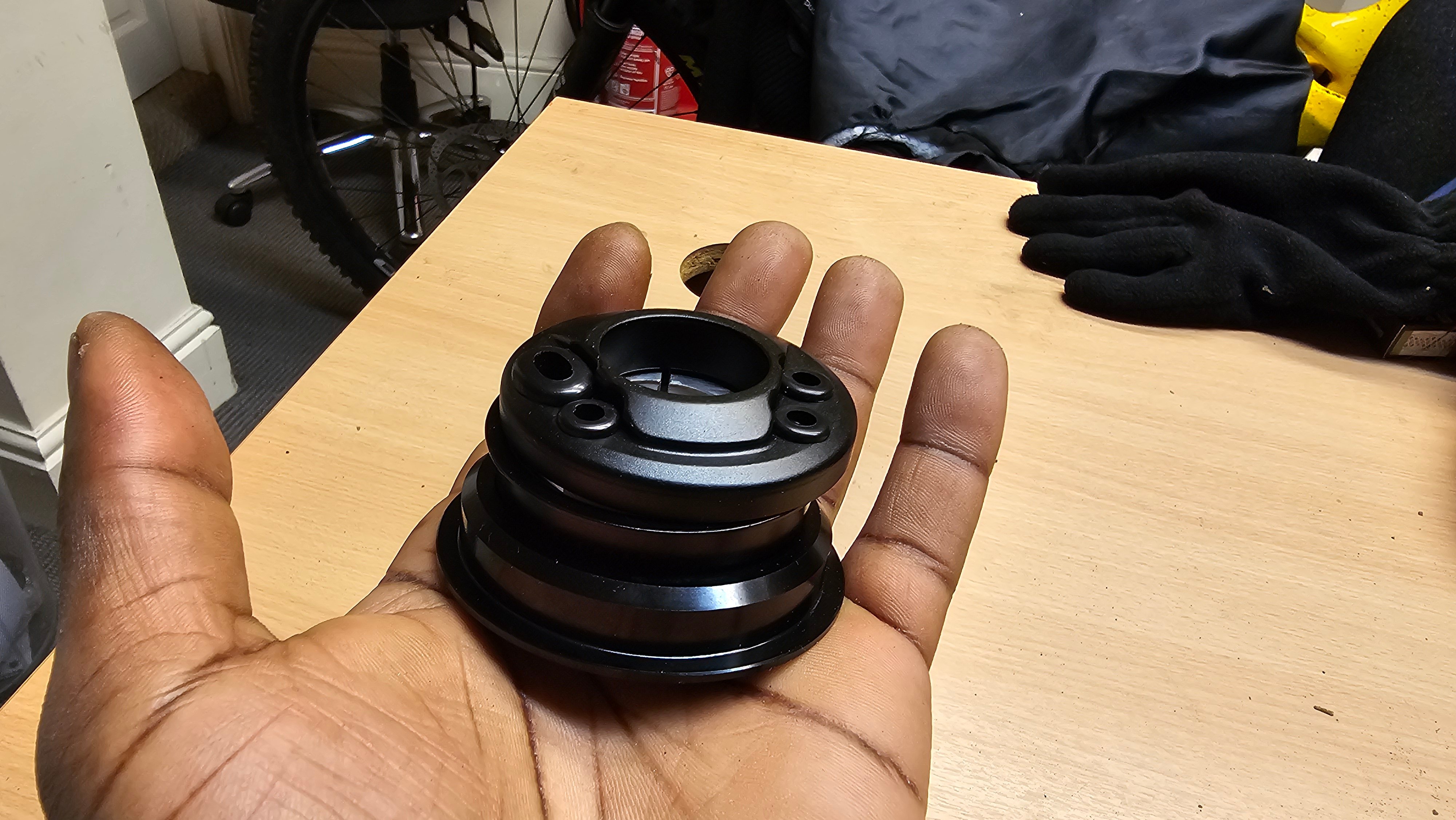

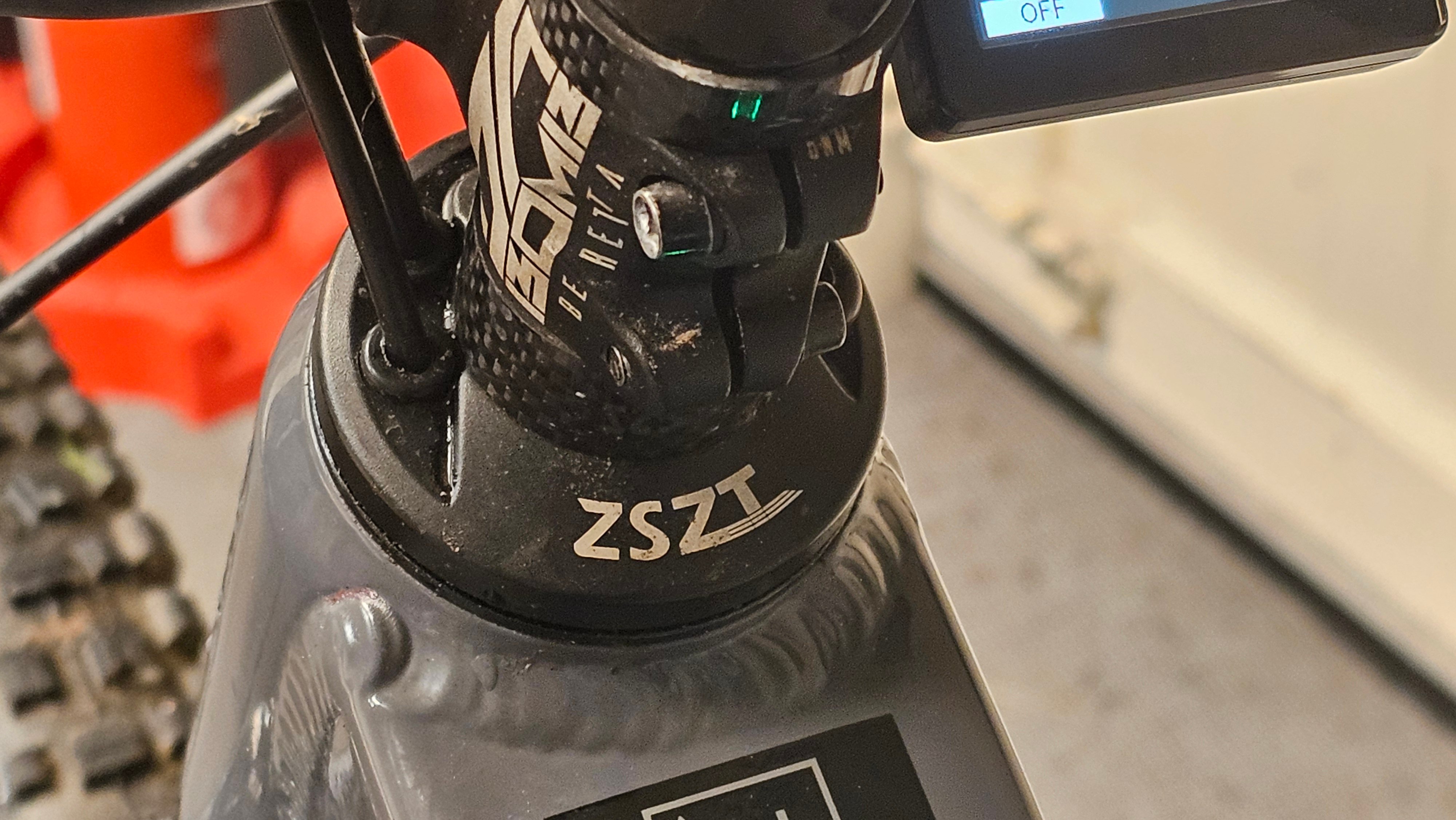

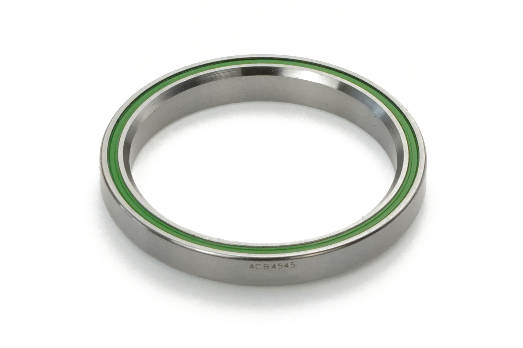

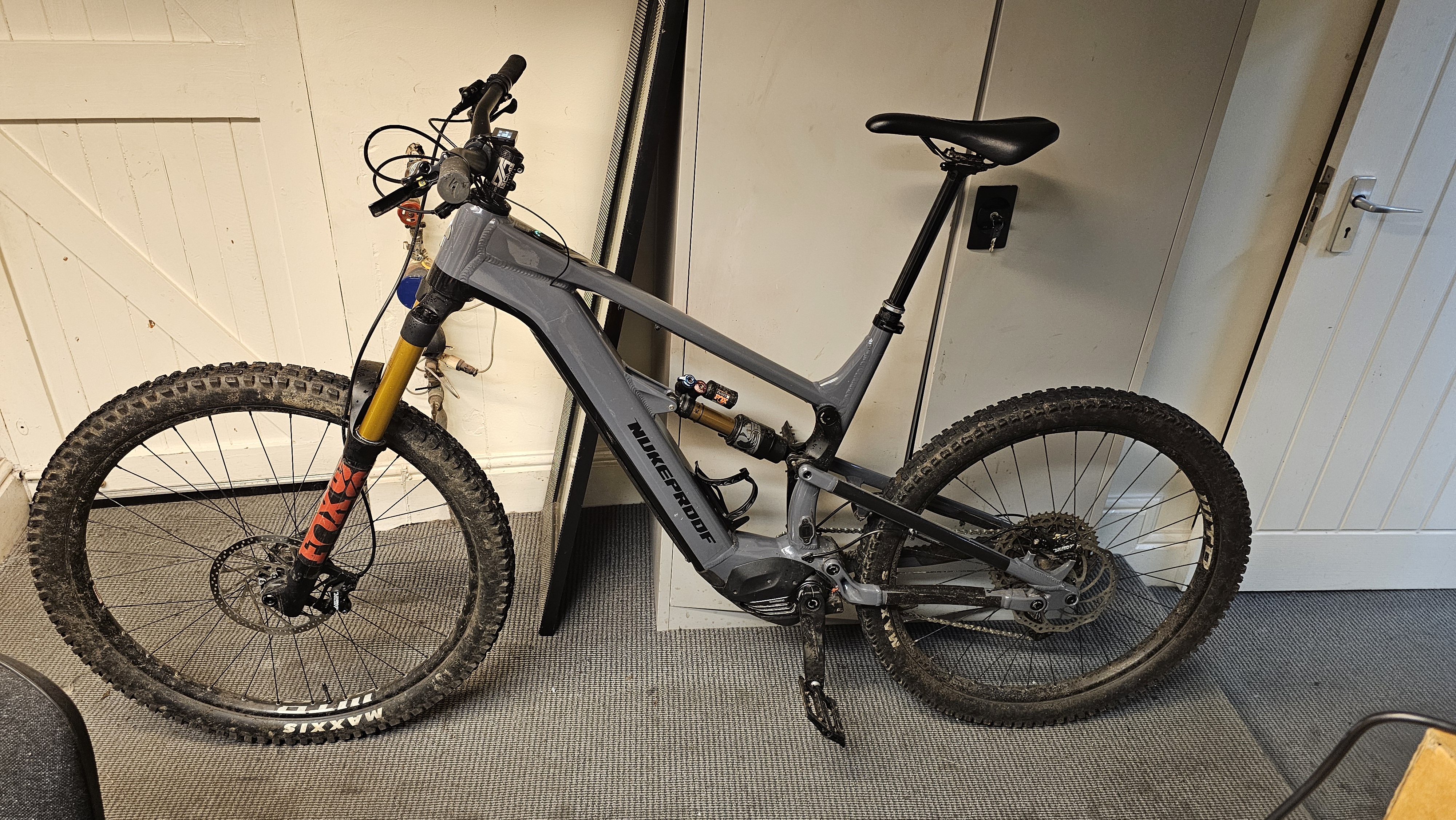

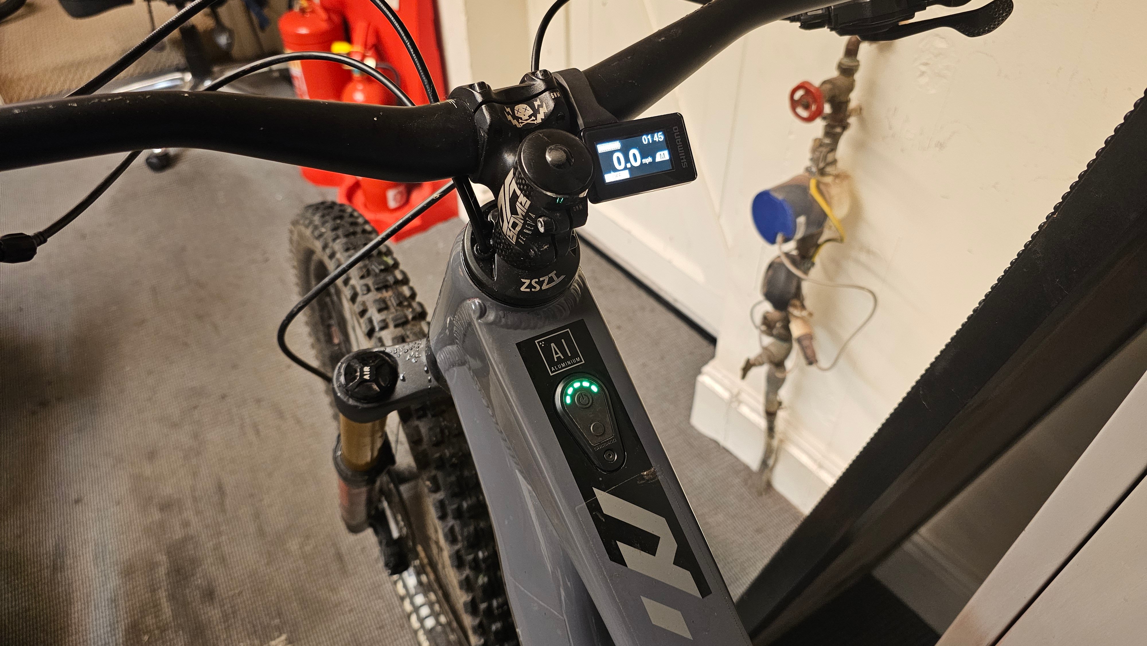

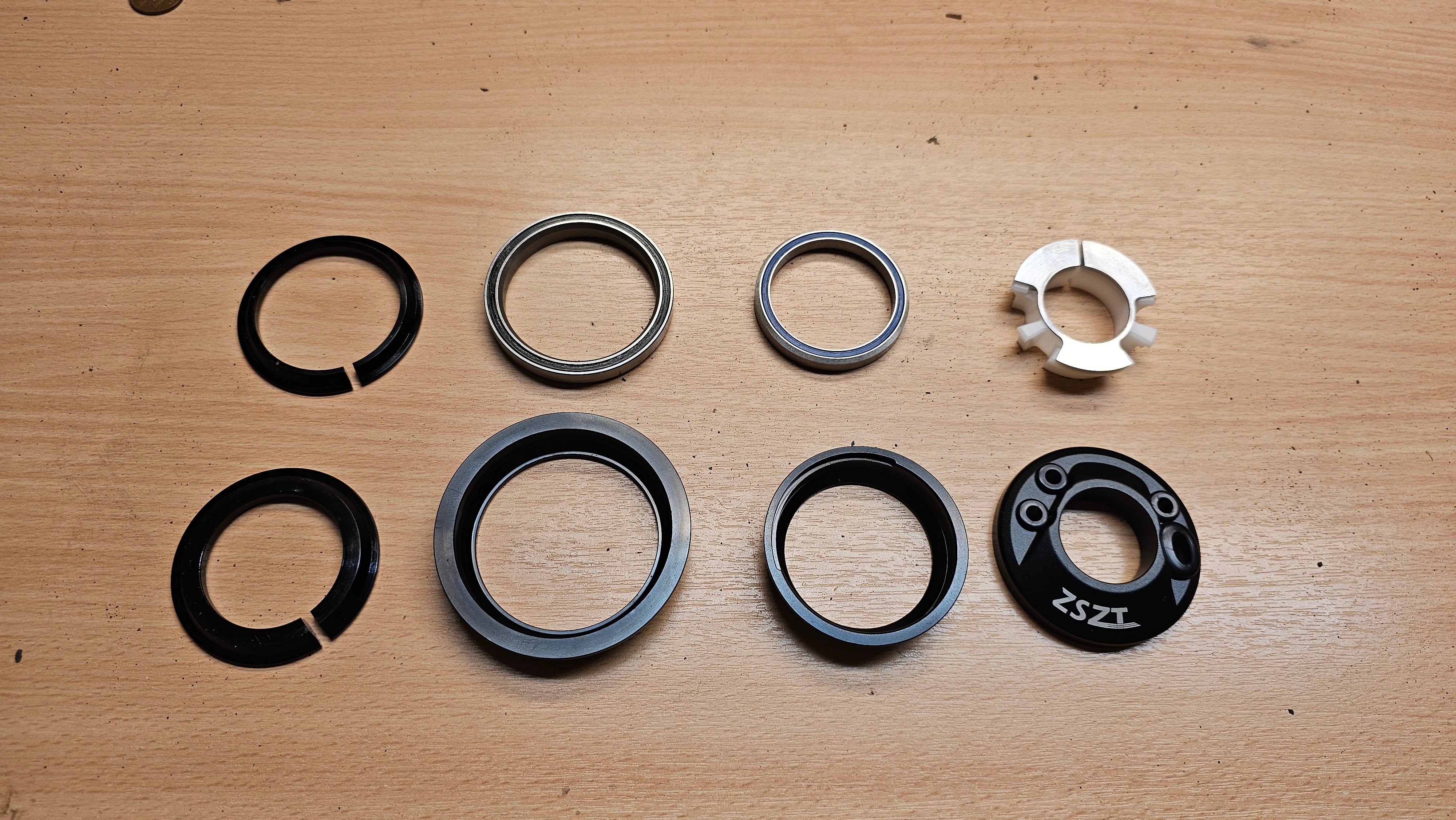

Apologies everyone, I should have updated you all on the headset.
I opted to install the headset into my Nukeproof Megawatt. However, it WILL fit in the CEF50.
Truth be told, headset cable routing isn't so bad (imo). Moreso, it depends on what headset is used.
The very fact that this headset doesn't restrict the turning axis of the handlebars is appreciated. I've come across some which do.
No weird sounds coming from the headset area. And cables dont rattle against one another when riding. But as always, just grease and preload the headset as you would ordinarily.
Cable orientation (depending on your preference), is appreciated as well. Although, the port for the wire harness (or di2 cable in my case) has a dedicated port on the right side of the headset upper cover.
The stack height is fairly low, which is a good thing. So the headtube area doesn't increase monstrously because of the cable routing.
I'm running a 10mm spacers x2. But it can be ran with a single 5mm spacer if preferred, without causing issues for the cables and the stem. So I'm pleased that I've found a headset which works well for headset cable routing. And this will be my "goto" headset for future emtbs/mtbs I build.
Again, It will fit the CEF50 frames. Don't let the fact that I've used it on the megawatt fool you.
It will fit. And I suspect that newer CEF50 frame owners will probably receive this headset by default (if you opt for the headset cable routing design).
Hope this helps👍🏿

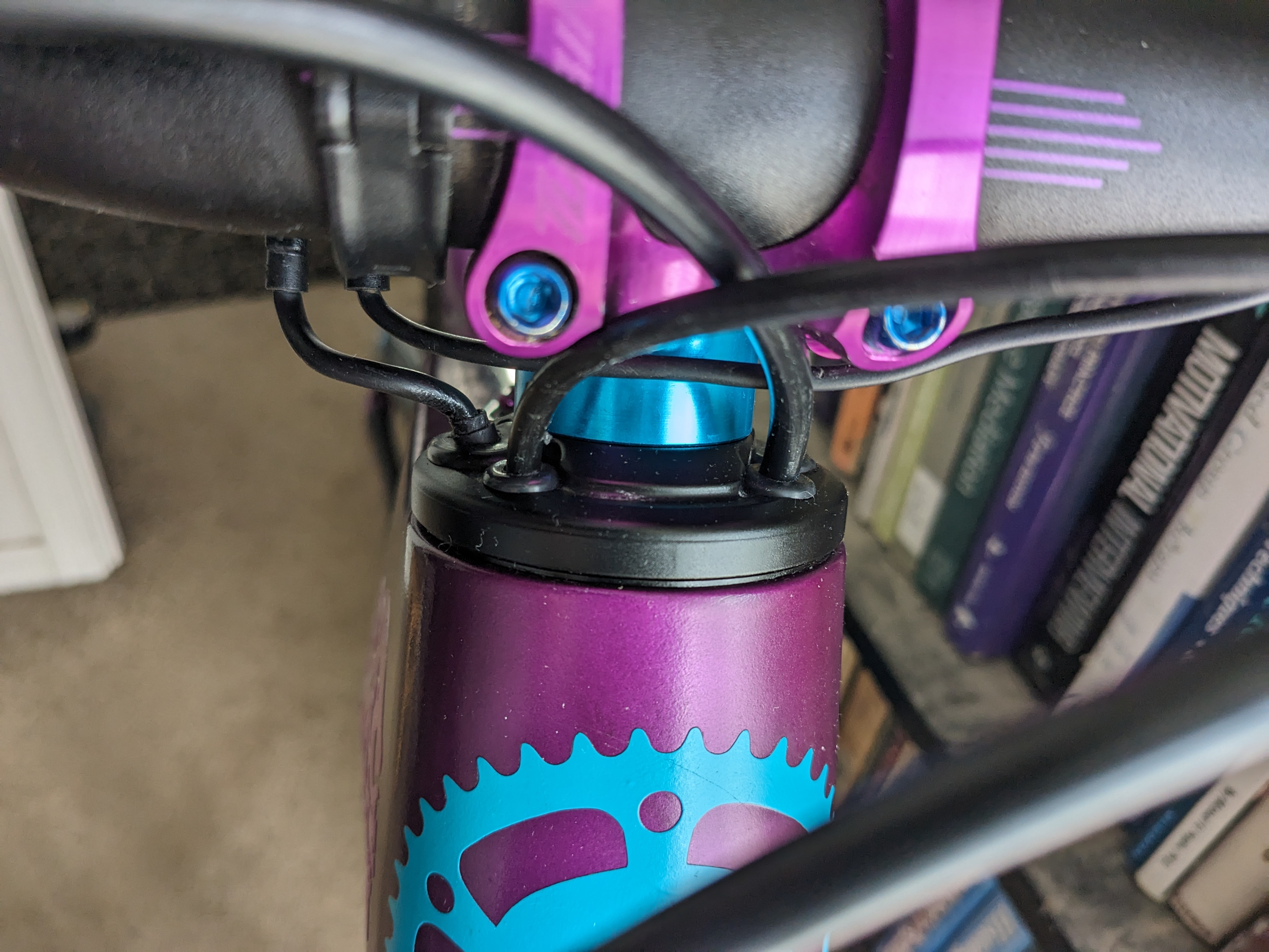

💯 Way easier to install compared to the old for the upper headset. Dedicated display ports insure no friction points that wore down my display cable and dropper housing bare and guide the cables well, thus not having to fight for space between them.
Plus, there's no gap for water ingress which definitely happened to me leading to the dreaded creaking.😝 (The upper cup is raised lip about 1 mm +/- closing the gap.). This time, I also went with the higher grade Phil Wood waterproof grease, and applied generously throughout the headset for a better seal.
Downside: since the upgraded upper headset has a thinner bearing 42 v 40, the bearing balls are smaller. In general, it's better to have the largest bearing balls possible, especially for the headset. I found the OEM bearings very low quality. I replaced them with premium grade Enduro 52/42--45/45°. $35 is relatively cheap for the higher quality. See link 👇
And unfortunately, I found the lower headset was just junk as well and went to the premium upgrade: Acros 66 at the outset.

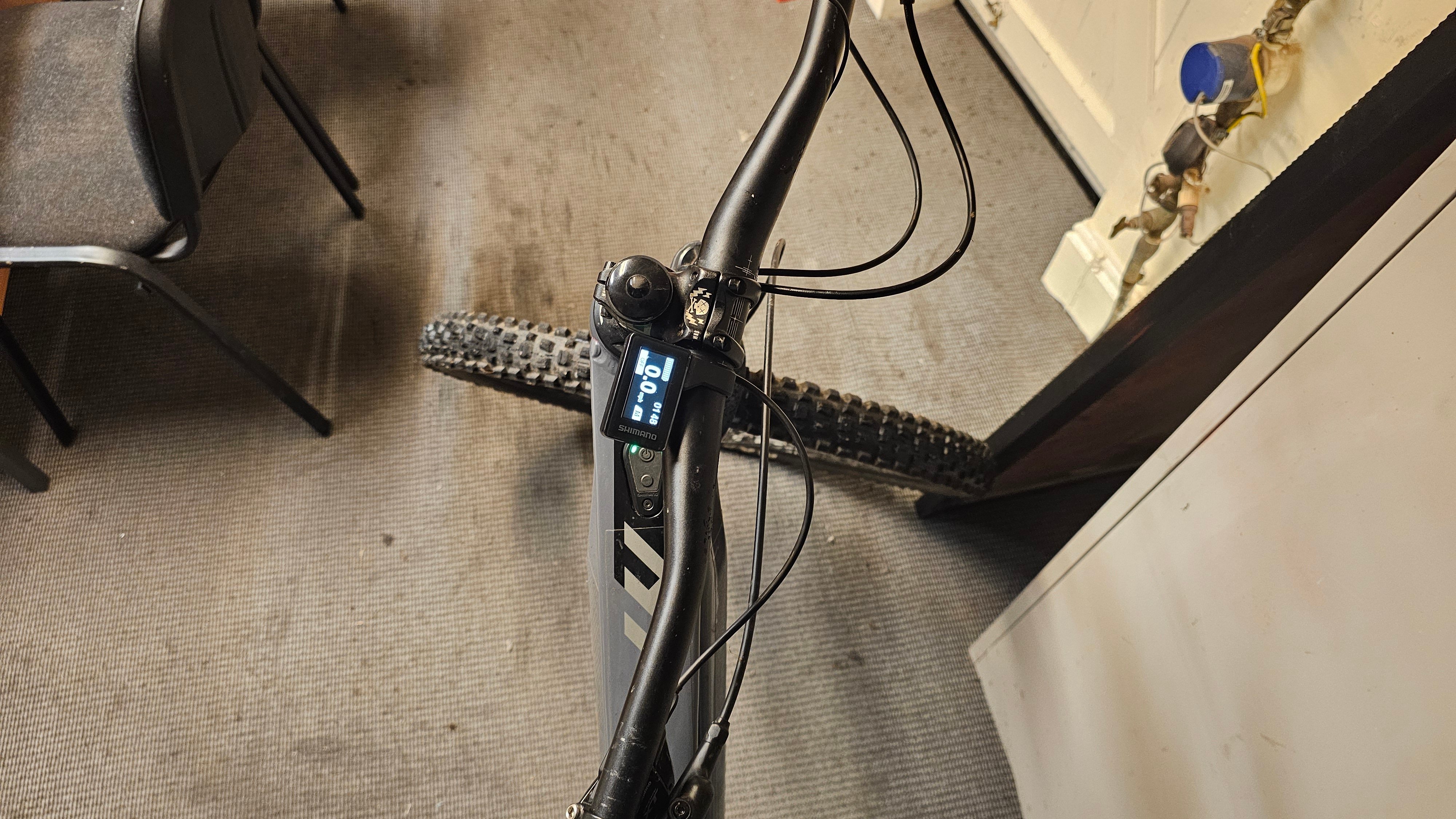

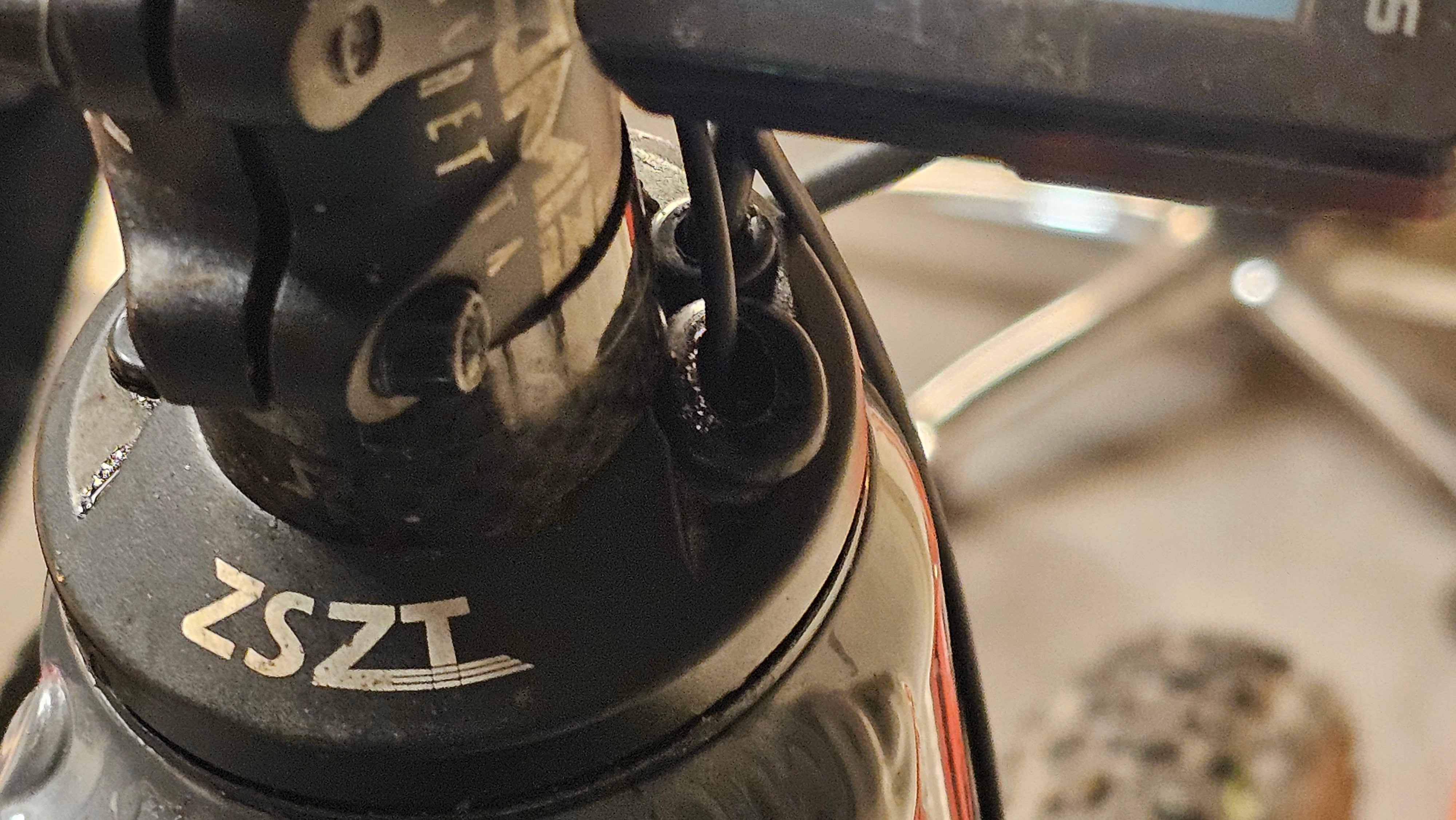

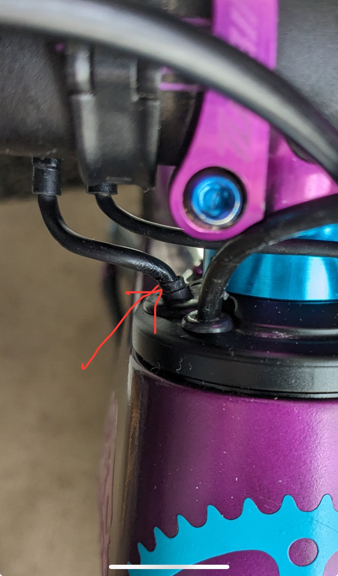

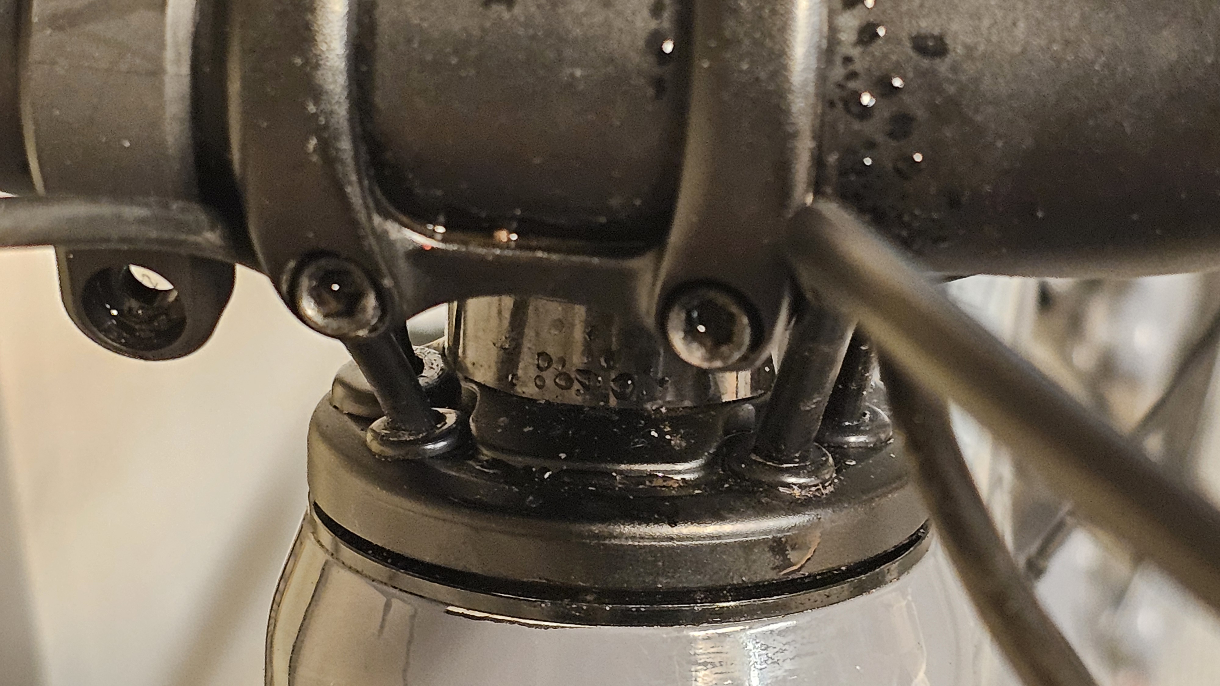

I see You walking home…
I had 3 cable breaks with the canbus cable motor to display allready, with standard cable routing at E10 frame. Maybe they improved the cable, the current one lasts since 1.400 km. I allways take a spare withe me in my backpack. Good luck mate!
TCFlowClyde
Feb 26, 2022
1,384
905
Mesa, AZ
View attachment 131891 .
Yeah...it's an odd angle.. But no choice of course. I do have an extra display cable as a backup I'll take it on camping trips just in case the inevitable happens down the road 💪
Makes a good case for wireless. The next gen of the Bafang display should be battery and Bluetooth, no cables to worry about. 👊
Great catch. I guess ill have to heatshrink all those sections to give it some mechanical support
Yeah agreed! I did heat shrink wrap to help close the appature better since it's bigger to make it more water tight. I should've done it higher through to the bends. I'll go redo if it looks like it needs it such as cracking or intermittent display connection.
Usually, Bafang makes 'em fairly tough. And I've hadn't problems with my past M600/M620. But they're also traditional side routing, so probably not a bad idea prior to the install due to the two acute dog leg routing.👍

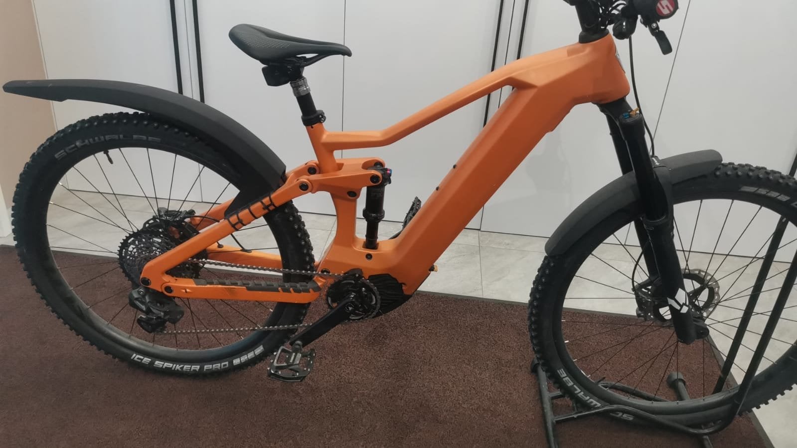

Guys, I’m about to pull the trigger on the cef50 size small, do you have any rear fender to recommend? A large one if possible !
I've tried a lot of wings. That's what I like the most. It protects well. You just need to fix it well. The clamps broke in the cold.

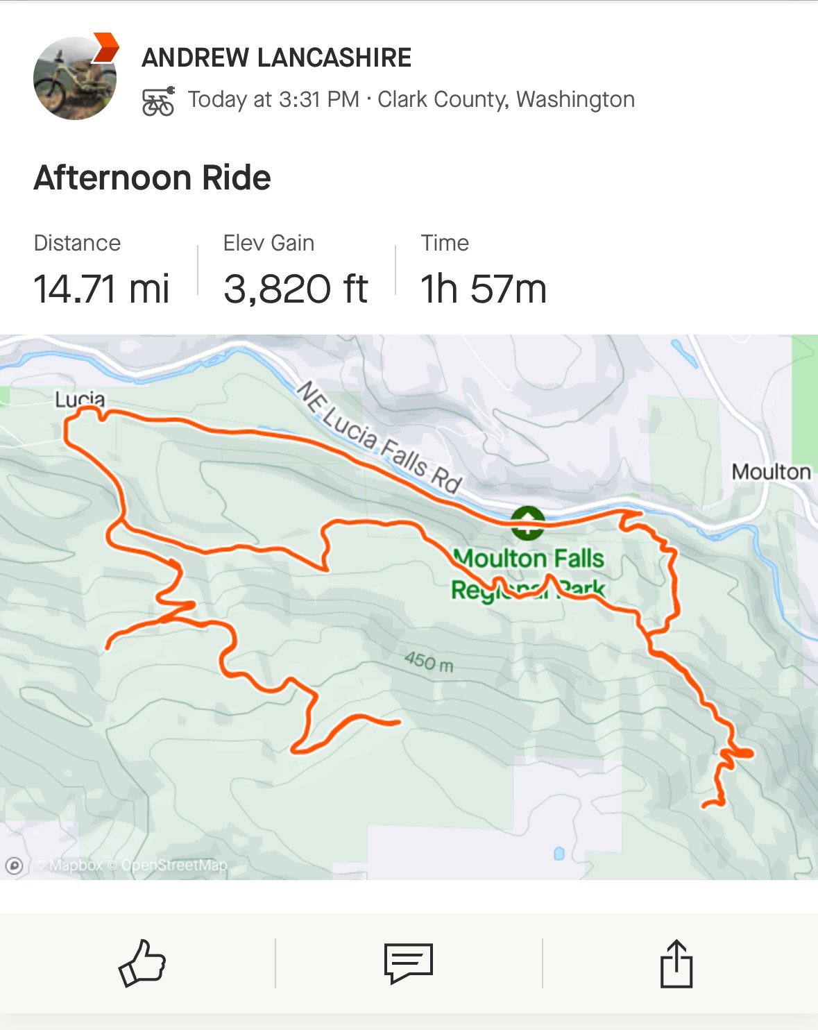

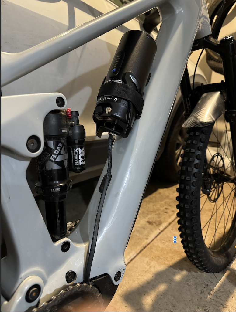

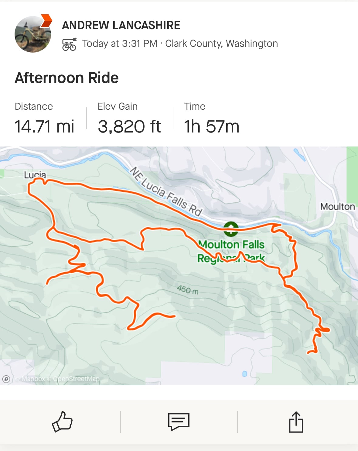

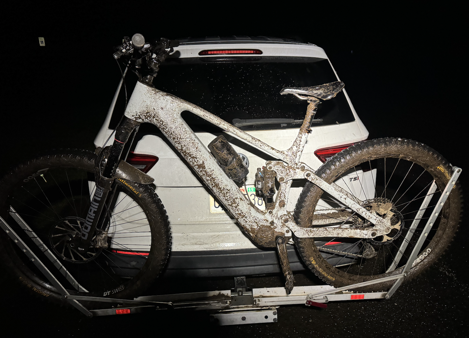

DIY 240w range extender is done and passed the first test. Thank you @mike_kelly for your help and wisdom. Couldn’t have done it without you.
I wanted a comparison of the standard 720w battery range. I did a ride last week in sport+ which gave me 3700ft before it hit the 25% throttle limit. By the time I got to the top of climb I was at 4k and 14%.
My goal was to be able to get 5k in sport+ before hitting the 25% limit. After receiving the battery, ideal diodes and connectors. I started trying and failing to solder this all together. I’m going to detail out the process I took separately . There are other roads to get there but I’ll document mine.
I did a ride this afternoon which took me into the dark hours and sub freezing temps. I started in the wet and rain 37 degrees. As I climbed I hit the snow line and tried as I might it was getting to thick. Back down and try the lower elevation trails gave me a total of 3800 ft over 2hrs with a remaining 51% battery left. This puts me in clear range of 5k which I’ll try and attempt soon. Between the newness of the range extender and how the break in after a few charge cycles works and the freezing temps I think it will be a good permanent addition. Some pics below.
View attachment 131953 View attachment 131954 IMG_0358.jpeg View attachment 131956 View attachment 131957 IMG_0362.jpeg

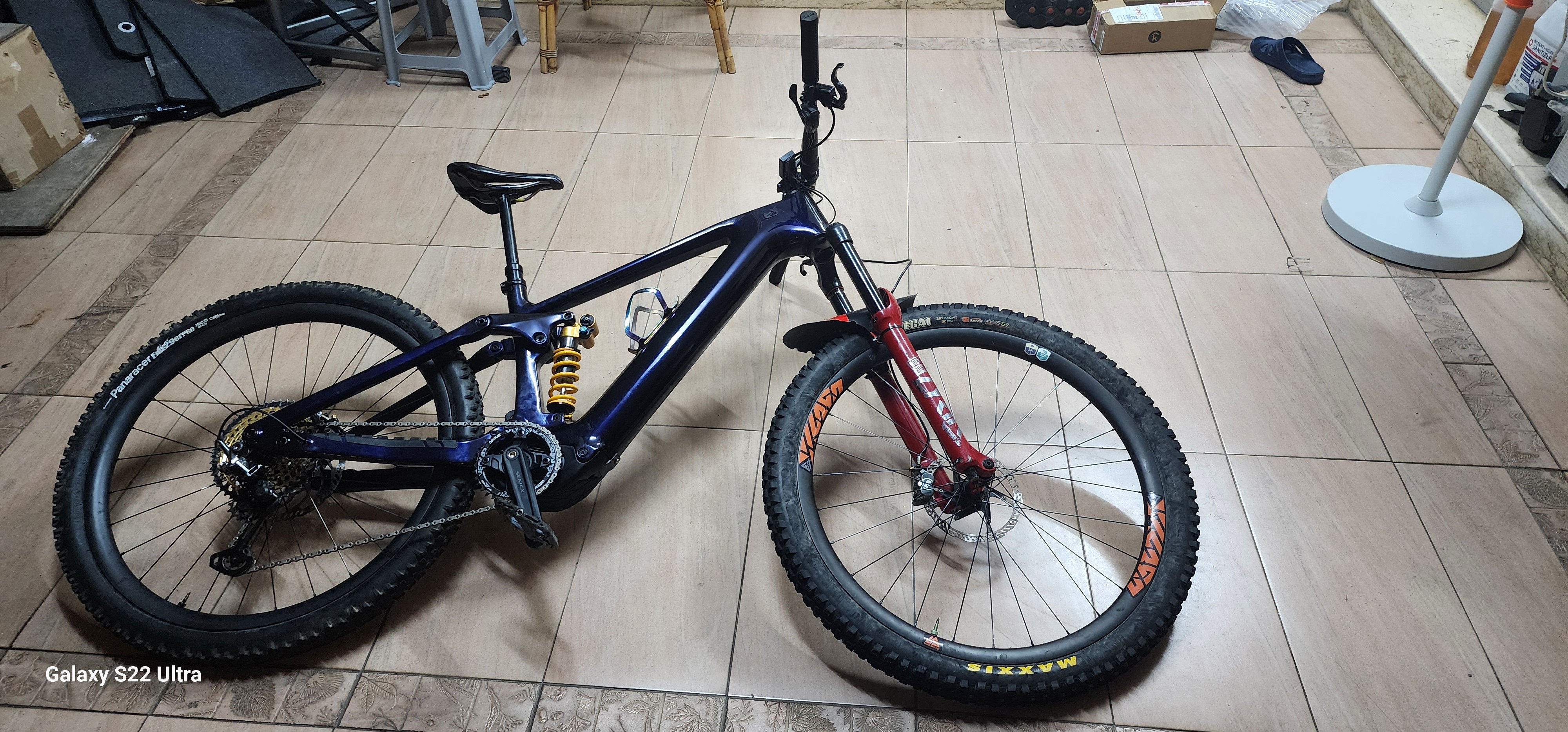

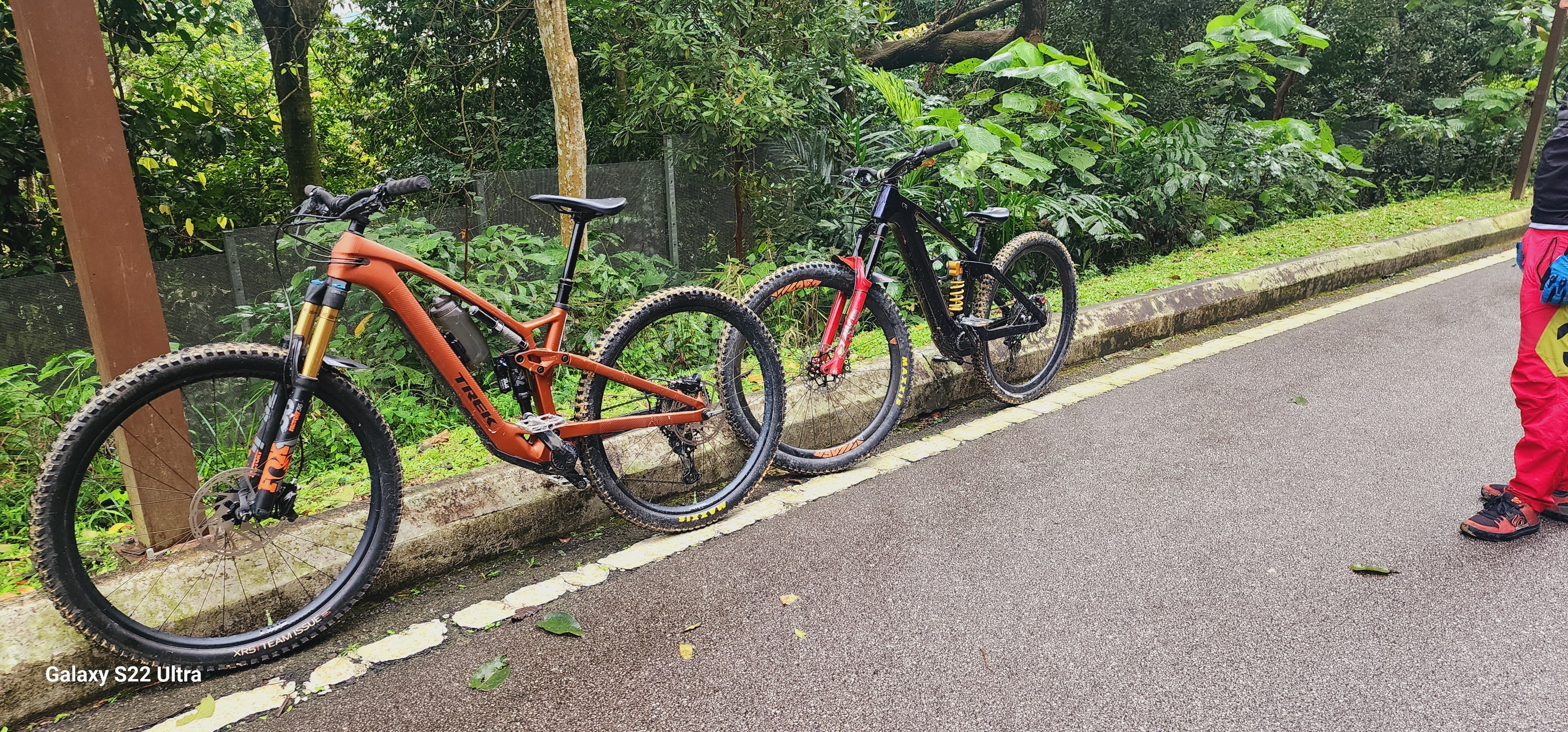

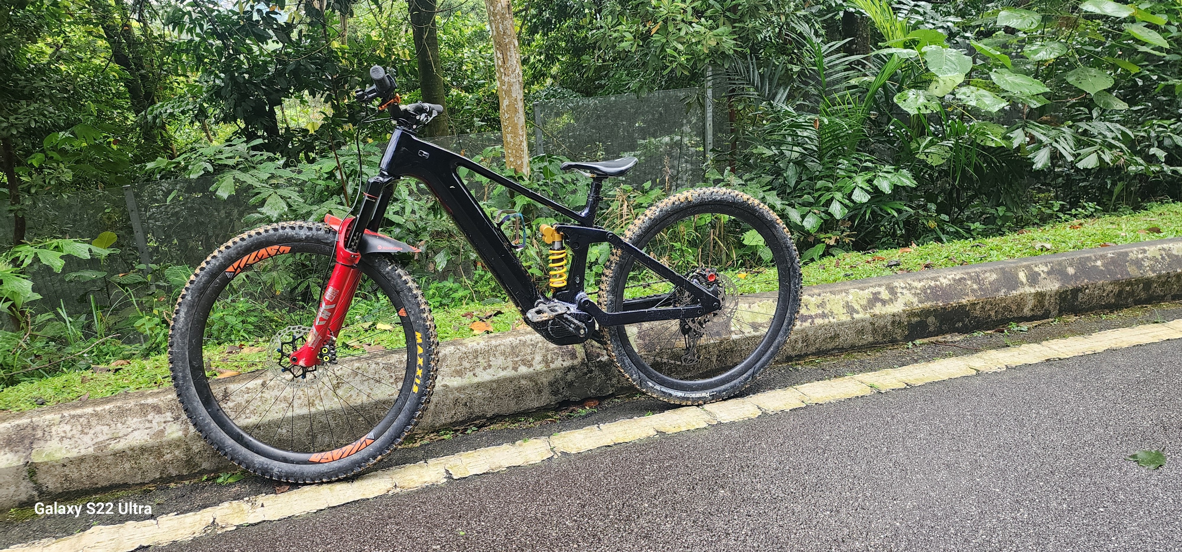

In my pass i own several high end bike from sb150, sp enduro 2020, megatower n now giga 290. I dont have those satisfaction that i have for this frame.. The DH feel its almost the same as my giga, very planted and stable. Cant wait to put in zeb buttercup, should be perfect build. My bike weight 19.3 with rear tire cushcore as on pic. Highly recommend frame.
TCFlowClyde
Feb 26, 2022
1,384
905
Mesa, AZ
Zebs are nice! I really like mine so far!🤟
