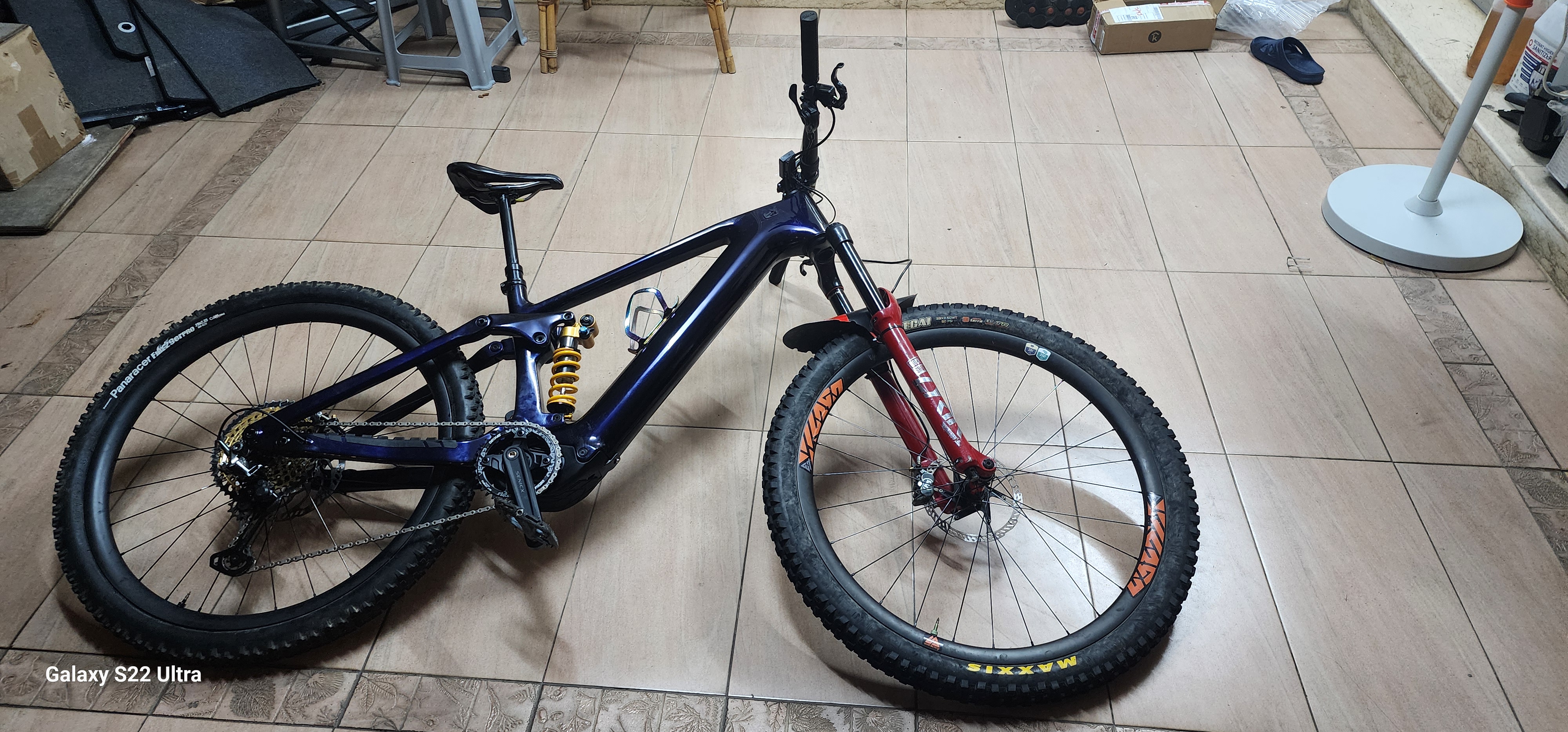

Looks like Kiara. I wanted to try the m820 and i have the m560. Lemme know your riding time?
Yes its kiara, my was like grab alot if my friend tested it on 2k loop... They where impressed with the bike only my fork has a problem require service

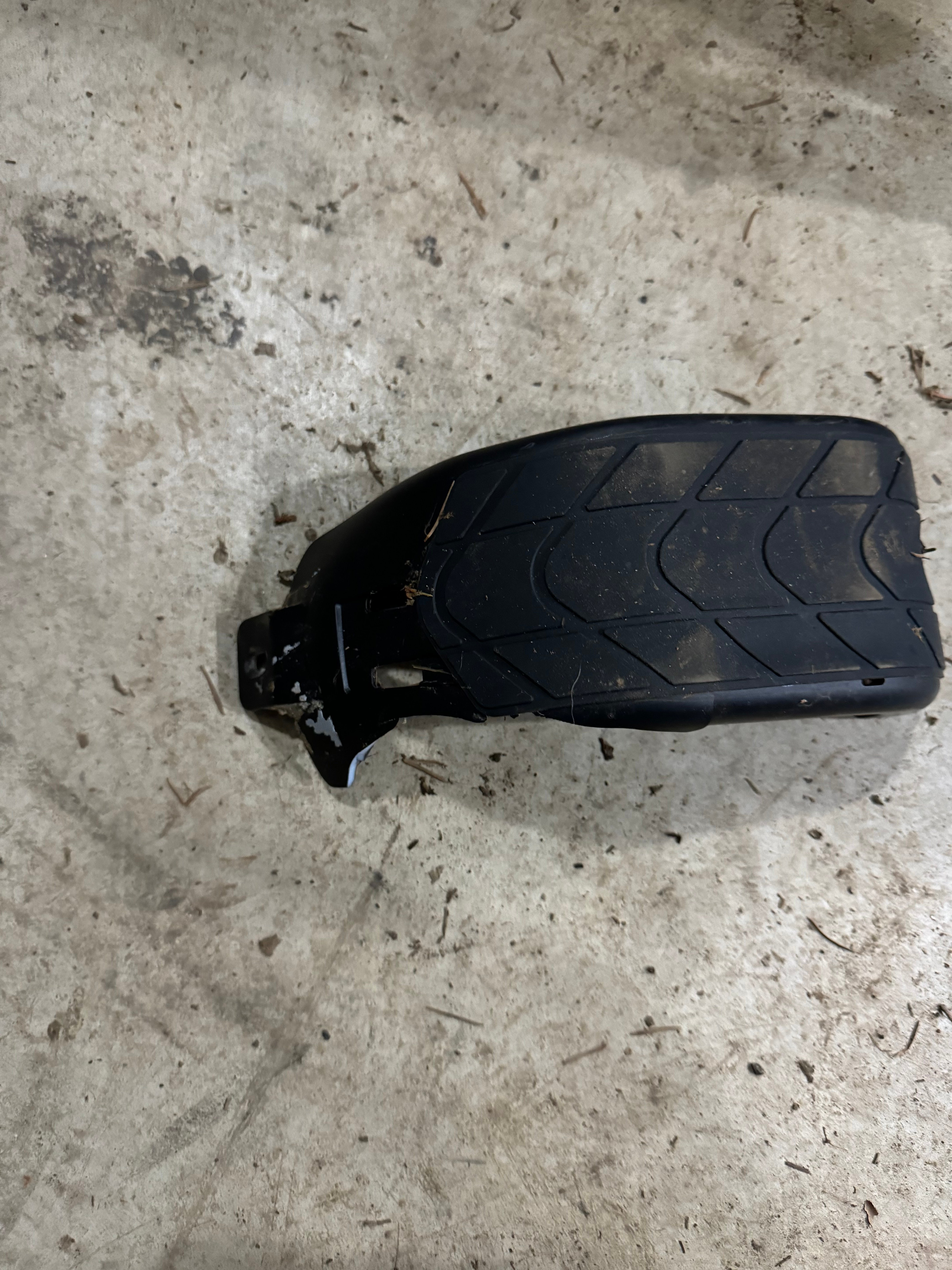

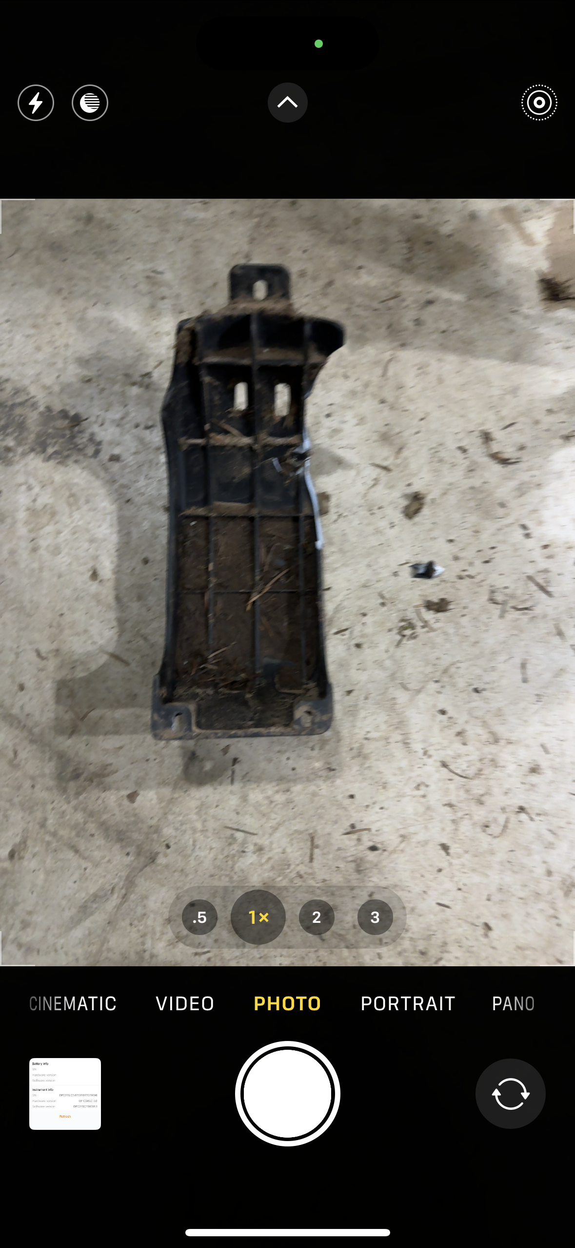

Did anyone get the new and improved motor cover? I just received mine and they look identical to old ones. I guess I’ll just start riding with it and let you know how it goes. Put a brand new old gen motor cover on last night. I looked today and there’s a big chunk out the side of it. Hopefully the new ones can last more than half a ride.
TCFlowClyde
Feb 26, 2022
1,384
905
Mesa, AZ
That's a bummer! 😝 I got almost 3 rides out of mine. Pic of the damaged Gen 2?
