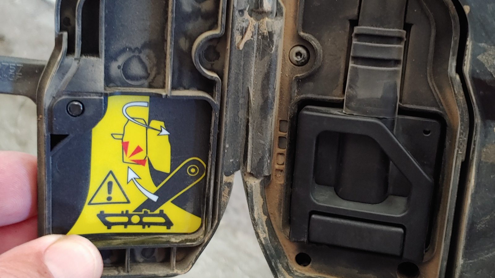

Cracked charge port door hinge.
Time to visit the specialized store.
Gorilla tape should keep it from falling off.
My port fell of 9 month ago - have ridden without it in any kind of weather
There is still double sealing at the plug - so no water ingress at all
Have also been riding without the chain guide for 900 miles with no drop of the chain :cool:

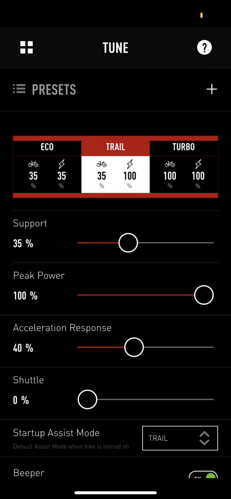

Does anyone else’s bike feel sluggish after the update? Trail now feels like echo and turbo like trail. I loved the way the default tune felt before but now I’m thinking I might need to tune.
I've been holding off on pulling the trigger on 8.1.5 until there is more feedback....good to know! Did you by chance have your tune settings tweaked before the update and then maybe the update returned everything to default?

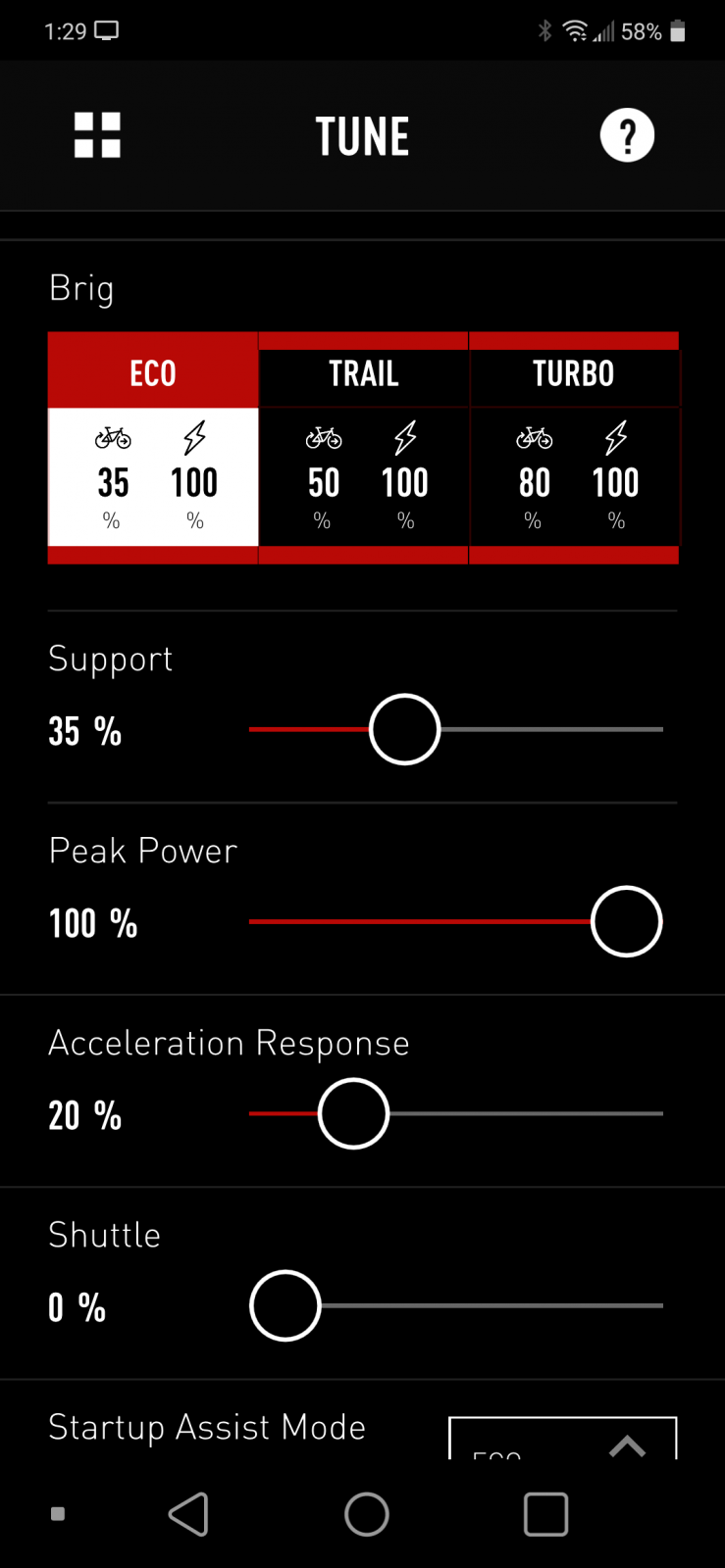

I can confirm the motor update does not change the tune setting.
I run a custom setting, 35/100 50/100 80/100, and it was still the active mode after the update.

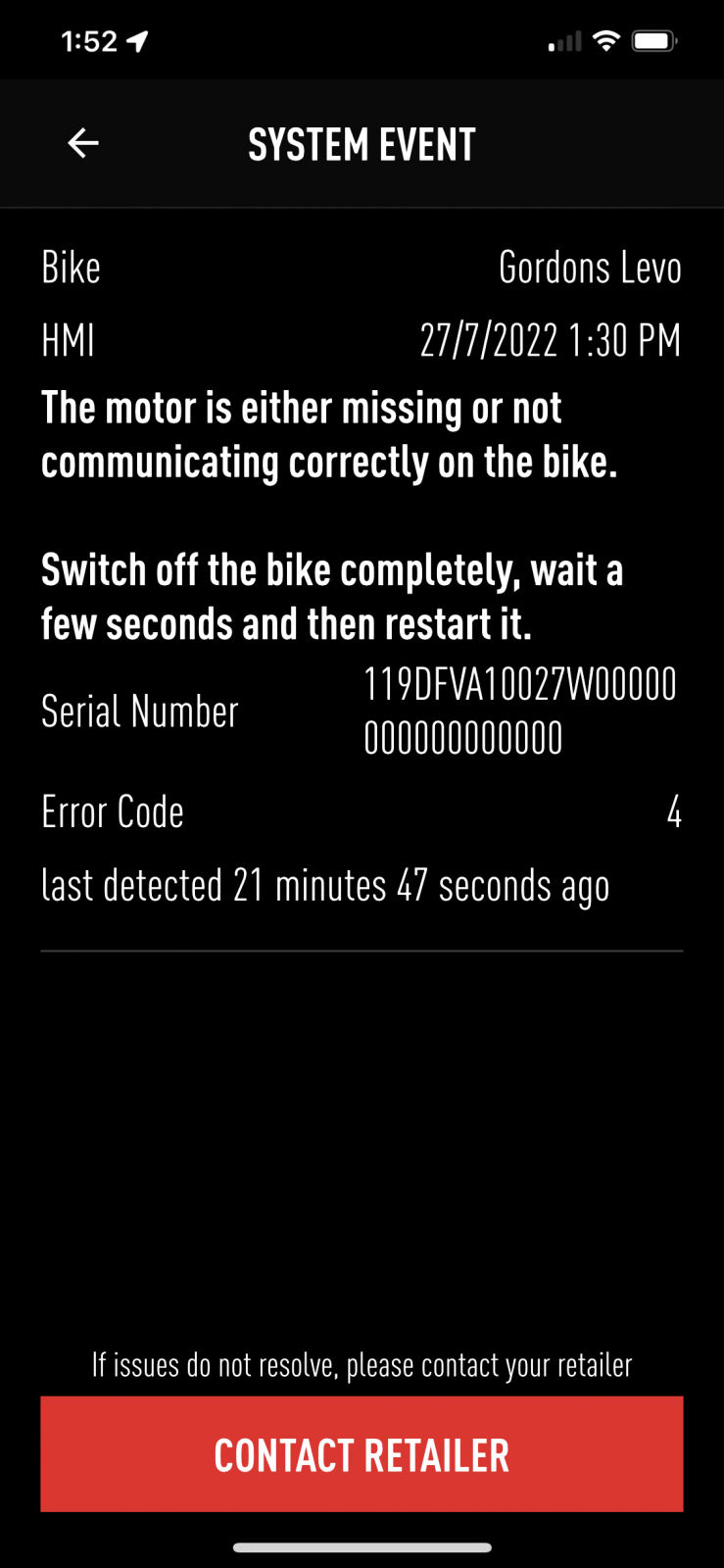

Have upgraded both my 2023 Levo's. Expert and Pro. (don't ask! :) ) and now have an error on both. Both report a motor connection error. Bikes both seem fine (in my driveway at least). But I'm still wondering if i have an issue or there's a glitch in the upgrade process that triggers it.
Had the same issue with my 2022 Comp Carbon. After deleting and reinstalling mission control app error report is gone. The bike is running fine. Don’t worry.
