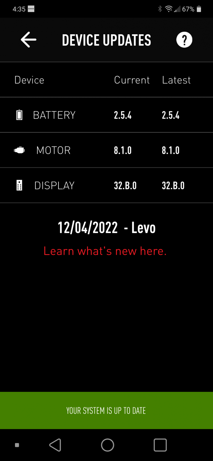

What version? My motor has 8.1.0 which was released 09/03/21.
I rode the bike an hour ago and it said there was an update and needed to take it to a specialized authorized dealer for the update.
Then I connected to get you a screenshot of my current versions and now there's no update available.
Must be a bug...

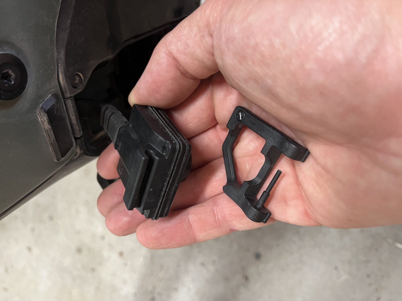

Yeah... You need to remove the plug by getting a piece of the plug, pinching it, and not just the handle. I use two hands.
I was at a specialized store looking at a bike and opened the charge port door to peek in there. The plug handle was missing. LOL
The store broke it off charging it one time.
The entire charge port door and contents are a design disaster. It's literally located in the worst possible location on the bike.
If you said "where could we put the door to do the most damage?"
No need, it's already there

Yeah. Definitely a drag. I wonder if it’s designed to fail as opposed to breaking the housing of the battery. I was thinking I could drill out the remaining plastic hinge and slip in some steel rod but then what if that breaks the part it clips into? Then it’s cable replacement.
Sized it up and it looks like a piece of 1/8” stainless rod would be a good fit. I think I will try to fix this one up while waiting for a new one from the shop.

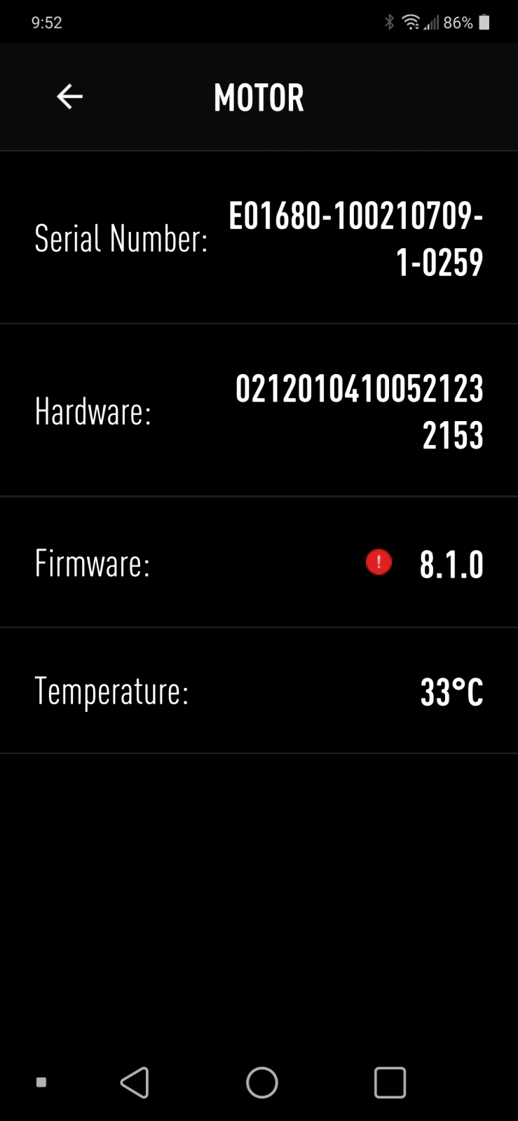

No luck getting the update to download on the Levo. Constantly fails between 4-26% during the update connection module phase. I tried deleting and reinstalling the app. No improvement. Any ideas?
Edit: Spoke to Specialized Rider Care this morning. They're seeing a history of errors between the TCU and motor in the log, so it sounds like a bad TCU. Seriously a bummer. I was having problems with the remote on this bike as well and had to swap that out. However Specialized implemented their CANbus, it seems the hardware isn't very robust at all.

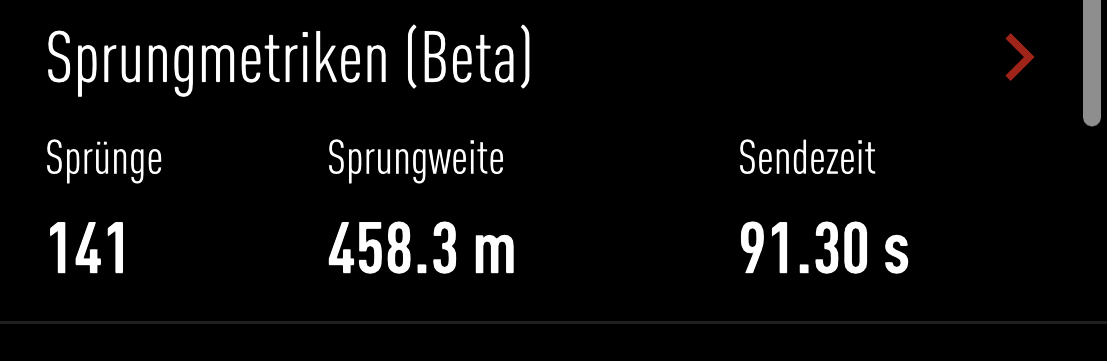

I noiticed a small bug: when I'm on the new "screen", that I added with the jumping stats data, it sometimes randomly jumps into the 1st "screen" ( default ).
Hi !
Same here ! Skips back to the 1st screen.
Perhaps its a feature ?
The new firmware is allegedly capable of detecting anything non standard and is then stopping the motors from working. Those with derestrictors beware!
No way ! The only speed input is the rpm sensor. Every unlocker that creates a smooth modulated signal near the limit can not be detected clearly
The only bug i found is, that when jumping derestricted a 8m Table is shown with only 6.5m due to the wrong speed input over 24km/h 😅
Overall it is a Nice feature 🤘Especially the Jump counter !
Looks like I will have to try and repair this one as the Canadian distributor doesn't have any spare battery pulls. That kinda sucks. 1/8" steel is a little bit larger than the fat ends of the hinge too. Perhaps I can print a piece to repair it.

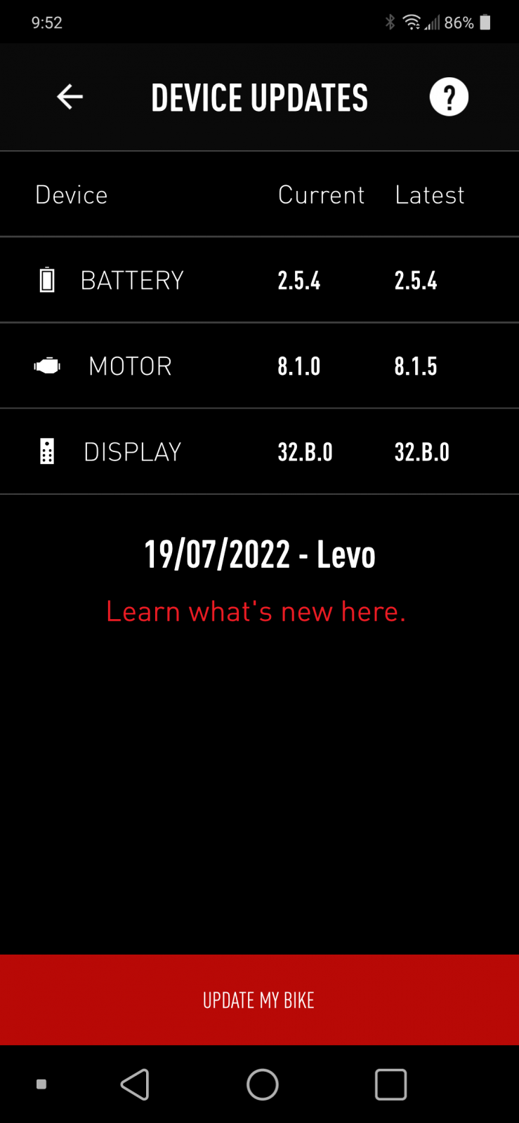

So to double and triple confirm... Levociraptor 2.0 will continue to work after 8.1.5 update?
The recommendation is to unplug Levociraptor first, update the bike through the MC app, then reconnect it?
