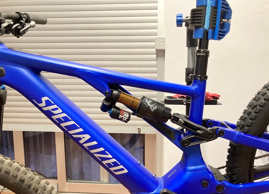

I've got it in the lowest and slackest setting. I like it as the stuff that I ride is quite steep. Havent tried with any other setup, so cannot comment on that (y)
Hi, when I picked up the TL expert 2022, immediately set the bike in the lower and slacker mode, having an enduro background, I immediately found myself very well, but, at times, I touched with the pedals on the ground for the lower bb height , now i moved to high and slacker position and i like it better, with shorter rear end and higher bb height.

I use it, but with a cascade link for 230x65 shock now I have 165 mm rear and 170 front the ha now is 63 degree.
the fork is the original fox 38 performance elite, with 170 air spring and the shock is a dhx2 factory
Bit risky running a DHX2 isn't it do the shafts snappy easy on levos due to the lateral forces through the shock

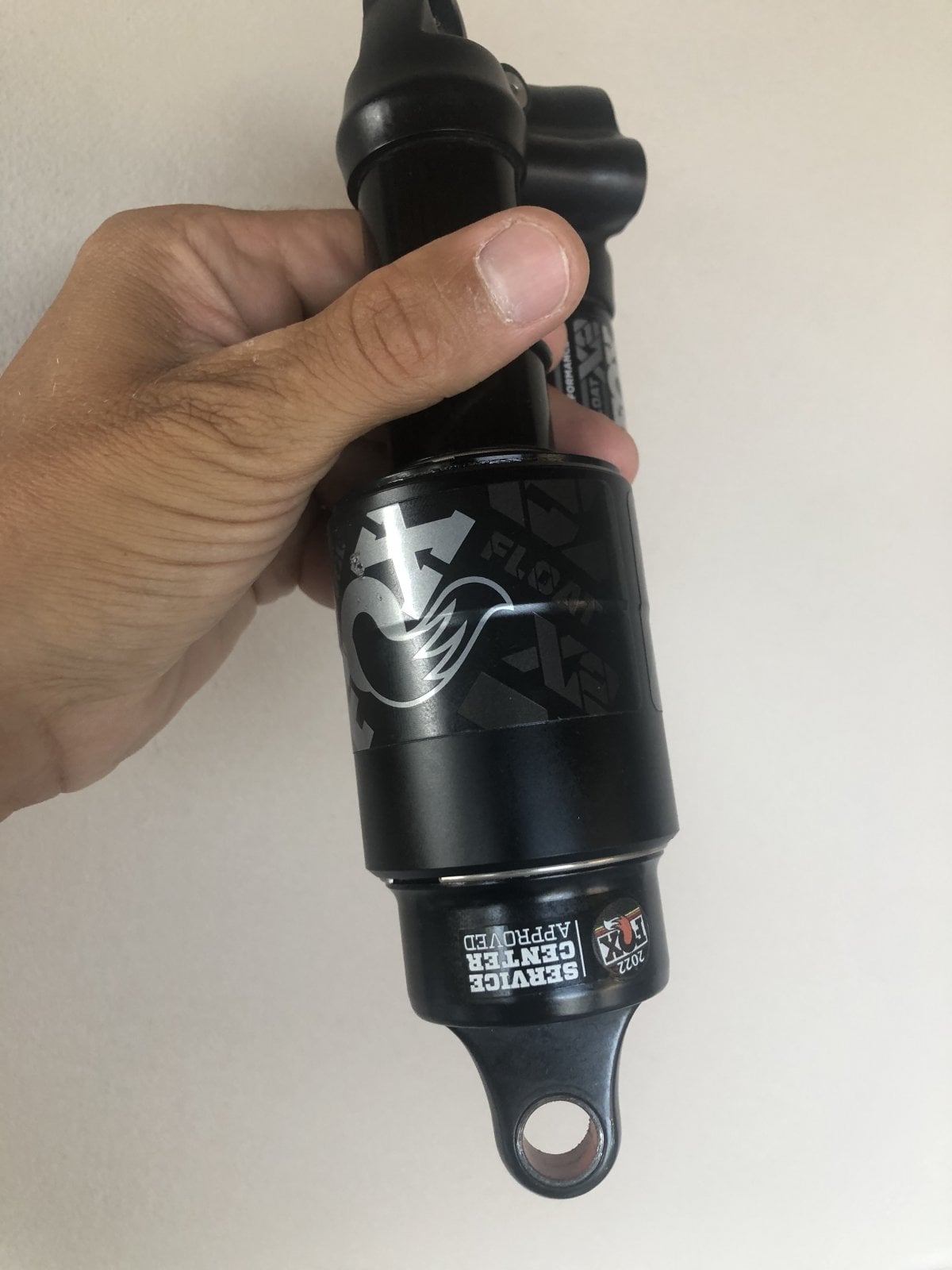

Salve a tutti! Chissà se è normale che la mia Fox X2 stia per entrare in servizio per la quarta volta! Non ne posso più! Ho avuto più problemi con questo shock che con qualsiasi altro
