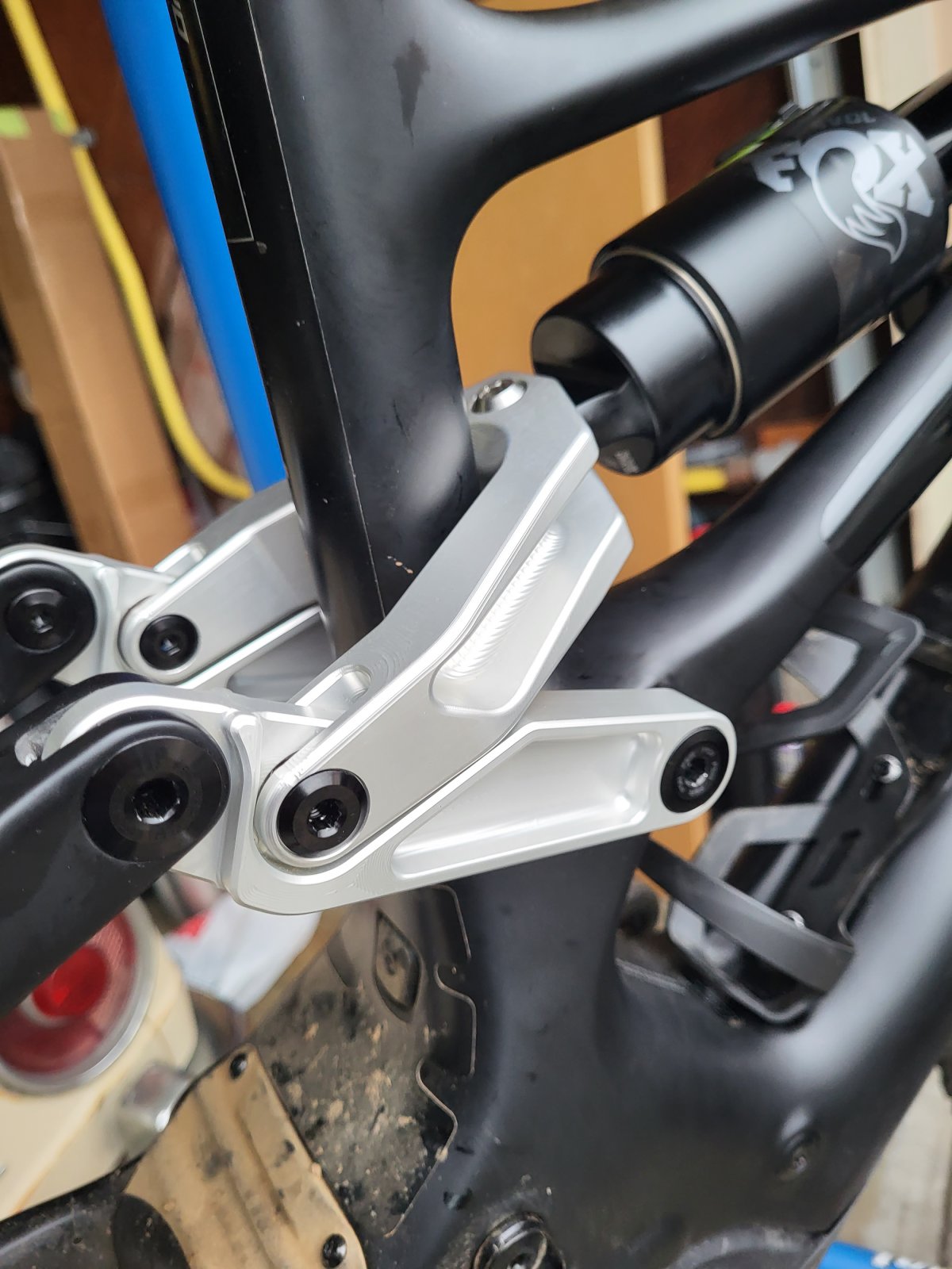

happened on my 19 levos the air shocks would start to knock got a gen 3 Levo comp and that has started to do it now so have been running coil last 2 years on the 19s not a problem had a KSL for 3 months with the same shock as the gen 3 Levo did have one single problem with it just hated the motor that why I sold it otherwise I would of kept it

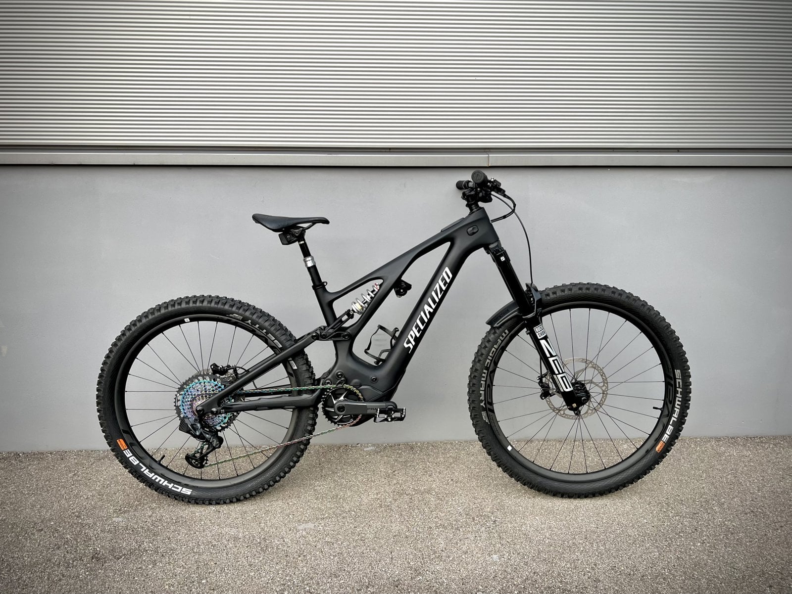

New Bike Day ☺
PUSH - Smashpod - TRICKSTUFF - ENVE - Industry Nine - RockShox - Hope - Sram XX1 AXS - Roval Traverse SL

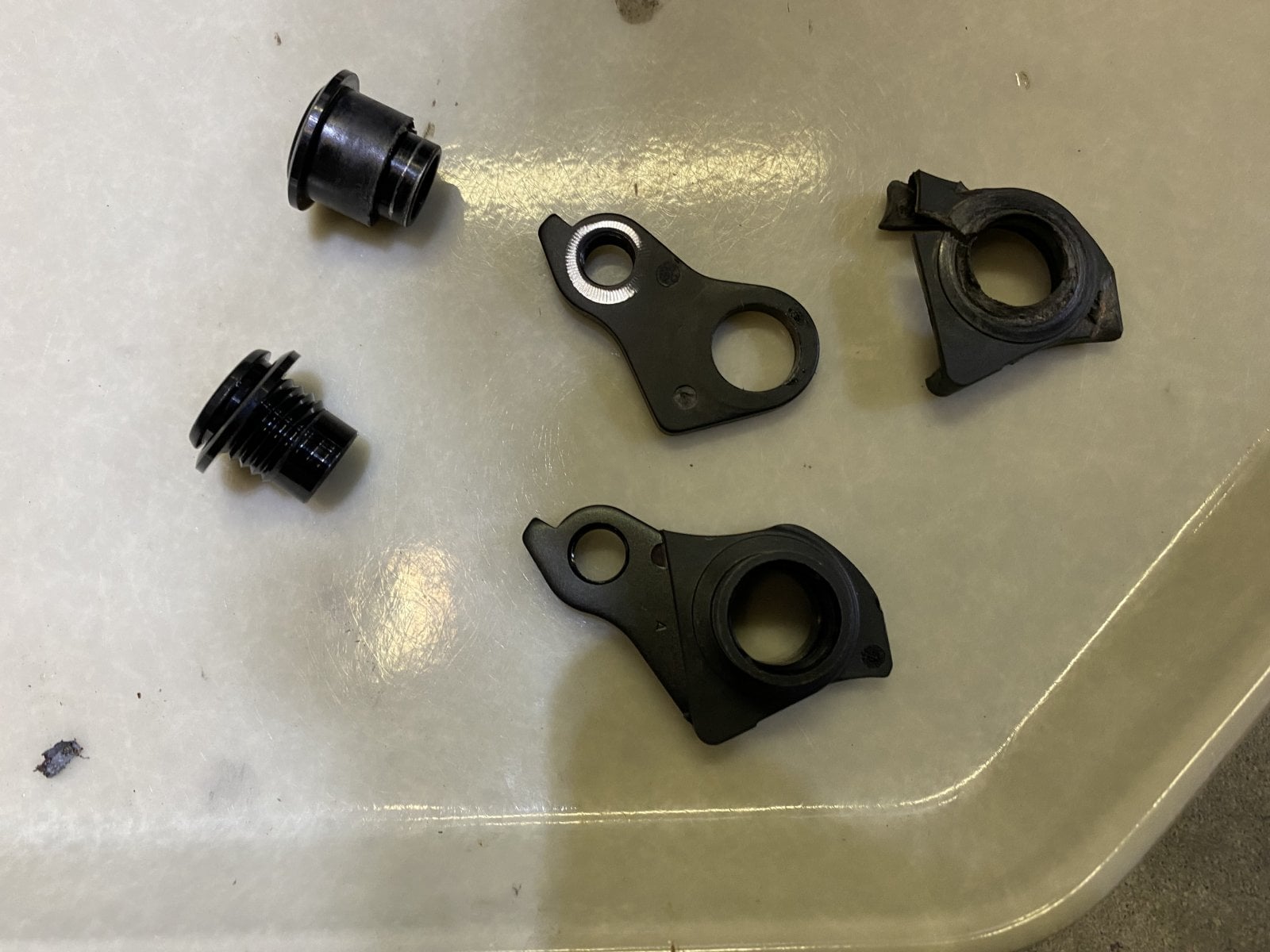

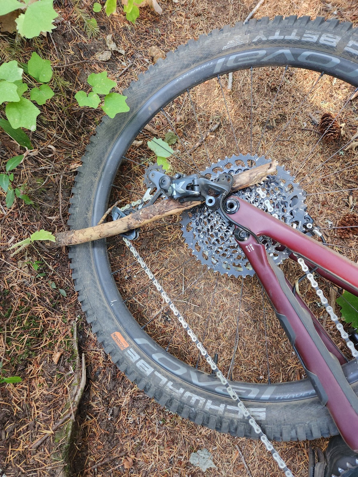

Specialized Gen3 derailleur hanger for SRAM bikes-just a note. Maybe this has been covered before but I could not find it discussed. I have a Gen3 Levo Pro which has been totally reliable. Last week I was riding and something got into the back wheel and bent the hanger, broke two spokes, and flatted my tubeless tire. I went looking for a new hanger and ran into a wall. Could not find the part anywhere. It was a two piece thing with one piece being a rubber boot that fit over the other piece. I think the part on my bike has been replaced by the SRAM Universal Derailleur Hanger which is easy to find. See the attached pic. Top is what was on my bike. Bottom is the new part. Just in case others have this two piece part and get confused like I did:)
Just had same problem. At least 3rd time
Is the replacement shown the SRAM UDH? I have the same frame and should probably pick up a spare….

But the bike is eating rear shocks.
First X2 Dead After 1200km
Second X2 worn Body After 2500km
Third shock dead
Now im going to Switch to another bike, i think.
Love the Levo, Love the feeling. But i dont want to sit and wait for shocks to come Back from Service.
Third shock dead
Love the Levo, Love the feeling. But i dont want to sit and wait for shocks to come Back to Service.
I blew up my X2 during the first 100 miles🤣😂 I’m running the cascade link and the EXT storia now, so far so good but I’m waiting on it to blow up too.

Same here blowing up shocks on the gen 2 though they might have sorted it with the gen 3 but no one mouth in on the comp knocking coming from the shock that rear end is a bad design or they should put a shock on that can cope with some abuse

My X2 shock started leaking air almost immediately during the ride as well before six months of use. Sent it back for warranty just recently. Bought a Rock Shox deluxe ultimate RCT and couldn't be happier with it. Bike is more balanced with front fork. We'll have to see how long it lasts. I like it better than the X2 which never felt good from the very beginning even with the proper adjustments for set up. Tried the specialized settings for my weight for the X2, as well as the fox recommended settings and multiple variations from these with no improvement. I love this new shock.
