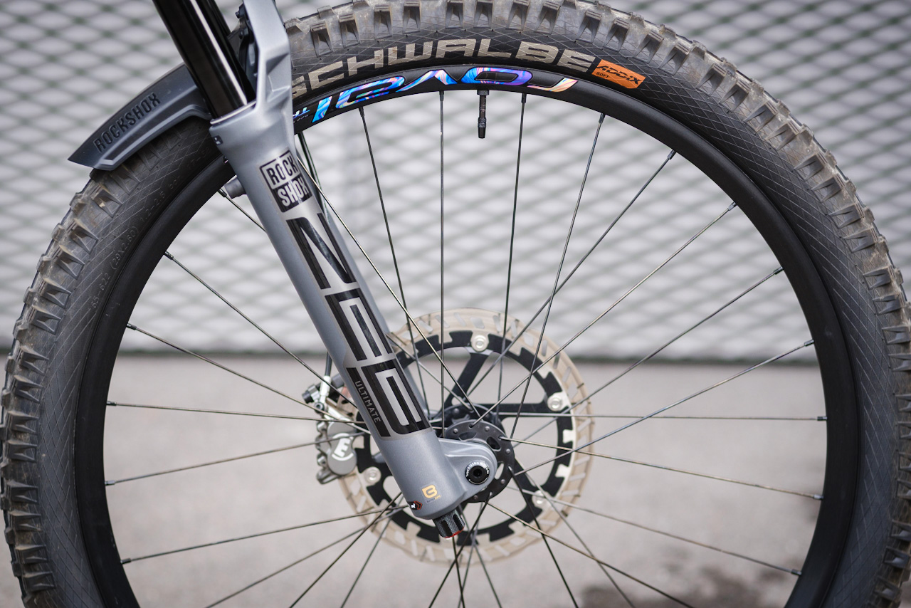

Mounted the Argotal DH SS/Kryptotal DH SS today. Yes, they are heavy but I was riding along in Eco mode anyways so a litte extra weight doesn't hurt, as my battery lasts for ages.
With these tires and the EXT setup this is a beast! Grip for ages!

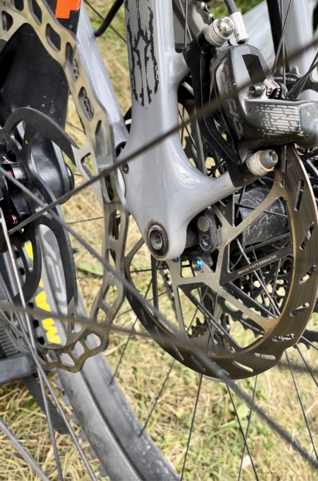

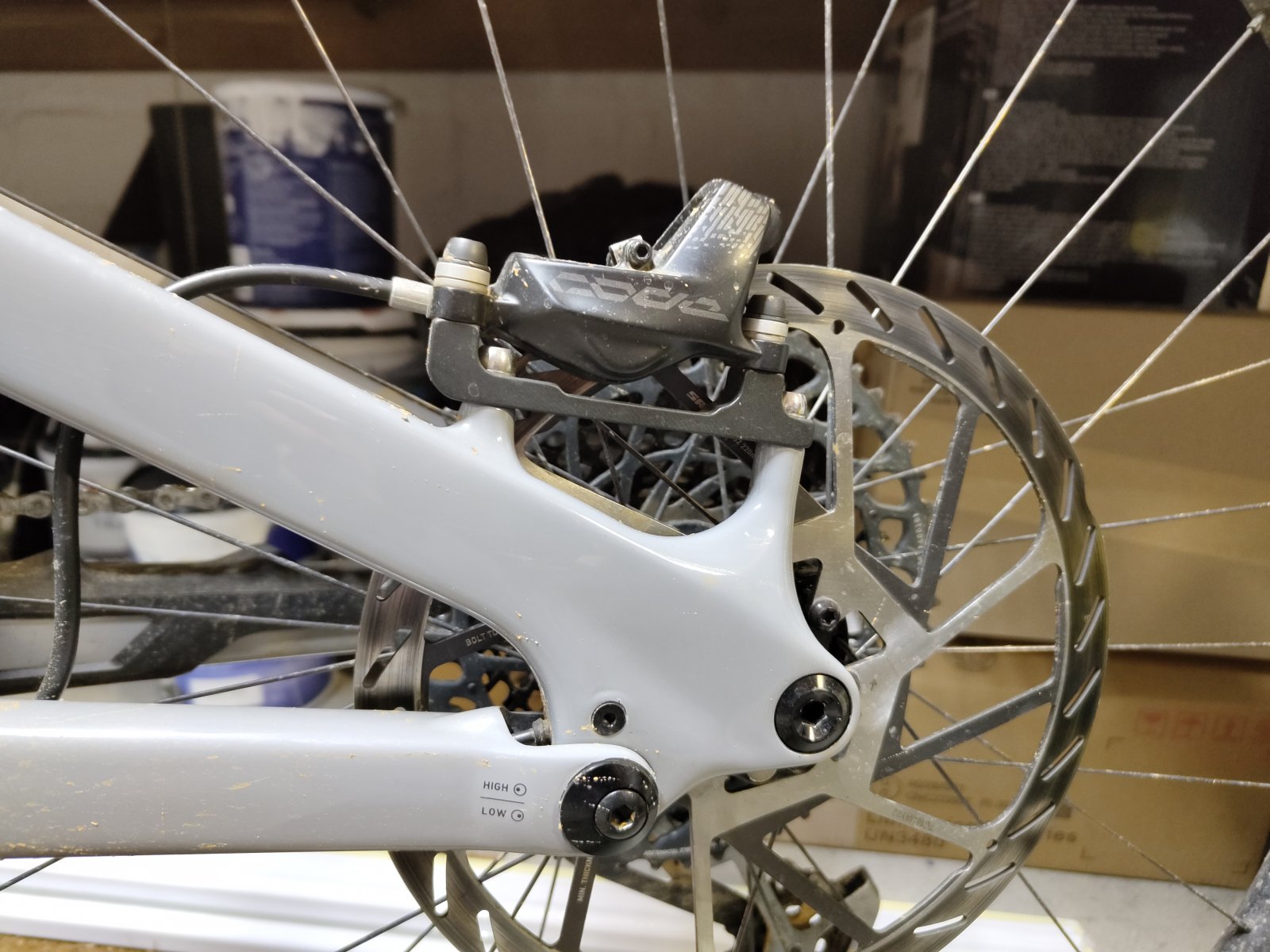

Keep in mind, that Sram HS2 heat management is not so good. After spending 6 weeks riding in Alps this year here is a picture of my bikes and the rear brake rotors. Galfer rotor is like a new and Sram HS2 not, although I was riding the one with Galfer rotors more.
the HS2 heat management is way better than the stock centerlines, I have zero fade with the HS2 where I got major fade with stocks after 1 run. And, your picture above is comparing a front rotor with rear
Did you get any fade with that? I don’t care if my rotors look used after 6 weeks in the alps, I care of the brakes keep working
Small amount of fade, but not bad. Just colour change, which proves that the discs were really hot. However, I thought I would ride them as long as they last.

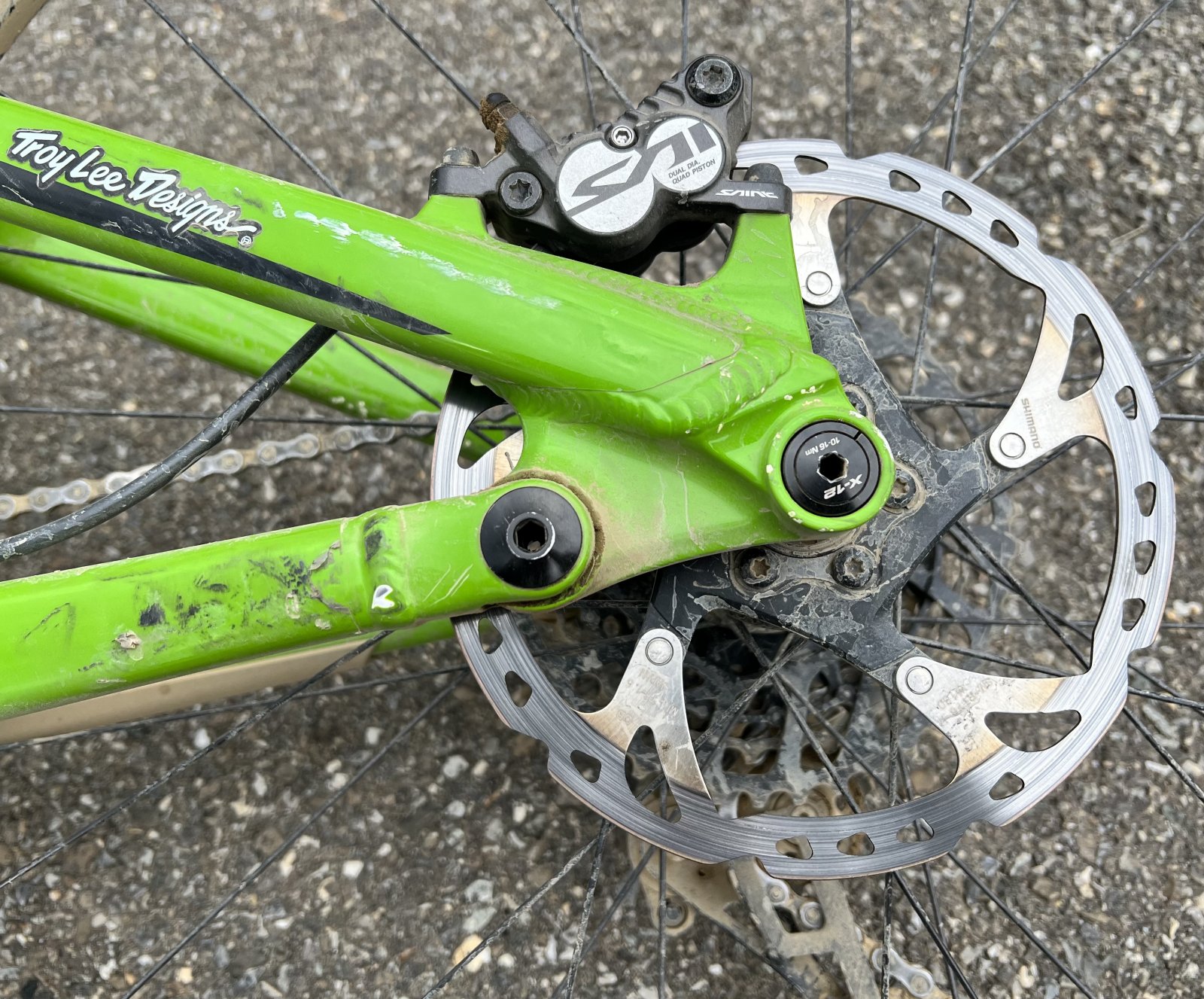

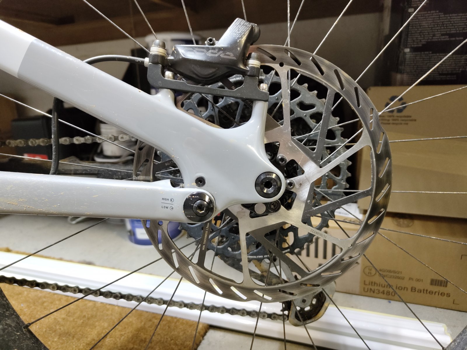

The rear rotor on my non-ebike currently looks like this, dont see this as something to worry about until braking performance is affected:

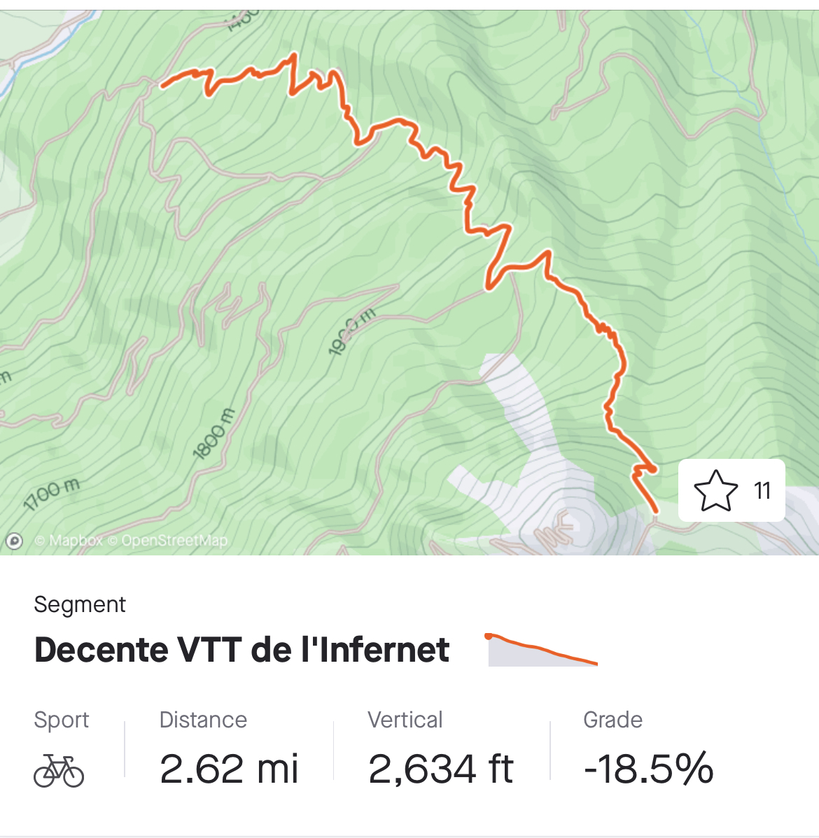

I don’t for the UK. I used to be a big Shimano fan, but 4 years of riding the codes on my OG Kenevo has really made me appreciate the modulation of the Codes (and the fact I haven’t bled them in 4 years and they still work great).
I dug my regular bike out and rode it on my usual trails at fod (steep tech) and kept locking up, and genuinely came away wondering why I had ever fitted saints. Then I rode in the alps, doing trails like this one, and the saints make sense. Will probably be going back to XTs on that bike for the UK.

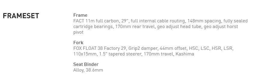

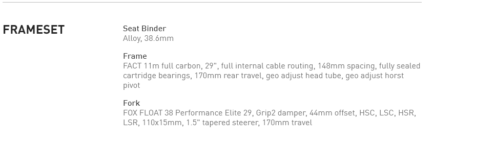

Is there any difference between the frames for the S-Works, Expert, and Comp Kenevo? With the SW frameset costing $8.5k and the Comp whole bike costing $9k, it seems like there must be something better about the SW frame beyond the shock (about $200 delta between the X2 and Float X performance). But frame description looks the same on the Spec website:
S-Works: vvv
Expert: vvv
Comp: vvv
S-Works: vvv
Expert: vvv
Comp: vvv
Well... you obviously missed the most important difference... the S-WORKS sticker and all the bragging rights that come with it! I am not really sure what the S stands for other than Sucker. Then again, I can make my own stickers :D.
Oh... they also throw in a Range Extender for that price too :rolleyes:
Sid Duffman
Aug 23, 2022
11
17
San Jose, CA
Lol, of course, how could I forget the bragging rights!?
I can't find the post now, but I assume you're the one who put on the Knolly stickers. Really loved that! I might have to do something similar when I get one.
