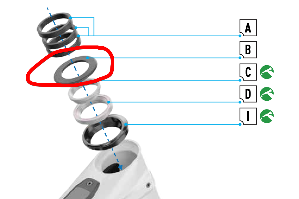

hi guys, I have a question about the headset. When I bought the bike I was given two added conical spacers. What is the difference in using these conicals rather than the standard ring ones? (beyond aesthetics) Is there any substantial improvement or difference? Thanks

Just aesthetics, you can use those if you don't have enough or right amount of spacers. Nothing else. If you use conical spacers, just remember to remove this number B spacer (marked red in picture)
Those are just aesthetic, although there exist version on market that claims performance :- )

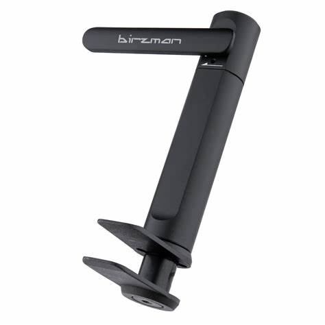

I had to pull my shock out for service this week and could not figure out why it would not go back in as easily as it came out. Is there some special trick to getting the bottom end back in? I know it has to be a tight fit with all those bearing bushings and spacers but I am sure there has to be a better method that the way I ended up getting the shock back in!
I used one of these on my mates KSL when I changed the spring on his Ohlins coil the other day. Didn't take much pressure at all.
