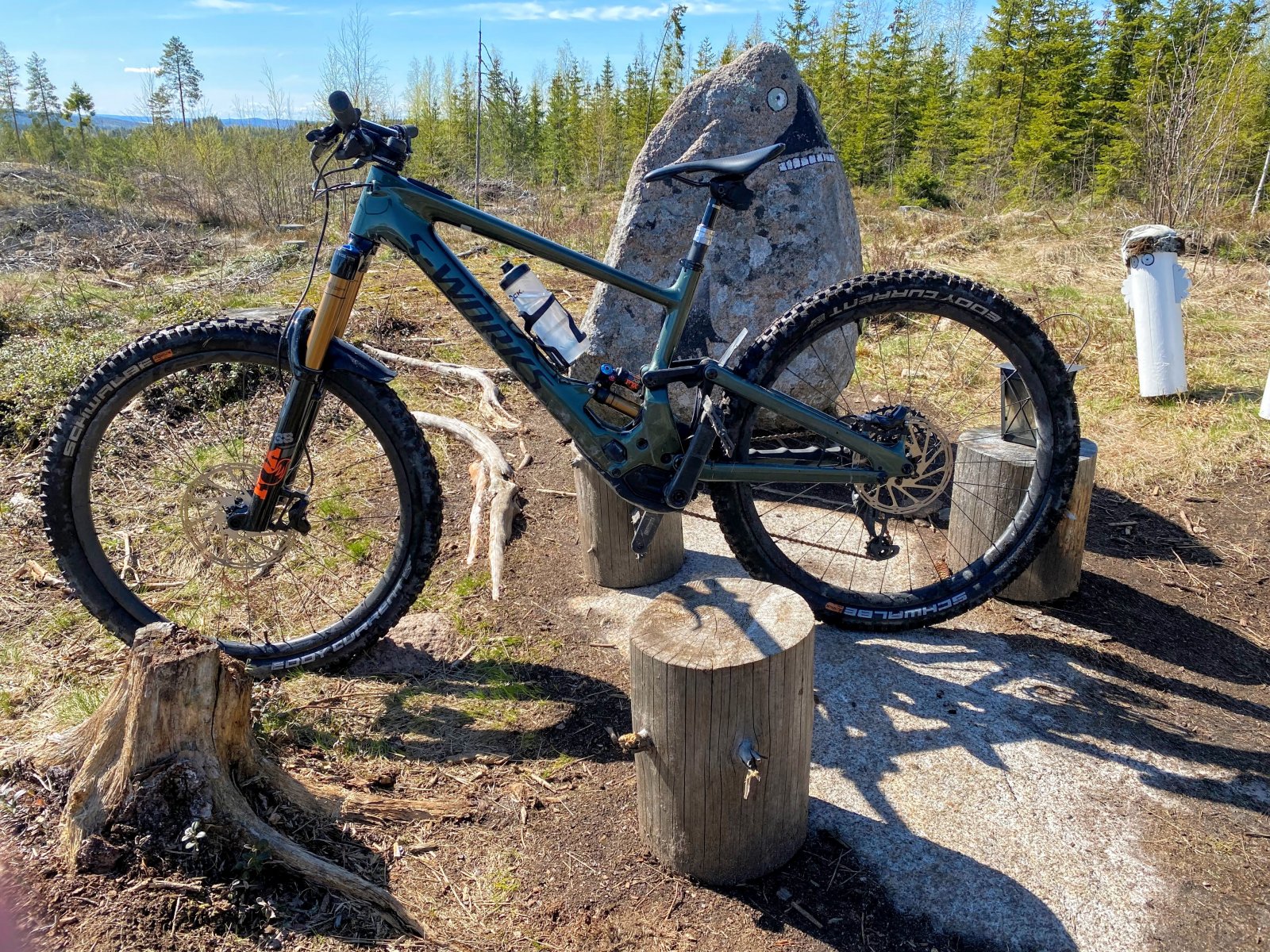

Finally the snow has melted and weather is little warmer:). New set of Eddy Currents and tweaking the suspension last two weeks and bike finally start to feel planted. I'll swap the the X2 to E-storia. Hopefully I'll get it soon.
