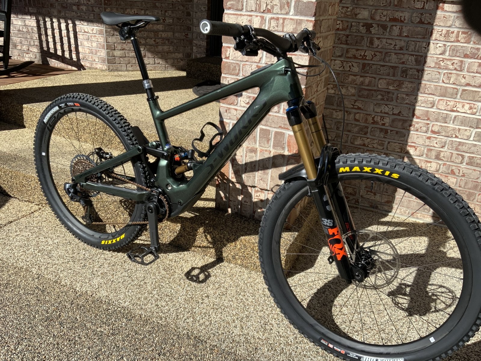

Beautiful ! Exactly aesthetic I went for with my KSL build. I deliberated for 2 months which frame to use, pure-black Comp or the S-Works.
No competition, the S-Works is the most stunning, but I see I was right with going comp for me.. even in stealth build, the logo "screams" :- ). For someone like me, that's too much, but for someone who has the swagger for it, all the power!
The current Fox stickers are kind of generic, I would think of swapping them for some custom lettering to better align, for example the Heritage (in white of course) was much nicer. I think pure "38" in big letters like old Marzocchi 66 would be also badass :- )

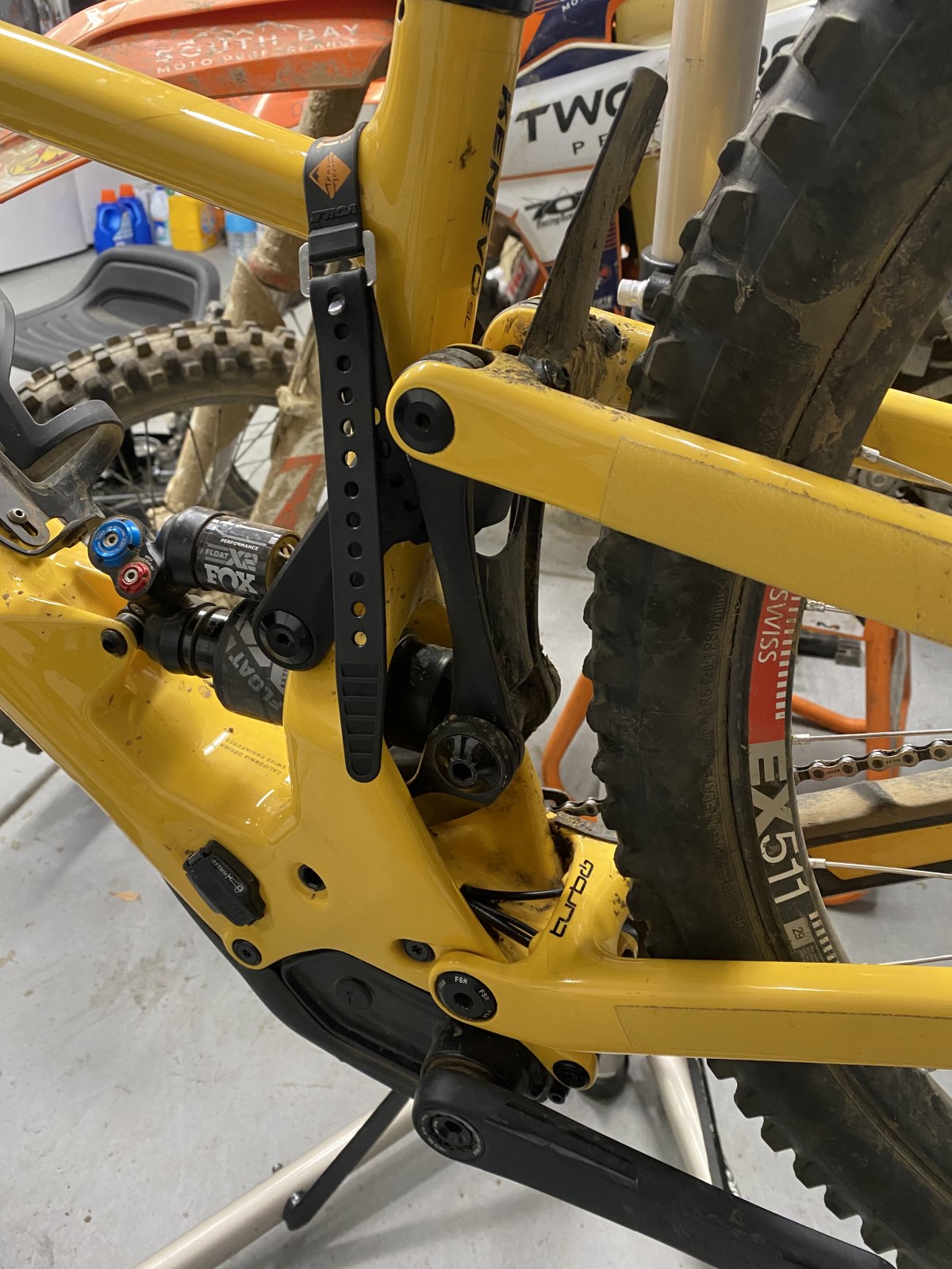

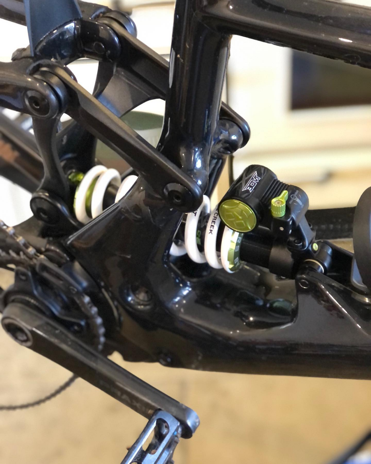

I've had the shock for a while. I took it off my Rail today and fitted it to the KSL.

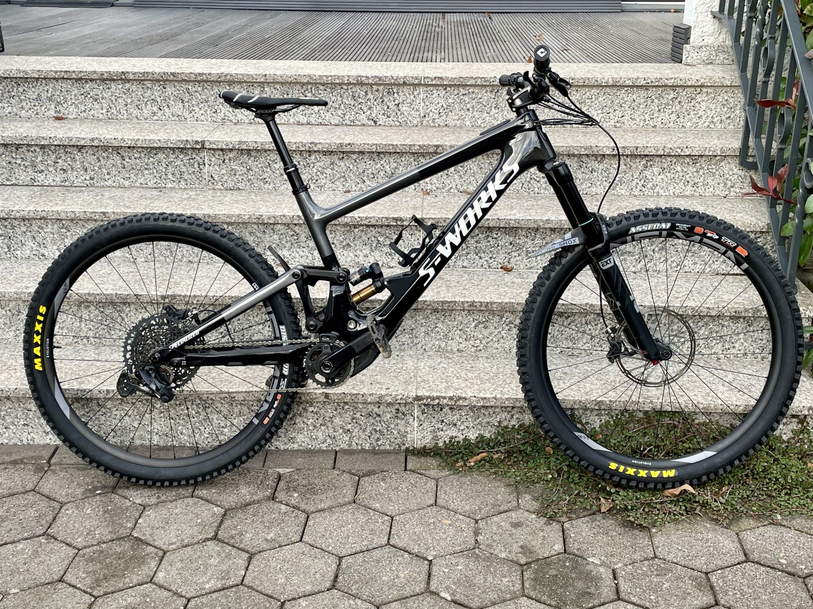

Thought I'd join the party with a coiuple of pics and some thoughts on my S3.
Coming from a Large Levo SL I was expecting to want to run this bike Mullet as thats how I got my LSL to trun and behave in a more lively fashin, but after experimenting I definitely prefer it 29x29 unless, I do a shuttle day in the super steeps and the I'll throw in the 27.5 but generally leave the bike 29x29 and high/steep.
I quite like the trail feel it gives, its similar (ish) to the Levo SL which I really loved but found it got a bit wayward in the rear end when pushed hard, hence, I bought the KSL..
Rather than buy an S-works at the silly money they want, I built mine from the ground up on a Comp frame with Line pro 30s, Zeb Ultimates, PUSH 11-6 (475lbs spring - I'm 88kg) full AXS, One Up bars and Deity finishing kit.
I read some previous comments about the rear feeling a bit more lively than the front and can agree when it was on air, but as soon as I added the 11-6 all that went away.. I run the open circuit on soft DH and the firm circuit in trail and its just a revelation of a shock... And it's only 300 grams more than the float X... WARNING.. I tried to fit a Factory Float X initially but the compression can is longer on these than the non compression Float X specialized spec.. The factory will hit the seat post arch, they need to be modified...
As for brakes, I pondered this a lot, but for familiarity and convenience when with Code RSCs, (or course with oilslick bolts lol) I just can't fault them...
Praxxis 170mm carbon crank arms and XTR trail pedals..
Tyres are Maxxis, 2.5 Assegai EXO+ Maxx Gripp front, 2.4 Dissector EXO Maxx Terra rear with a Cushcore
XX1 Chain and cassette...
All up it goes 19.4 on the scales, with pedals and I have to say I'm really really happy with it..
I have struggled with the Zebs and have to say after my Lyrik Ultimates am disappointed so far, have tried 1,2,3 tokens and various pressures from 57 to 76 and have not been able to find the sweet spot with enough support but a subtle top end, so have ordered a Vorsprung Luftcappe to hopefully sort them... They have either felt firm with good mid stroke support when decending and no small bump compliance or soft and divey if I run them compliant for small bumps....
What else? wheels, Bonty Line Pro 30 carbon.. teyre great wheels and at 1750 grams are stupid light fo the performance they offer, plus, if I smash em I have a two year replacement warranty and lifetime manufacturing...
Have been riding MTB properly now since my late 20s... I'm an "enthusiastic" rider but at 52, know my limits... I could never want for more bike now... Infact, maybe she's got me into a trouble already a couple of times lol.....

Hei Stumpi, I am fellow KSL + ZEB Ultimate rider, here is my setup. I had multiple ZEB forks, in fact it's my most favourite fork after long line of Fox 36 Floats of every assortment and generation. But what you write is kind of true.. it's bit of personal preference.
On my lighter Capra29, I run (I am 177cm and was 86kg then) 64 PSI, LSR 9 clicks from Closed, Compression fully open, stock token on 170 (I think one).
On KSL I did the same but I couldn't run it much because of COVID complications... and I am bit heavier at 88kg now plus the bike is heavier so here is what I will alter in following month:
I will probably go up to 68-70 PSI and ZERO tokens. That has been preferable setup by lot of pros, including the BlisterReview guys. This fork is wallowing when run at lower pressure with tokens.
For me the small bump compliance is excellent, but it's not apparently as stuck to ground like Fox38. Why I didn't like 38 more, is that in exchange, 38 runs bit lower in ride-height, requiring higher cockpit setup. I don't like that really, even if it means superior small bump.
I run aggressively on front, and want my fork to stay really high in travel. ZEB has already such big negative that I am not sure if Luftkappe will do much for you, although the little-can they sell would.
But it sounds like you might be more of Fox38 kind of guy. Or EXT.
Hey, thx for the reply,
I'm definitely not a fox guy, have run, Revs, Pikes, Lyrik and now Zeb since 2010.. I love the way RS forks ride.
On my Levo SL I ran Lyrik Ultimates and simply loved them, they were literally set and forget which is what I was expecting with the ZEB, hwever thats not been the case, I've even been tempted to go back to Lyriks on my KSL given how good they were previously.. A lesson learned for me I guess..
I'll try your setting with zero tokens, its not something Ive tried yet... As for the LuftCappe, there are a few reviews on YT suggesting its a great mod, one particular guy seems to have gone through my exact scenario and it helped him...
I'll update when I have it fitted...
Thanks again...

Given that you tried going as high as 3 tokens, you might perhaps do benefit from Luftkappe in different way that I used it previously ( I needed to make old RC2 '18 36 softer of the top). The ZEB Luftkappe is so massive that it takes the volume of token or two by itself. If you keep the pressure as before (or even add a bit to compensate the increased (well...lowered) sag point) it should be lot more progressive without harshness.
But then again... internet reviews of "I bought expensive tuning feature" are full of placebo "suddenly everything is amazing!".
Now I am kinda curious. Do you have the latest (2022) version of ZEB? It has different air-shaft already, domed on top.

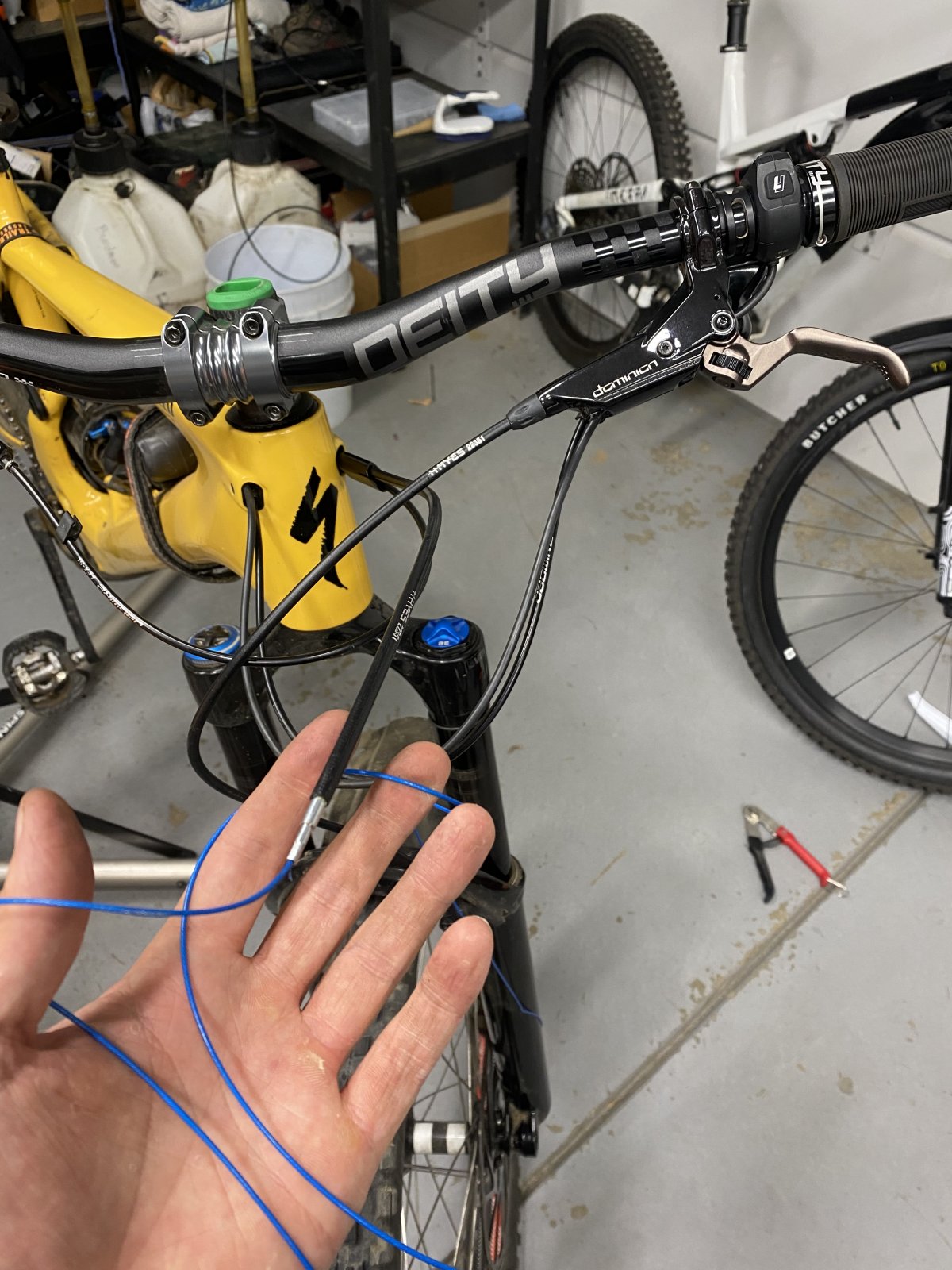

My local bike shop told me that to do the rear brake they were just removing the air from the shock, and with the suspension compressed it was “super easy” to route the rear brake above the motor. I have a set of Hayes Dominions I’ve been wanting to put on, but have been procrastinating. Will update how it goes for me. Lol
With the help of the park tool hose routing tool, and letting the air out of the shock, getting my new brakes routed turned into a 10 minute job with zero struggle. (Now bleeding them was a different story, lol). Did not touch the motor or battery.

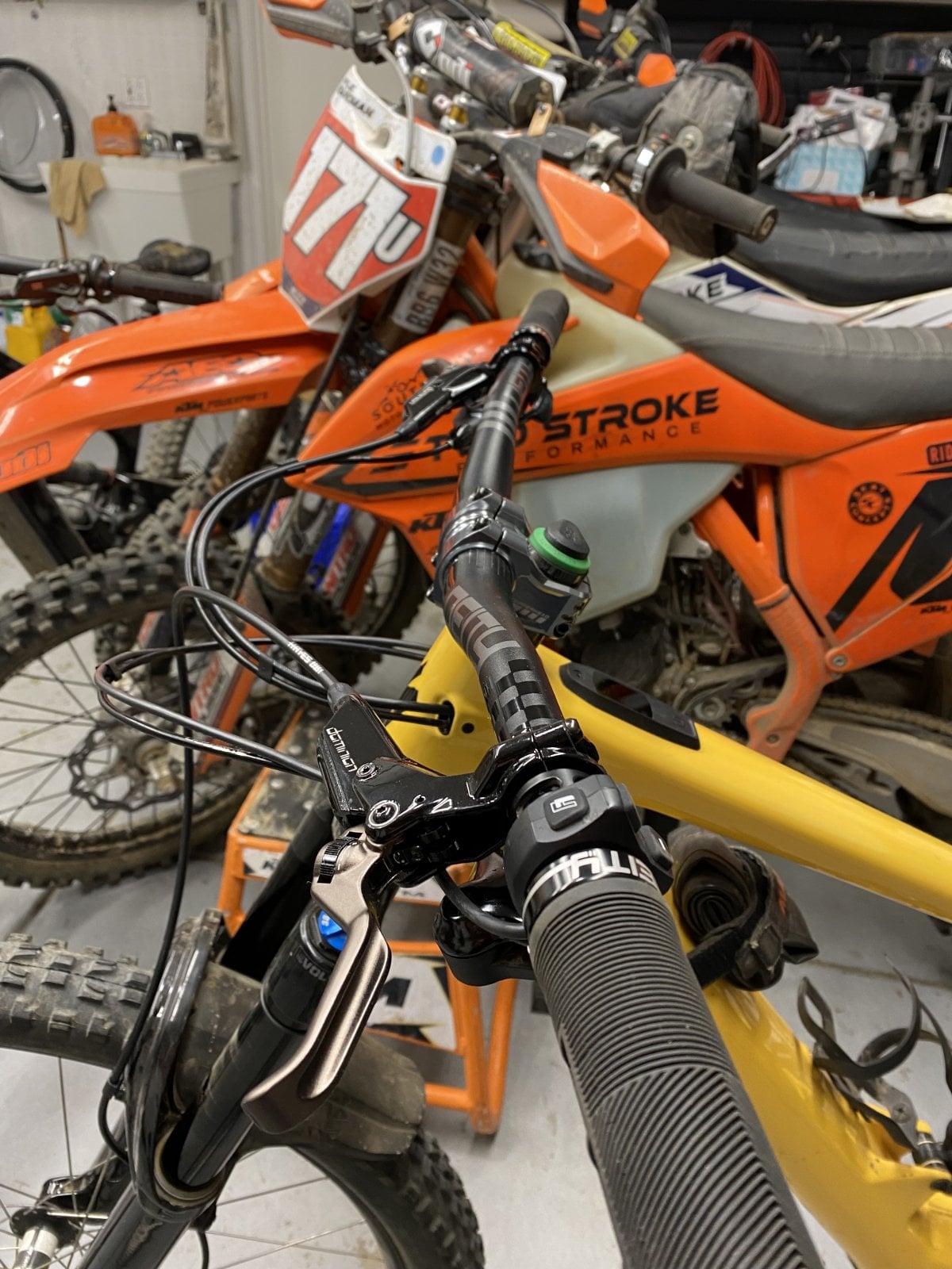

Cockpit finally set up the way I want it (for now) with the Dominions, Deity bar/stem/grips, the skinnier non-matchmaker clamps, and OneUp multi tool. Would like a wolftooth dropper lever, but that’s purely luxury as the stock works fine. Also the cables are a mess, but unless I got AXS I think this is as good as it will get.
How do you find going from moto front brake on the right to mtb front brake on the left?
Also, not to encourage you to spend more money but the Wolftooth dropper lever is such an improvement over standard. Money well spent imo.
rb.
Apr 27, 2020
388
262
San Jose, usa
I ride mtb and moto for the last 20 years and never once had any issue with the brakes being different. Now that being said, I always disliked owning 2 mountain bikes at once because I could never get comfortable on bikes with different geo/sizing. Especially going between ebike and normal bike, would throw me way off and take half the ride to get comfortable again. I know, first world problems. Lol
