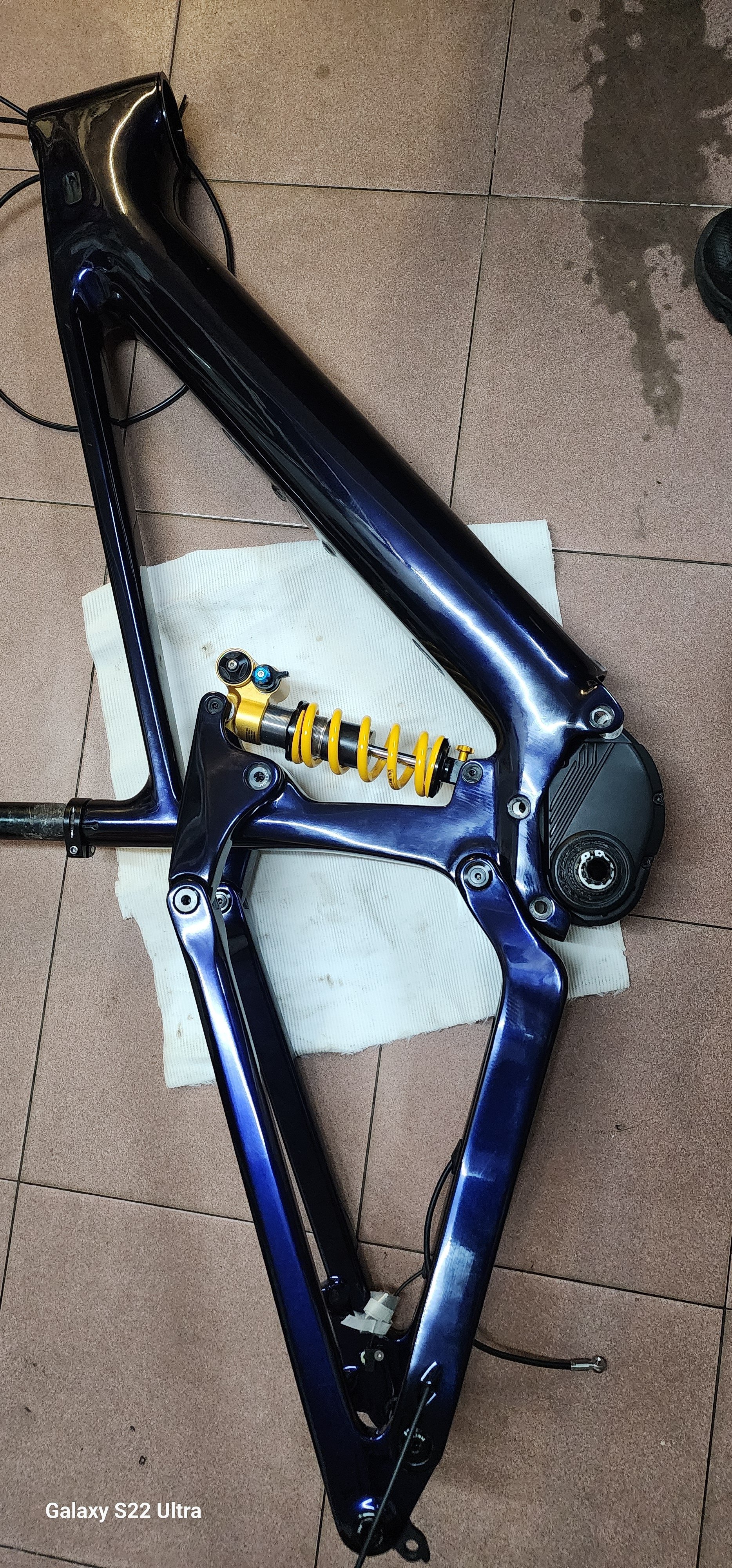

48v 480wh

I paid my deposits since September until December only able to shio out cause fram shock mount positions mold mod. Then special request for T800 carbon upgrades and wait another few weeks.

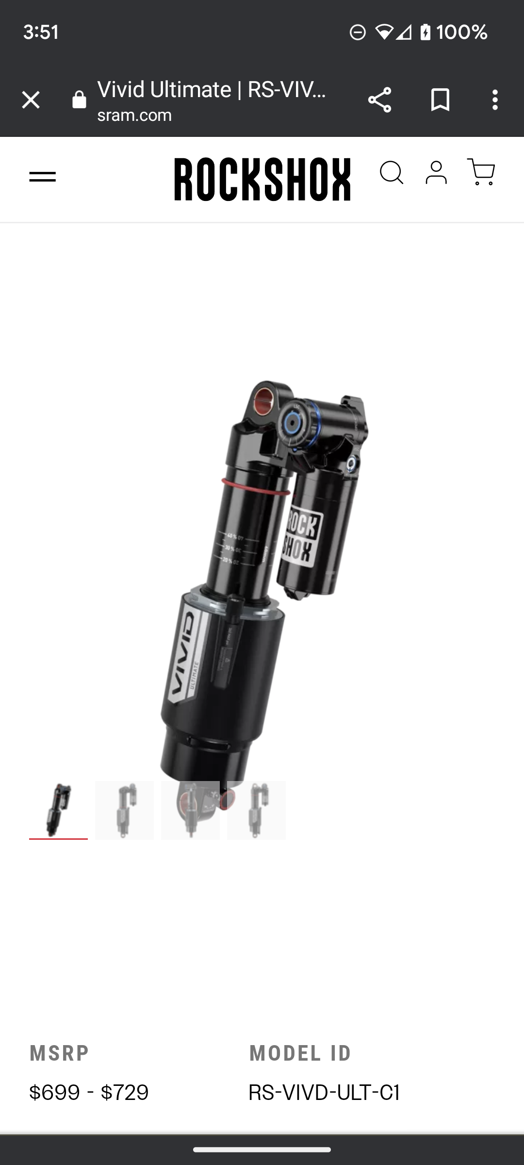

Sorry I'm sick, so not thinking straight... Maybe the new Vivid Air next?

I used an „old“ Vivid air with my E10 and it was a very very good shock, coilish 😊 and plush. If You get a good offer, give it a try!
Ha thanks! Better to go new! But it looks like the new Vivid ultimate'23/24 has too big of a E2E for my risk level.

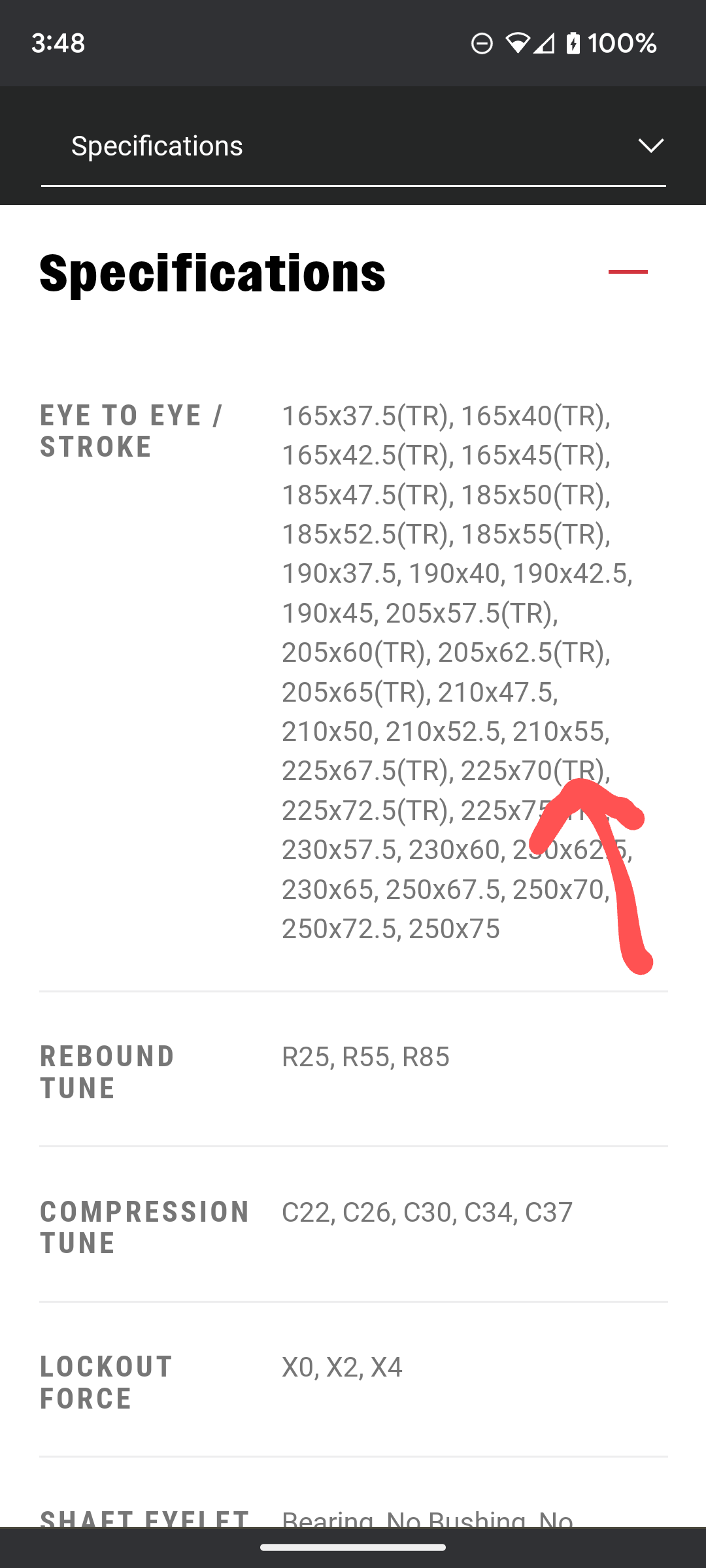

Oh wait! I had the wrong spec page. There's a 210 x 55...perfect! I might try one next year!
But wonder CEF50 V.1 will fit it. Peeps had probs fitting the Fox Float X2. So...maybe not!🫣
