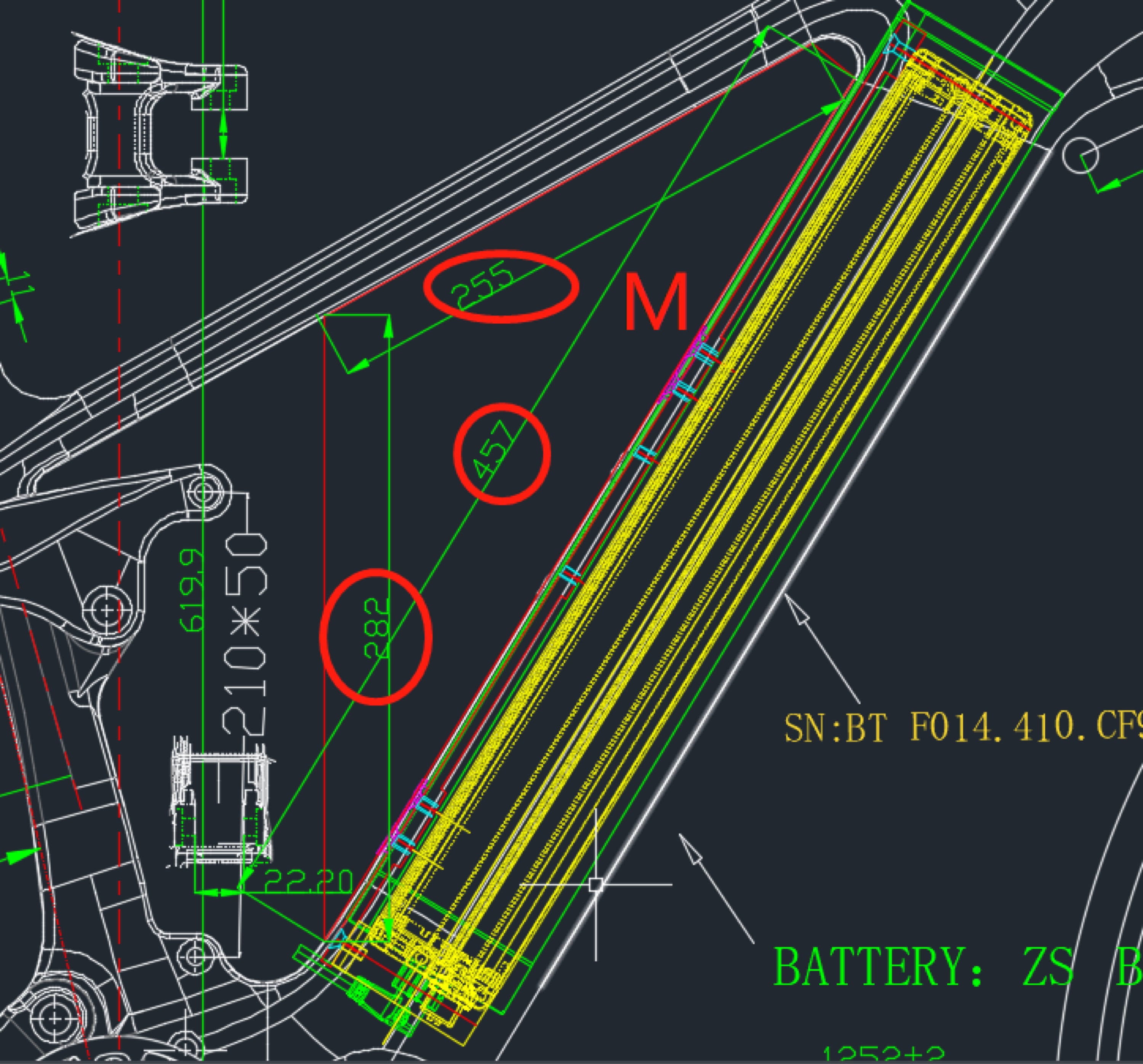

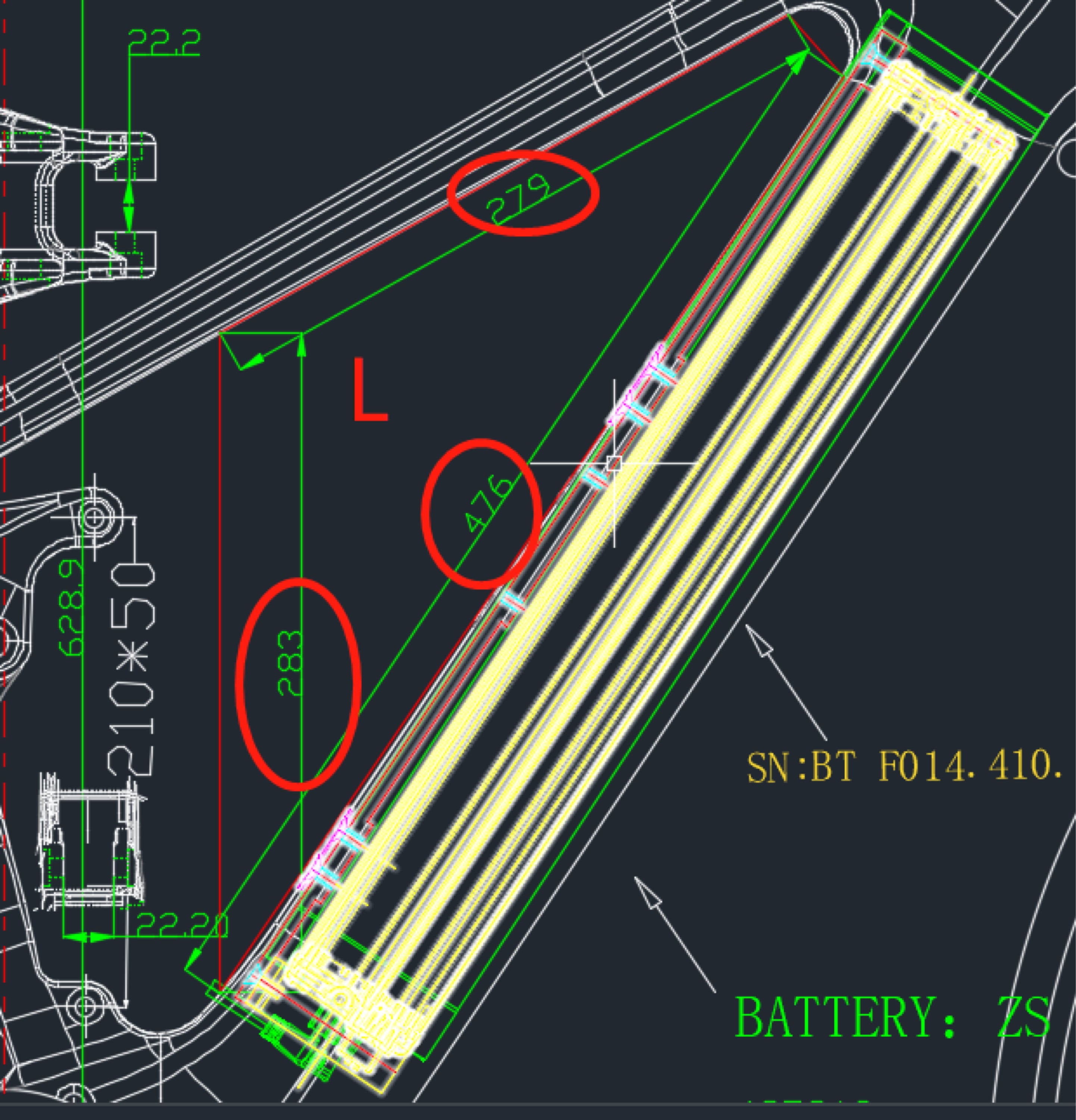

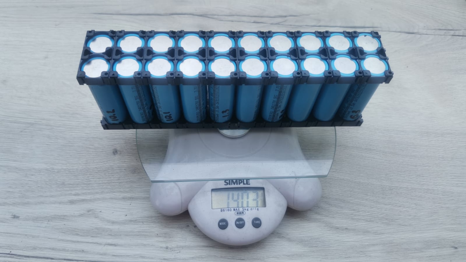

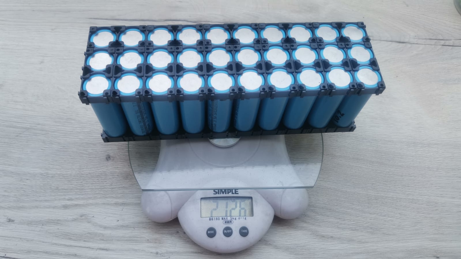

If you want to install a battery in your handbag and reduce the weight of the bike by another 1 kg, see the size of the empty space for the bag.

So 410Wh: 1.4 kg (21700 cells) +1 kg (plastic case) = 2.4 kgs/5.92lbs
And
720Wh: 2.13 kg +1 kg = 3.13 kg/6.9 lbs
you made a typo, 2.4kgs is 5.29lbs, so the difference in weight is a bit greater
I'm about to pull the trigger on an order... chatting with them and they told me the 410wh is not an in house battery of their own. The 410wh they will sell is the Bafang BT F014 which weighs 2.6kg's. They also reiterated to me that their 720wh battery weighs 3.8kg. So there is 1.2kg/2.6lbs difference between the two.
Tbh, I'm on the fence on which to order. 2.6lb is substantial, but the extra range and power the bigger battery gives is also substantial. hmmmm.
oh, also I asked if they can supply an empty battery case for DIY. Answer is yes and it's $44USD

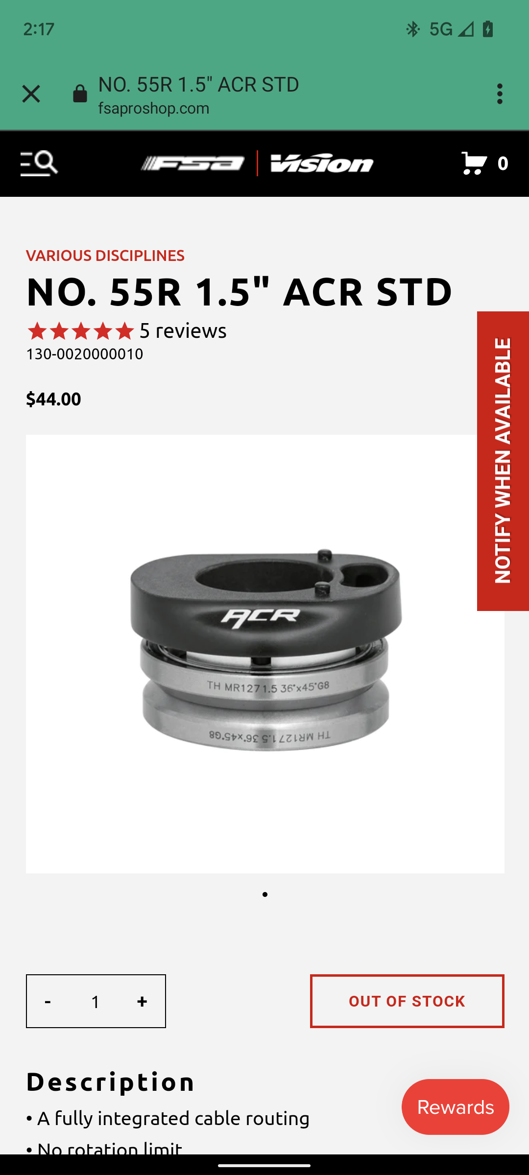

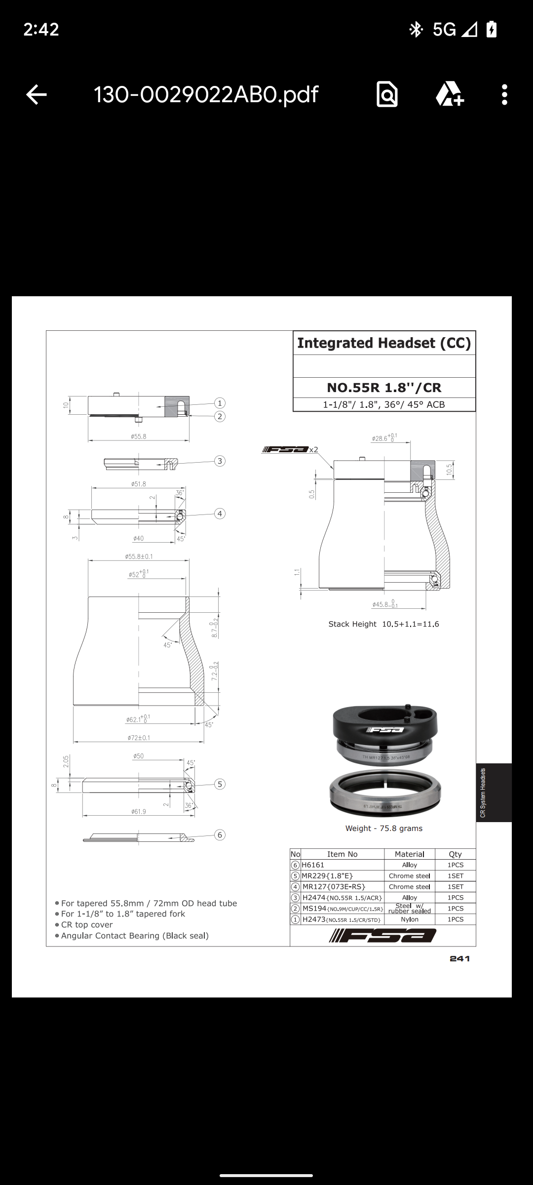

TCFlowClyde
Feb 26, 2022
1,361
887
Mesa, AZ

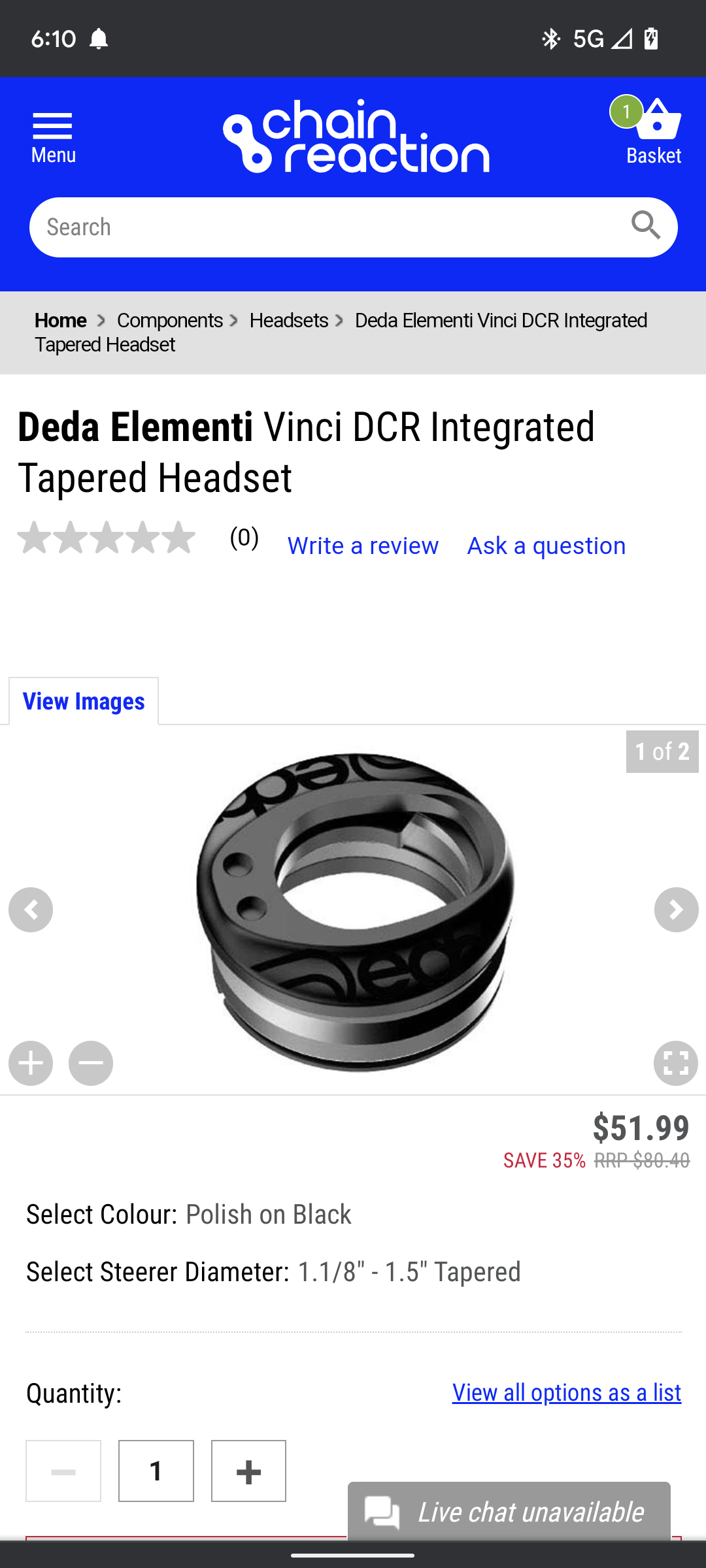

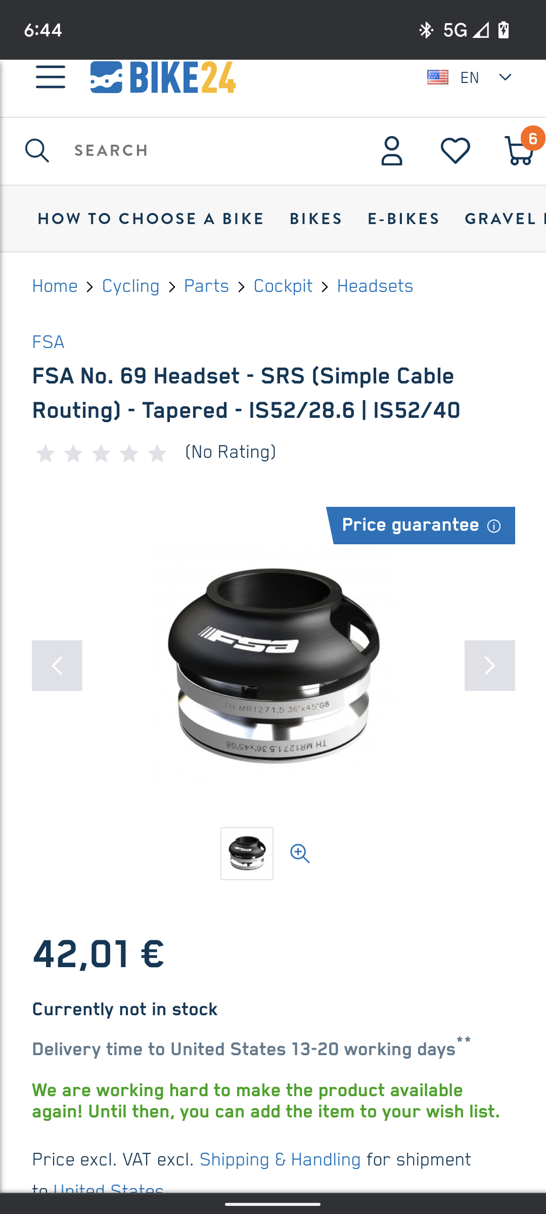

I've never built a bike before. What is the headset 52 mm / 66 mm piece indicate? Which headset piece can I purchase? Cause it seems they come with different sizing (Cane Creek 40 IS42/28.6 IS52/40 Short Cover Headset). Is there a headset you guys plan on purchasing?
It's an internally routed cable (IRC) headset for the upper...frame manufacturer specific apparently. Probably lower grade for CEF50 frame and will junk most of it. Unfortunately, no Chris King, Cane Creek, or Wolftooth makes them for mtbs except for a few smaller road headsets. I spoke to each a few weeks ago.
FSA has one. Ritchie as well. But
I also found Nukeproof's ICR for their Megawatt E-mtb...might be a better alternative. Or a Deda looks cool.
First, I was just going to stuff as much CaneCreek 110 or Wolftooth Premium internals that will work with the stock upper headset and see what works.
If not buy the NP or Deda.

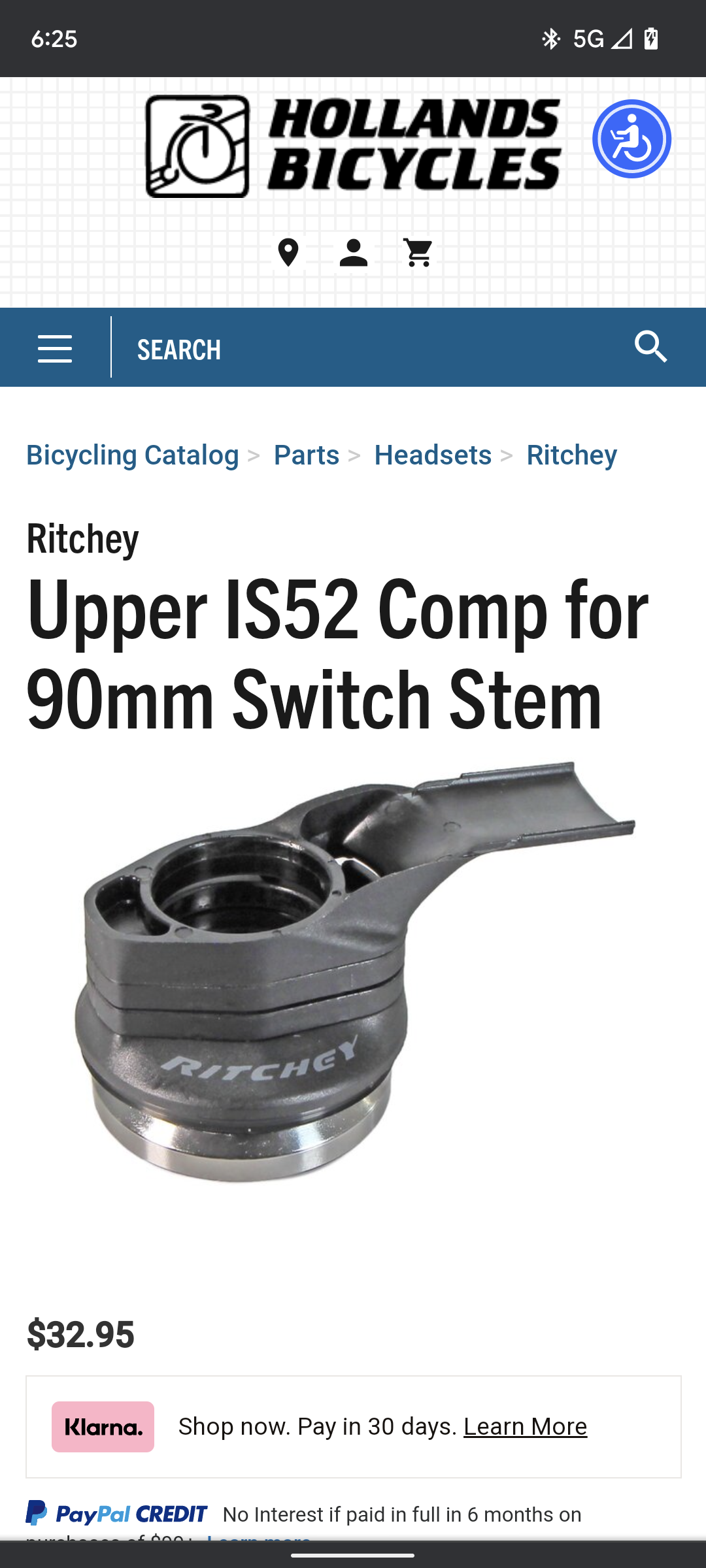

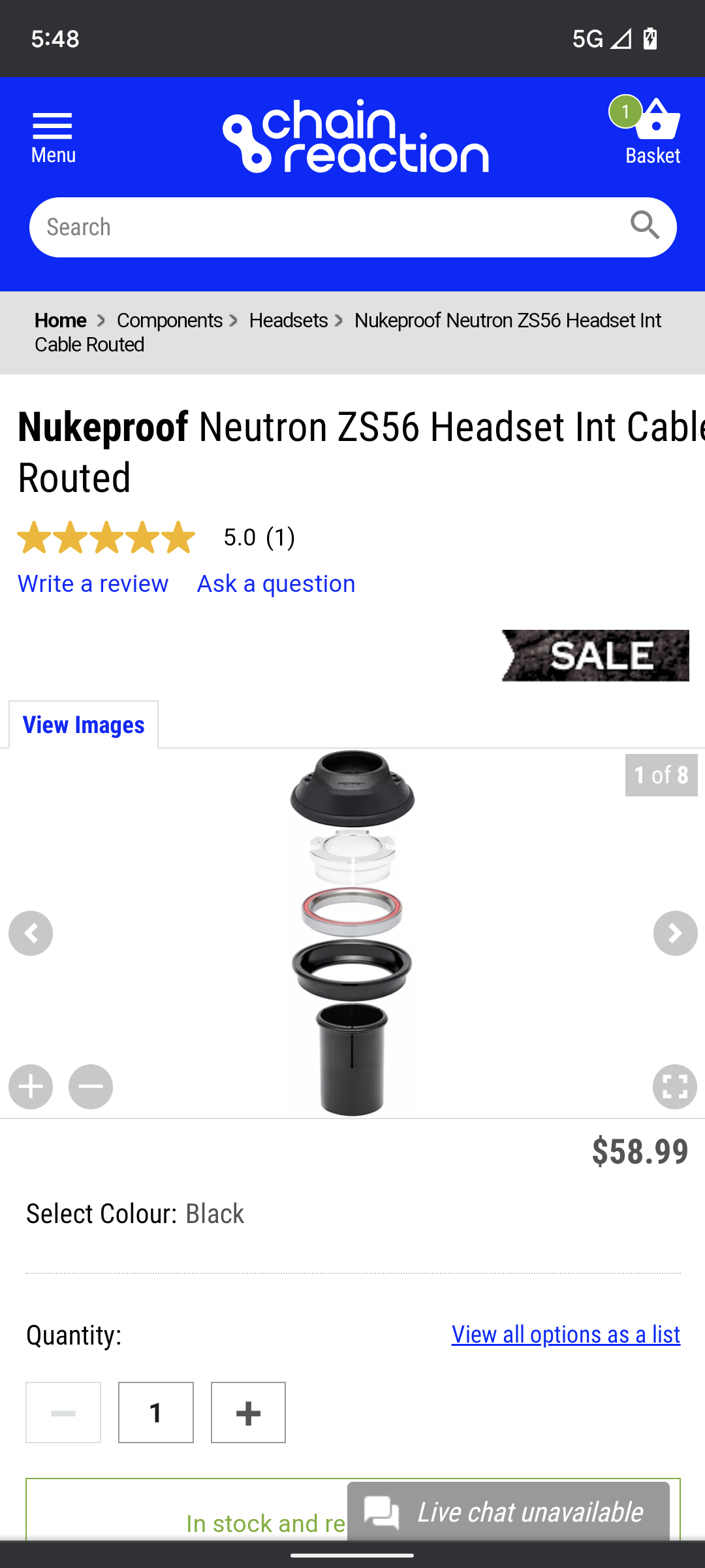

It's an internally routed cable (IRC) headset for the upper...frame manufacturer specific apparently. Probably lower grade for CEF50 frame and will junk. Unfortunately, no Chris King, Cane Creek, or Wolftooth makes them for mtbs except for a few smaller road headsets. I spoke to each a few weeks ago.
View attachment 106406 View attachment 106407 View attachment 106408 View attachment 106409 View attachment 106410 View attachment 106411
Oops! Looks like Deda and Ritchie are the only 52 out of the whole bunch mentioned previous.

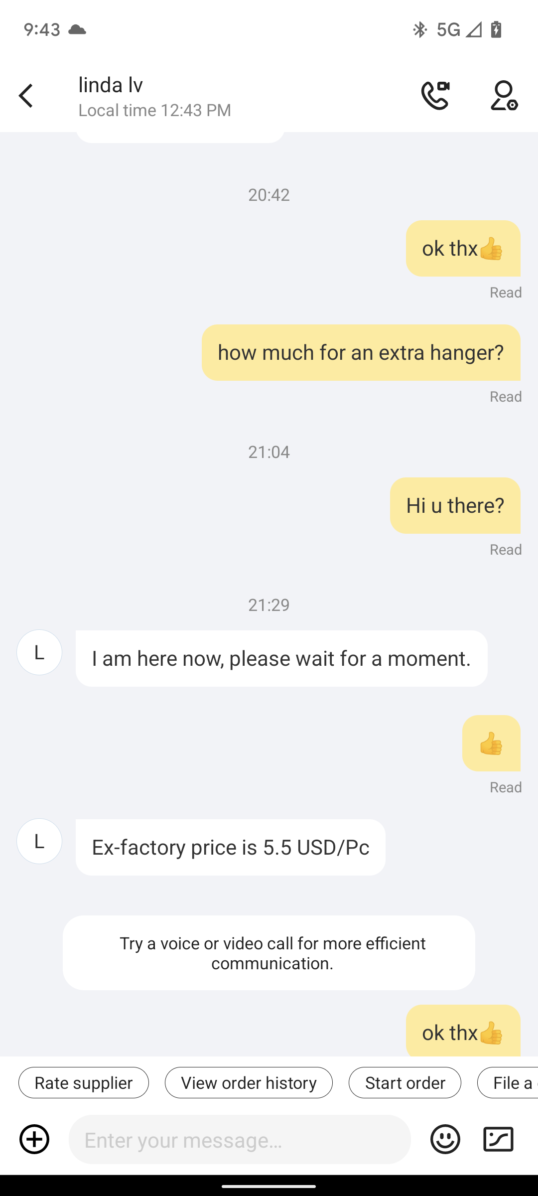

Love that you are always 2 steps ahead of me haha. Just asked linda and she confirmed thats all Included!
Confirming your confirmation👍...now I'm asking how much is spare hanger.
Update: $5.50 each USD for spare derailleur hangers.
