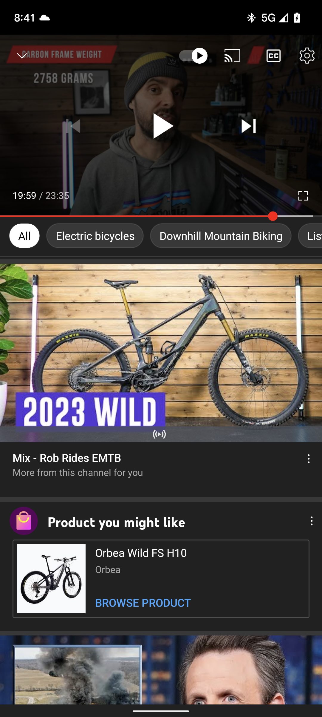

2758 g is the Large carbon frame weight for the new Orbea Wild full-powered rig. It too has no cable routing ports and is internally routed cable headset, integrated 760 Wh battery (motor drop access) to save weight. 😲
So, very comparable to the CEF50 in stoutness. BTW this was posted on Rob Rides review today...🍻
I'm still waiting for Linda to give a Large frame weigh-in pic. Hopefully, this will quell concerns over frame integrity/robustness potential.🍻

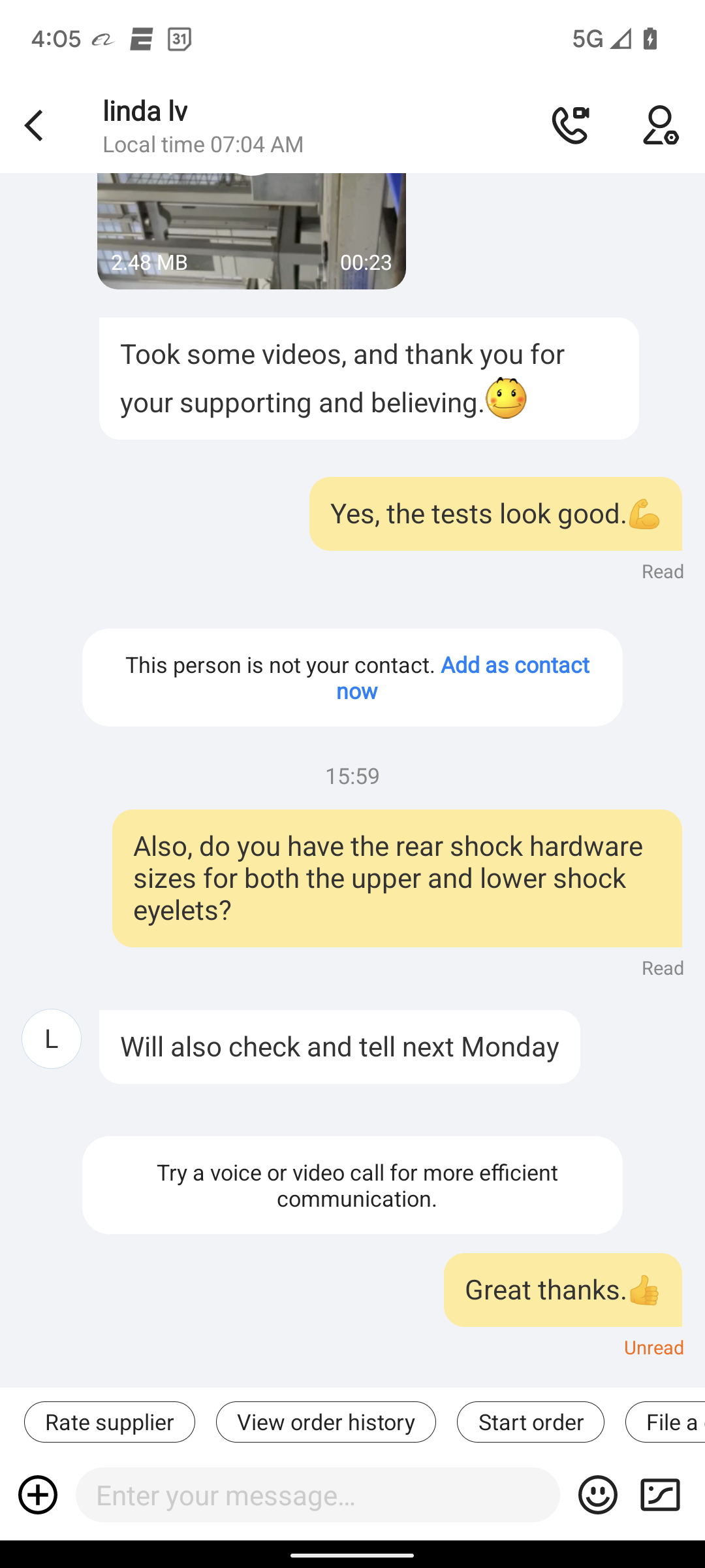

Linda should publish the upper and lower shock eyelet hardware sizes. So, I'll typically purchase the same hardware as the Shock maker...RS for me.
But I ordered from MRP in recent past build to get a tighter fitment on my Fox DPX2. The manufacturer's eyelet bolt was machined with poor tolerances and created an irritating slack feel.
The rear shock bolts and all linkage hardware will come with frame.
Update: I just asked Linda.

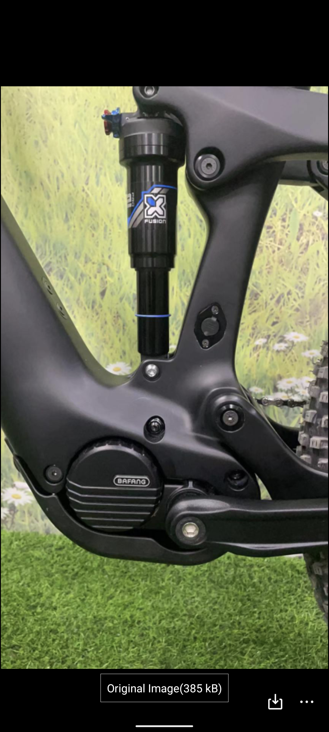

Fresh
Feb 19, 2023
18
9

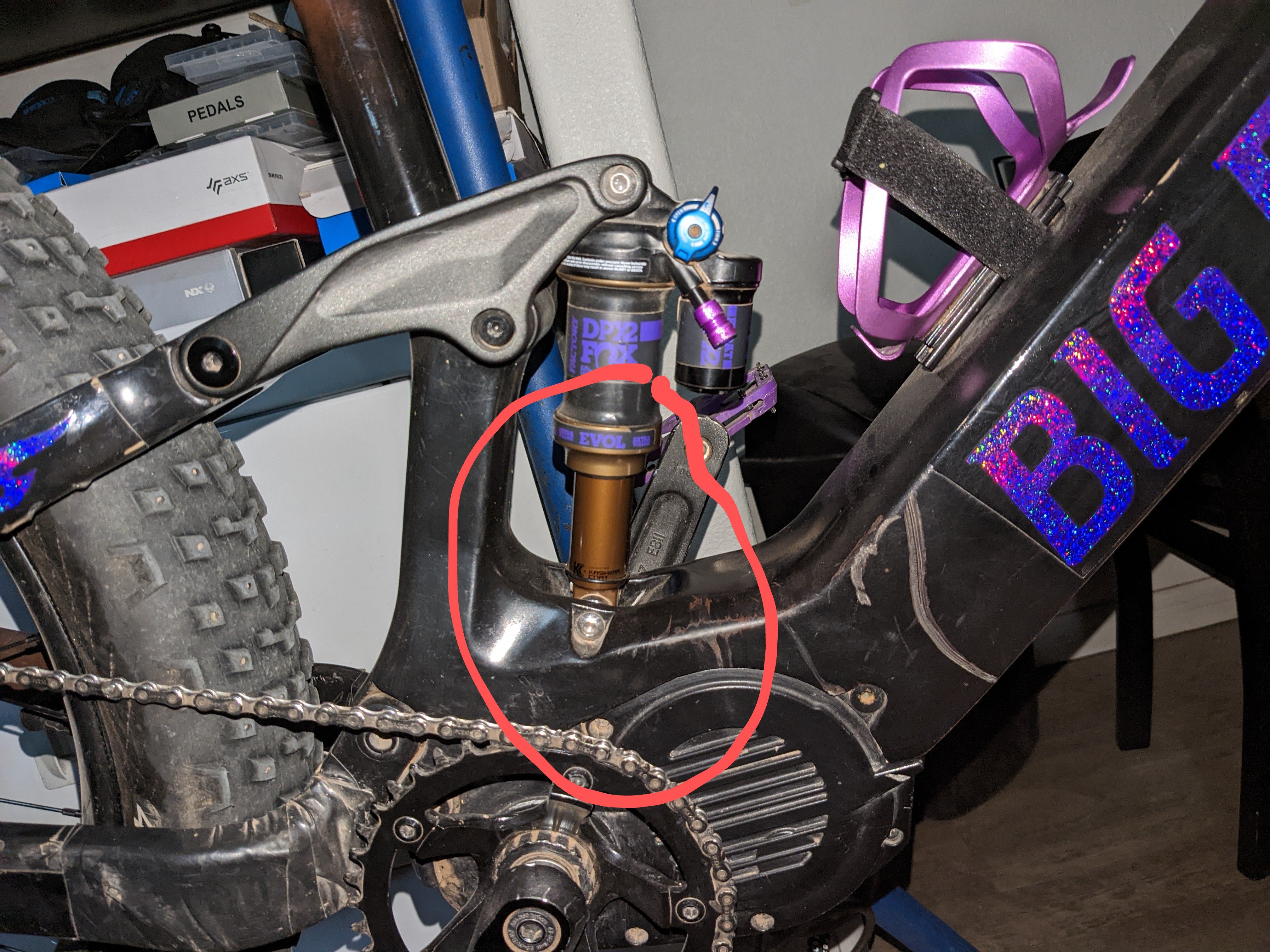

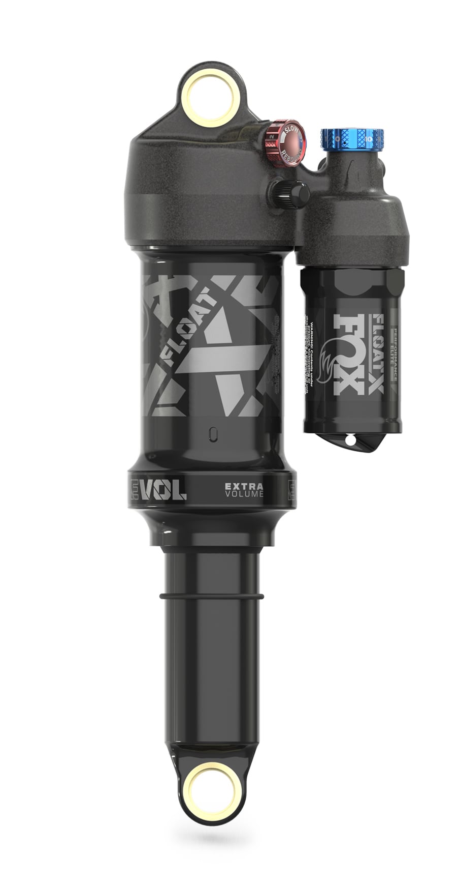

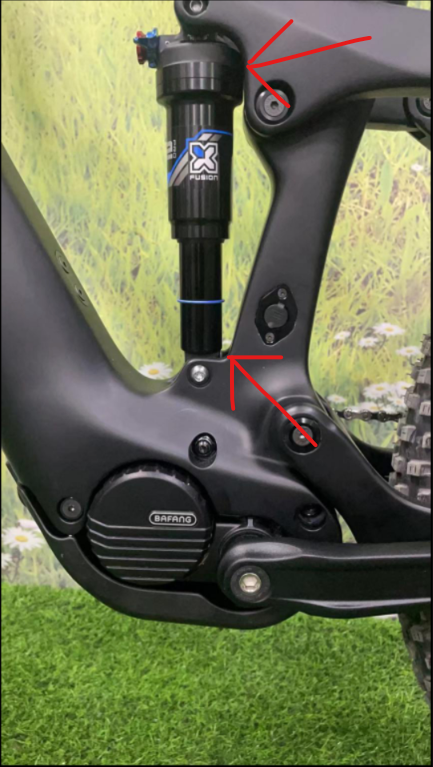

Hi Guys Newbie to the forum but been a lurker for some time.
First thanks tcflowclyde for getting a great amount of info on this frame. I've been keen to enter the DIY ebike market for some time and once i had seen this frame and the geo numbers I began to think it's the one for me.
not sure if this has been noticed or brought it up. But from staring at this frame the bottom and top shock mount looks very close to the frame. im thinking this frame won't be able to run a coil or even a float x2. Just putting it out there.
I think it might even be a tight squeeze with a Float X.
2023 rockshox might even be close.
TC i'd like to see if you run the megneg how close it will actually get to the frame.
Ill be interested to hear everyone's thoughts.
FYI, Im a coil guy but this is not a deal breaker for me.

The Small frame may have some issues with the piggyback grazing the downtube, possibly even a medium depending on maker, but you should ask Linda to have engineering run a simulation graph.
The picture from side view is irritating. The gap between the swingarms is big, and I think there is way more space / clearnce than You expected from that misleading picture. I bet You can fit Your shock in easily, pointing the piggyback towards the headtube.

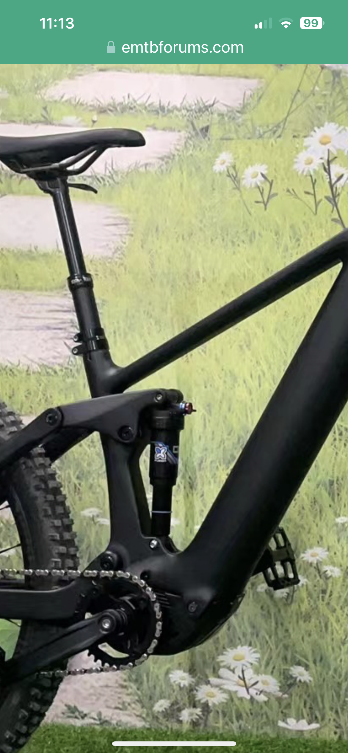

Im not worried about the piggyback. its more the diameter of the air can. Thats why i think a coil might not be able to run. As the dia of a coil would be larger than the aircan on the xfusion shock shown
Just looks close to me
Tc you are correct. but i am not yet talking to linda as im not ready to buy.
thaeber
Jan 26, 2021
888
769
Bruchsal, Germany
Got it. Thought You are talking about the upper area / swingarm clearance. You’re right, the lower mount clearance to seattube may cause a problem with coil.

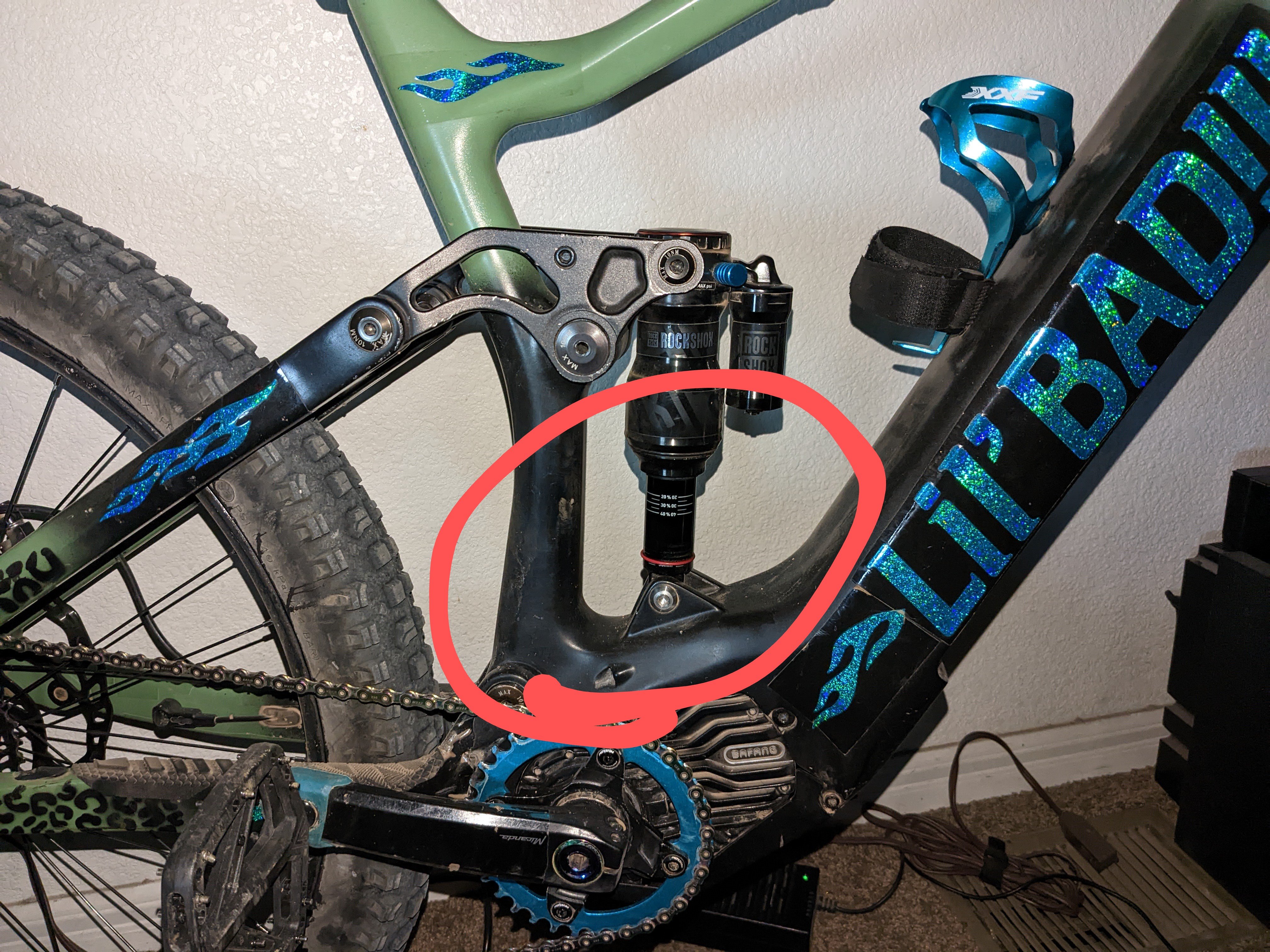

On shock fitment. Hoping it was initially an optical illusion, but yeah it's compact on the lower eyelet mount. I was most worried about the piggyback reservoir making downtube contact. Under more scrutiny, it's tight on seat tube clearance for a complete shock downstroke like Fresh keenly observed.
Up top, the rocker arm should accommodate, but as it angles closely down to the seat mast, clearance might be an issue.😬
Especially on the small which is their build in the pics so far according to Linda. It's definitely unusually if our visual reference is accurate.

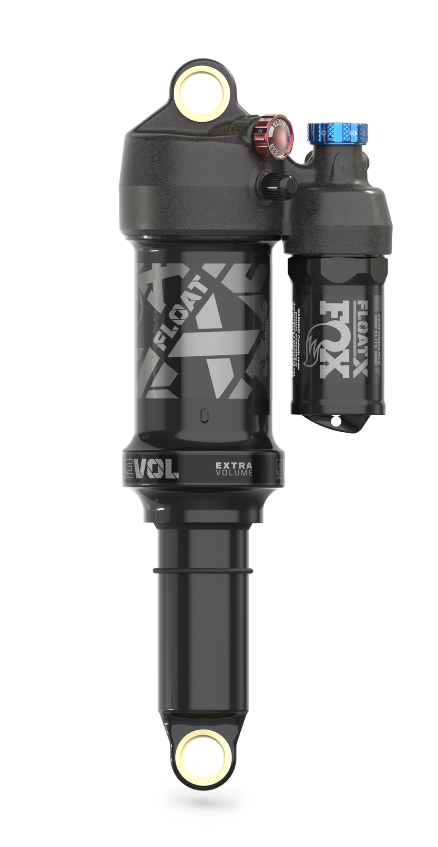

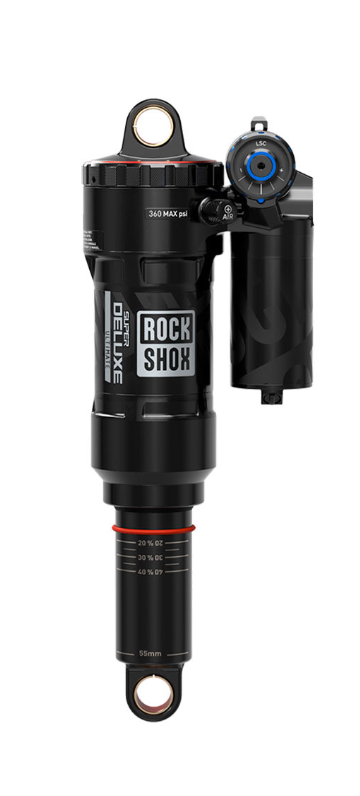

Here's my Fox DPX2 and RS Ultimate NegMeg for comparison on two recent Large builds. Lots of space for a big air can or coil spring to move through to the bottom.
Looks like another question to have Linda forward to their engineering department.

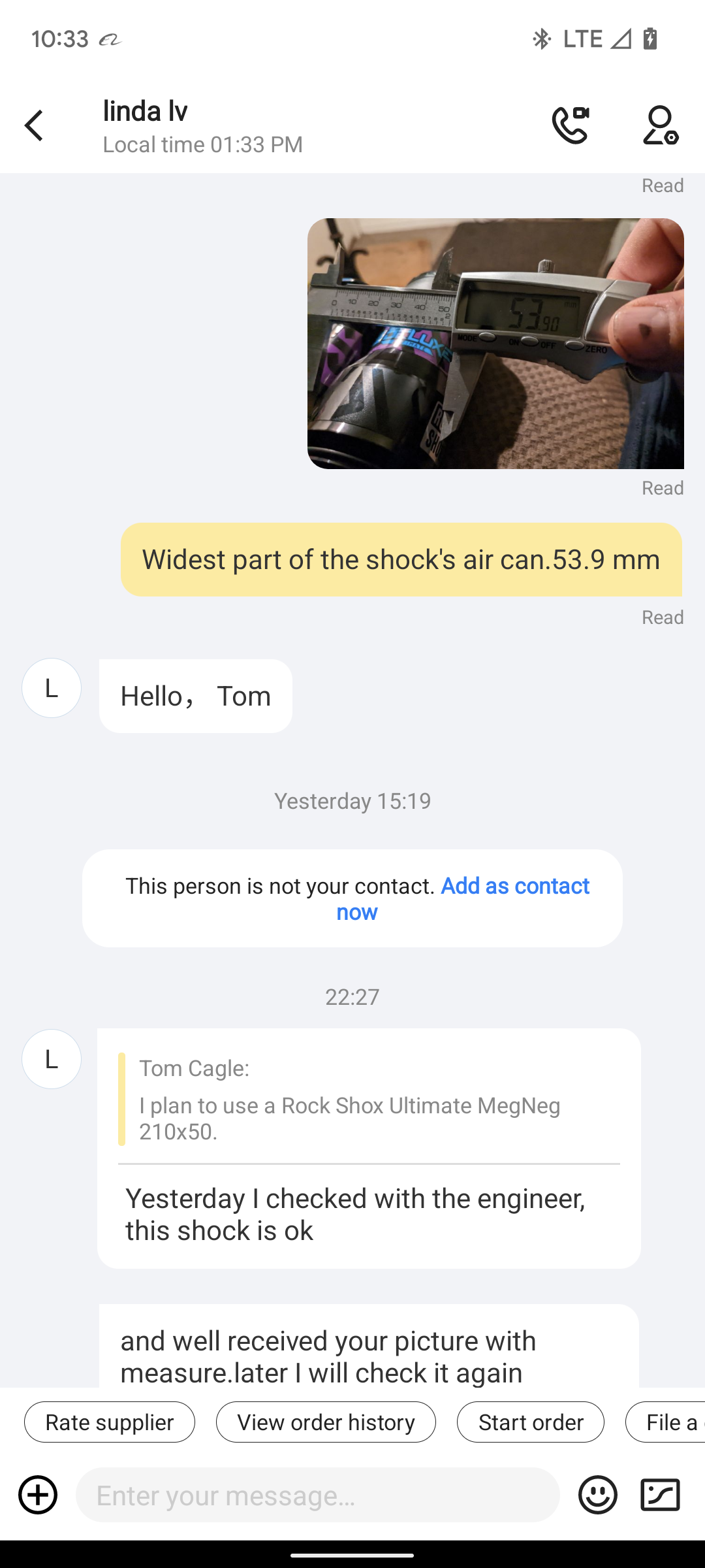

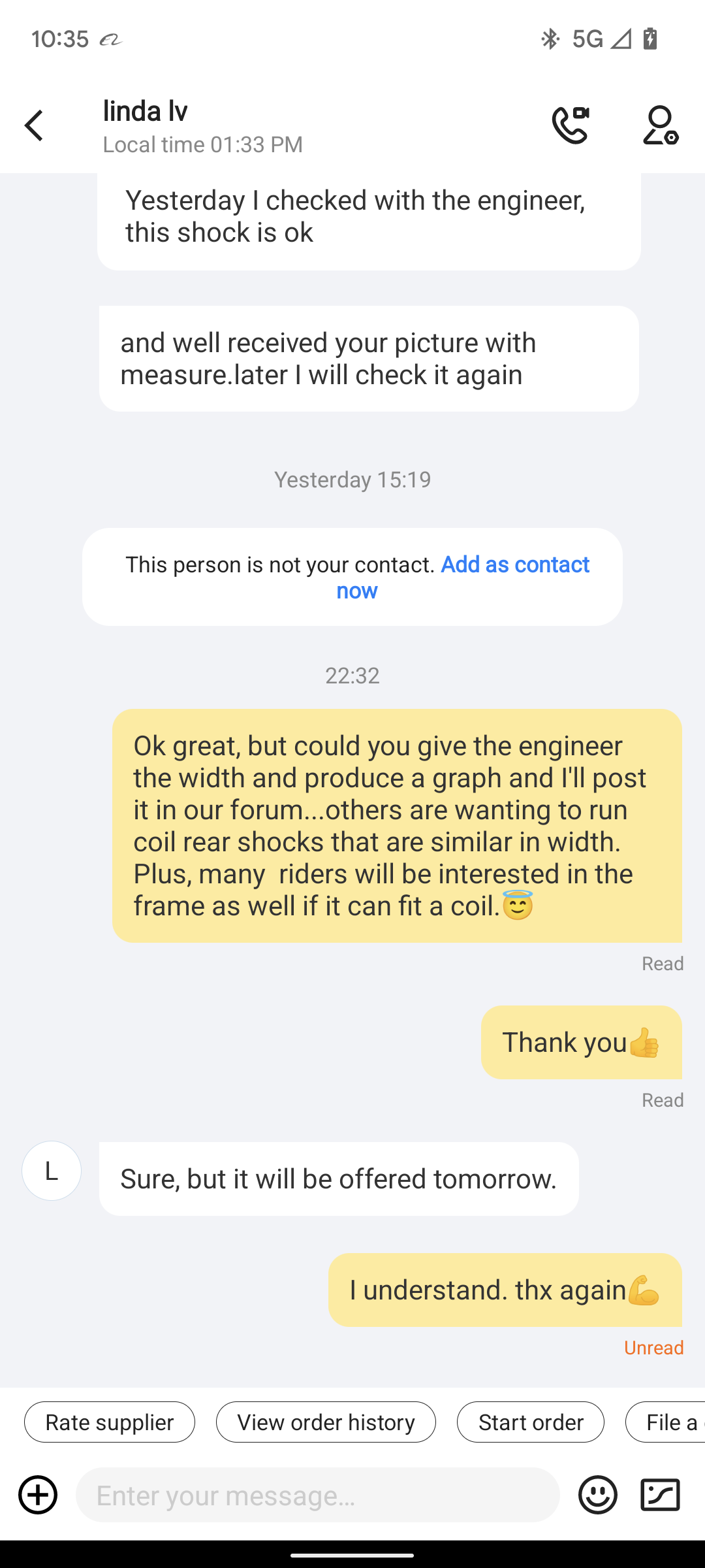

Shock fitment: Preliminary good news for the bigger air-cans and likely coil shock enthusiasts! I requested that Linda produce an illustration to see and confirm it visually.
Well, I gotta admit, I luv my RS Ultimate MegNeg...best shock I've ever ridden. The Float X was my backup, or honestly I might have been booking a competitor's frame offering reluctantly.
So, chances are good that if your coil is less than 54 mm width...it looks promising. But let's wait for the engineer's graphic. 🍻
