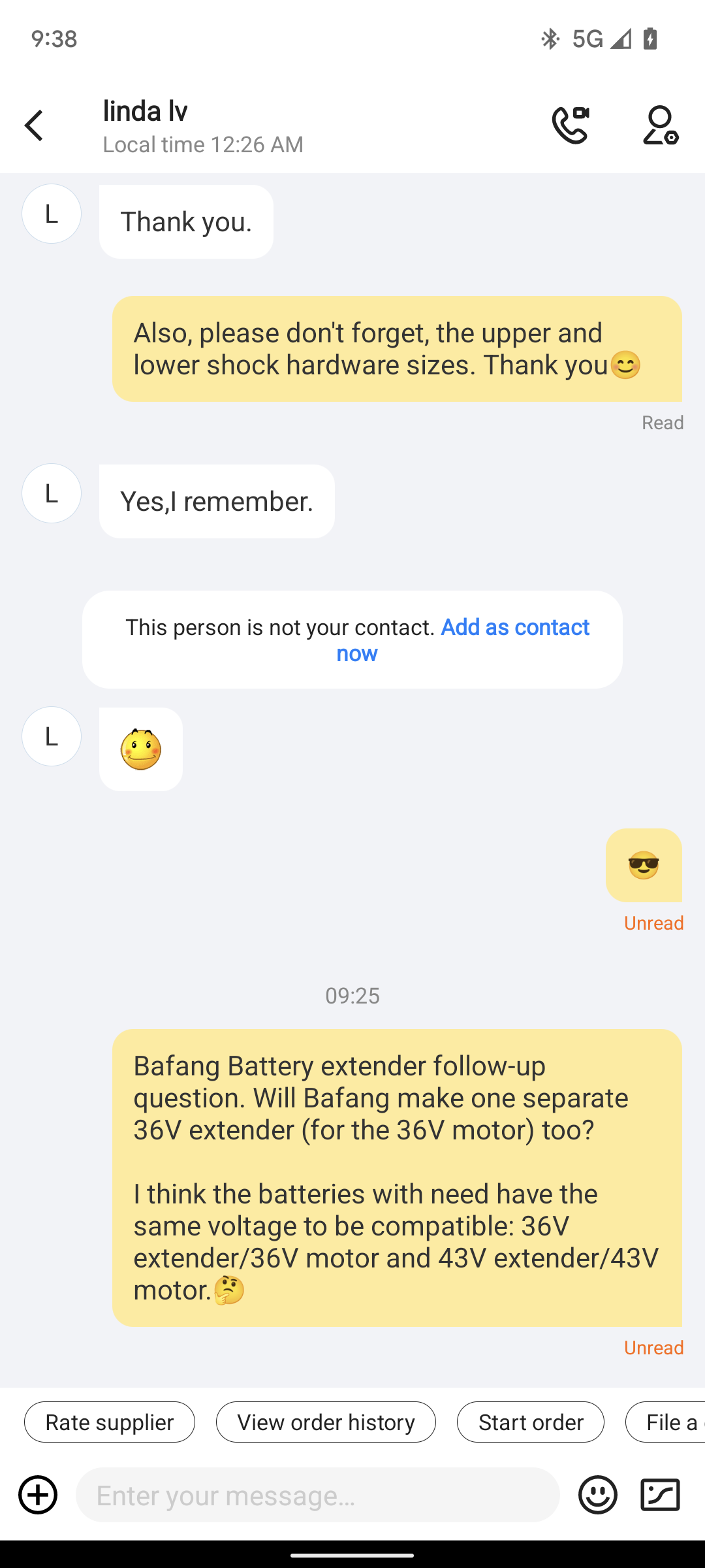

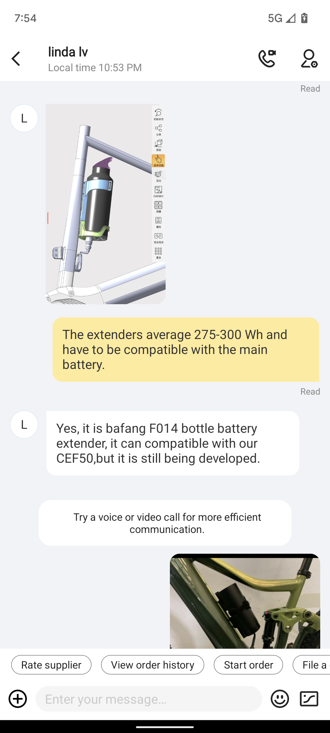

Yeah!💥 The CEF50 will have a battery extender (water bottle cage fitment). It's a Bafang, see pic below.
Size (Wh) and price are unknown...it's still under Bafang development. Fully comfortable with FT-014. 🤛
Linda says they're engineers confirm it should work with bigger 720Wh too...I hope so.🤞See Convo below.

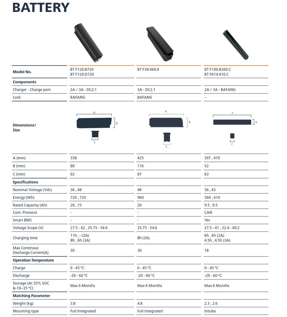

There is no way you can mix a 36v and 43v battery on the same motor. It is clear there are two bafang m820. One 36v version and another the 43v version. The F014 is a 43v battery and the 720wh is a 36v battery. Never the twix shall meet.

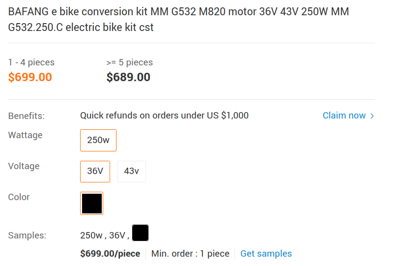

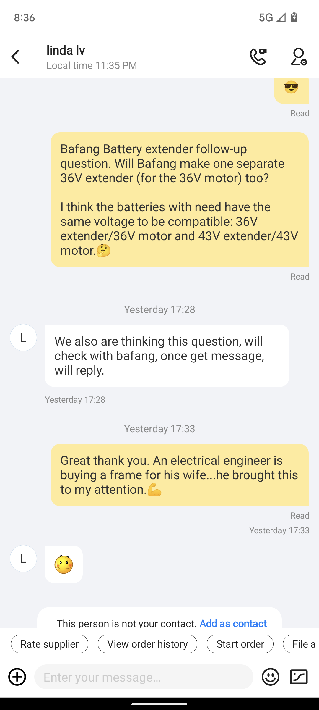

Here is supplier showing you must choose between 36v and 43v
Except me because I have to have 36v
Ah you mean nobody with a 720 will need an extender, quite so.
I would get a 420 if it was 36v because I want the lightest version possible.
💯True, I just asked Linda if Bafang was going to make an extender for the 36V too...to help clarify.
Also, hoping that the CEF50 engineers might be inspired to make one.😜

I am thinking that Bafang makes a 36v battery that would fit the CEF50. If you look on the Battery chart in their catalog. The column that includes the BT F014 also has the BT F100. Same form factor and the column says voltages of 36,43. But if you then look at the specific page for each battery the BT F100 is listed as only 36v and the BT F014 only 43v. So I think that the BT F100 and the BT F014 both have the same form factory fit in the same downtube specification.

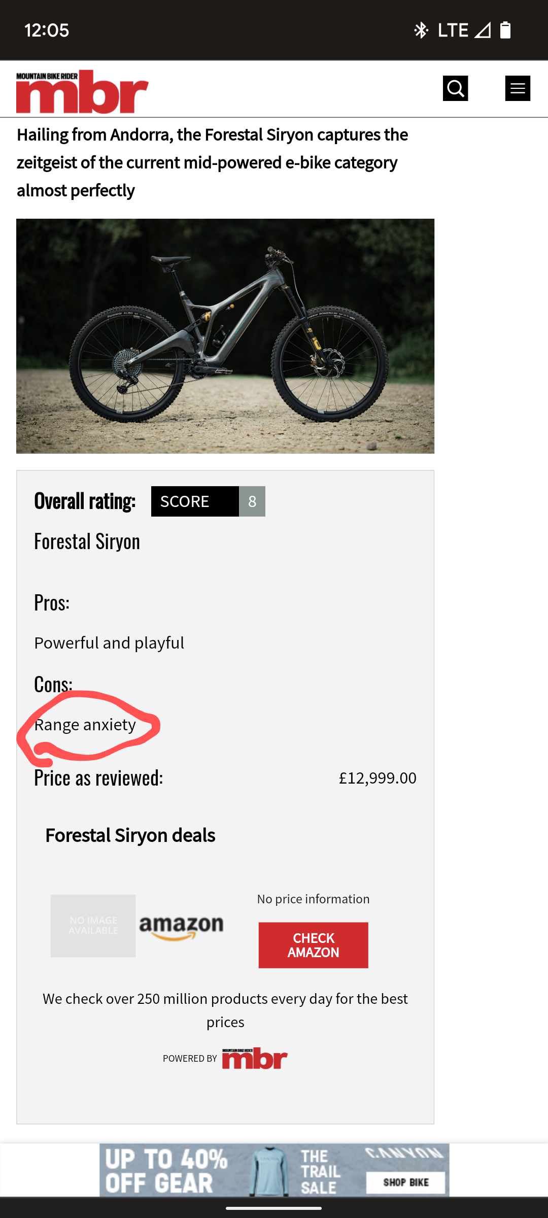

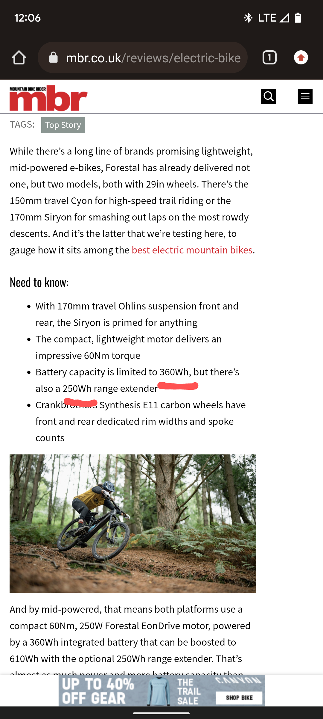

Just putting it out there: the biggest M820 "con" is range anxiety. Strongest field-tested argument yet.
A Range extender alleviates this issue. Let Linda know it's a prioriry. Check it out!

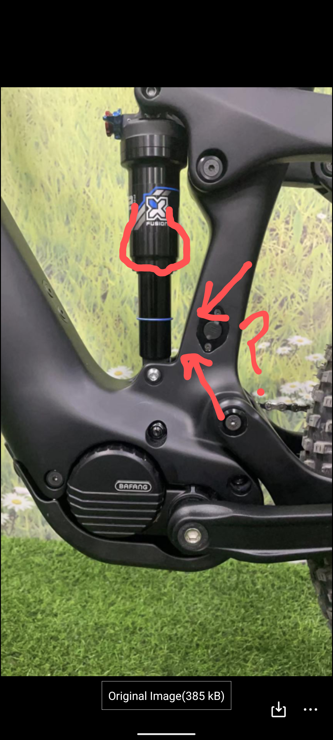

One thing I did notice on CEF50 naked frame was a solid seatpost/seatmast when scrutinizing shock fitment of the coil. The Trust one has a cutout on the full build. So maybe ZCF just made a slight change to make less generic if that's what's happening?

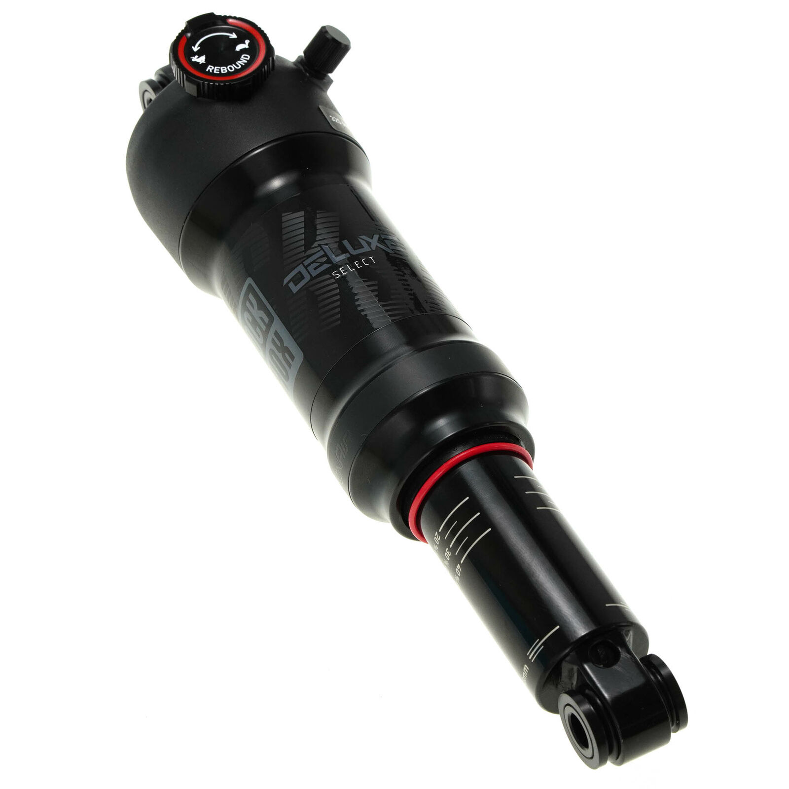

YA me too.
Also if there are any other cheapskates reading...
I picked up Rockshox Deluxe Select rear 210x50 on ebay for $143.
