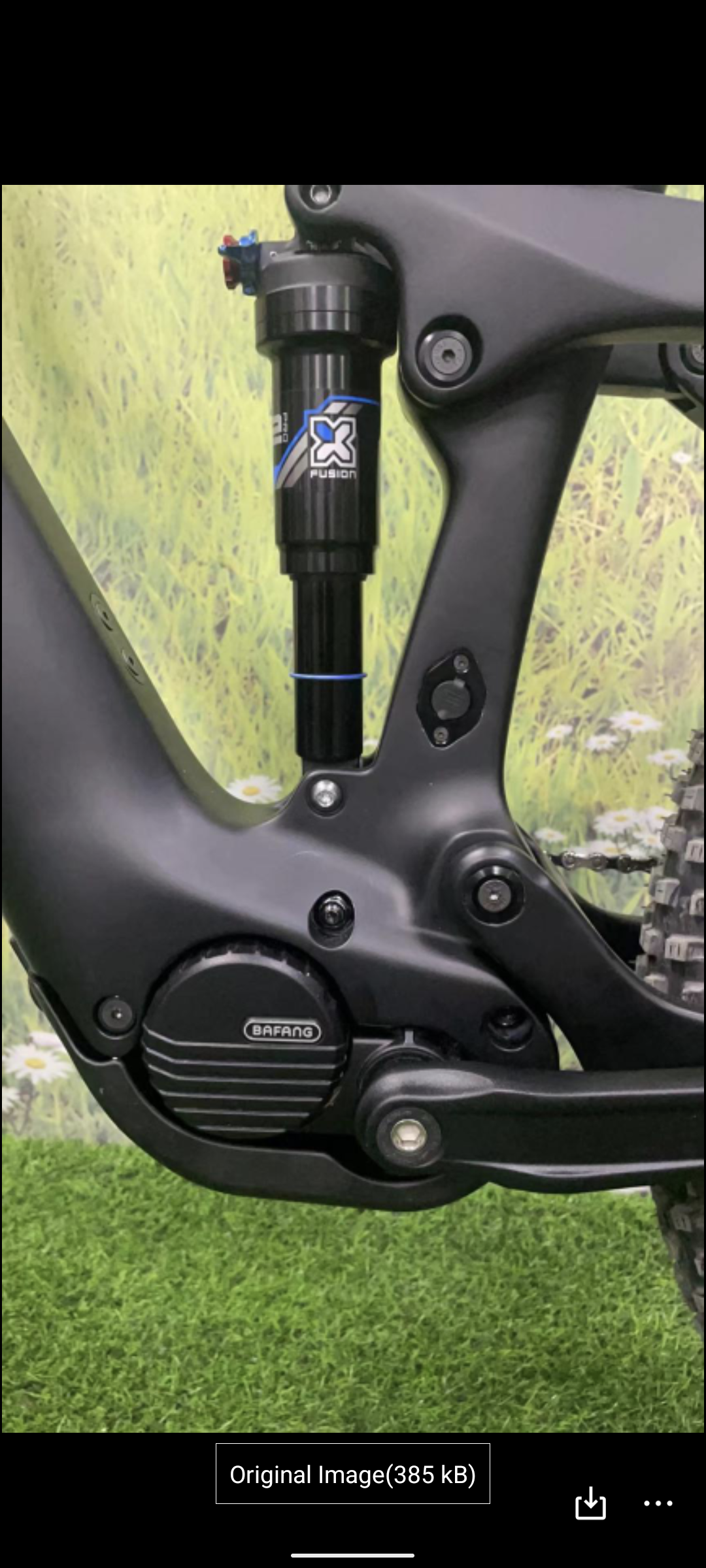

Just a quick CEF50 v Siryon/Cyon non-drive-side comparison for the purposes of aesthetics. Definitely lower profile for both. A little softer curves v. more geometrical line.

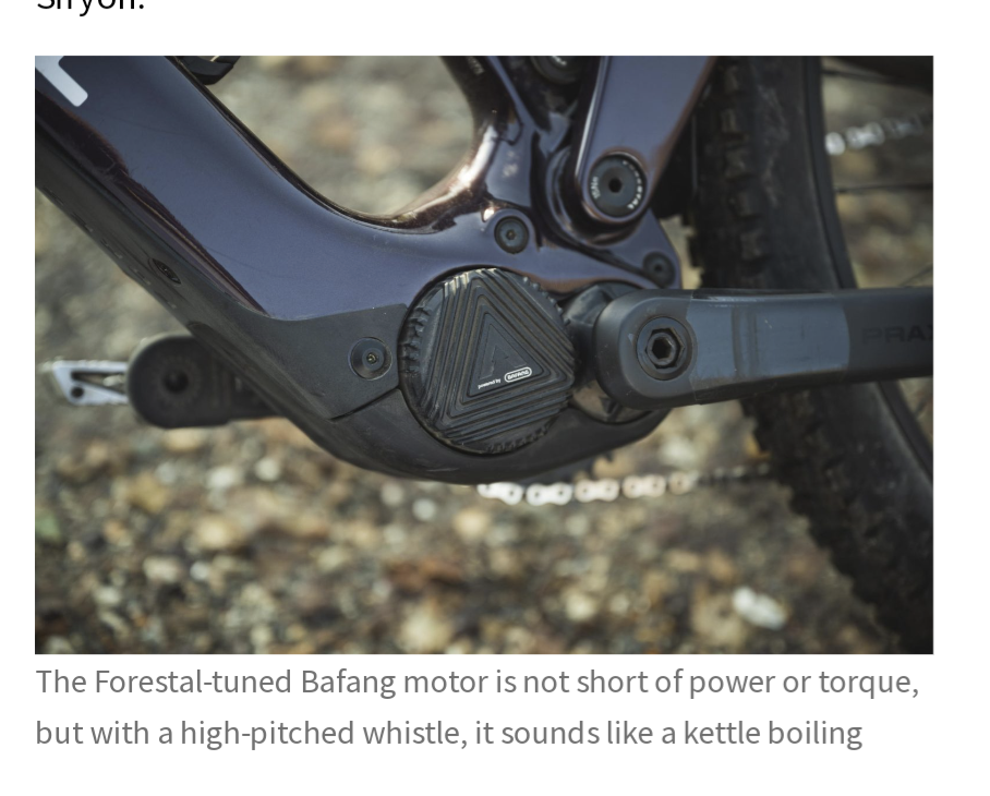

[URLunfurl="true"]Forestal Cyon Halo e-bike review - MBR[/URL]
Here's a vid review of the EonDrive/Bafang M820 motor whine or whirring noise and possibly a gear grinding wretch? Check it out if interested.
Remember, this is in higher stress environs (climbs) and turbo modes that most E-mtbs in general experience. Even the TQ50/Fazua60 has some noise. But, it's definitely evident in the vid.👹

Thanks for sharing! This whining noise is well known from my M510, but I think it’s not as loud as what You hear on the video from the Forestal M820. I hope it will not be that disturbing with M820! I don’t like the noise of my M510, this would be the first thing to improve if I were Bafang. Let’s see…
Yes...true video and microphone enhancement of sound in the cockpit is usually amplified a bit.
We'll have to do a third party come sound check from a hiker's perspective when the M820 builds are fleshed out in real time.
Would be a good stand-alone YT vid for Rob Rides channel fans.🤙

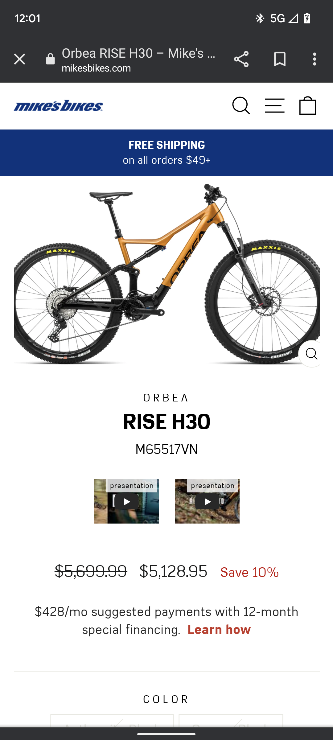

In example, the newest Orbea Rise M/H Shimano RS-60NM (considered to be one of the stronger climbers) series for 2023 are beefing up their downtubes (looks more symmetrical to me) in order to add their bigger 500 Wh juice-box by popular demand.

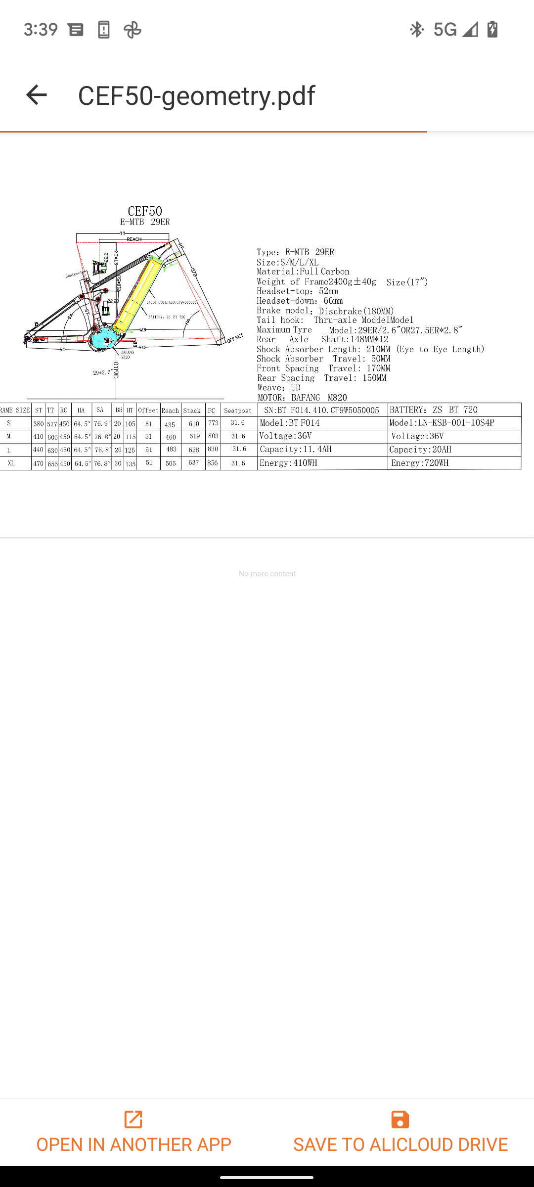

do you guys know the wheelbase on this frame? and if you overfork the frame to 170, what kind of ht angle do we get?

Is it missing part of the chart? I feel like the typical measurement of chainstay length is with a slight angle and not exactly a horizontal measurement so you can't simply add CS and FC together.
You know what everybody else knows.

Wish they could have made a latch like transition! That would make this similar to the relay.
That's the primary reason I'm probably going to skip on the Relay as that removable battery decision added weight, cost, and a failure point.
I've been in touch with Linda (very helpful btw) and there is a high probability I'm going to go with the CEF50.
I'd save so much money, that I could just take my saved cash and go buy a new AM pedal bike with the saved cash, if I so desired.
Here is my question: is this the EXACT same Motor as used in the Forestal? Mag case, Ti shafts, same programming? Furthermore, is the power curve programmable to try and improve how natural it feels?

Chart says fork length 572 mm. 170 mm fork is about 586 mm. This will slacken You head angle about 0.7 deg., ending up at appr. 63.8 deg.
My intention is to run a Mara Pro 210/55 I already have, and love. This will give me 161mm rear travel.
A -1 or -.5' headset, and likely stick with a 160mm fork.
I like a long Reach, but a short, seated cockpit with a steep sta.
No one knows for sure at this point. Power curve and programmability options would be nice to see.👍 If someone has knowledge of them, please post.
Only known is that the M820 spec is 75Nmmax/95Nmpeak cited from the Bafang-e website.
The EonDrive is tuned to 60 Nm by Forestal. If it weighs the same, it's probable that's really the same motor...but ya never know with Bafang.
Hopefully it's true to their numbers. And reviewers will produce some concrete comparisons to bear that out.🤞
