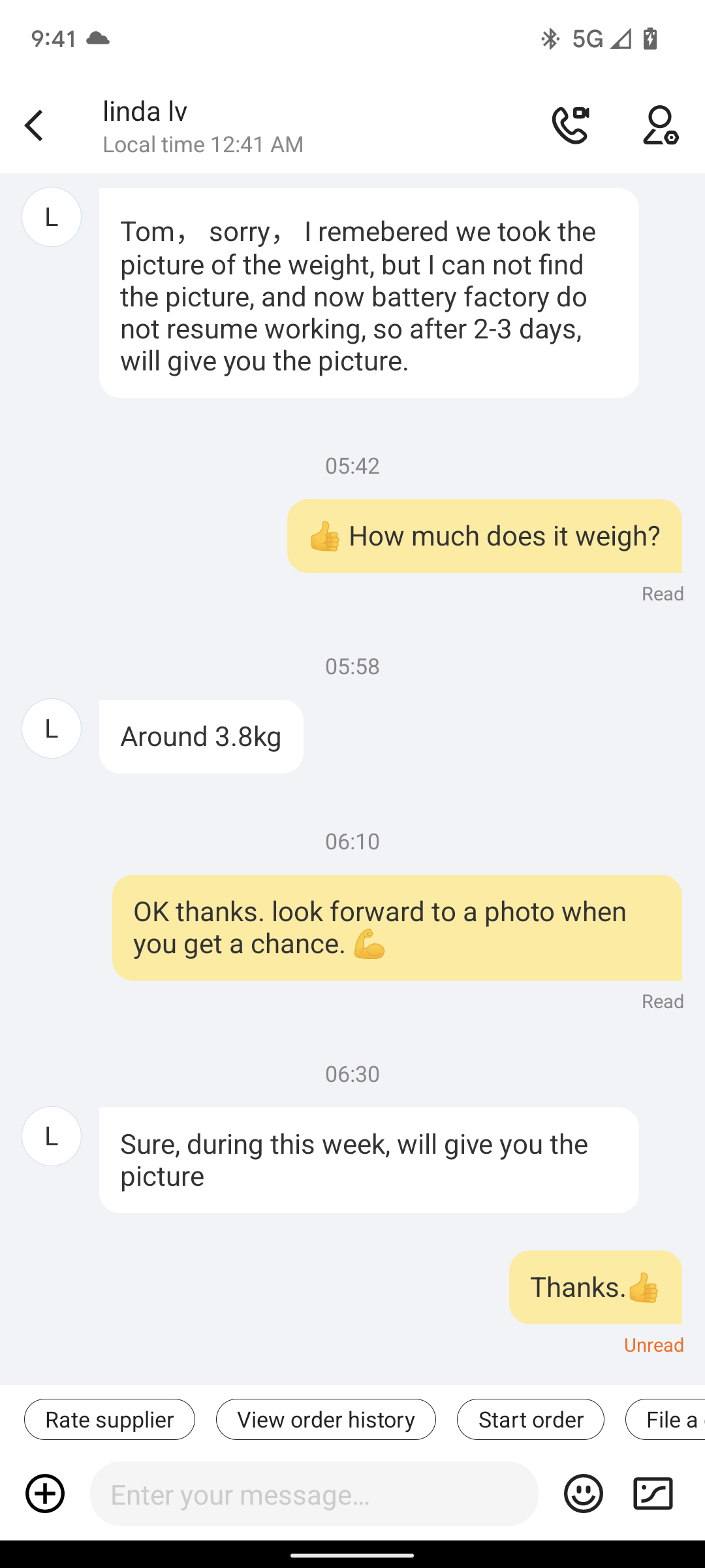

Here is another tidbit: I asked Linda to confrim the weight difference between the 410/ 710 battery was really only .7 kg. She stated that this was NOT correct and the weight difference is actually 1.5 kgs/ 3.3 #s. As rarely as I'd use the extra juice I'd stick with the 410 watt battery.
I'm either going to end up with the Relay, the new Levo SL, the Siryon or the CF50 by this summer. Just wish I could compare them all at this very moment and began fully moving forward.
Cool...but bummer too on weight difference for me. I'll plan my expectations for another lb added to my build.😜
But I'm glad you got to it first...was waiting for Linda to get back from Lunar NY to ask.👍.
On drag for the CEF50 we'll have to see... hopefully sooner rather than later.🤙
Excited on the CEF50 build potential but still maintaining reasonable expectations.🍻
P.S. I just made a request to Linda to maybe put the 720 Wh on a scale and take a pic to get an official measurement.
I'll post her response here either way to stem off future controversy.🙏

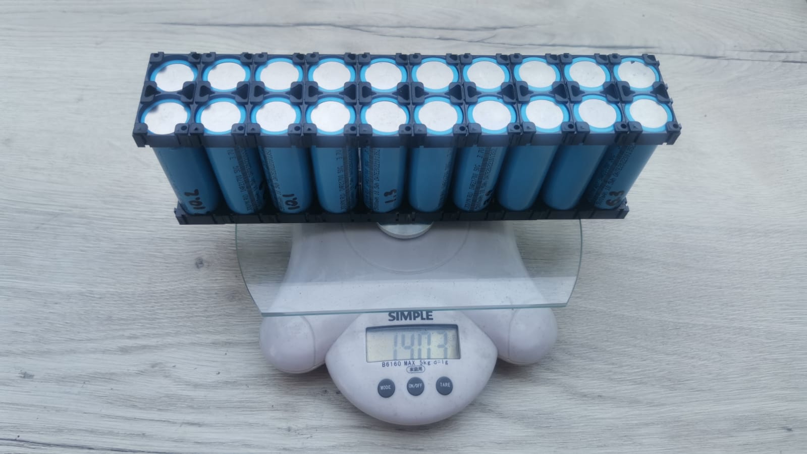

720 Wh battery is tentatively estimated at 3.8 Kg/8.37 lbs. But to be more definitive, I requested a scale-pic and is forthcoming...

Bafang 410 Wh battery is quoted at 2.6 kg. So weight penalty is only 1.2 kg. This means 46% more weight, but 75% more capacity. Deal!
Seems you're making some assumptions. I have to assume that Linda knew the actual weights when she sent me the weight difference.
Still awaiting some details from Linda I requested about 2 weeks ago (during Lunar New Year).
For a moment I was ready to begin my purchase, but I've cooled a bit. Just want to get this decision correct.
Nobody is questioning you, just Linda and her weight estimate of the 720Wh.😁
Me personally, I'm just double checking Linda with a scale photo for her future accuracy. 😉
She's in sales with evolving product specs and might have been told varing numbers from the engineering department 😇

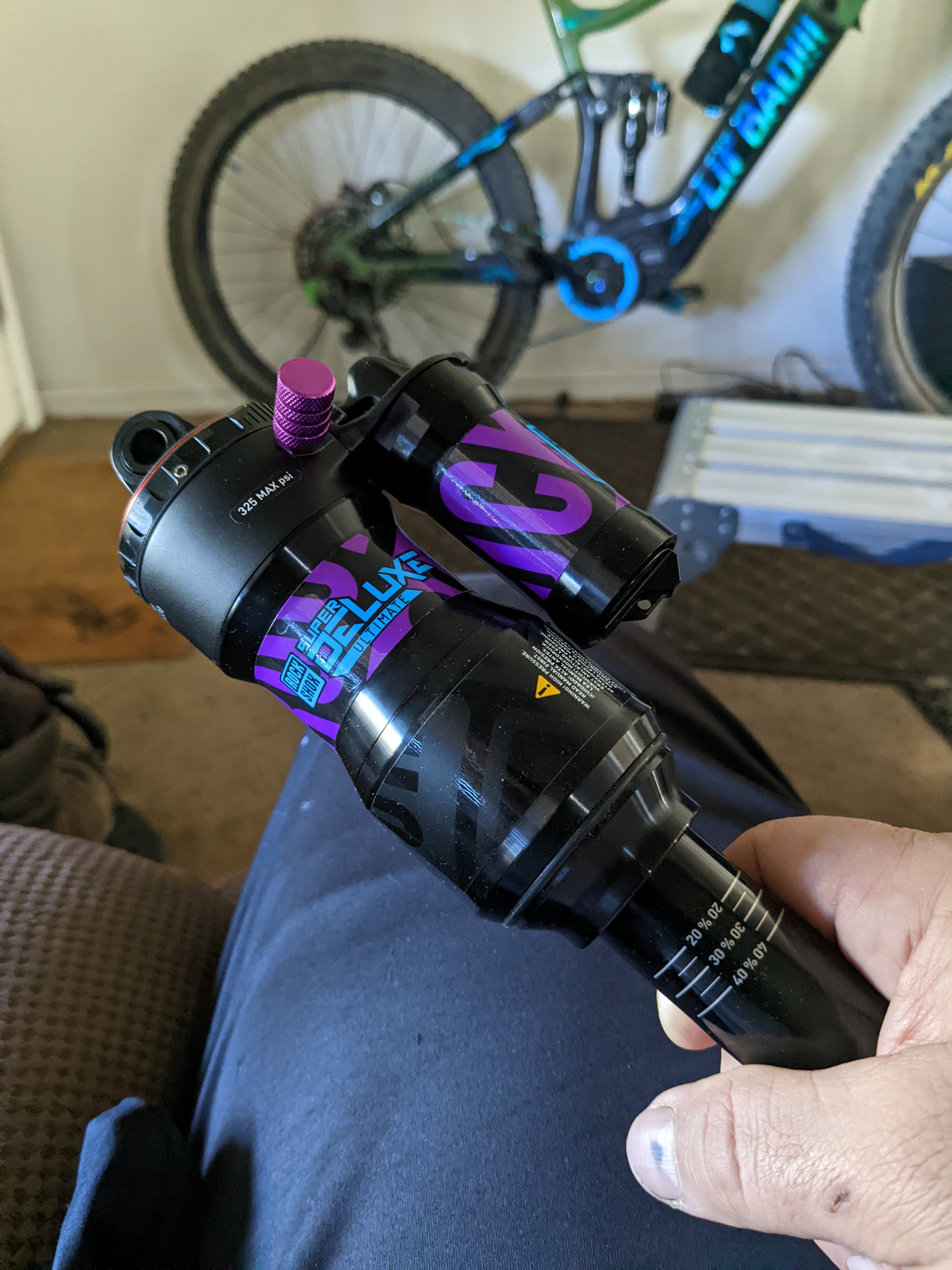

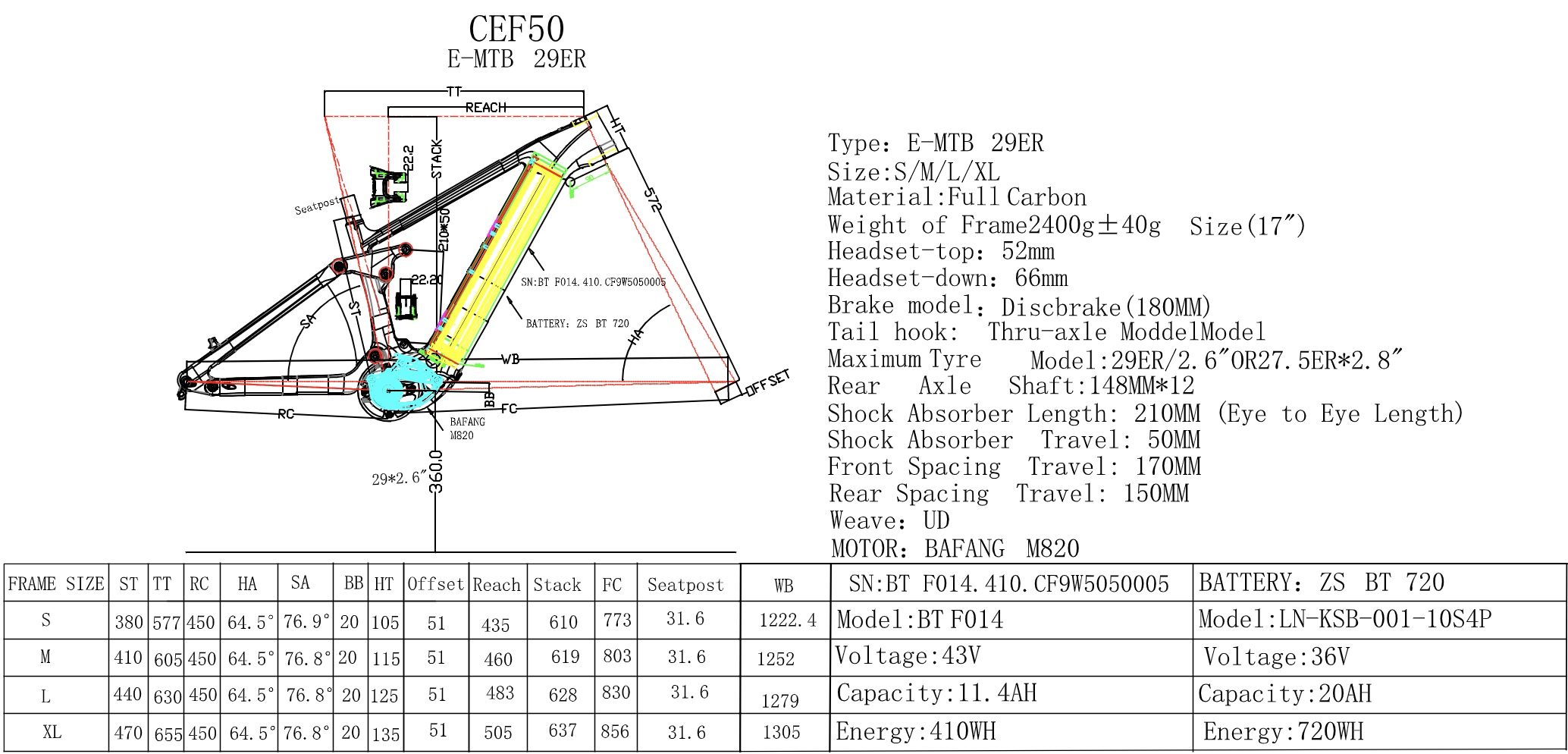

Is the bike actually capable of taking a 55 mm stroke shock? How did someone calculate that? I’m worried I buy the shock and then it ends up buzzing the rear seat post.
Also, I’ve mostly seen 210x55 shocks being used on 130-140 mm travel bikes. Does this mean we need a progressive air shock with heavy tuning?
We're only guessing on the kinematics from the previously posted progression curve....but I'll u know if I get seatpost rub or crack a seatstay.💪
My RS 210x 55 Sdlx w/NegMeg upgrade.
Run mullet. I would bet my butt that this will work with the 55 stroke shock, there is no bridge between the seatstays that may hit the seattube 😊
I’m still confused on how a 55 stroke shock can get 162.5 mm travel. Most bikes using the 55 stroke shock has travel ranging from 140-150.
