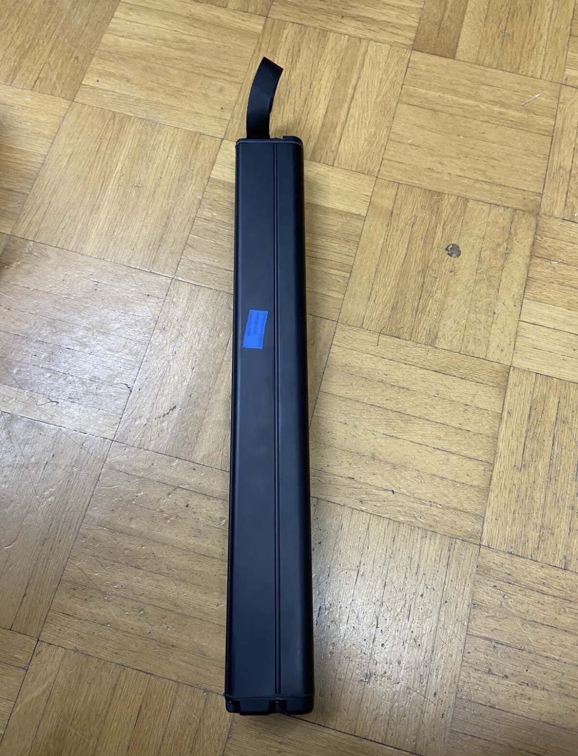

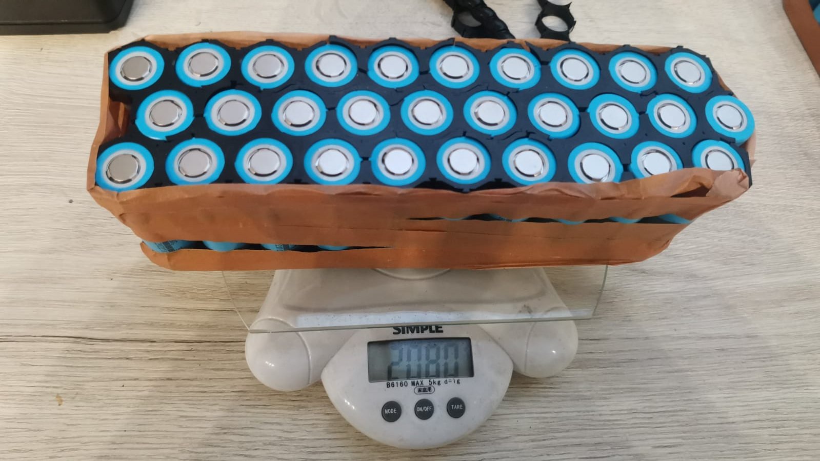

The EF 50 is a very versatile frame. On its basis, you can make a light trail bike with a stroke of 140mm and an enduro with a stroke of 180mm. The rear shock absorber with a 210x55 stroke and a 27.5 wheel gives a 165mm rear suspension stroke. In Height at CEF50 360 mm. Light carbon has 335mm. Find a good battery manufacturer and make yourself two removable lightweight batteries of 1600 or 2200 g. and get a capacity of 10Ah or 15Ah. If I'm not mistaken, a bike with a 140mm stroke and light parts should weigh 1600g with a 160 1600-1700 kg stroke. The lightest battery case is a bag. Or a bottle on Aliexpress. Aliexpress has a very large selection of bottles, but then the battery weight will be more by 700-1000g. Let's hope that the frame C EF 50 is light and reliable. Why the LSE930 weighs 3000g. we'll never know. Look at the Lexon brand on Aliexpress, it doesn't remind you of anything. Lexon is manufactured in the same factory as SUA 50. Lexon has been producing light frames for a long time and they have a very large selection of frames. They even have a copy of Scott with a hidden shock absorber.

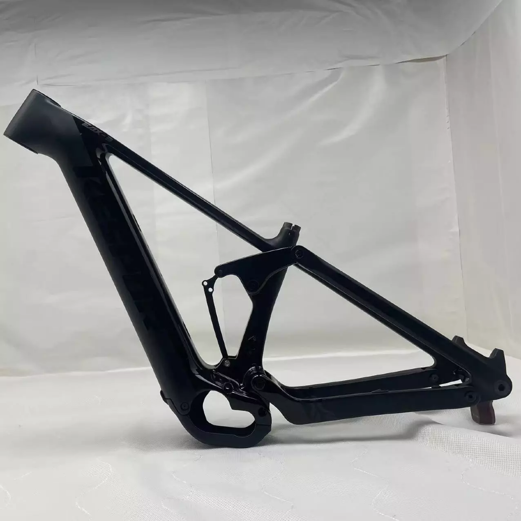

I see the frame's offset is 51mm, do you have to use a 51 offset fork...? what will happen with a 44mm fork, do you get 63 degrees or so as the end result?
It will reduce the trail about 7 mm with no effect on the head angle if fork length stays the same. I doubt that anyone will be able to notice the difference.

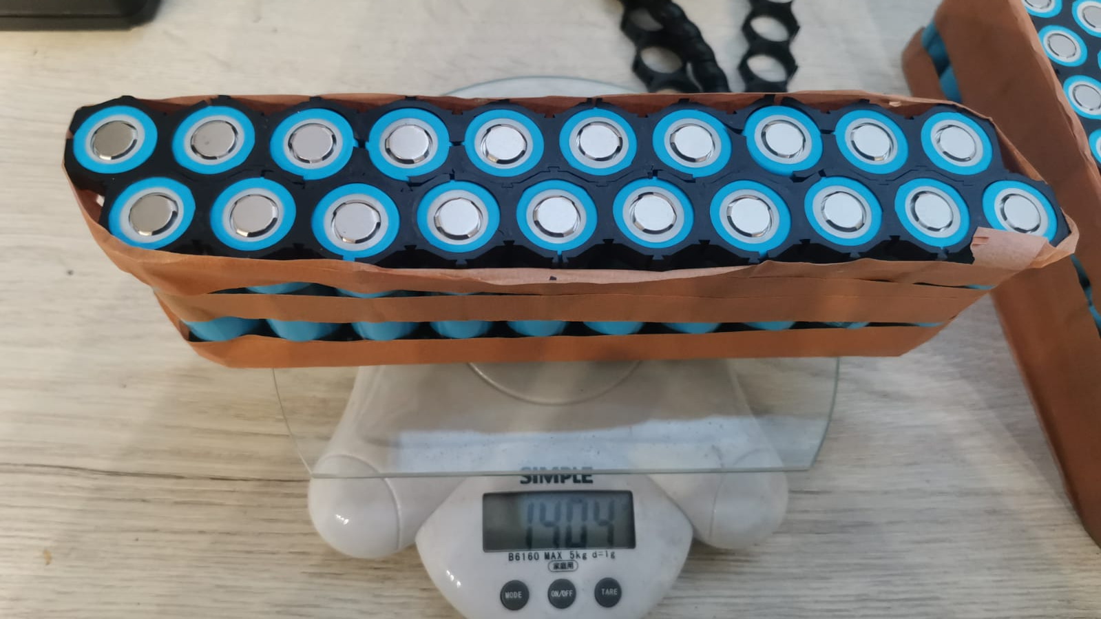

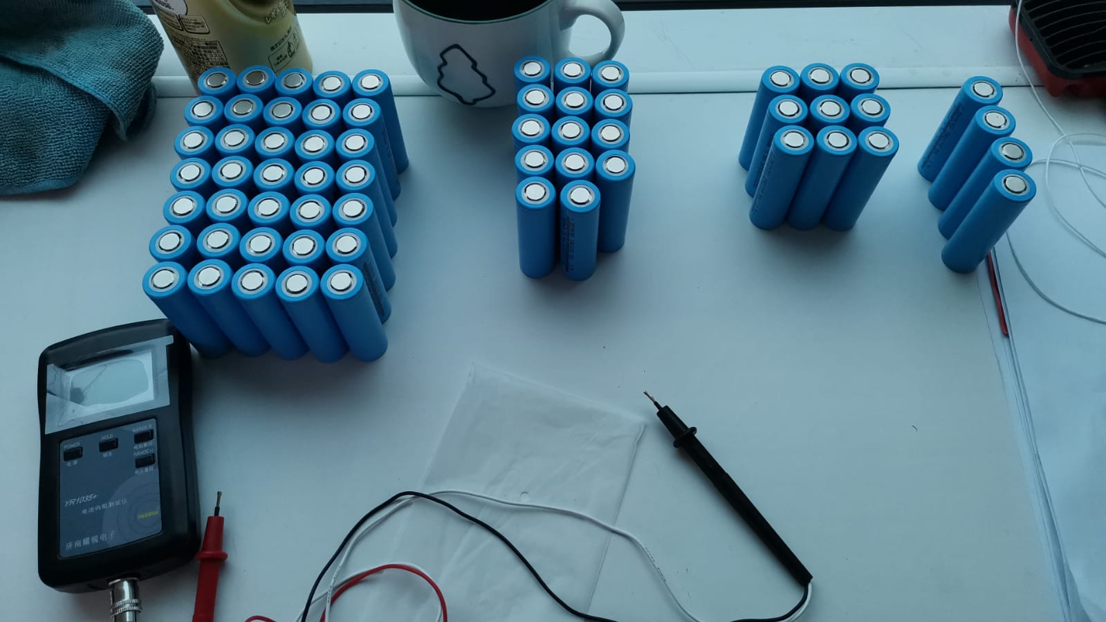

For the battery, I have some experience in the manufacture of the interior modules and the carbon shell, I don't see a problem in making one.
Perhaps the best option would be the 720 Wh model with a DIY battery of about 600 wh, that is, 12S 3p with 21700 cells and carbon casing.

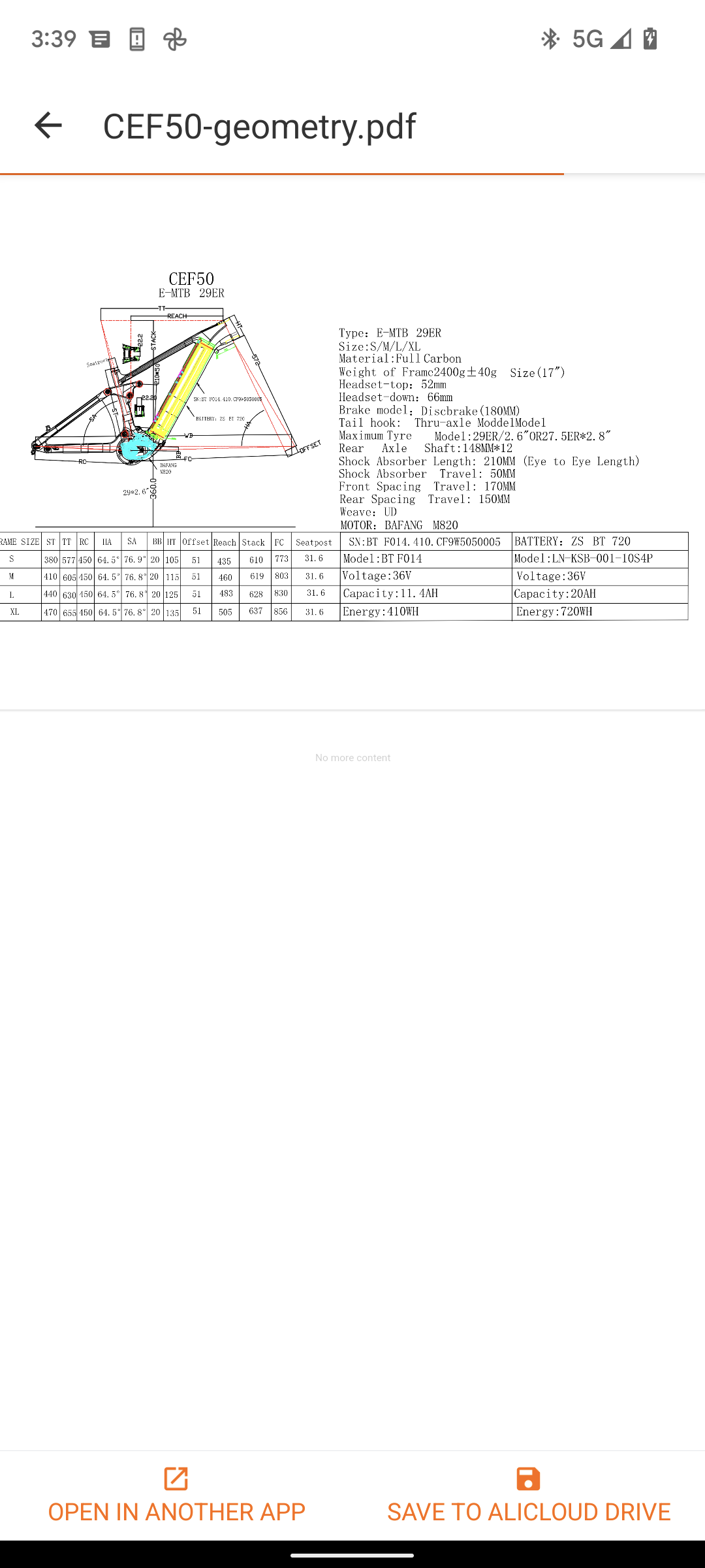

This is the Bafang BT F014 as claimed as alternative to the 720 Wh battery. Looks completely different.
View attachment 104900 View attachment 104901
According to the information provided, this battery is 42v, 12S 2P, 24 21700 cells of approx 4900 mAh that give those 410 Wh, very similar in section to the one my current trek fuel exe bike has.
Apparently the other battery is 36 v 10s 4P, 40 21700 cells of approx 4900 mAh = 710 Wh.
I highly doubt they are the same size.
What do we know about the motor voltage? Is it compatible with the full 36/42 v range or are they 2 different references that each have a specific controller? To be able to make extenders or a 600 Wh carbon cased battery to save weight would be interesting to know.

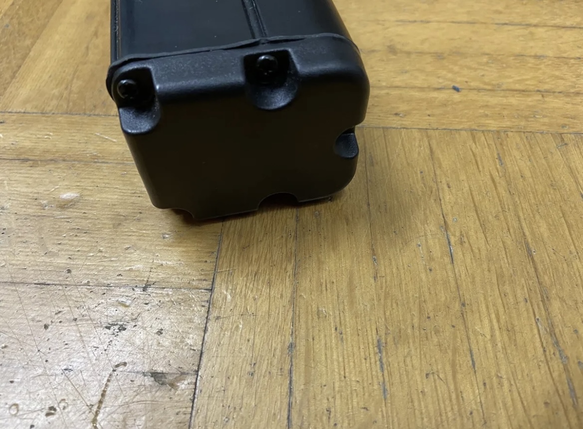

Here's the 720Wh in-house, bigger battery option. The smaller is the 410 Wh Bafang battery. Both are integrated (motor dismount required) in order to save weight on the frame cutout, cradle hardware, and key latch system. Purportedly, this strategy can save 2-3 lbs off the total build. We'll see! 💪🤞
No range extender is planned. So, I opted for the bigger one knowing the 75Nm/95Nm peak motor power will inherently consume more battery range. Plus, I'm a heavy Clyde-rider.

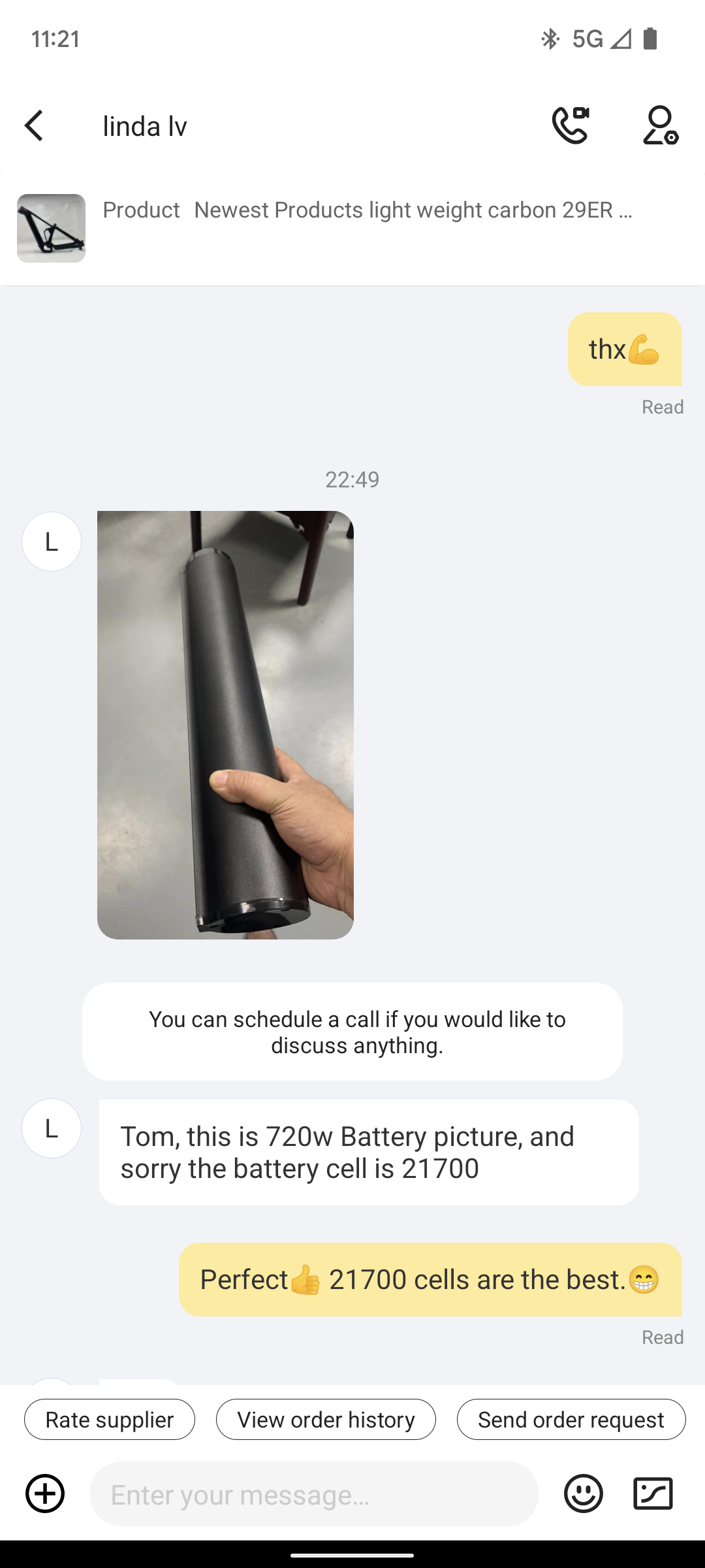

This is a picture of the 720 Wh battery. Completely different from the Bafang 410 Wh…
