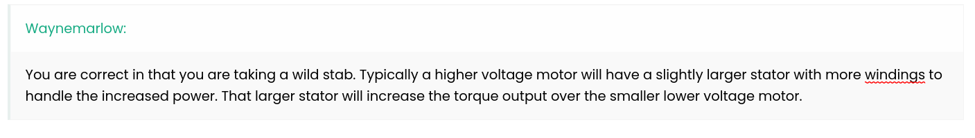

I’m afraid as an EE it’s either correct or it’s not. Unfortunately all too often I see basic motor and battery function perhaps misunderstand by the poster along with way people will accept anything written on the internet must be true.
In my view incorrect information blindly followed can only lead to slower development of what looks to be a very good over all EMtb.

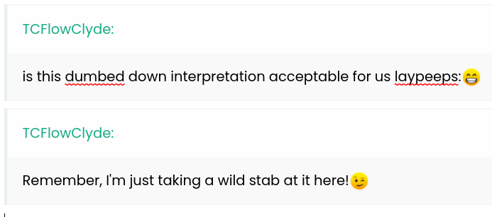

Guys it’s been proven over and over that a higher volts motor should have more torque and power but manufacturers don’t quite work that way and instead have common parts across the entire range, simply changing output via computer control to get different characteristics including max power.

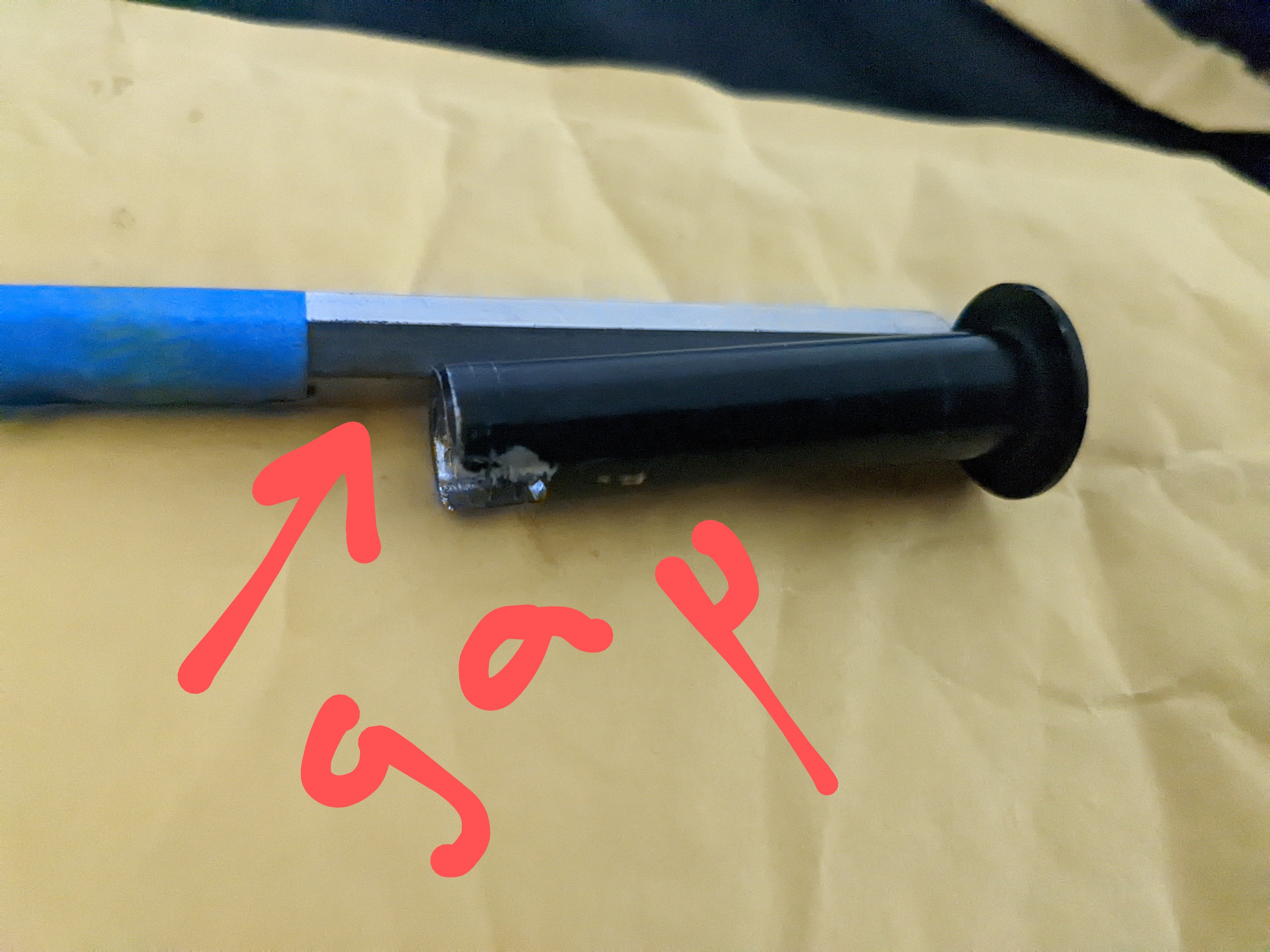

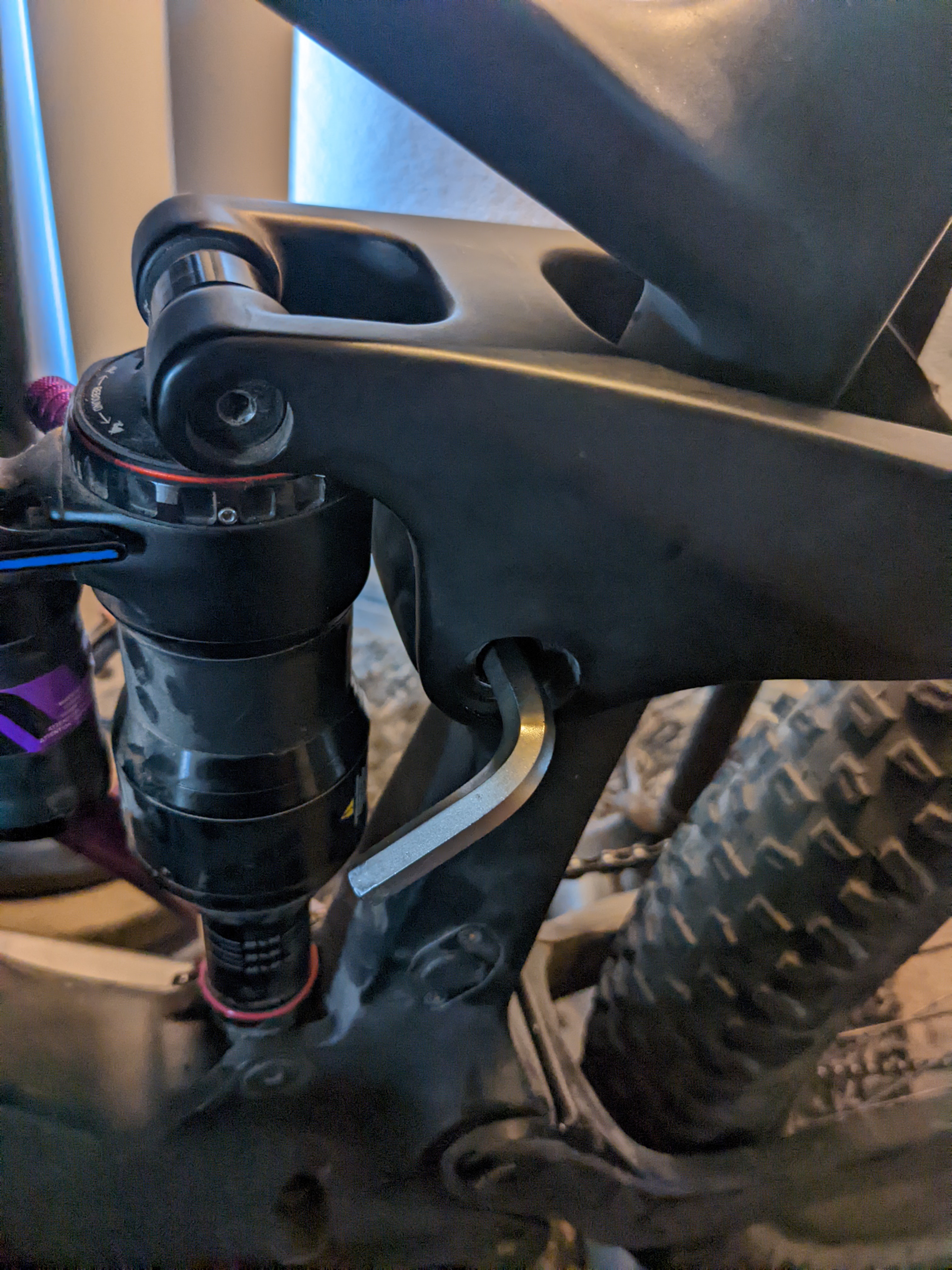

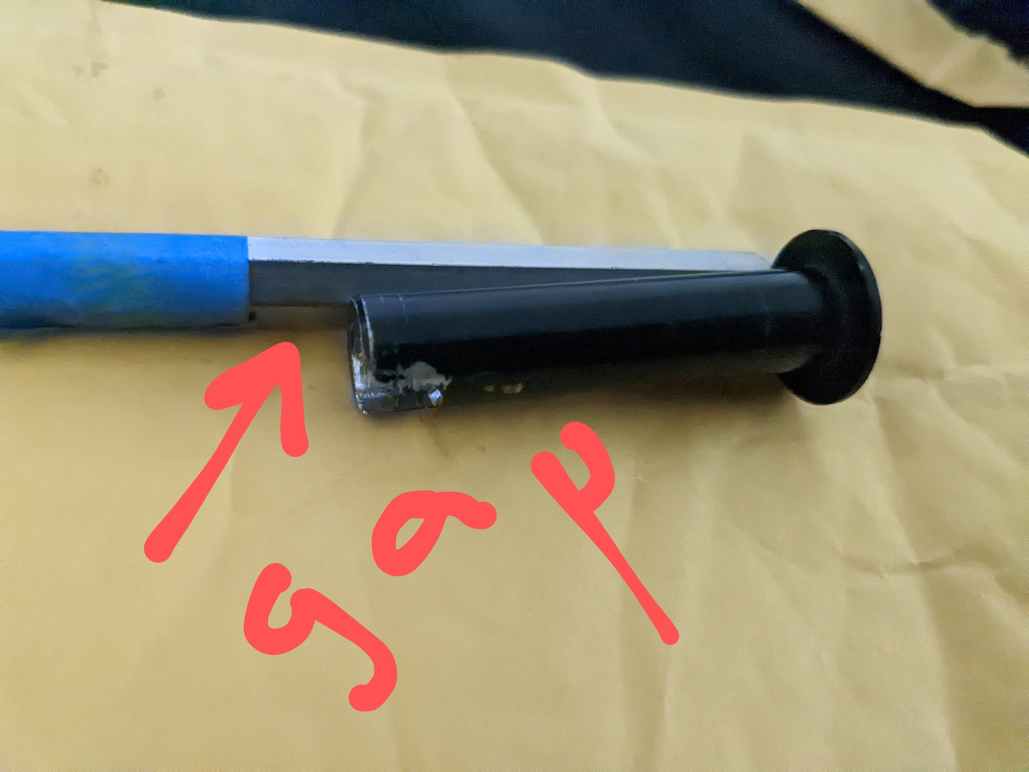

Yipes...my mating bolt sheered off on my main pivot bolt. But here's what I discovered...my OEM pivot bolt is too short.🤯
I should've noticed it sooner...😵‍💫
It looks like about 9.25 mm short in order to be flush with the opposite side of the bushing of rocker arm/frame pivot.
I'm having a Ti bolt custom made with a mating bolt by Huk-tek that specializes in mtb suspension bolts. Owner validated it should be longer.😝
Hopefully, SZZS just sent me a wrong sized pivot bolt.
Anyone else?

This should be checked. What is the correct bolt length?

I also wrote about Jean's problem. She said she would find out from the engineer. My bolt is 58mm long. The total length is 64mm. The length of one crown is 9mm . The bolt enters from one side by 3 mm. I don't have any problems yet. I think that it is not necessary to tighten the M6 bolt much. 12H is very strong for M6

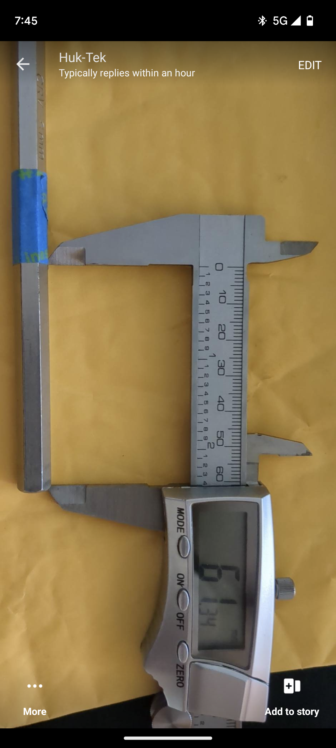

Your main pivot bolt length is 58 mm. Does that include the bolt head too?
Do you mind taking a pic with caliper measurement if you can? I can tell Huk-tek and update today before machining. I appreciate it.👍

This is together with the head. I've already screwed the bolt back on. The bolt should be longer by 4-5mm. He's holding on, but not tight enough. Let's wait for Jean's response. And we will make new bolts of the required length.

I just did a crude measurement with my hex wrench. I will pop out one bushing to get a better measurements, and then compare to it Jean's measurements when you get them.

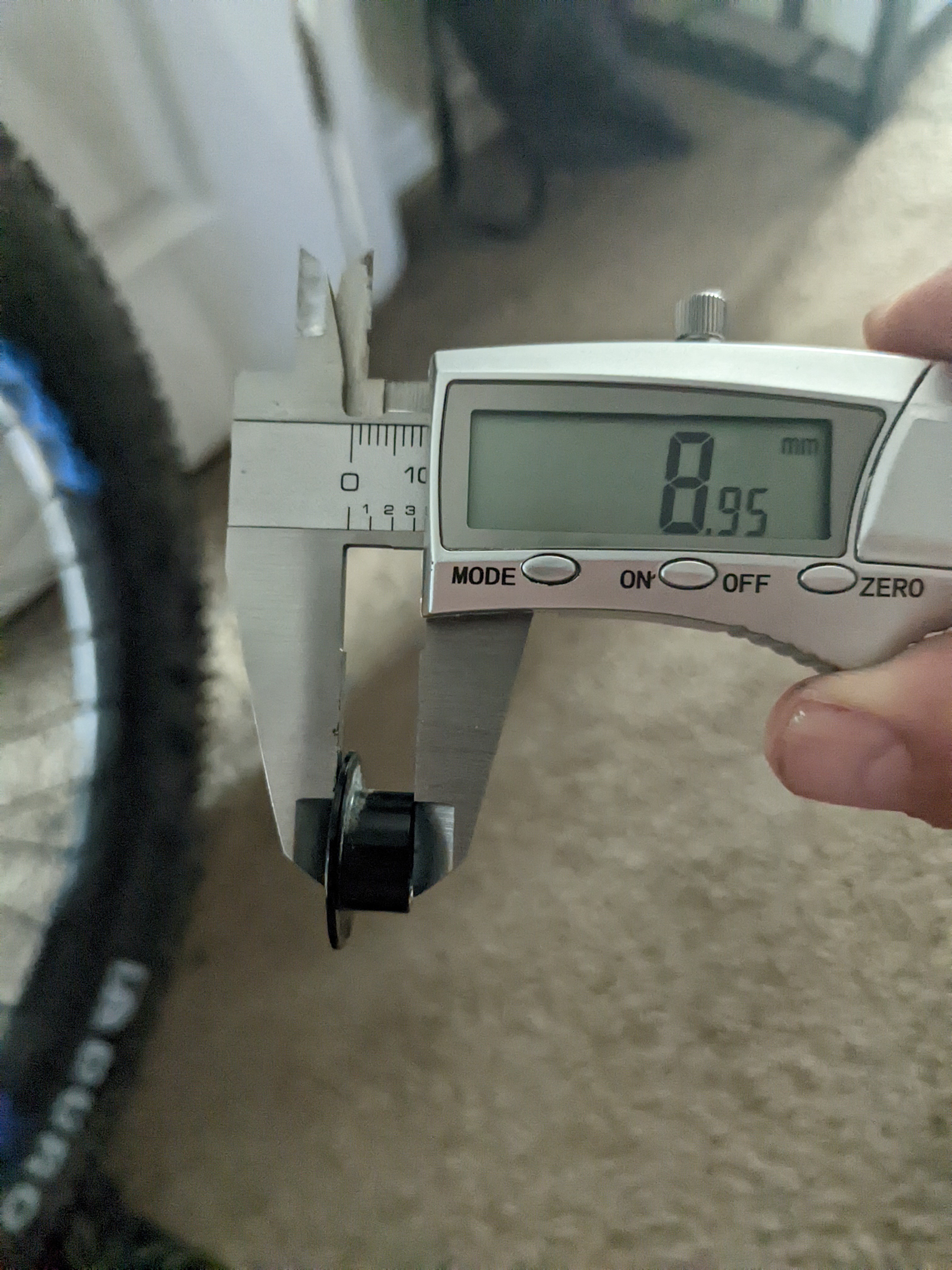

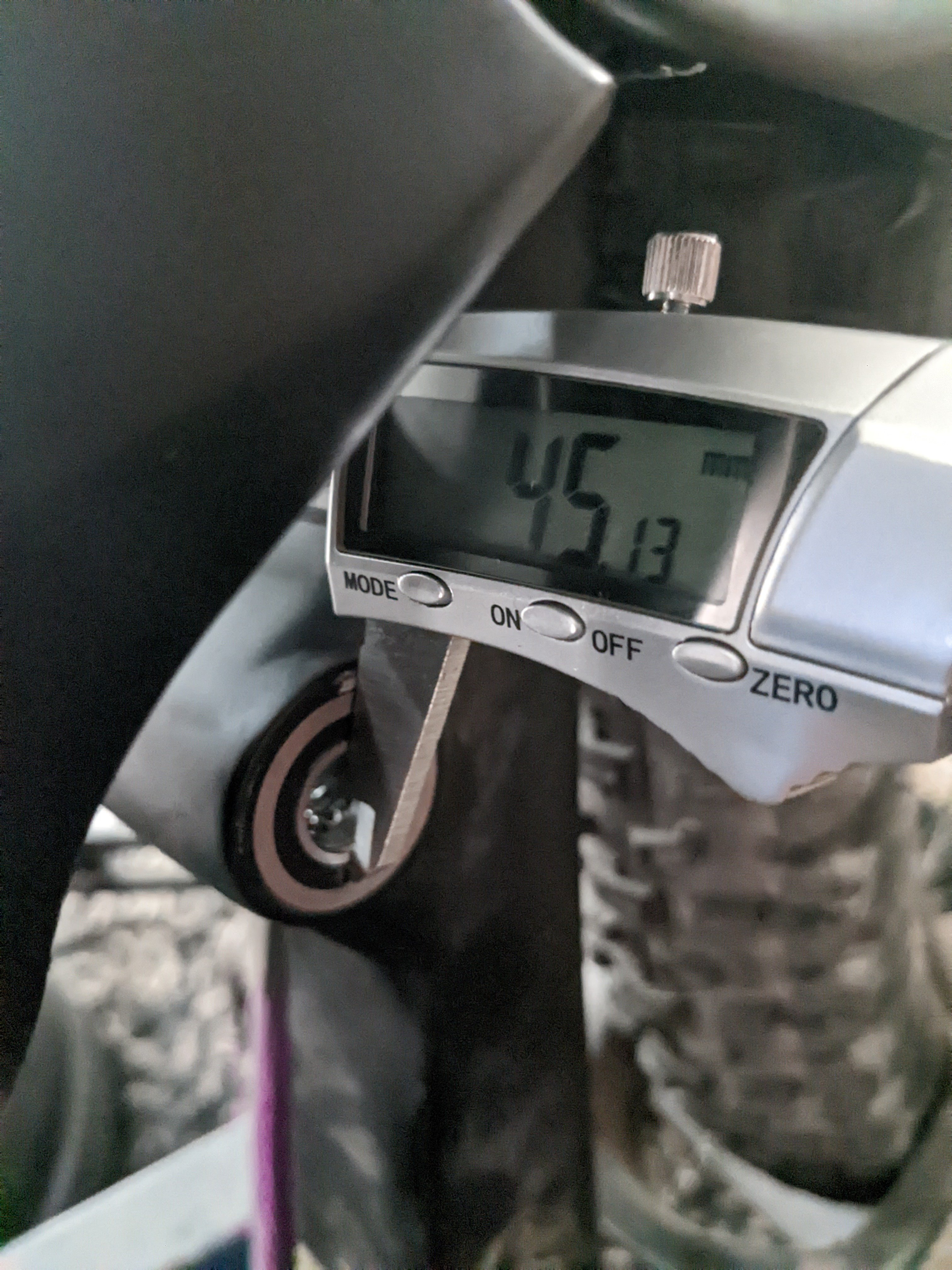

Here's my caliper measurements of the bolt shaft length (no bolt head) outer bushing edge-to-edge. So, flush to the mating bolt side.
45 mm + 9 mm (2) = 63 mm +/-.
The Huk-tek machinist suggests a minus 1-2 mm recessed shaft length in order to sink in the mating bolt with enough depth to allow some torque (hopefully 10-15 Nm). I think the 61 mm bolt shaft should work.🤞
If it's not too much extra 💸 I might try another 59 mm length to compare. Plus, he's including a more standard Ti mating bolt than OEM to match. It's more art than science at this point. 😎
Unfortunately, I'll have to risk ordering it today. The machinist lathe is open currently...it might not be available soon.💸🤙

View attachment 119896 It is interesting. I will disassemble another bike again. We need to check which one he has. The frame size M has a second part of the bolt of 2mm together with the head. We twist the M6 steel bolt into an aluminum part. Isn't 10-15N a bit for an M6 bolt?

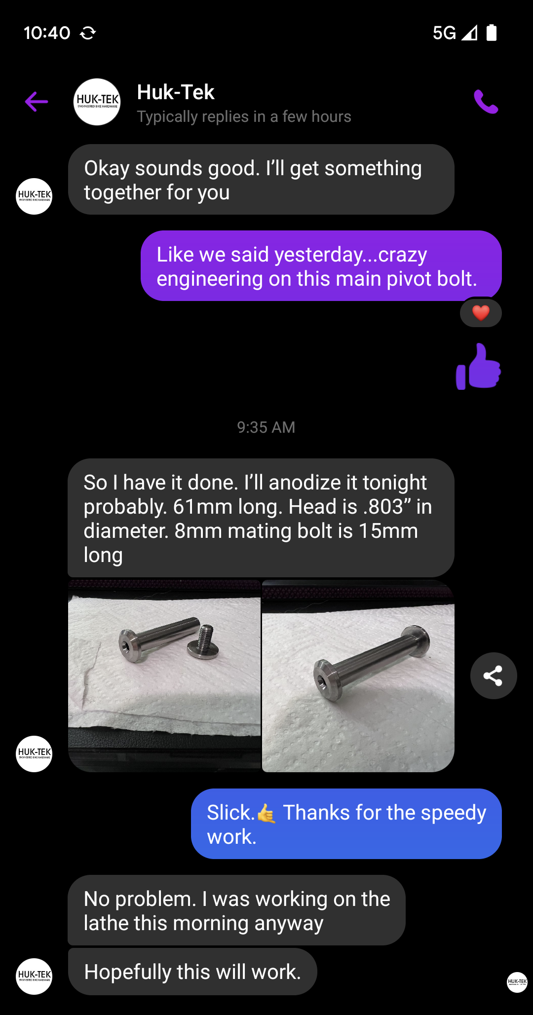

Here's what Huk-tek milled for me. It should be to my address in a few days hopefully.🤞
I'll let you know how it fits.
The suggested torque was for the new ones. Both the pivot bolt and mating bolt will be M8 with of a torque 10-12 Nm probably.
