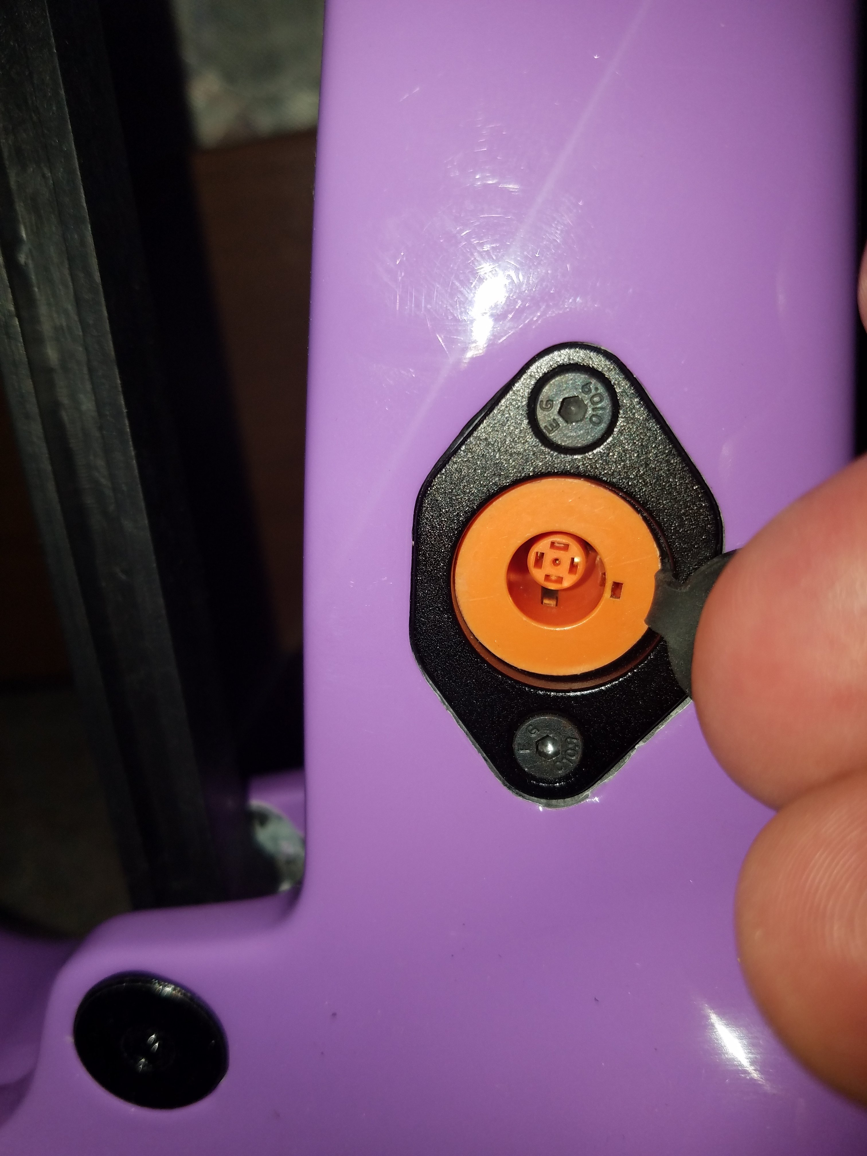

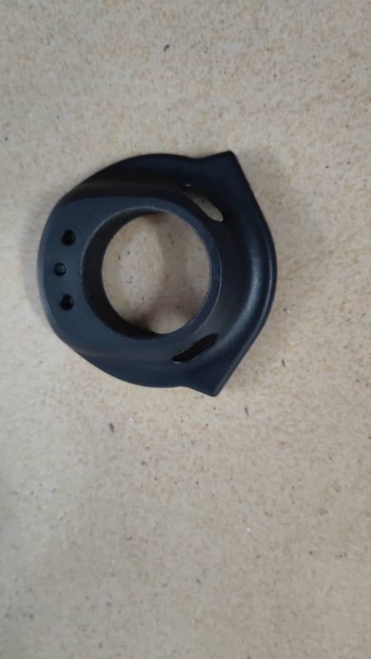

The cost of the socket and plug is only $5 but you need to be able to "ring out" the Bafang cable and cut it off soldering the wires to the new plug.
Even tho the socket is the same shape it is not exactly a perfect replacement fit. I would have to be shaved down for a perfect fit. But it fits over the top and the screws work after just reaming out the holes in the new socket a tiny bit. Then I will put just a touch of sealant under it.

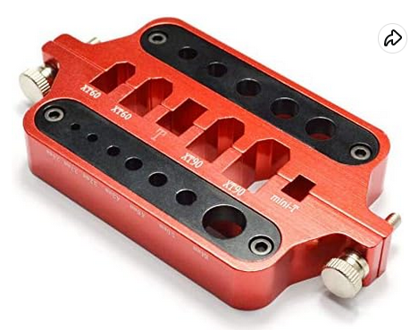

I need to learn some soldrering skills. Good time to start in simple things for practice.👍
I really hate soldering large wires. With modern connectors it is easy to melt the connector trying to get a good solder joint. I use a metal frame to hold the connector with Xt60 but most other connectors don't have holders available.

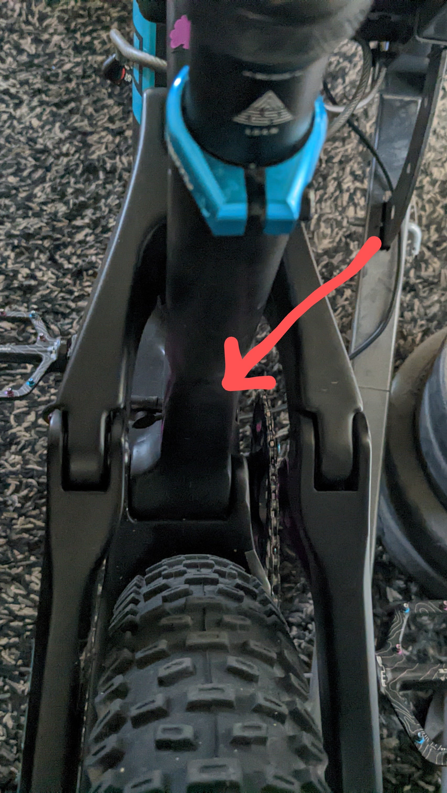

One of the frame design issues that I brought up in the past was the lack of seatstay crossbar. It does have a beefy all-carbon rocker arm. So, it seemed unusual, thinking that it's a weight savings strategy. Yet is it at the expense of lateral support? I don't know if this true, and I don't feel it in the frame performance...yet!😵‍💫😁
However, after seeing some of the same lighter, full-powered designs (both carbon and alloy) from recent Eurobike internet video, is having no crossbar sound from an engineering perspective?🤔
Any legit structural/mechanical engineers in this forum that might be able to explain at a SIMPLE level if this is indeed structurally superior to having a crossbar vs. not? Just curious as a layperson. 🍻
If You look at it from an engineering perspective, the two seatstays are working like independent pushrods if there is no crossbar. But they cant, because of the stiff rear axle, and the massive one pice rocker arm. I doubt that a crossbar would lead to any noticeable improvement here.
So, just a little extra weight to shave off then...makes sense. 💪

The CEF50 is not designed to have an external battery. Bafang may eventually design an internal battery and cabling to accommodate an external battery but the availability is unknown. The last connector shown is a DIY attempt to add the needed connector for an external battery. The connector for charging only needs to support 2-4amps but for powering the motor externally that connector is required to support 7-10 amps or more at peak.
@langharr To answer your question. There are no premade 43v batteries out there. Lots of 48v and 36v. So you have more battery choices with 36v. But there is no stock way of adding an extra 36v battery without some DIY modificatiions. The 36v and 43v batteries made by Bafang are late in being produced and are not yet available. The majority of the current buyers bought 36v 720wh batteries that were made custom for Zhaosheng by a contractor because they are available now.

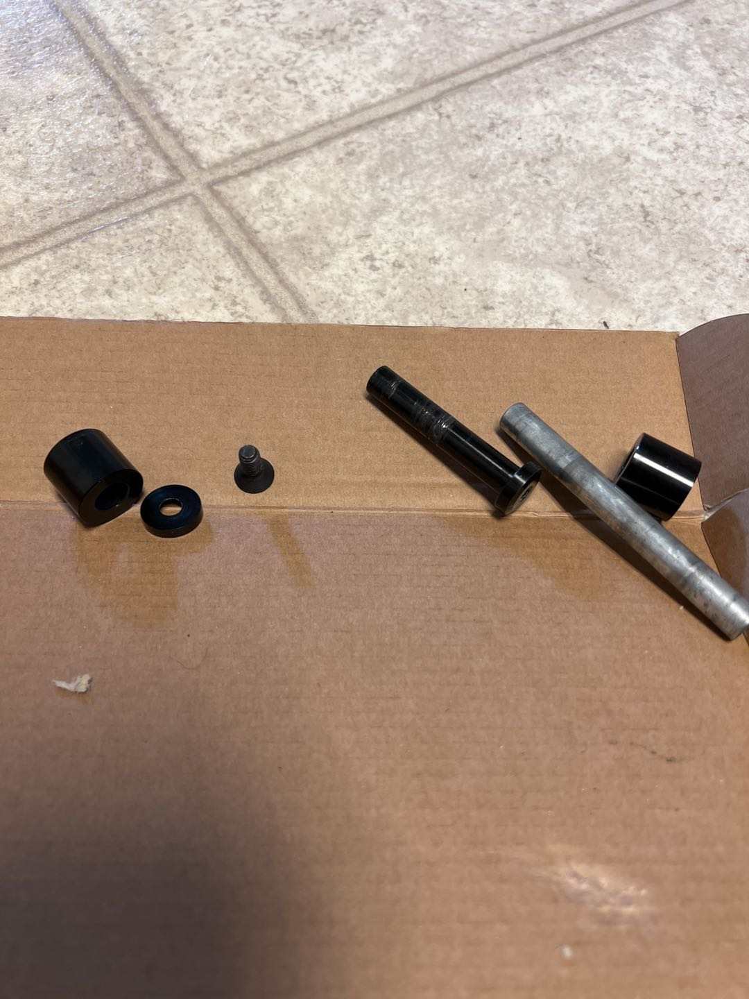

damn I just checked why my bike was creaking.. and half the bolts attaching the motor to the frame has already fallen off. Everyone should make sure to loctite every single one of those screws..
Anyone know where I can get extra motor attachment screws?

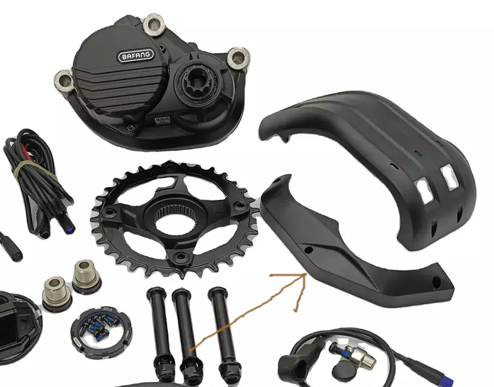

Depends. I lost my main pivot bolt screw (flat head socket screw = fhss) and speciality beveled alloy washer the second ride. Fortunately, a generic M6 fhss and M8 alloy spacer could be purchased at local Hardware (ACE). The OEM replacement is still weeks away with the new warranty front triangle. 💪
To your issue on motor mount hardware. I think they're M4 fhss for two motor mounts with the really thick black alloy custom spacers/alloy thru-bolt-like double-ended female threaded shaft bolt (defts bolt). The bigger is a M6 fhss, black alloy spacers, and steel defts bolt.
Caveat. I'm going from memory of sizes for screws. Check your remaining bolts to confirm.😇
If the spacers are there with defts bolts, fortunately the fhss should be easy to find. Steel defts could be sourced too. But the alloy spacers are most challenging and might have to be machined if you want them faster than from SZZS. 🤔

Thanks TC for always being so informative as usual. I would have never guessed those names. I am a bit confused though on your wording.
so it seems I have the following:
-most anterior set of mounting screws: steel deft bolt, the black thicker washers, and one screw that was holding it.
-from the middle motor attachment: I only have the longer black female thru-bolt-like shaft bolt. Do not have the opposite side screw / washer.
-For the rear motor attachment: I've lost both the longer black female thru-bolt-like shaft bolt and the opposite screw / washer.
Seems all I need are a couple fhss/washers and a rear bolt.
Anyone know what the length of the longer black female bolt would be for the rear motor attachment?
