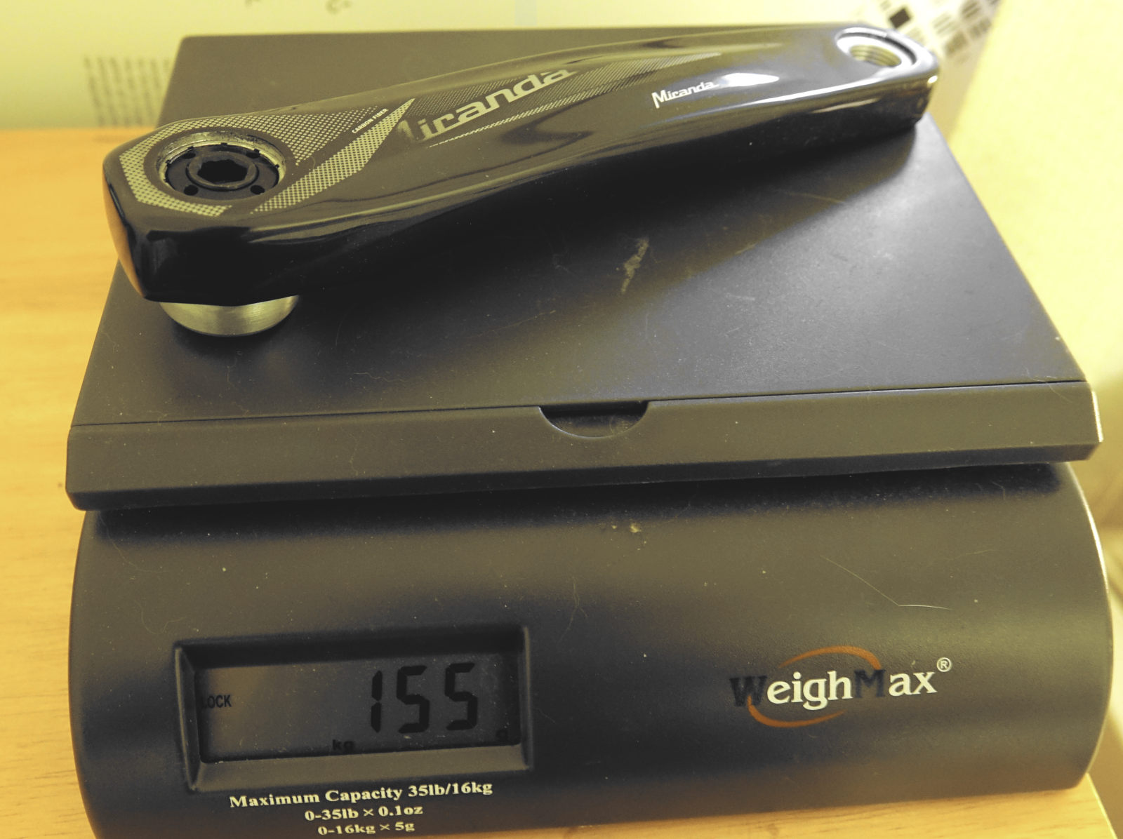

Miranda crank is really nice. Not as light as advertised but still very light.
