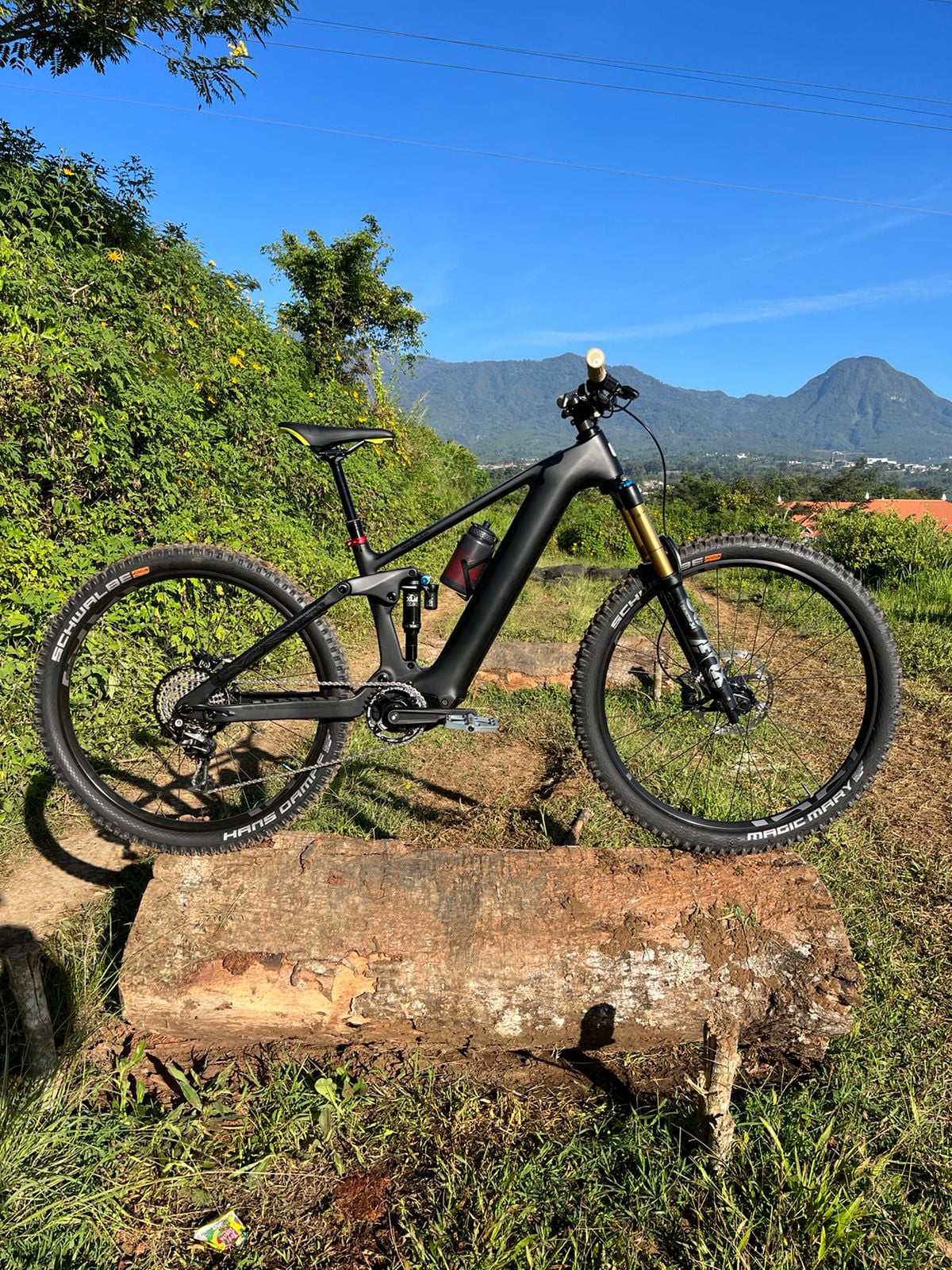

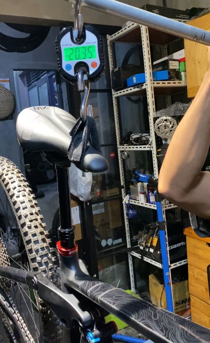

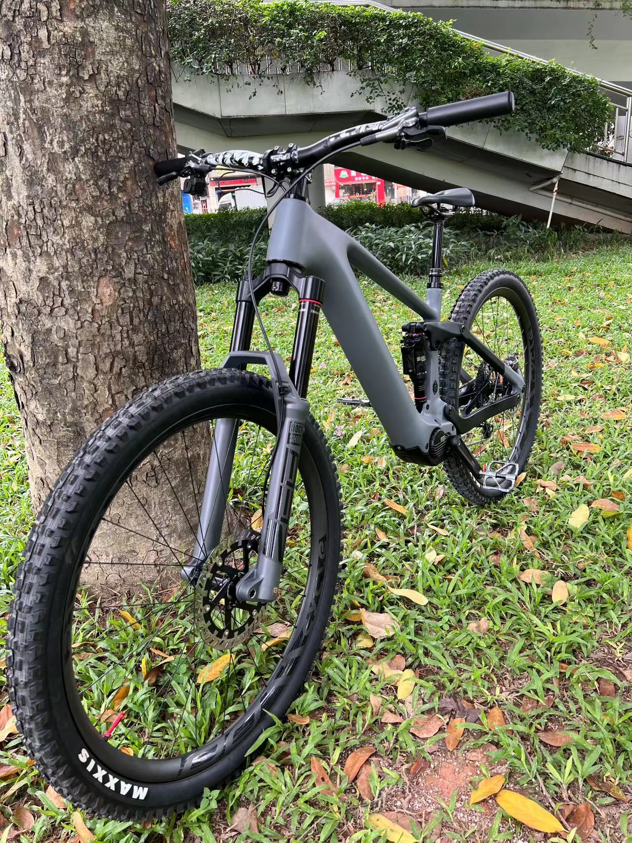

Finish my build and have short test ride. Feel comfort with the frame, size S as I just 160cm height. Motor feel not as smooth as my M510 FC 2.0 but just a little, maybe need firmware update (will find it).
Total weight 20.35kg with 720Wh battery, Fox 36 Kashima, DPX2 210x50, Mullet E13 LG1 Alloy wheelset with Spank hub, Sram X01 11 speed groupset, Magura MT5 Brakeset, Renthal 35 Carbon Handlebar n Stem, Syncross dropper seatpost and cheap pedal and saddle.

Nice!
How does it feel with the mullet setup?
Fox at 160mm or 170mm?

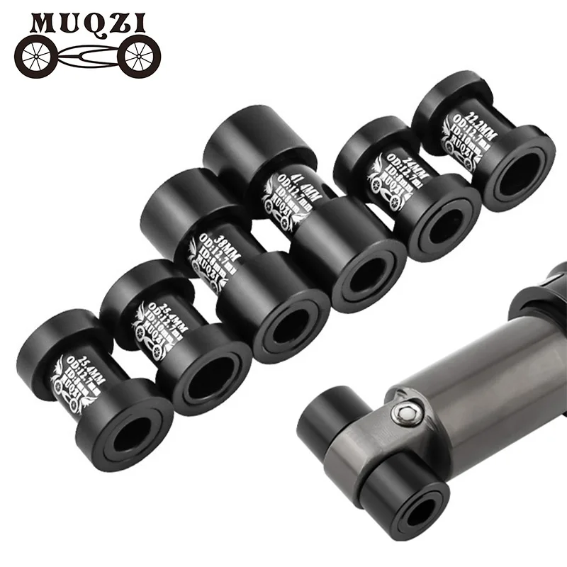

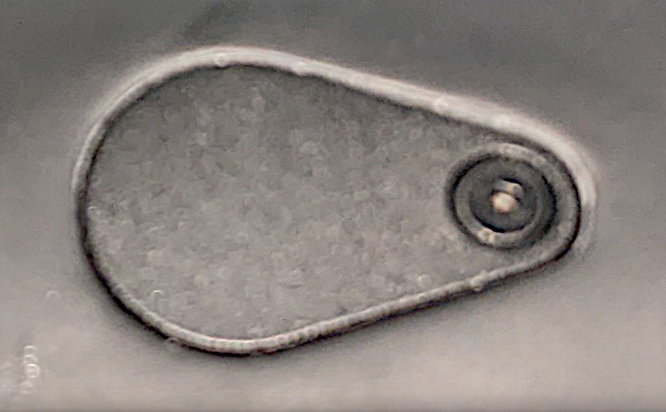

for those that have received their frames, I have a few questions that would be appreciated if you could verify:
1. Did you use a 8mm x 22mm or a 8mm x 22.2mm bushing on your rear shock?
2. Did you receive a power button for your top tube or just a metal plate covering the hole? If you did get a button, please describe it or post a picture. Did anyone get the Bafang power button?

1. 8x22.2, exactly this ones:
2. Just a metal plate. I want to get the DP E171 and just use that instead of the DP E180 that came, like the cockpit as clean as it can, dont care of only having 3 power modes instead of 5
