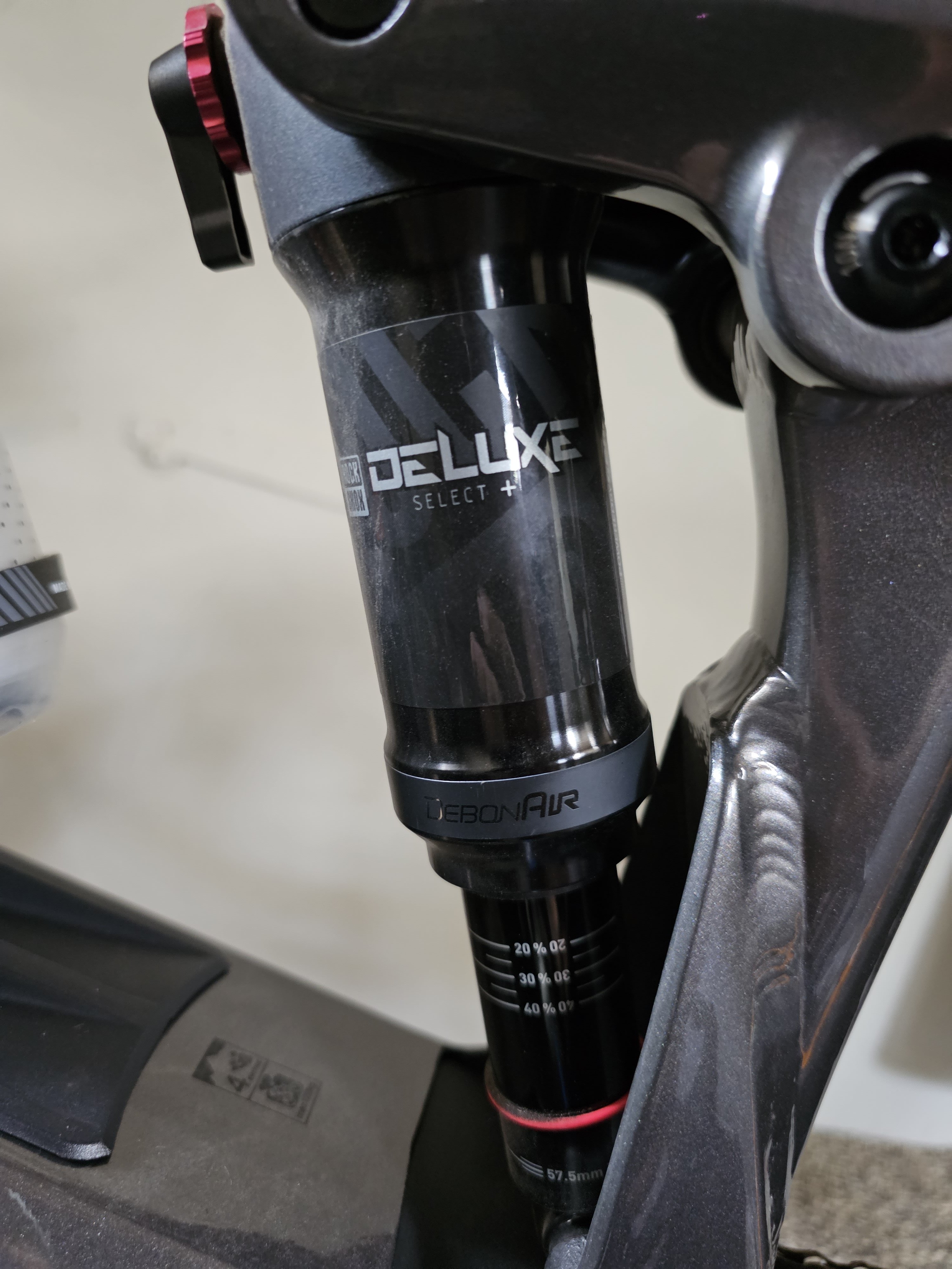

I think the Float X should fit. My MegNeg is as thick as a coil unfortunately.
How wide is that body from the megneg?
Im not sure if i have enough space to fit one.

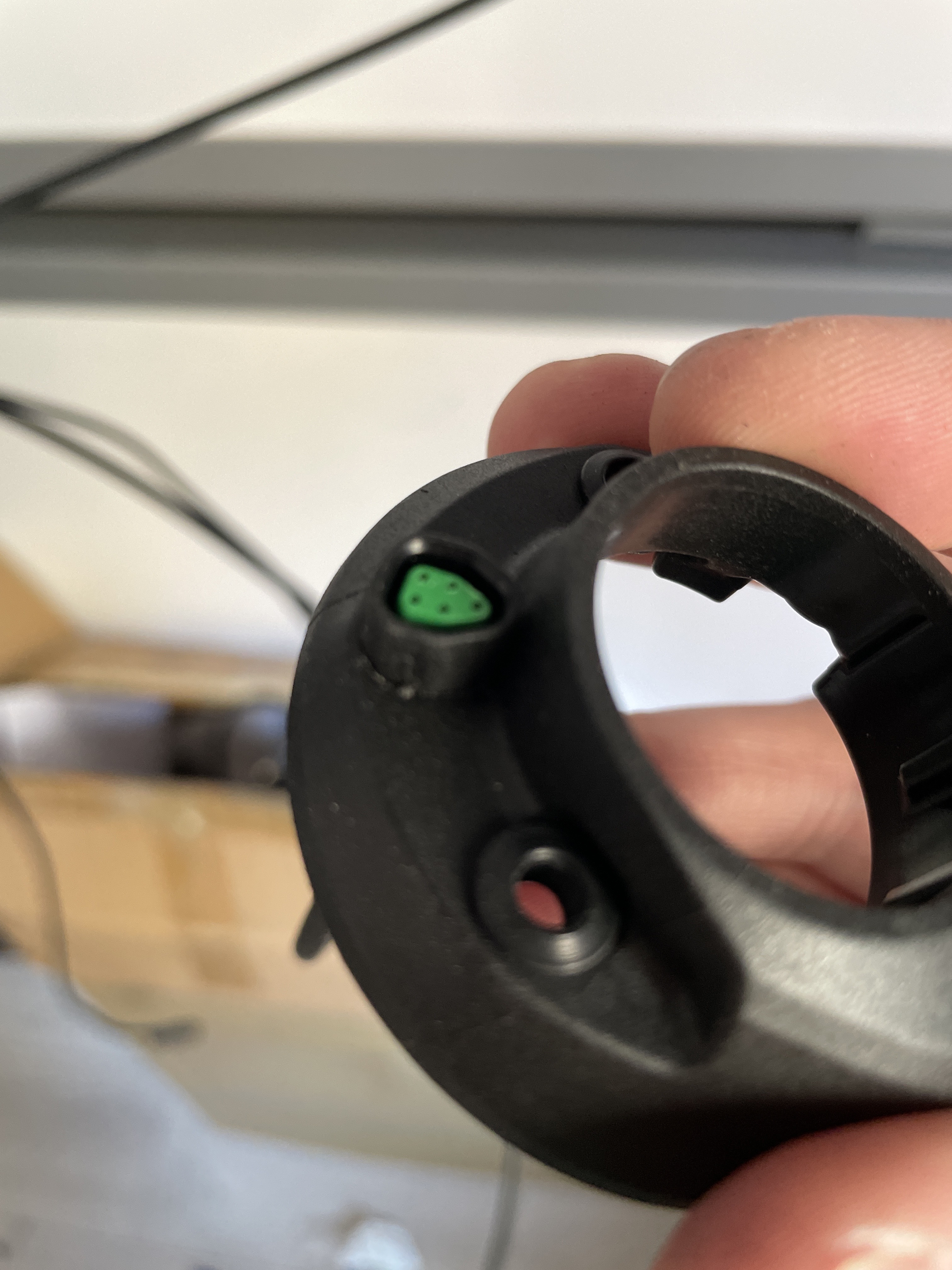

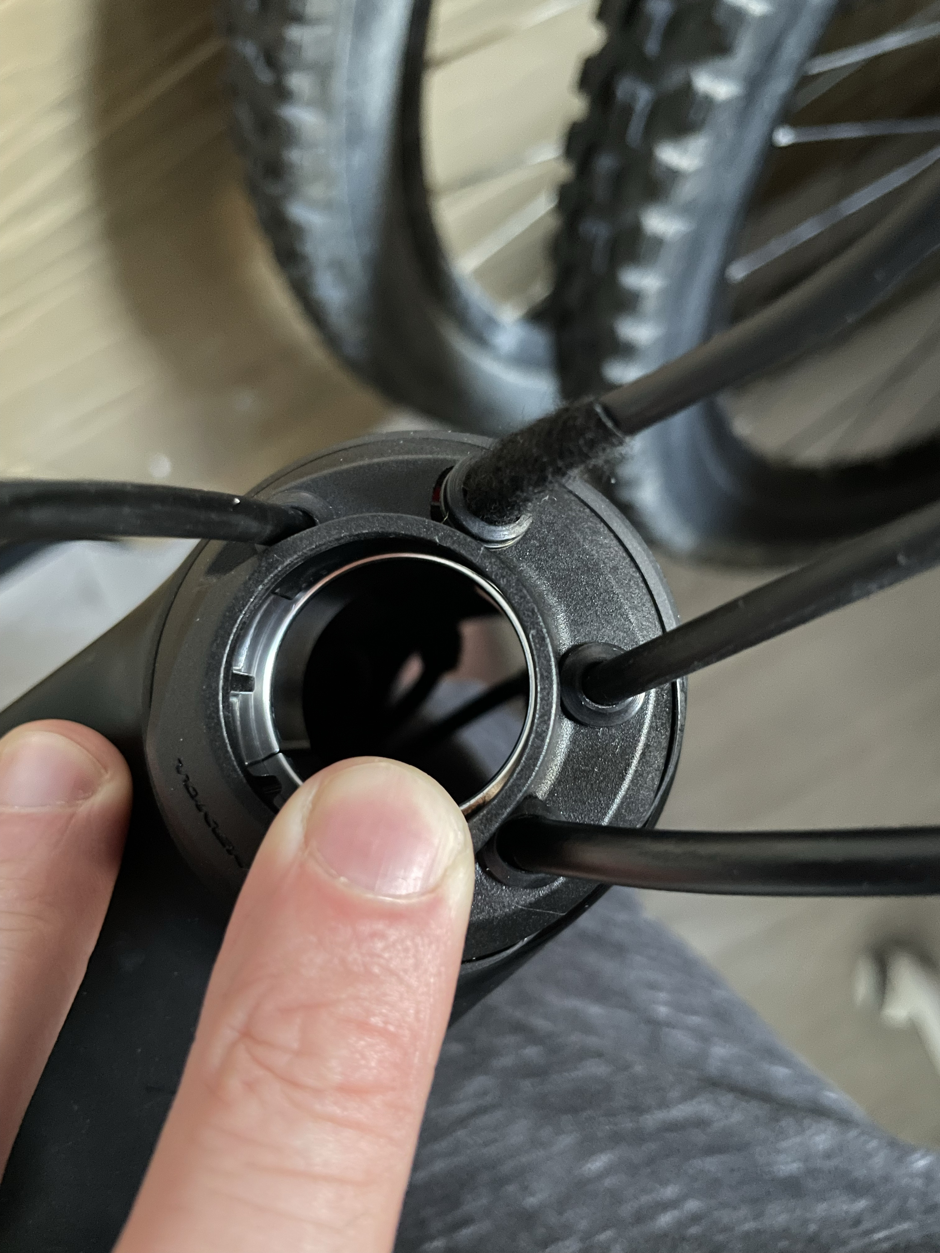

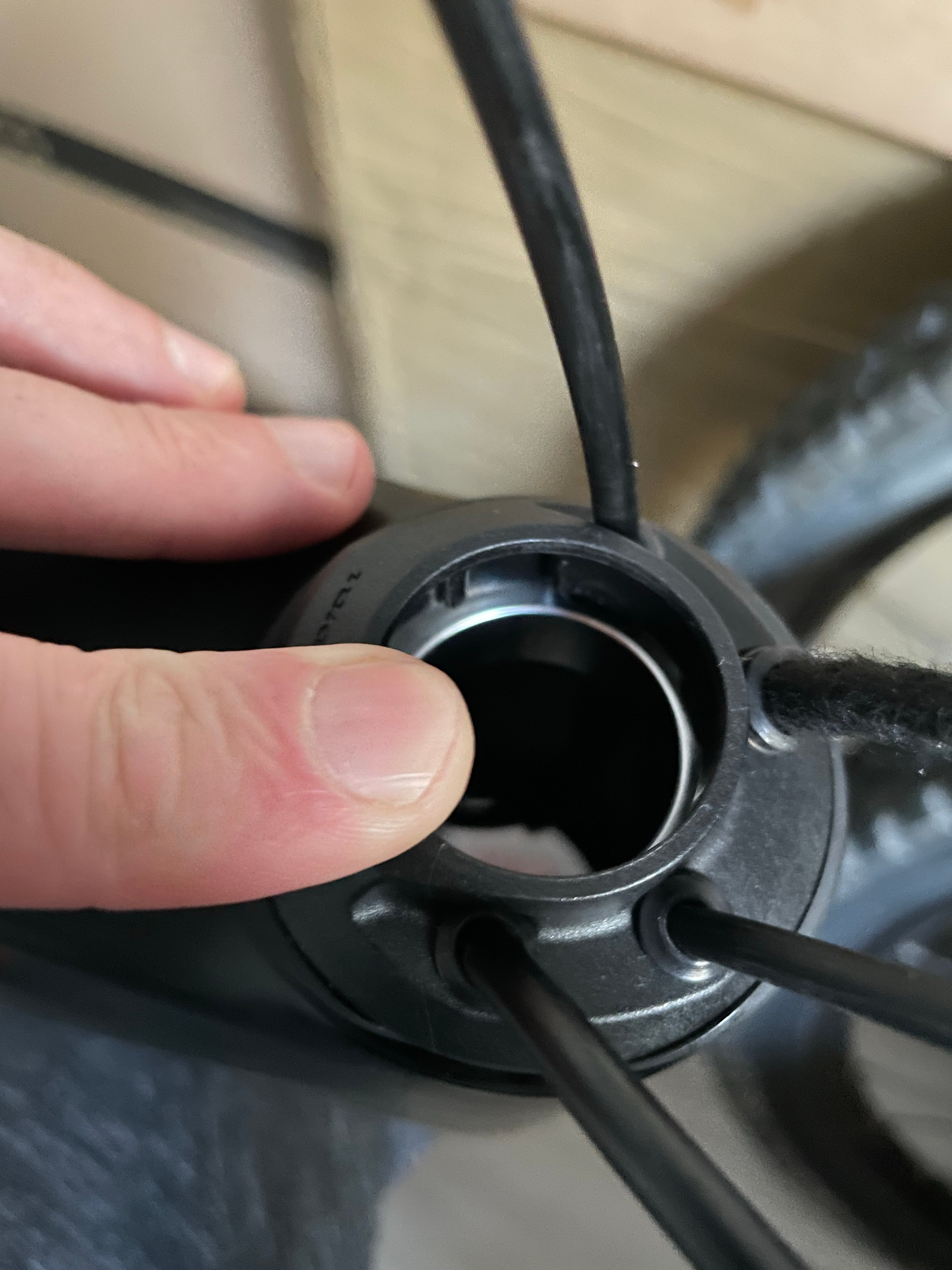

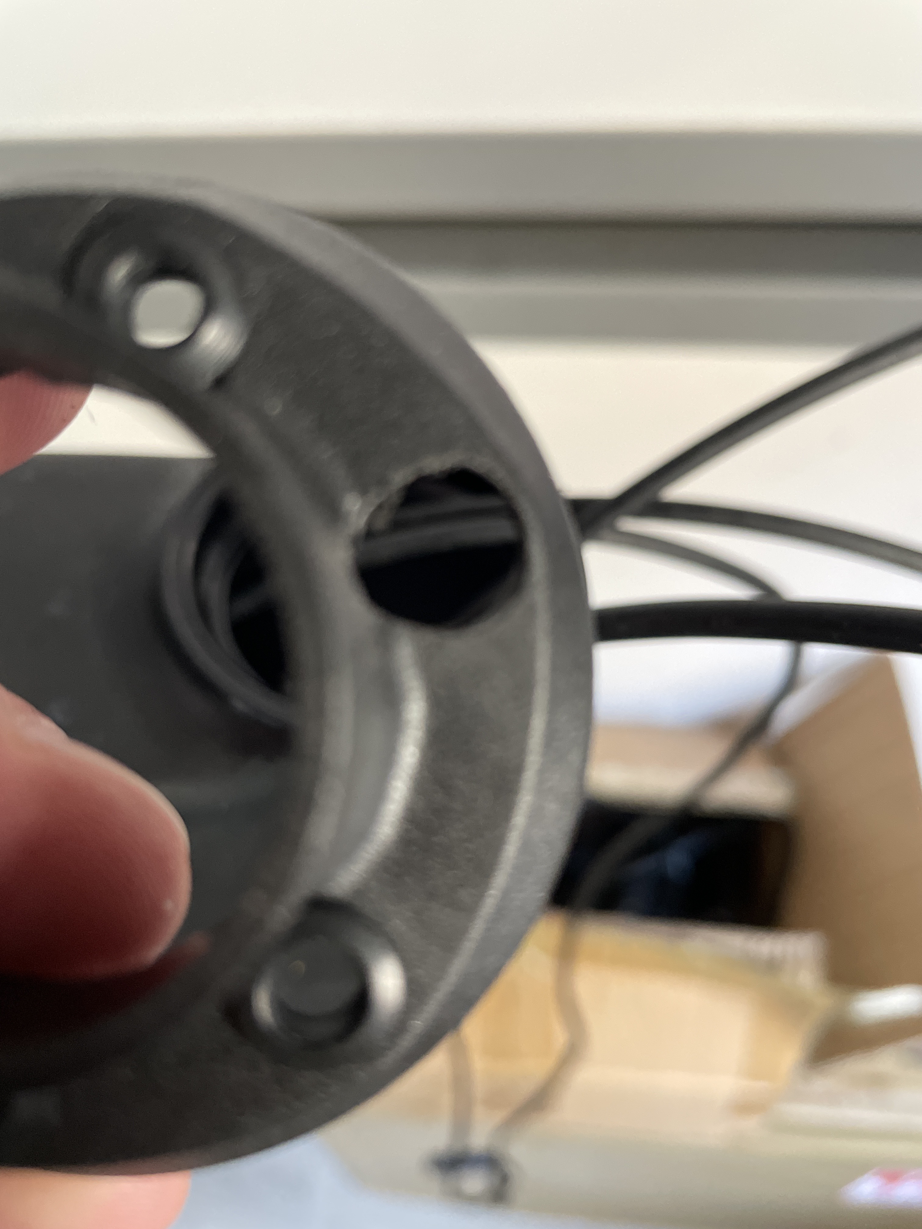

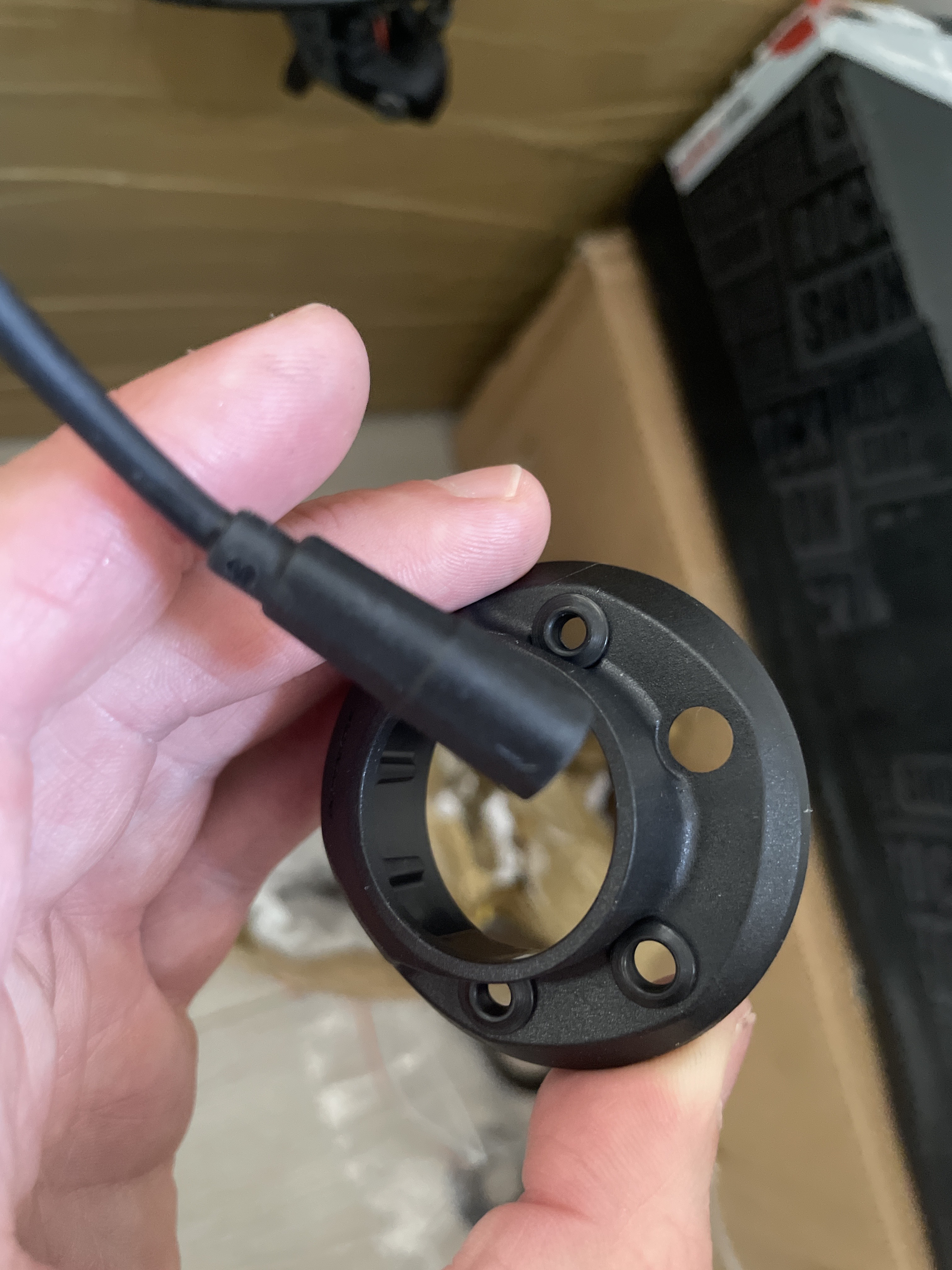

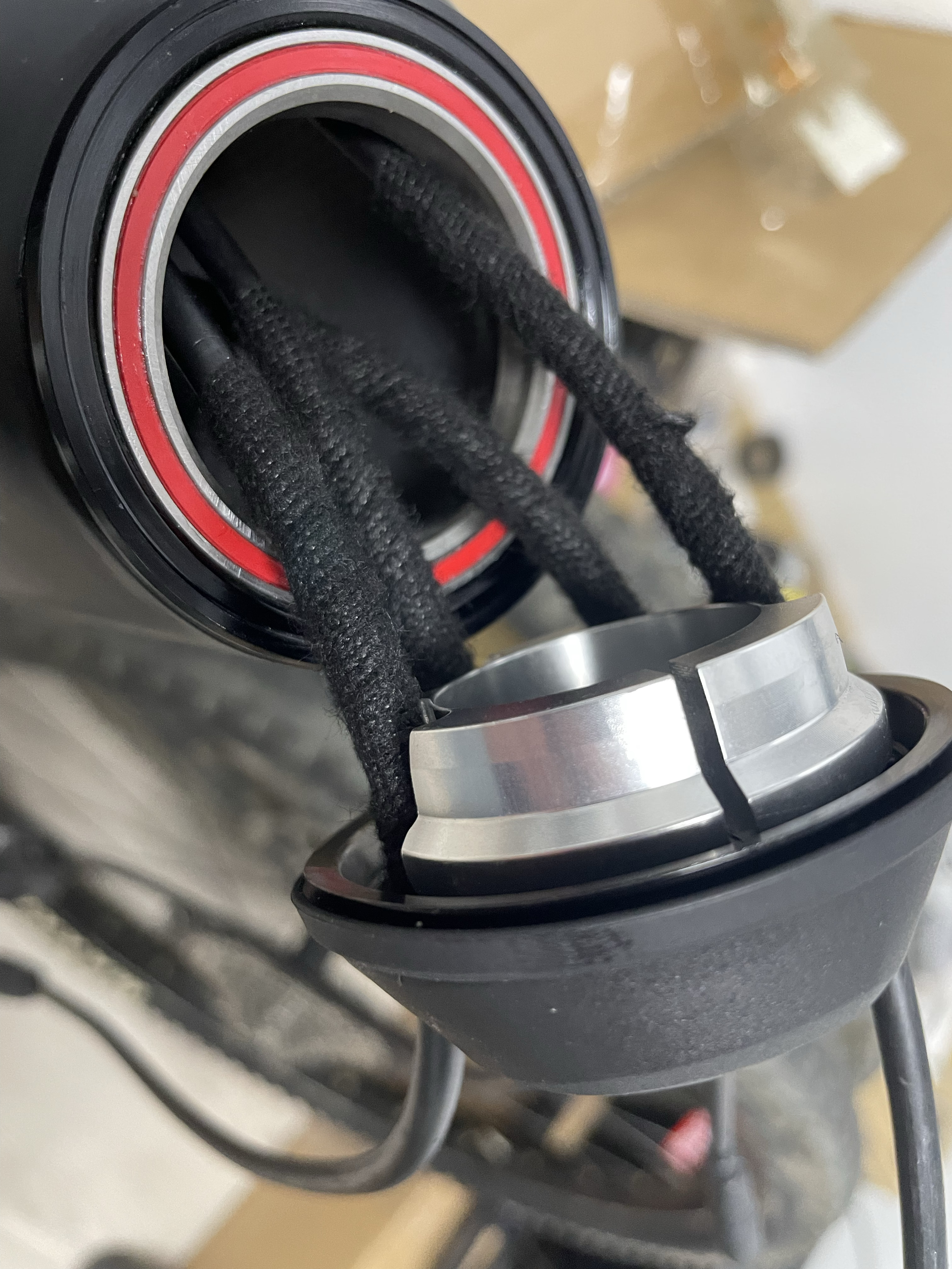

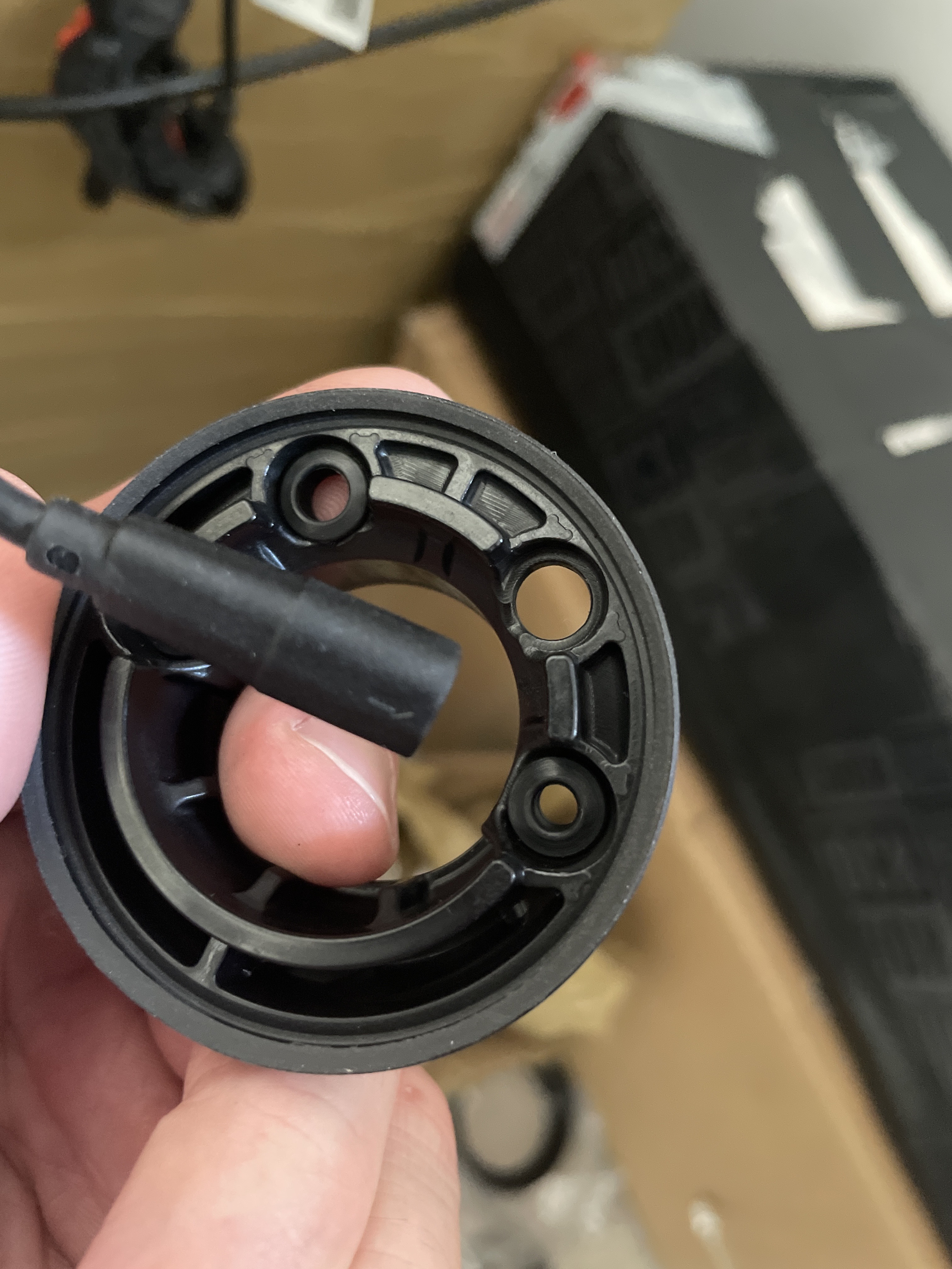

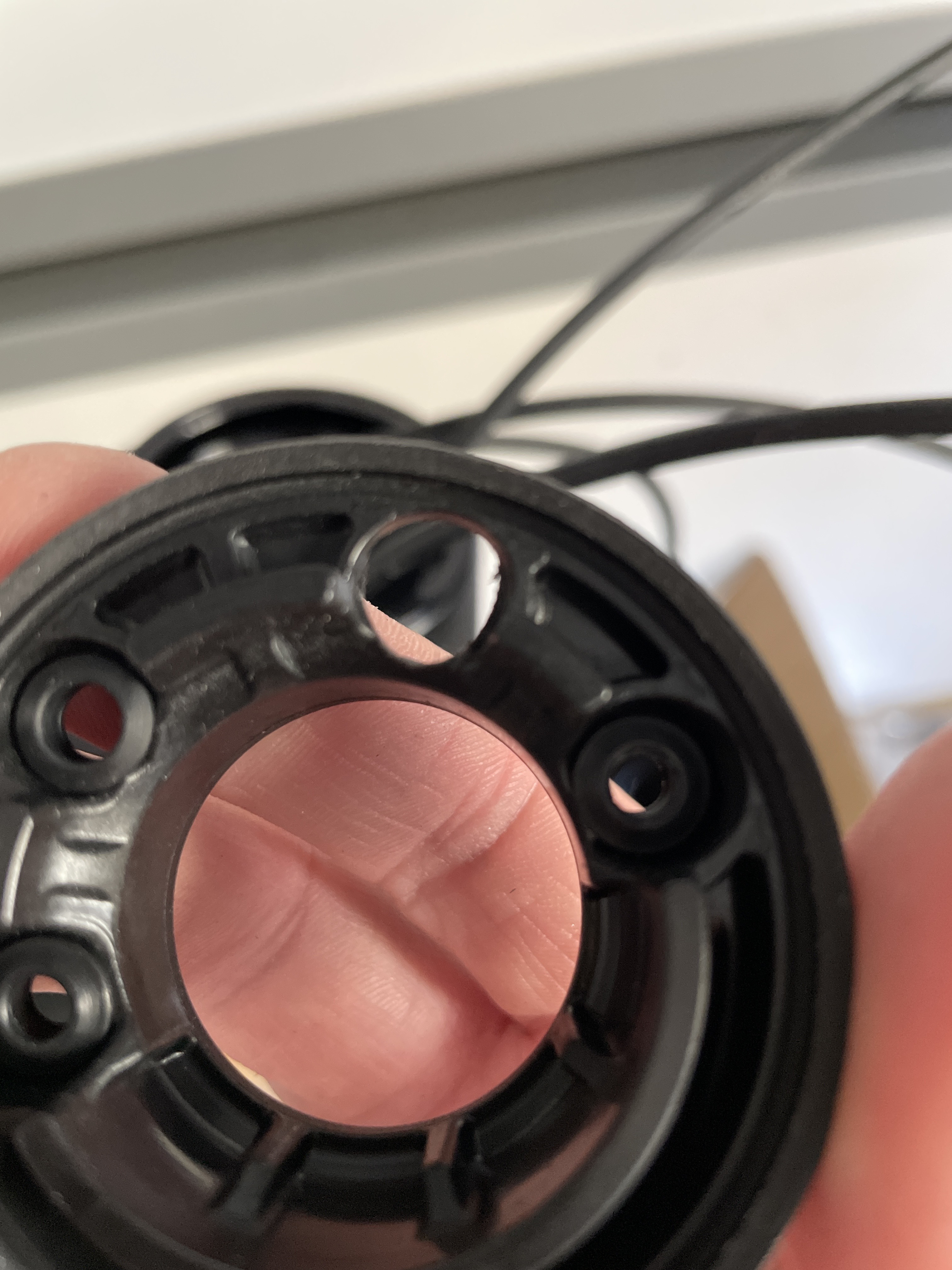

Today the Nukeproof/token headset arrived.
For the remote plug (dp e181) to fit the plastic in a whole needs to be trimmed a lil, apart from that it fits OK.
I’ll take advantage of disassembling and route cables better, add some noise insulation and upgrade the shifter to xt.
Also upgrading the fork to a lyrik for stiffness
temon10
Feb 8, 2022
677
566
Malang, Indonesia
any picture or video?

I am having my Fox Float X2 210 x 55 stroke reduced to 50mm. It has one volume spacer in it now should I have them leave it in?
I don't feel comfortable taking the shock apart myself.
Leave it. Adding or removing a volume spacer is a job that doesnt even require tools

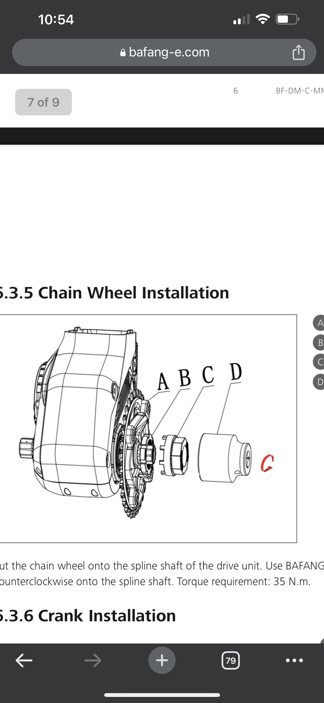

Anyone know if we need a special chainring tool to tighten it? I’m not sure I received one if so..
Part c and d?
