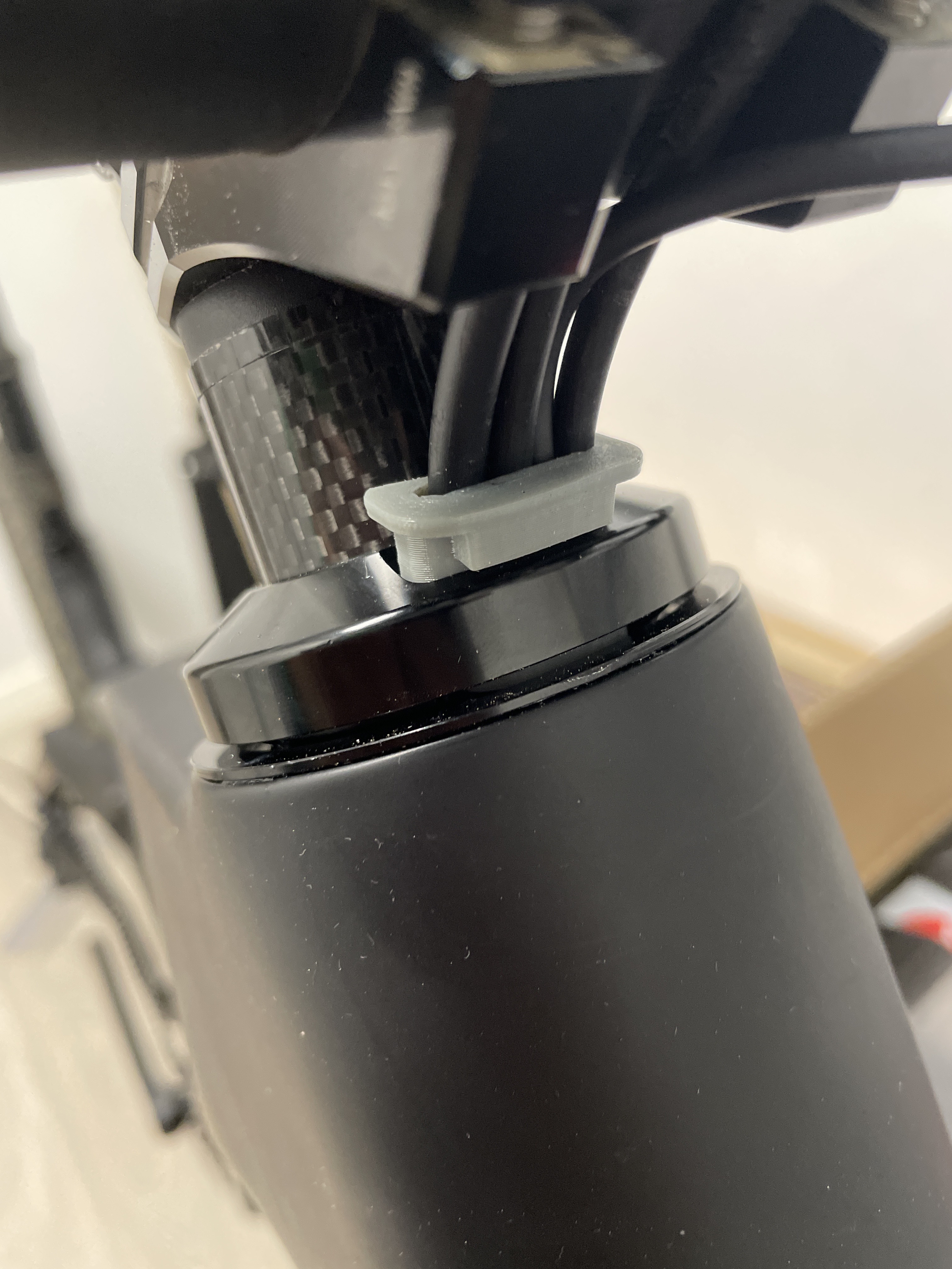

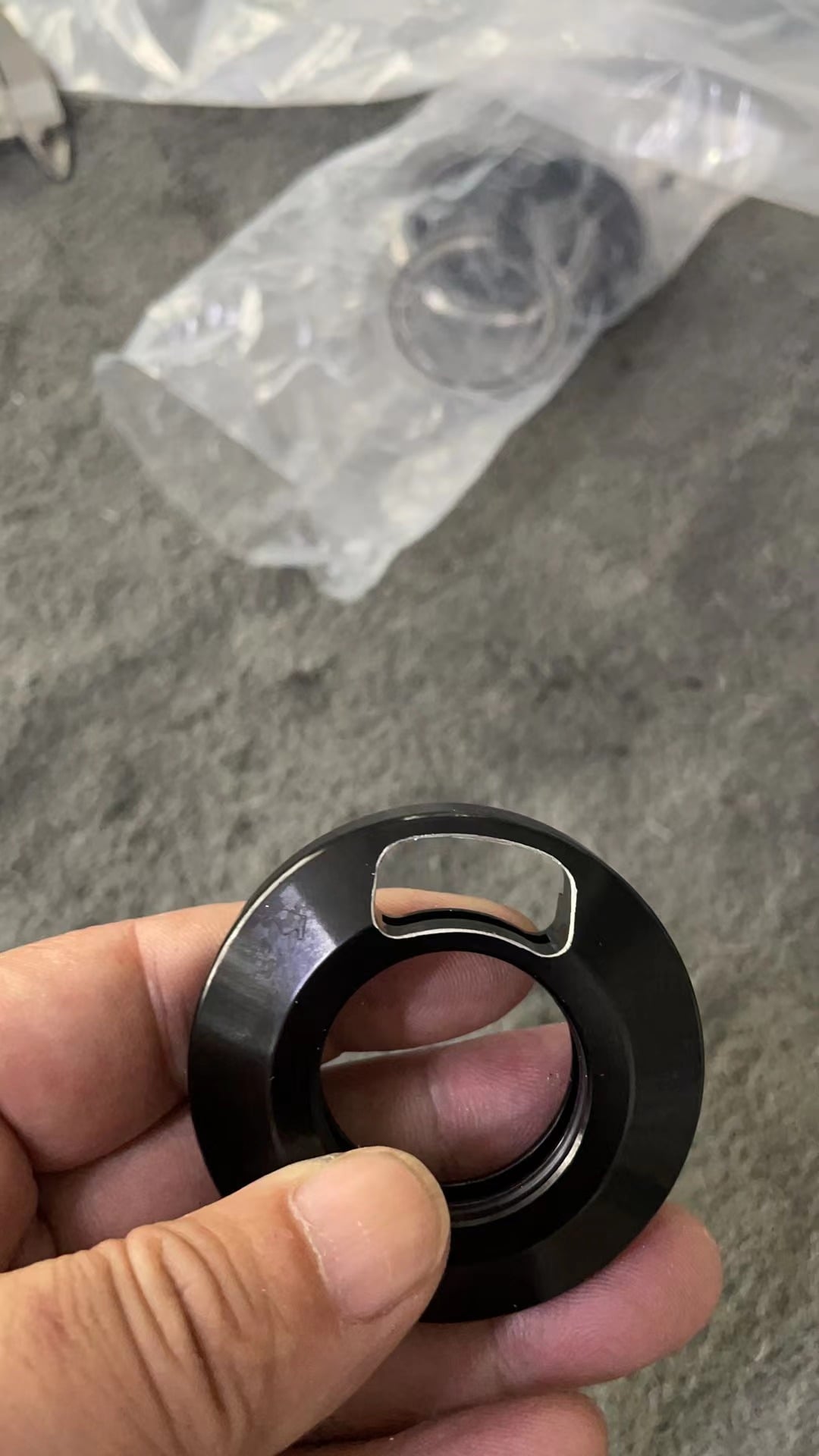

I did get this email from Linda showing the top cap filed to reduce risk of cutting the cables.
Yes in the main spec thread about third picture down shows the headset pieces but not in high res.
That's a nice big opening with a rubber/plastic grommet insert.👍
One thing to consider is that the DPC245 display plugs (green triangular male end) is fairly sizable. It will easily fit and feed through the stock cap opening. And now that they blunted the sharp edges...less work on the build.💪
However, on some of the aftermarket ICR headsets, you may have to drill out one of the more narrow cable ports to pass through the connector and reseal it with your favorite method. It's a little bit of an extra pain maybe?🤔

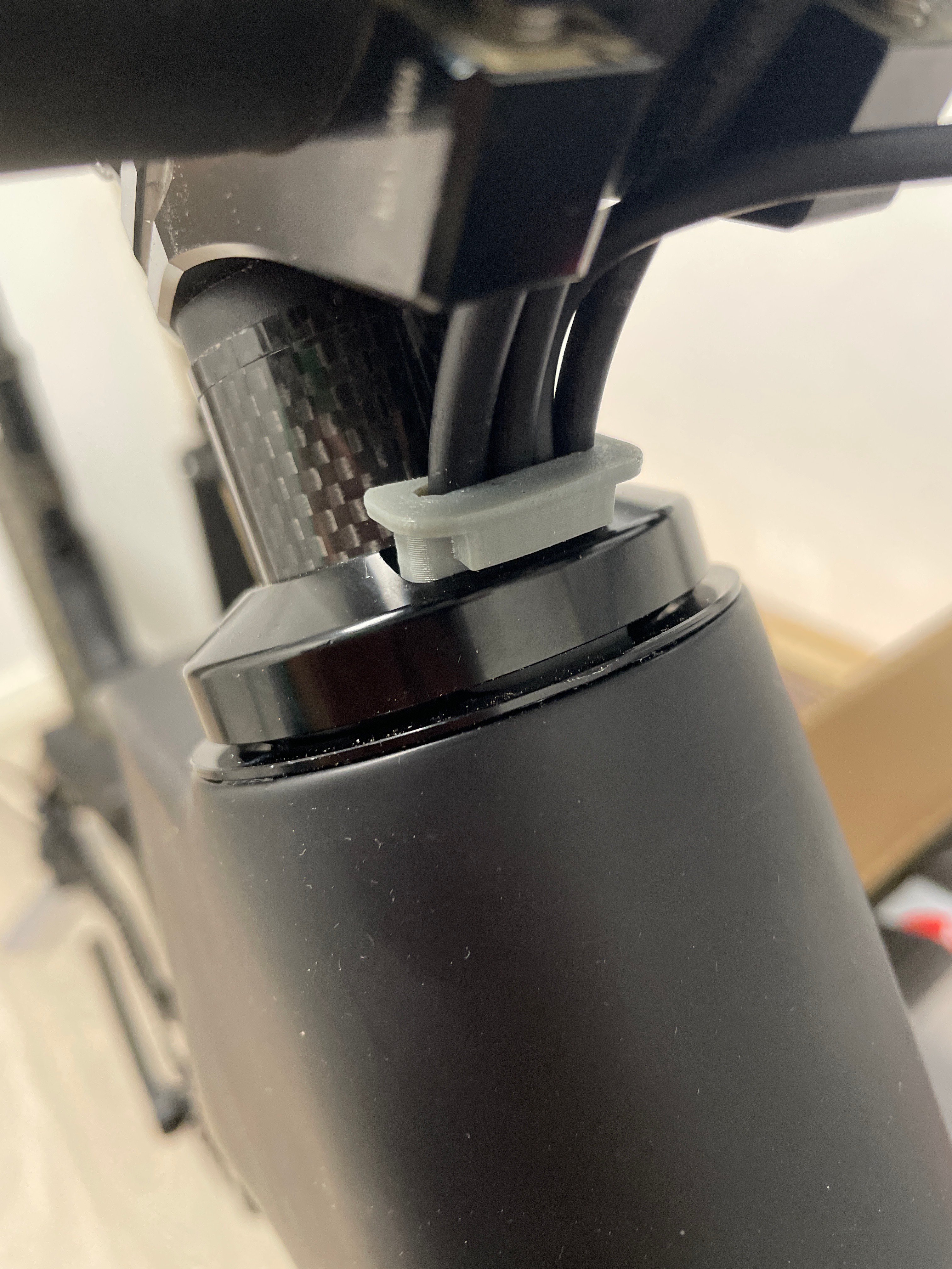

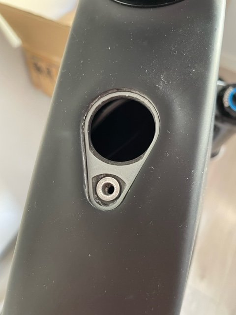

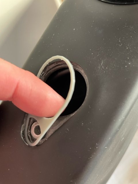

My fix was to 3d print a TPU grommet so cables arent damaged but i’ll order a better one.
Today im posting all STLs

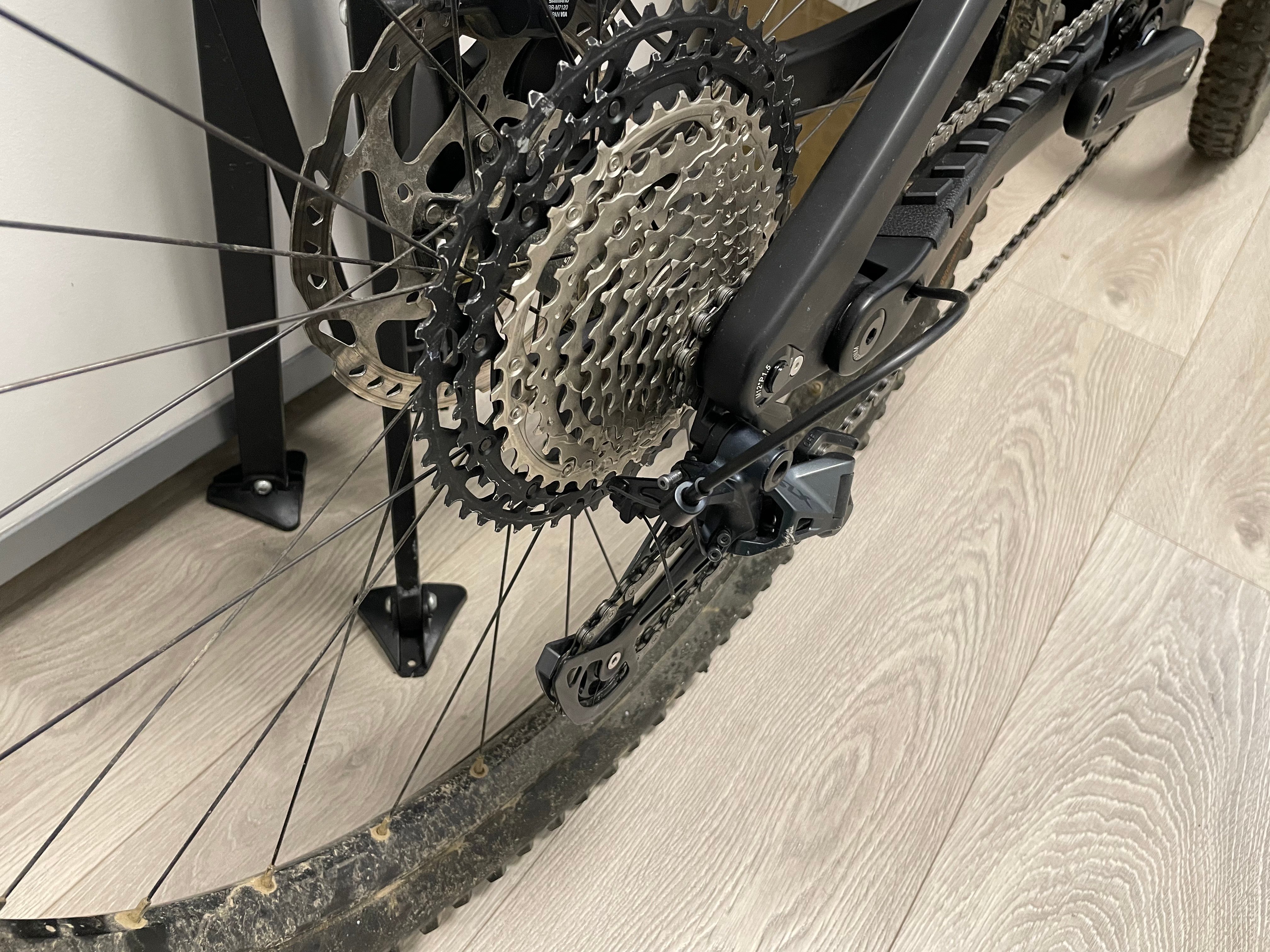

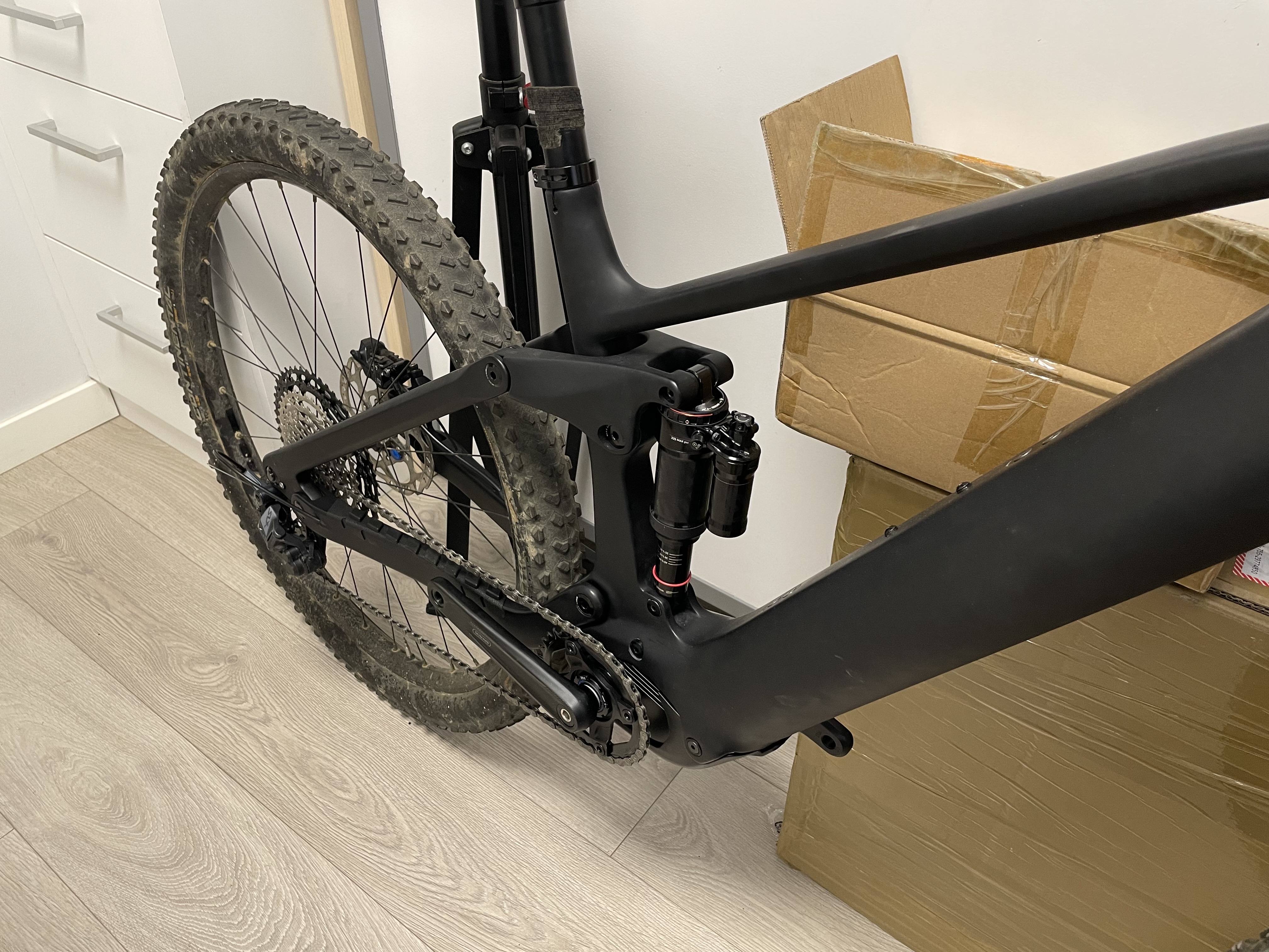

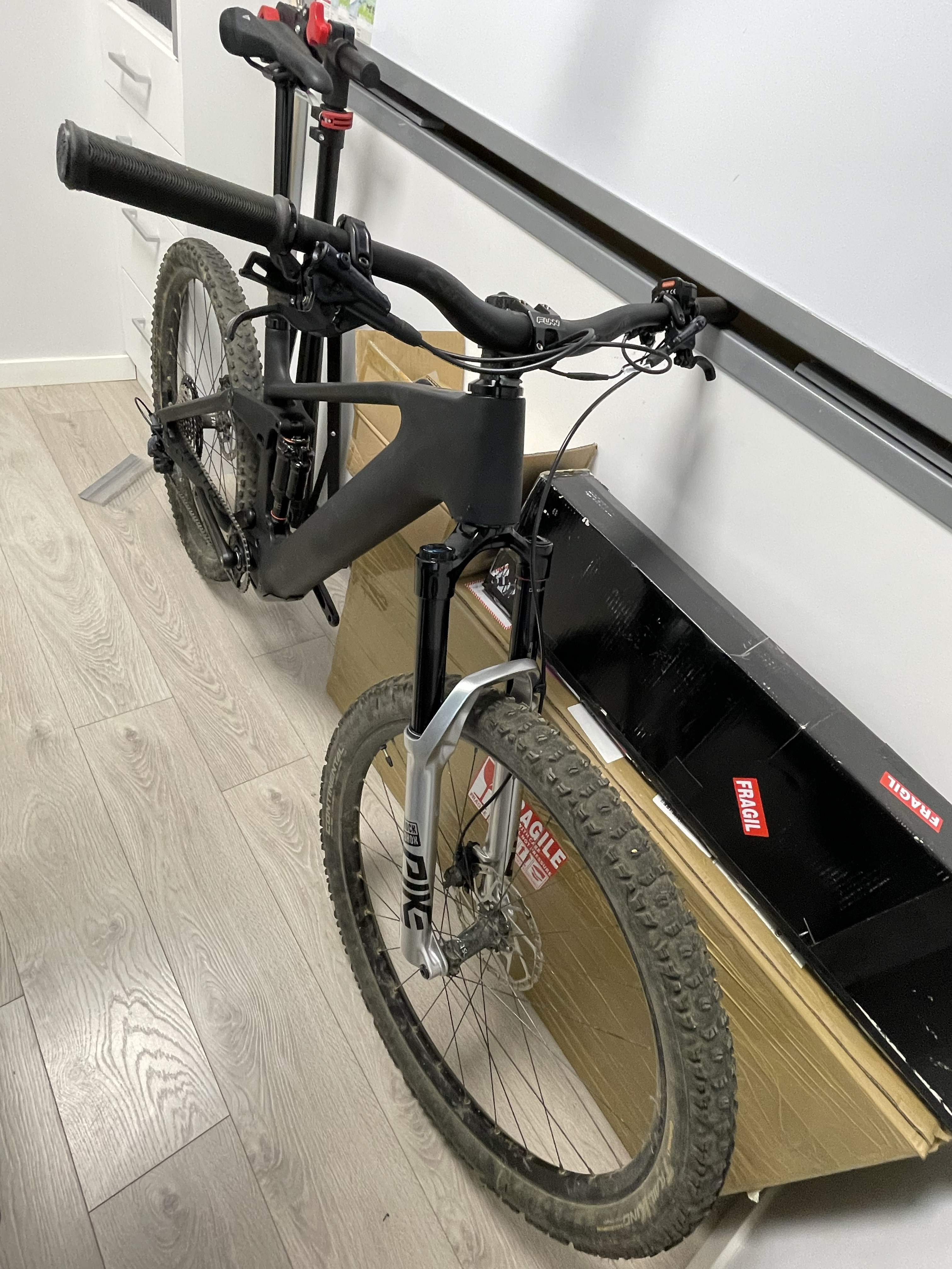

Almost there, today I should receive the RT-EM600 rear disc that includes the magnet for the speed sensor (magnet didnt came :/ ). Then a test ride.
it doesnt have the final wheels (1900g is this set) nor the carbon handlebar, lighter cranks or seat but it weighted 18.4k
Im pretty sure that it can loose 1 more kilo after the upgrades.

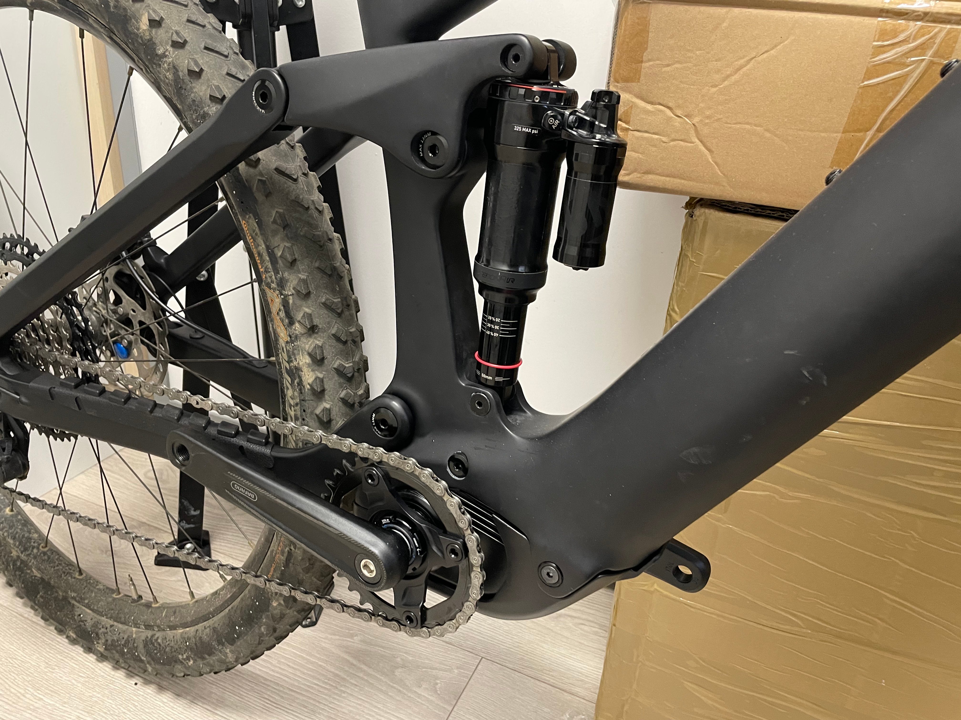

Here are all the STLs I used for the CEF50 frame, grommets and BT F014 battery support, any doubt or modification just let me know and i'll asses it :)

18.4kg! wow, well done, with the piggyback shock and "mid-heavy" wheels !
I'm quite impressed also!
Carbon cranks + lighter chainring: 200g less
Carbon wheelset: 400g less
Renthal carbon: 100g less
XT derailleur: 30g less
Saddle: 200g less (I use a 110g one always)
XT Discs: 100g less
That would make a nice 1030g less, resulting in what I was aiming, a 17.5k emtb :)
I will be drawing the top tube button cover gasket also today and uploading it on thingiverse. Want to make the bike as rainproof as possible, although here it never rains it'll benefit everyone that has a CEF50 in a more humid place.

What tires and cassette you're using ?
Full build for now:
Rockshox Pike ultimate RC2 160mm 2022
Shimano SLX discs 180/180
Renthal Fatbar 35 Alum 780mm handlebar
Funn Duro 45mm stem
Shimano SLX M7120 brakes 4pot
Shimano SLX M7100 derailleur
Shimano SLX M7100 shifter (got an XT replacement here, same a rear derailleur)
OneUp 180mm dropper post
Rockshox Superdeluxe Ultimate 210x50 shock
Shimano XT CS-M8100 cassette 10/51
YT Saddle
SLX CN-M7100 chain
Wheels (build them an year ago as a spare set)
ZTTO M1 hubs
Sapim D-light spokes
Brass nipples
DT Swiss M502 30mm 29"
Continental Trail King Apex / Mountain King protection tires
Octamousse rim protector

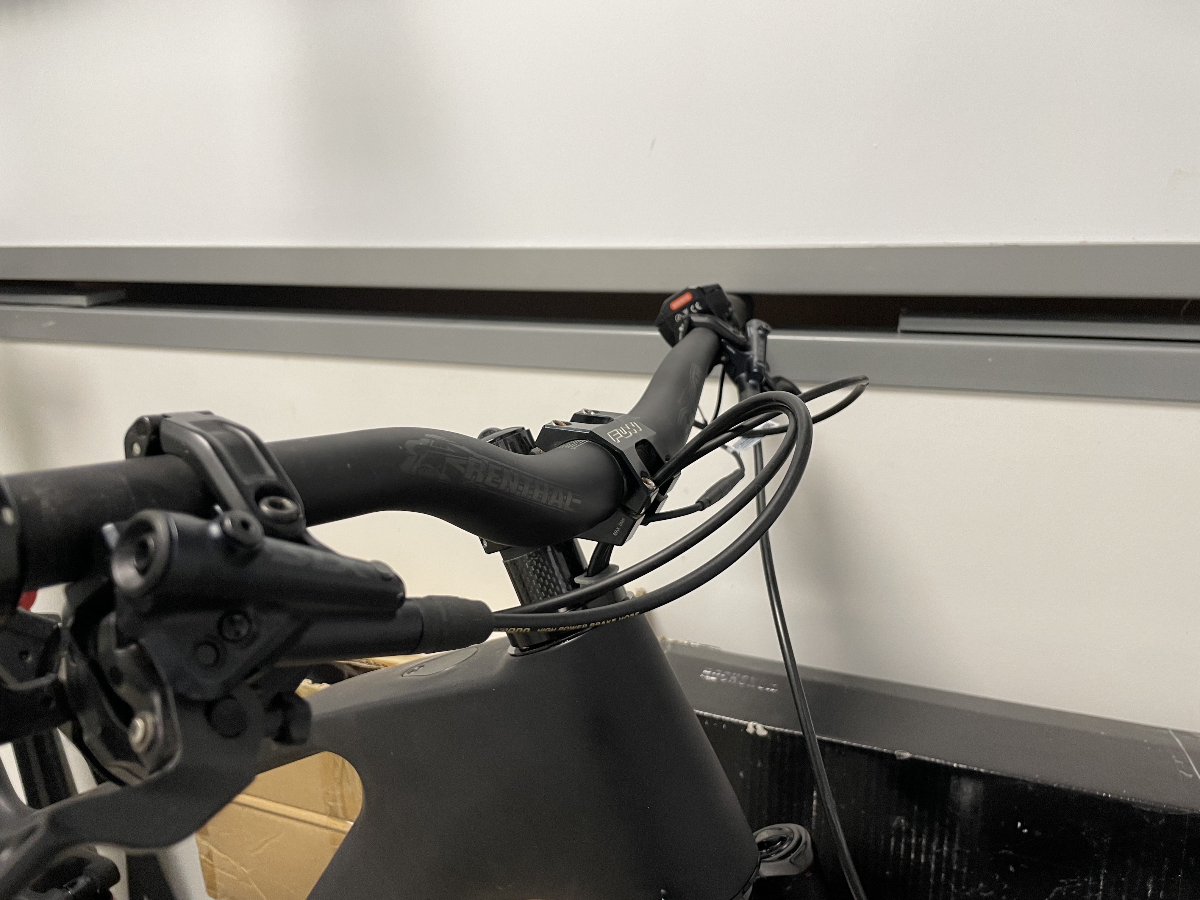

After bench testing the DP180 controller was throwing a 21 error (speed sensor).
I thought it was the custom magnet I was using but no, looks like the connector that's hidden inside the rear triangle was incorrectly connected (sideways). Had to straighten a pin, connect it properly and also added a layer of electrical tape so it keep tightly connected. I'll just order a spare "SR SD071.02" just in case.
Now tested it and works properly in the bench, even walk mode and error not appearing anymore. Either way since amazon is delivering the rear disc with magnet today I'll wait for it to arrive, change it and go for the first ride.
Photos don't make justice to the frame, but honestly its REALLY good looking, I love it.
To enable walk mode: Go to the no assistance mode, click twice the "down" button but on the second click keep it pushed. walk mode will be on until you stop maintaining the button pressed.

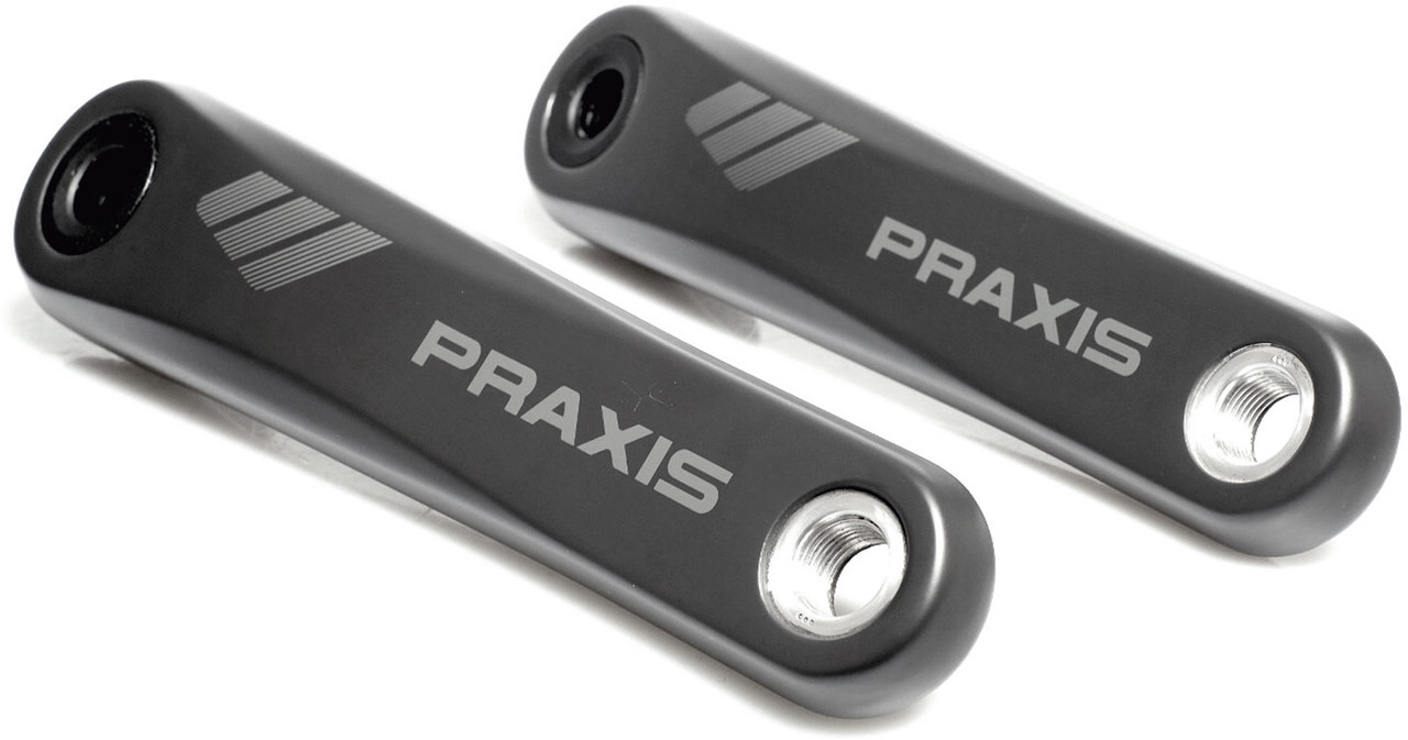

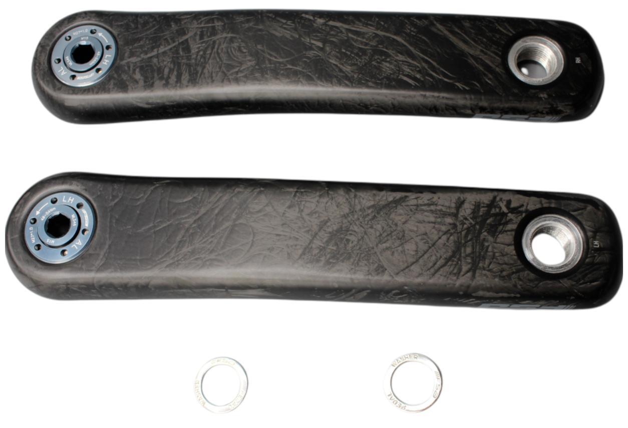

Hello how do i know what crankarms fits the m820? Any tips on lightweight pairs?
The M820 uses standard ISIS crank arms.
Miranda claims to have a lightweight crank and yet does not give the spec
They appear to be having a half price sale too.
"Try to find a lighter e-bike crank, we dare you! Our carbon fiber e-bike cranks have been engineered to produce a carbon fiber structure featuring an internal, proprietary crash-resistant composite. The design and materials composition make this crank — with its super strength-to-weight ratio — the lightest e-bike crank on the market."
FSA has
FSA SL-K CK-8685-1 carbon crankset for eBikes with ISIS mount. With their low weight, the hollow carbon crank arms set standards for your high-quality eBike. As the icing on the cake for your bike, they are suitable for all eBike drives with ISIS crank mounts, including Bosch, Yamaha, Fazua and Brose.
Model features:
Hollow formed carbon crank arms
  • ISIS bottom bracket mount
  • completely black visible carbon finish
  • Crank length: 175 mm (in our other offers you will find this crank in the lengths 170 mm and 172.5 mm)
  • Weight: 326g
  • including integrated crank screws
  • including FSA washers for the pedal mount
Raceface era
Compatibility Bosch Gen 4 (optimized), Bosch Gen 2, TQ HPR50 (optimized)
Includes Pedal Boots & Washers
Crank Arm Material UD Carbon, Stainless Steel Wear plate 
Weight 370g complete crankset
Weight Conditions 165mm Arms + Pedal Boots + Washers
Spare PartsCrank Boots - 8 Colors
Praxis
SPECIFICATIONS
INTRUCTIONS ⚠️ VIEW MANUAL HERE
E-CRANK
CARBON
CARBON E-CRANK for Specialized eBike
For the standard : Levo, Kenevo, Vado, Como, Turbo Levo with steel ISIS Spindle motor.
BUY THIS IF :You are wanting to change length or upgrade your Specialized eBike to a Carbon eCrank
For the : Levo, Kenevo, Vado, Como, Turbo Levo with steel ISIS Spindle motor.
MOTORSpecialized Motors on the Levo, Kenevo, Vado, Como, Turbo Levo with steel ISIS Spindle motor.
NOTE – If you have an "SL" model with SL 1.1 motor with black alloy spindle GO HERE
MATERIALLeft & Right arm set | Carbon Fiber | Rubber protective boots included / Adhesive scuff guard included
AVG. WEIGHT375g (165mm w/boots)
Q-FACTORQ = 182mm
MAIN BOLT8mm AL main crank bolt for Install/Self-Extract | 50Nm torque
Our eCranks with ISIS Spline use our replaceable M24 alloy Main bolt/Self extractor
VIP NOTECheck your Specialized motor spindle type - See Graphic above!
These specific eCranks are made for Specialized eBikes with steel "ISIS" spline spindle motors.

I'm thinking on going towards the praxis since they're 375g the pair.

Weird that Miranda claims the lightest yet does not print what the weight is of the cranks.
