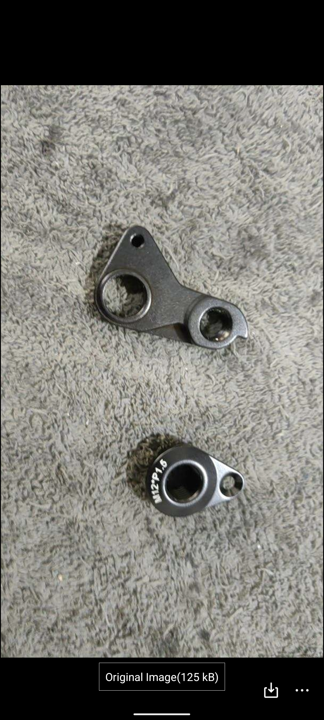

How common is this hanger? Can I buy it from anywhere? lbs, ebay, aliex
It's described as a "standard" hanger. How would I even look it up to find?
It comes OE on the CEF50 frame. A "conventional" hanger spare can be purchased from Linda. It is $5 USD. I also posted this about 6 weeks ago on this thread. Got to keep up man.😁

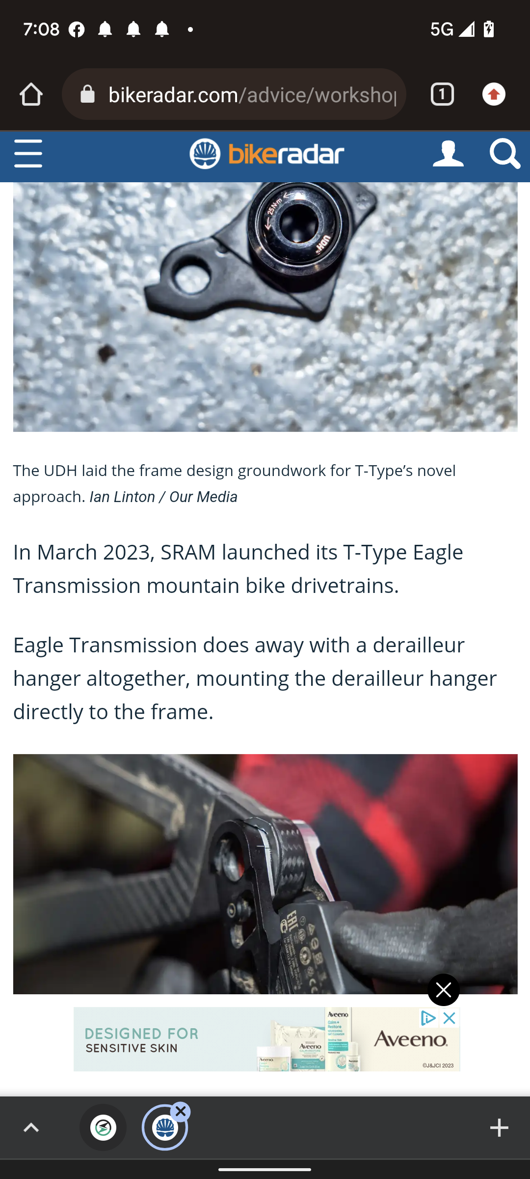

Nor will the old school conventional hanger be compatible on UDH frame. Again, that is NOT backward compatible with the new AXS-T rear mech either. Technically, the UDH itself on a UDH frame is completely replaced with the T-type for the new AXS-T transmission.
See the current article below...it's short a quick and clear.

To clarify: from Linda her photo. The CEF50 conventional hanger. Ergo the CEF50 is NOT a UDH compatible frame. Hope this helps.🫡

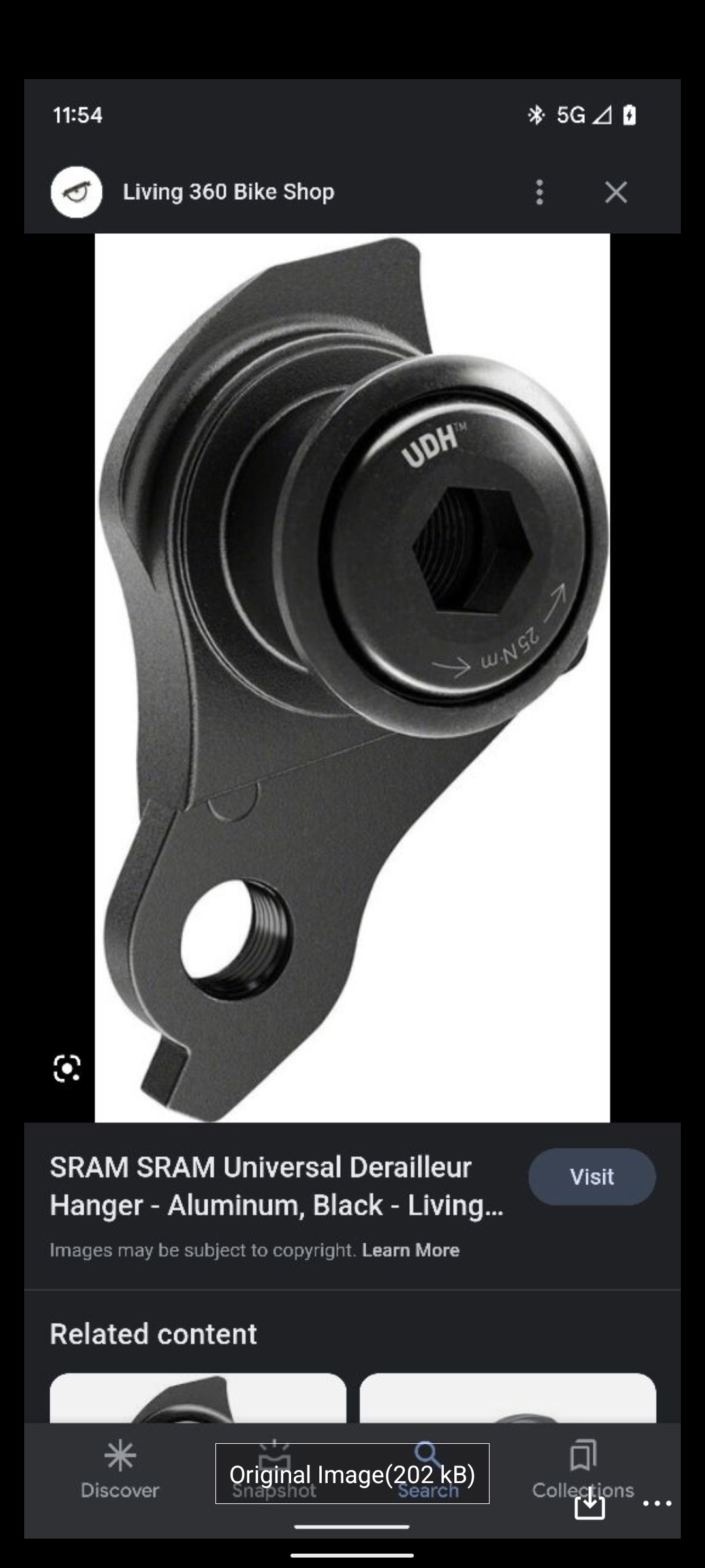

My picture of the UDH I sent Linda 6 weeks ago to clarify the frame type. The CEF50 is NOT UDH compatible. So, this hanger will not fit on the CEF50 frame.
But if it was a UDH frame, I still could use my old AXS GX = backwards compatibility.
However, I couldn't run the New T-type AXS transmission on the non-UDH frame like the conventional CEF50 frame, so no backwards compatibility.
The new AXS is T-Type UDH only.
Further clarification hopefully.😊

Transmission doesn't use a derailleur hanger at all in large part because many derailleur hangers flex and AXS has been flexing lesser hangers and causing shifting issues on some bikes, for years.
Also, the UDH is plastic and when it fails it mostly strips out and rotates. I carry a spare (without the bolt as the bolt doesn't fail) in my SWAT box and it only weighs 14 grams anyways.

There is no such thing as a 'new UDH-T AXS'.
You simply remove the UDH, and install the new Eagle Transmission in it's place. Transmission does not use a hanger at all, but does need the exact spacing left by the removal of the UDH to fit a frame correctly.
