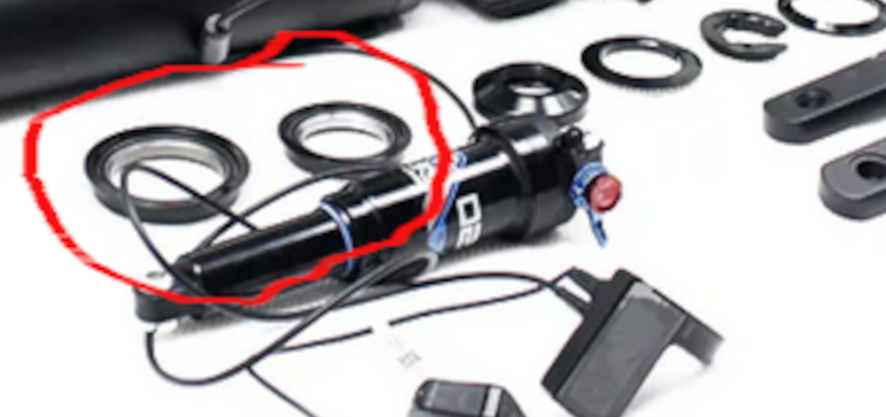

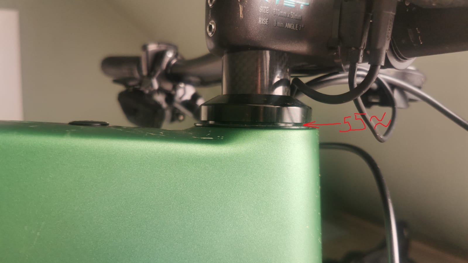

Cool. What is the upper headset bearing measurement 52 or 56 mm?
I know spec says 52 mm but just wanted to double check.👍

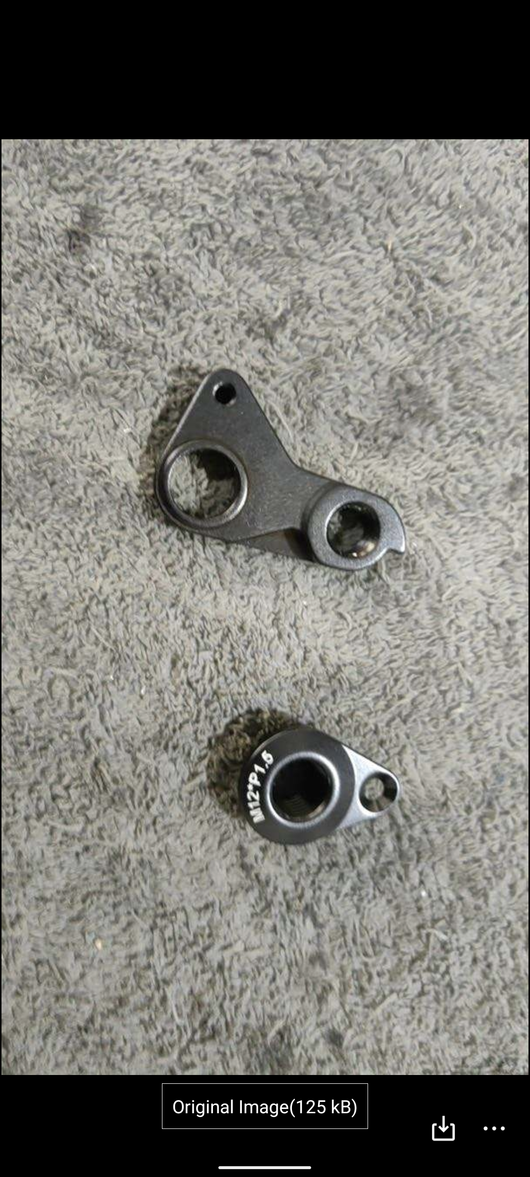

No UDH? If this is true, it's very disappointing. I've dismissed bikes previously for this reason alone.
There's no excuse for not running UDH. This is a potential deal breaker.
Yes, standard. Linda confirmed about 6 weeks ago with a pic. Actually just before the big new Axis launch...
