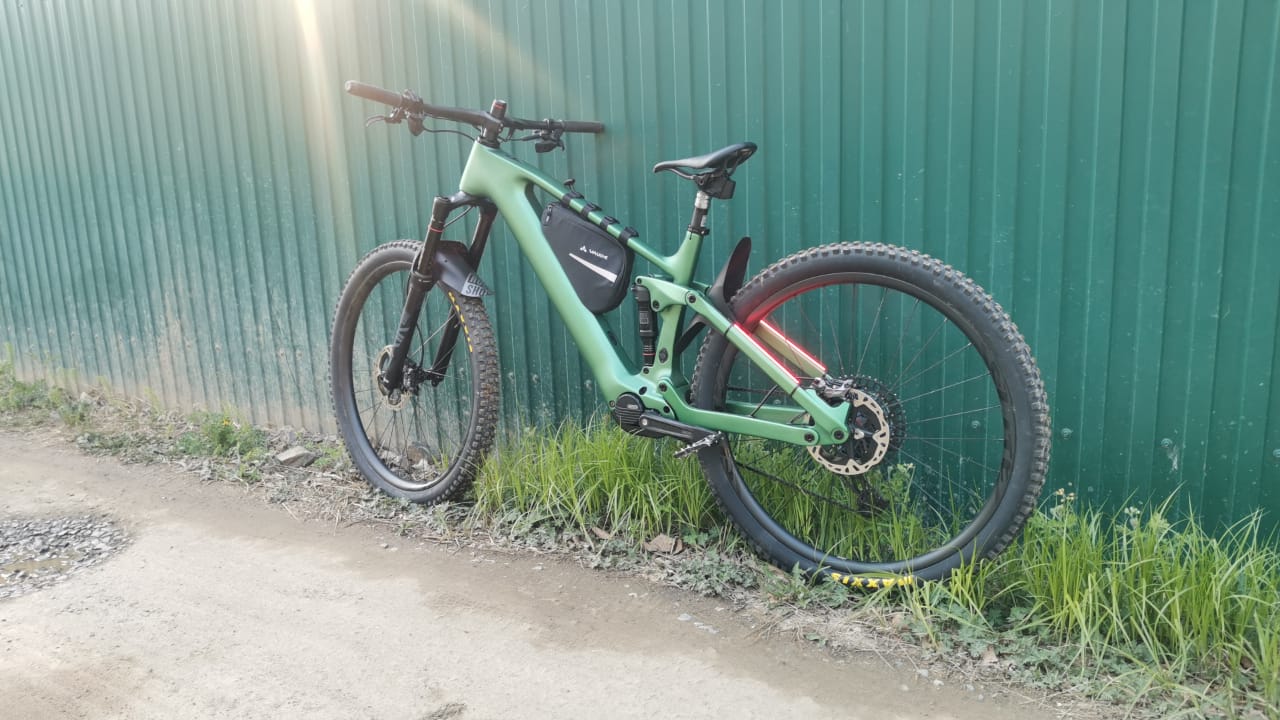

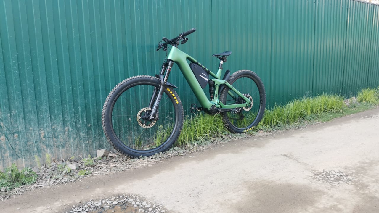

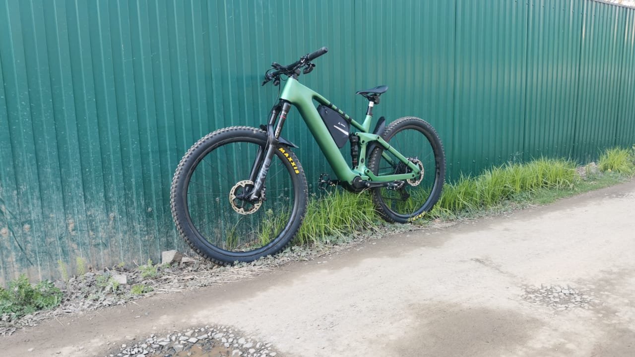

Steel, def some weight can be cut from there
Bafang's 410Wh specification weight is 2.6Kg (I'm assuming without bracket)
Your scaled weight came in at 2.8Kg (with bracket)
So 200g for a steel bar seems ok to me? Not much more to lose I would think. Or am I being too forgiving? lol
LAnton
May 12, 2022
558
465
Russia
The weight of the empty case is 1kg. I think that light models of well-known brands with non-removable batteries do not have such a heavy case. The frame itself is a strong case for the battery.
stuff
Nov 3, 2022
166
281
Spain
100 for an Al would be better :) or even try to do it in CF or 3d printed.

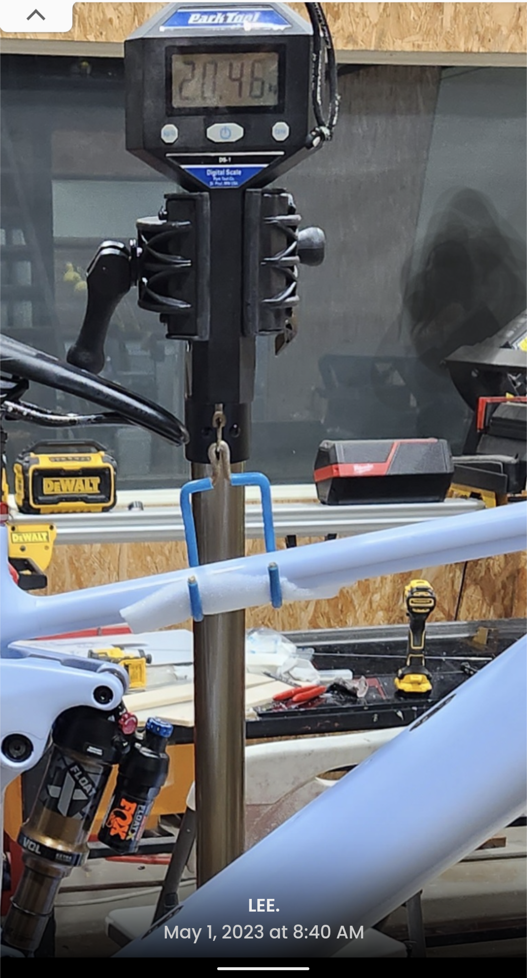

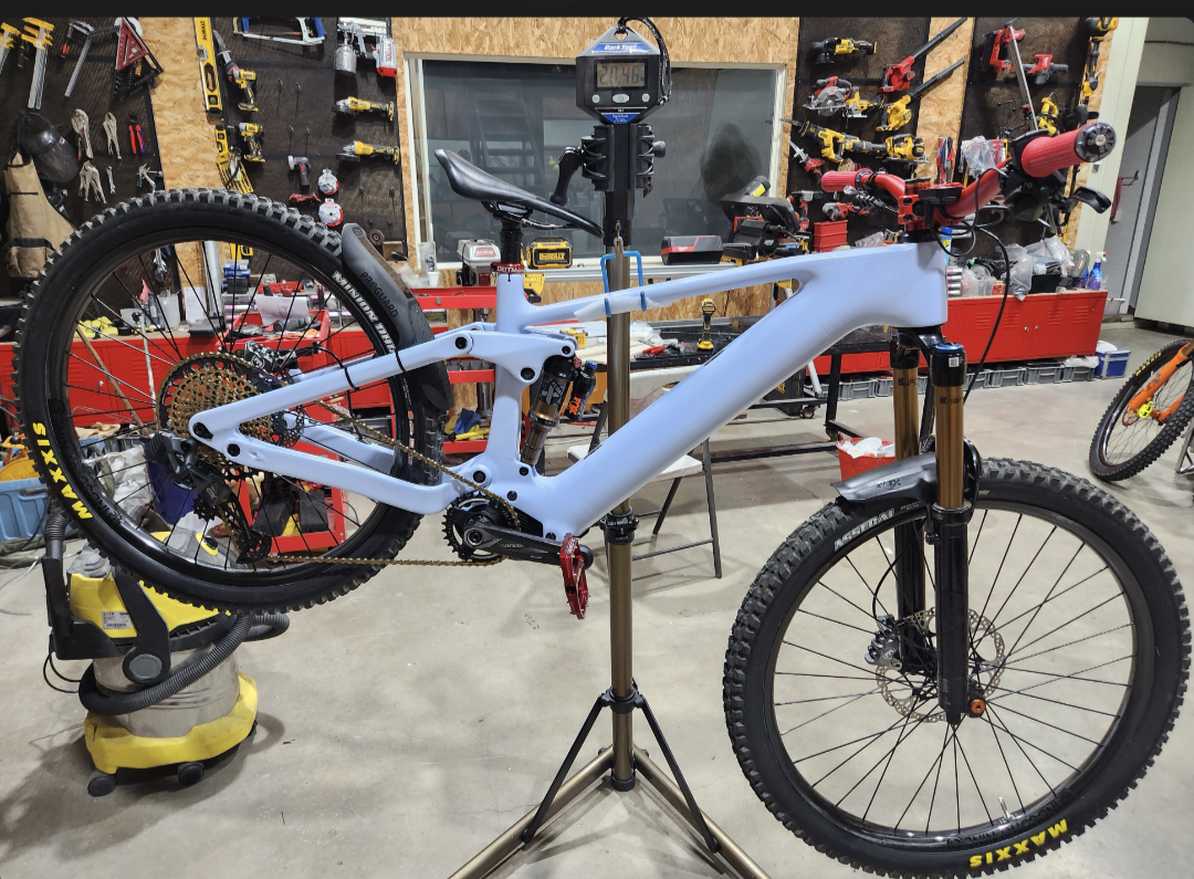

Permission granted by @LEE. to show off his large frame w/big 36 forks/720Wh build.
Clean and white sleek in color 20.46 kg/45.11 lbs. It's the wet weight with sealant and pedals and loaded with premium componentry, so it won't get too much lighter! 💎🪙🧨🎉
Well done!👍
He's still working out headset issues, so he's not able to ride review it yet. He'll post updates when he's able. Others are likely doing a shakedown ride as I write, and will likely chime in when they're ready too hopefully!
Mine is still a week away or so!
Again, great build @LEE.! 🤛

Just a quick reminder on stroke/travel calculation (guestimates):
OEM Spec: 210mm e2e x 50mm stroke = 150 mm travel
* known travel/known stroke = leverage ratio,
So 150/50 = 3 ratio
** 3 x 52.5 = 157.5 mm travel🤙
***3 x 55 = 165 mm travel🤙😉
TCFlowClyde
Feb 26, 2022
1,361
887
Mesa, AZ
Also, note: front sus v. rear sus balance.
Rule-of thumb in in preventing extreme "rake" to reduce headset bearings binding.
OEM Spec 170 fork v. 150 rear shock = 20 mm difference. Axle to Crown (AC) length and fork offset for "trail" or steering ease are important also.
So, a 170f/150r tavel setup seems to be a good enough balance by the manufacturer (ZssZ) for the CEF50. 160f/150r might be more balanced, but I suspect it would be negligible.
I'm running a shorter wheel 27.5er + which is taller than a regular 27.5. So, I knew that I could "overstroke" my fork 180 mm/27.5er fork, as well as, "overstroke" the rear shock at 165 mm. I'd still be within the recommended AC length, hence preventing extreme rake and/or sketchy "trail" steering. This combo should yield controllable steering while having a nice feel for front to rear balance.
Overall, the balance should work well at 180 v. 165 = 15 mm difference, should produce an overall nice plush riding experience IMHO.🤞
Remember, the trends for Emtb is longer travel due to pedal-motor assist. Full-powered (85 Nm+) is really no penalty. For 3/4-powered (65-75 Nm) and mid-powered (50-60Nm) there is slight weight penalty, and then more so for lower-powered (35 Nm+).
TCFlowClyde
Feb 26, 2022
1,361
887
Mesa, AZ
Yes, yes, impetuous "youth" always want bigger, faster, and "better"? It's subjective of course, but logical as a way to gain non-traditional plush w/o much penalty. 😉
I also got my 180 ZEB fork "cheap" ...mainly because I'm one cheap-ass frugal bastard. It was almost half-off 2022 with the fancy 3.0 charger damper, buttercup low speed damper, air pressure bleed ports, blah blah, blah upgrades. Then I found a takeoff rear RS Superdelux, super cheap and did the negative air can upgrade called Meg-neg. Just way more bottom out resistance for bigger hitters or heavier riders (I'm just a smaller hitter at best but "big boned" so my sus gets worked out even on flatter rides)😁
Got all of the above for 1,100 +/-USD, so I decided to build a frame around it. I had my carbon wheelset waiting too. I just sold my still boxed spare emtb frame+rear shock+fork+used M600+2 450Wh batteries for $1,500 to a family member, so my brother got the "kindred discount"....I had extra XT brakes and drive train. So, I swapped my old AXS GX and bought another 500+/-USD components.
Anyway, I basically decided that I could get the CEF50 at a cheaper price than other M820 frames. The M820 seemed powerful enough and 720Wh bigger battery sealed the deal! So, lots of work to stay reasonably priced.
But that's what's great about a DIY build, customize and upgrade with used/new, borrowed, or "stolen" parts! 😁 Whatever gets the job done is the mantra of a cheap-ass-bastard-but-with-fine-tastes buying strategy.💸🫡
