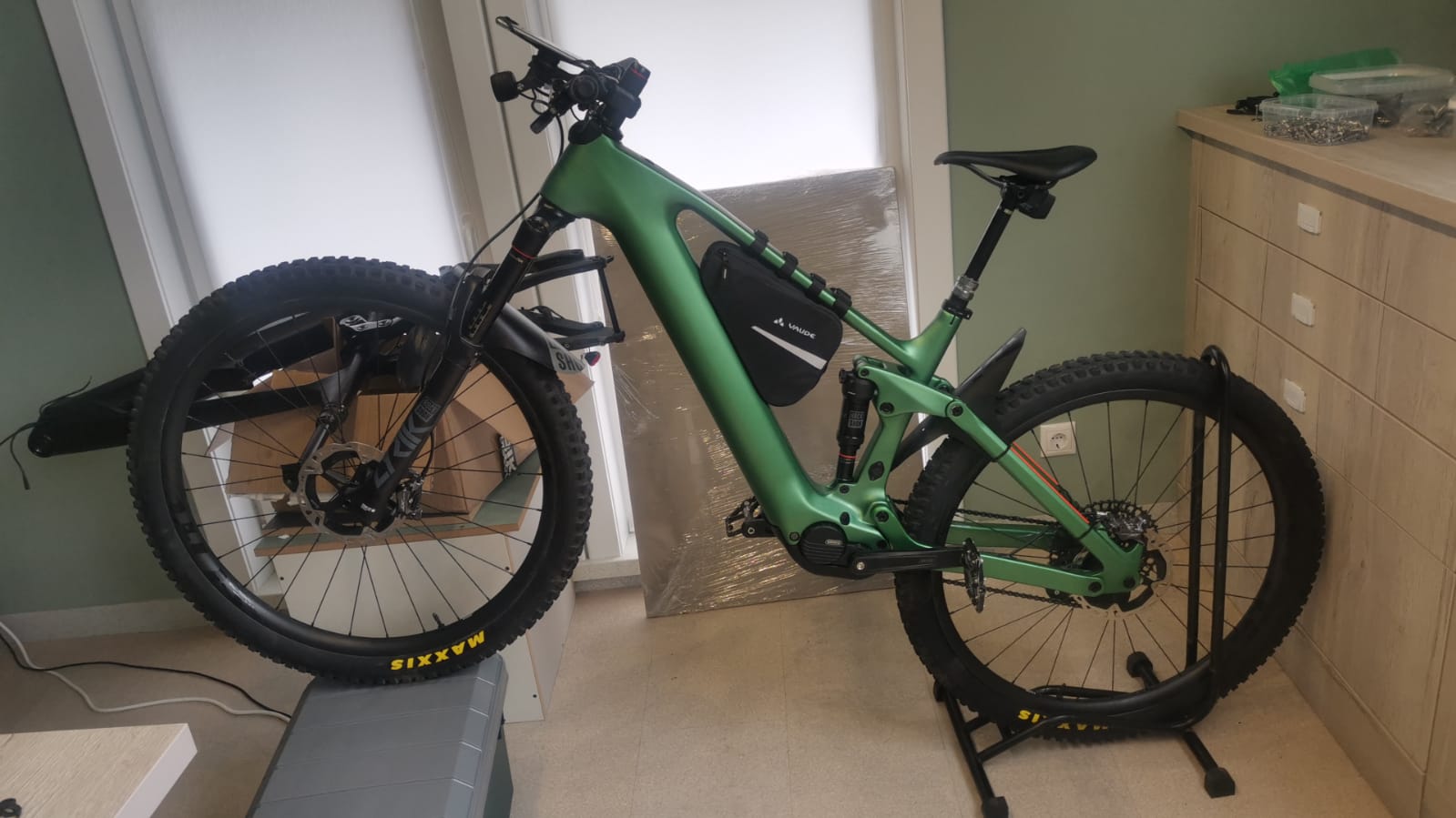

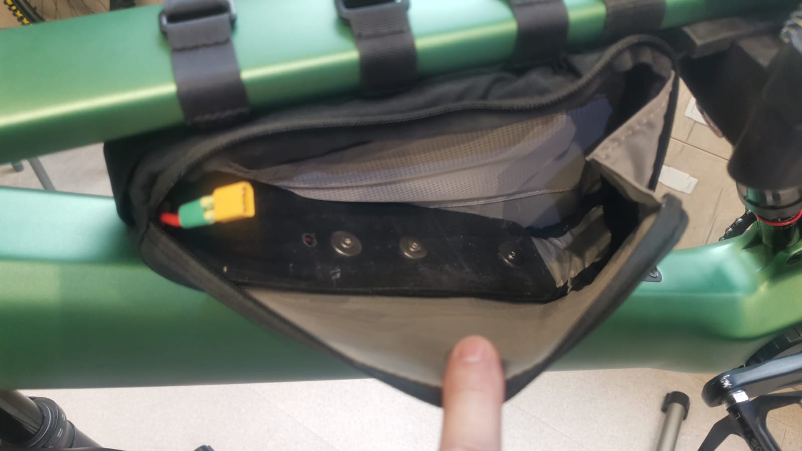

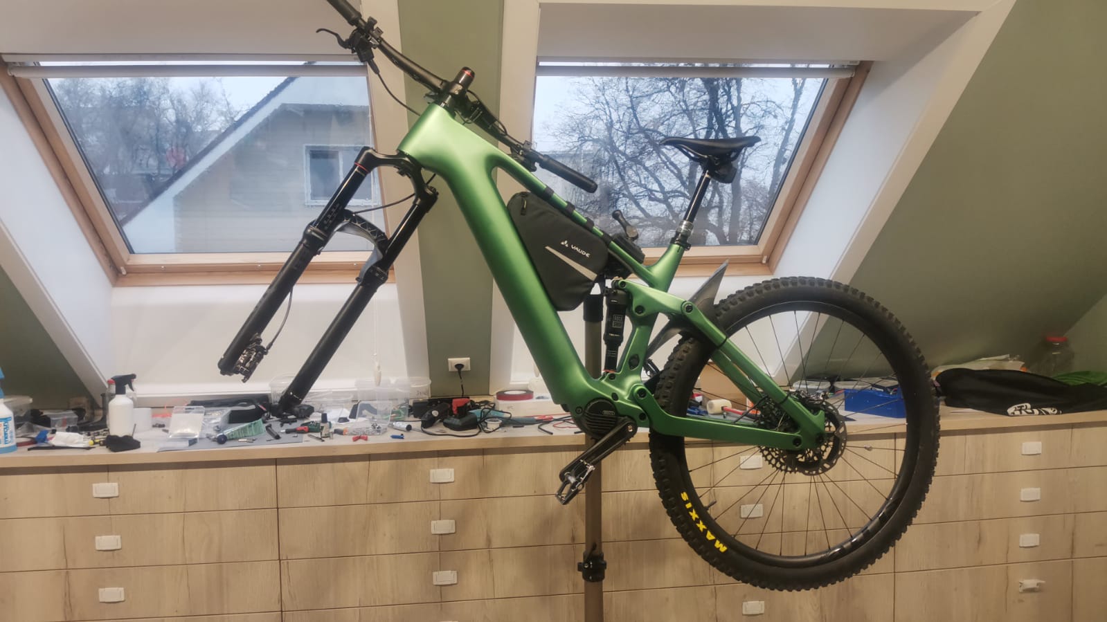

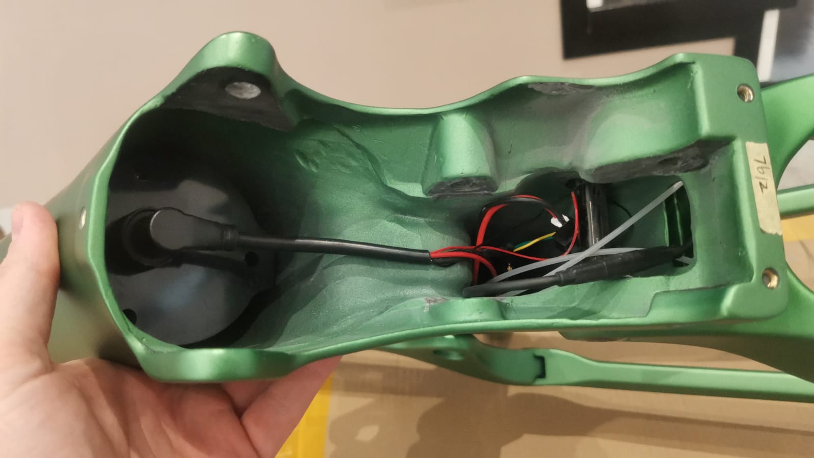

Hi @LAnton or @stuff Any chance you can show a photo of the internal battery mounting bracket for this frame?
I've almost finished assembling the bike. The battery is attached with 4 bolts to the frame. There is no bracket on the frame, only holes in the carbon fiber. Also, 2 bolts for the bottle holder are attached to the battery through the frame.

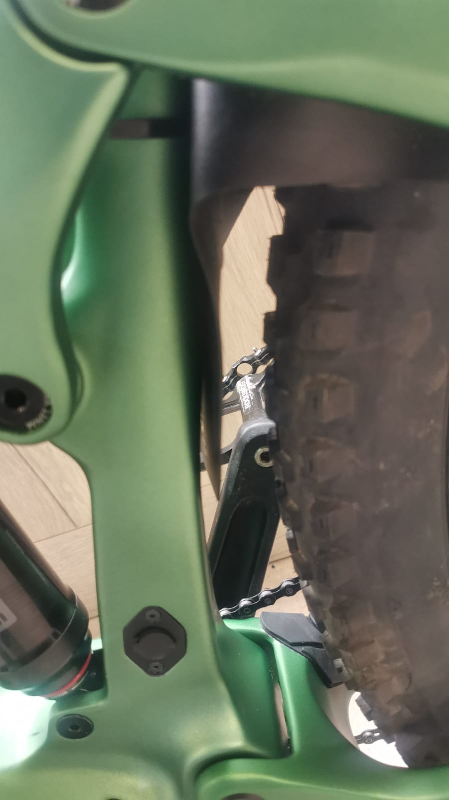

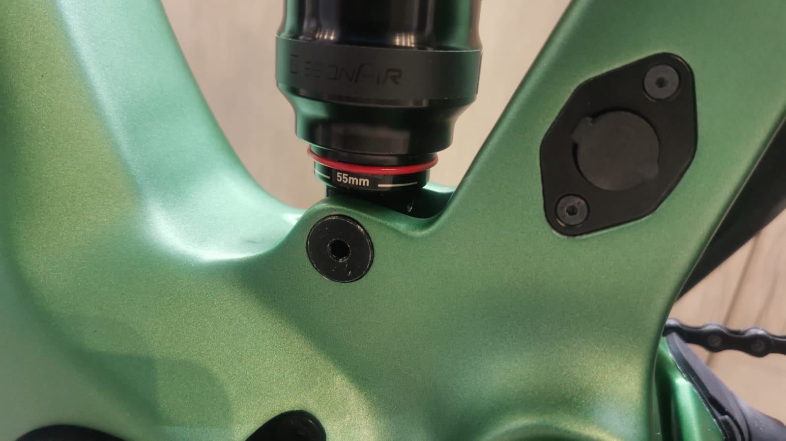

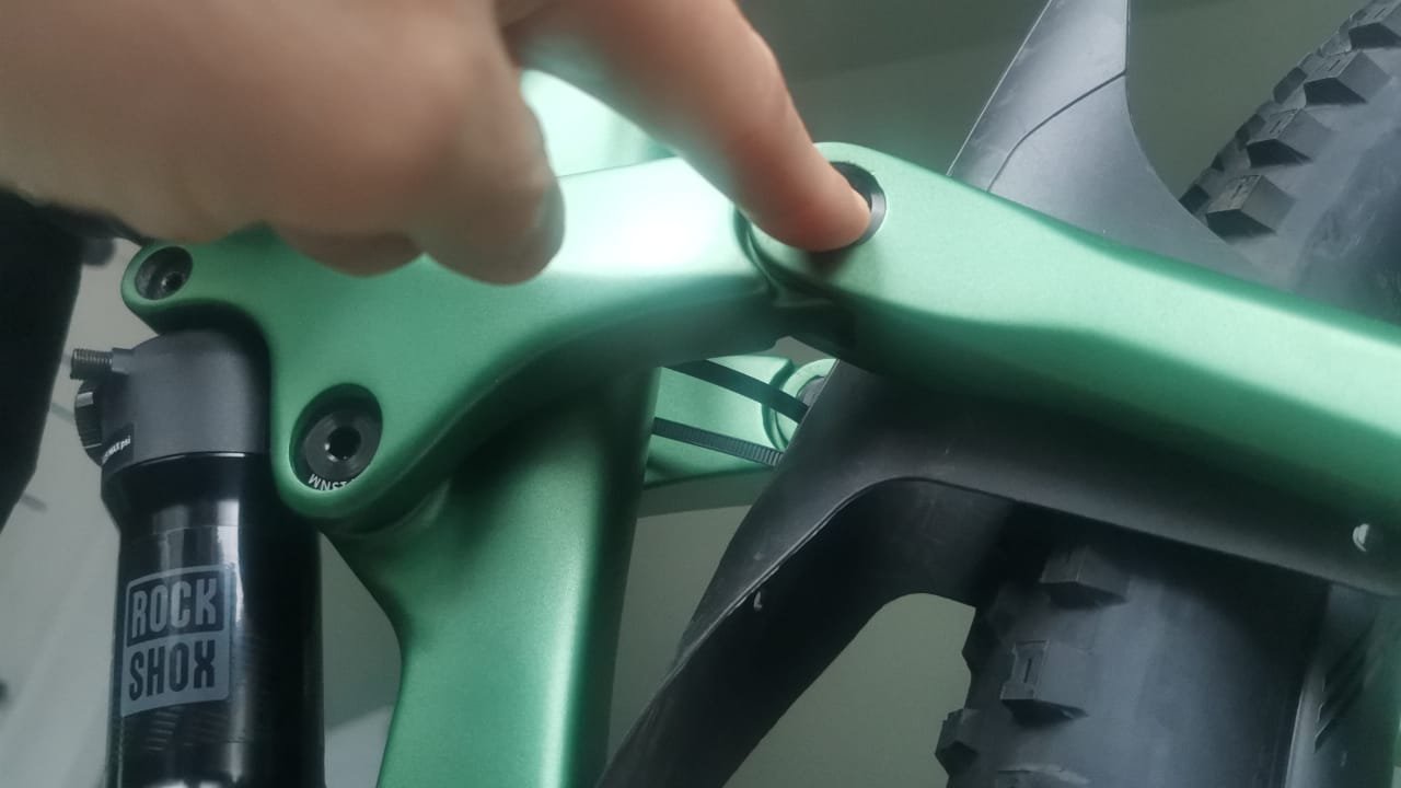

Attention. A shock absorber with a stroke of more than 50mm cannot be installed. You can break the posterior triangle.

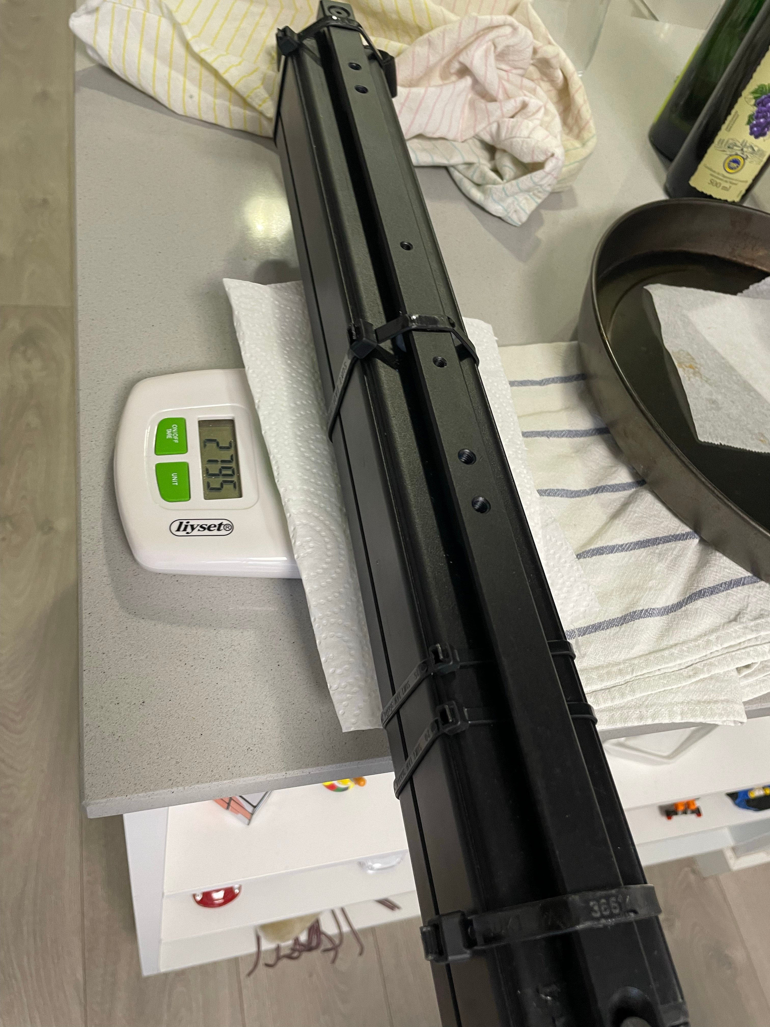

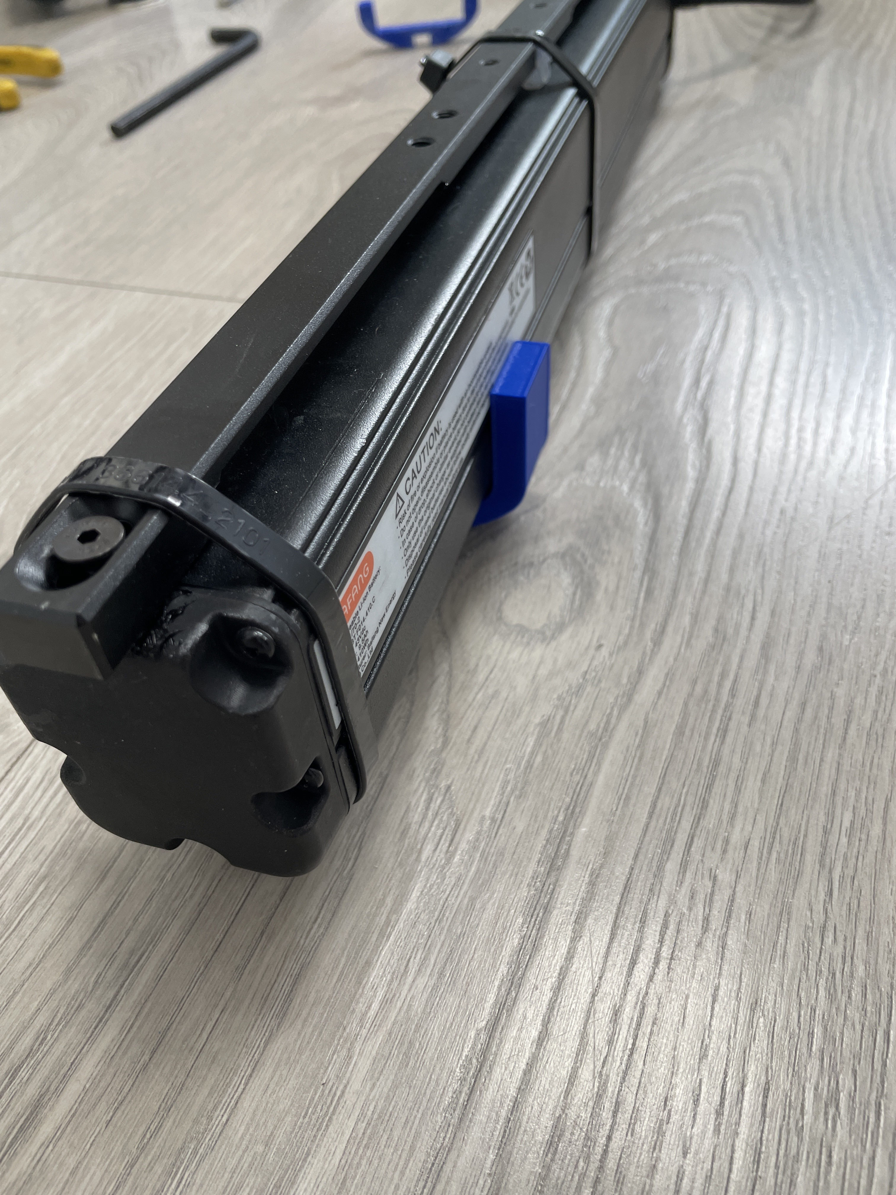

Battery wasnt 100% in here, but you can see irs a tight fit with the 3d printed supports
This were some initial prints testing fit

Added some zip ties to strengthen it up since its attached to only 2 bolts.
Also 3d printed some supports so its a tight fit

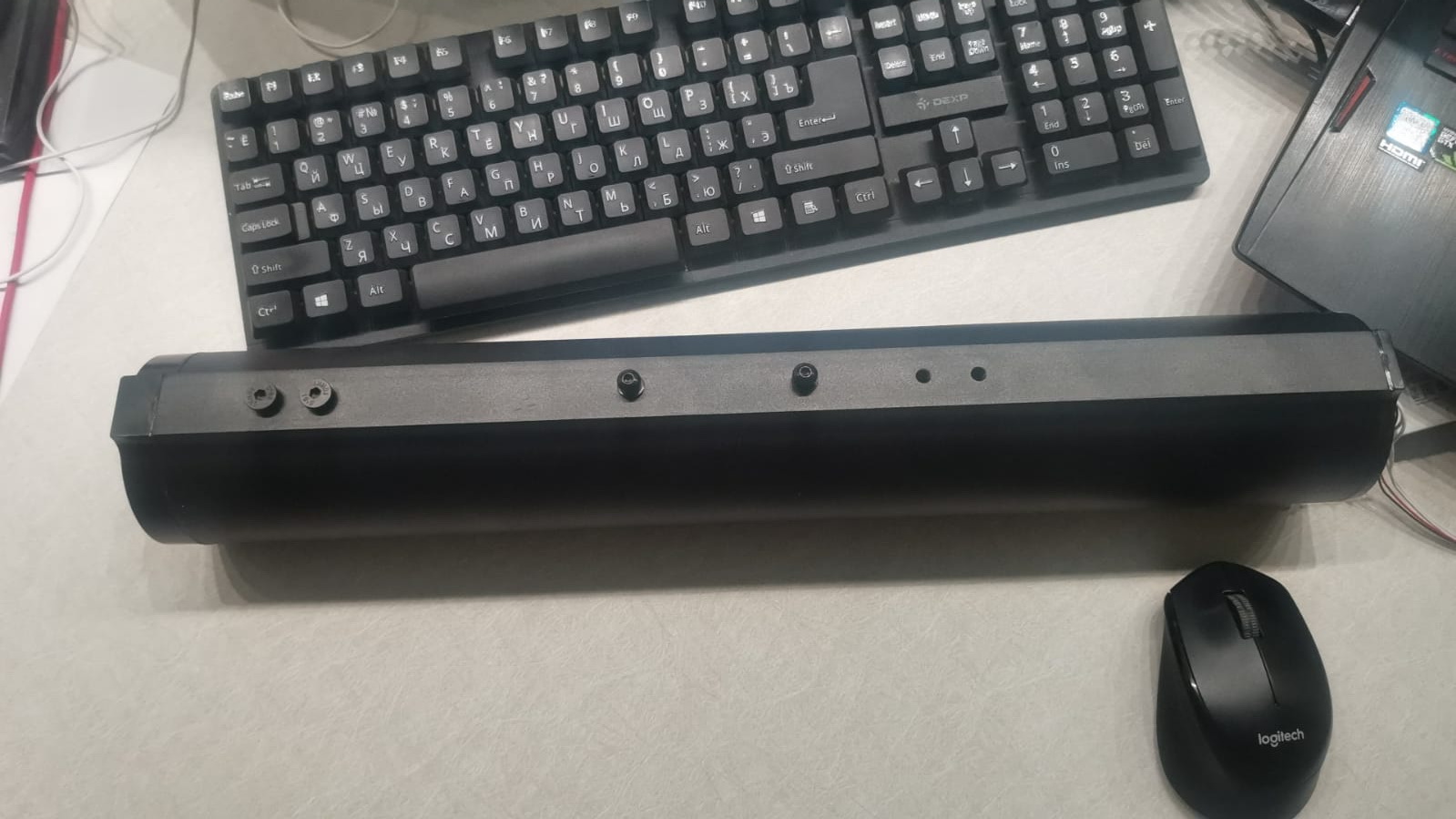

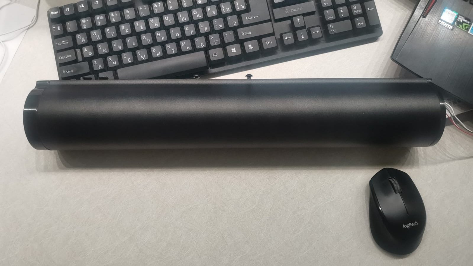

I have a different battery. It is made entirely of aluminum. The battery is attached to the frame with 4 M6 bolts and 2 bottle bolts.
WhatsApp Image 2023-04-29 at 21.58.26.jpeg WhatsApp Image 2023-04-29 at 21.58.34.jpeg
