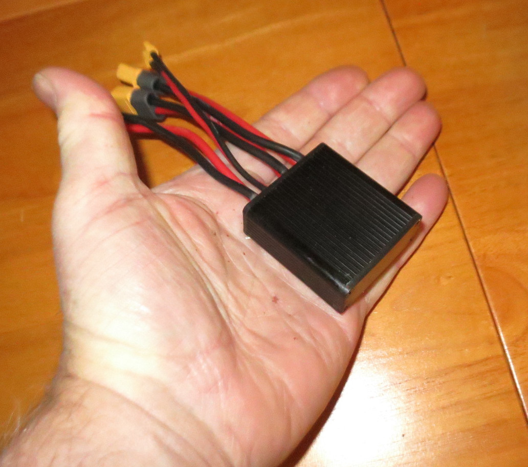

So I got the parallel battery controller I ordered. Smaller than I thought, which good. So this one has two battery in ports, one motor port and one charge port.
It is supposed to be a two way swtich.
So if battery one is higher voltage than battery two it swtiches to using battery one only, until battery one voltage drops to equal battery two. Then it swtiches on battery two. If either batttery once again falls below the other then it switches off that battery until they are equal again. This prevents either battery from discharging at high dangerous current into the other battery. It also has a separate charge port.
If there is room inside, the motor port gets connected to the motor, the battery to battery one and the charge port and battery two would go outside the frame.
The battery/motor ports are XT60's, which will have to be changed and the charge port is an XT30.
The one I got is the dual-battery 20 amp with charge port

@LAnton Of course, if the motor has an XT30 the battery must also. So I will need to change the connectors to all XT30.
Thanks LAnton. Do you think there might be enough room inside to fit the parallel switch or is it too tight?

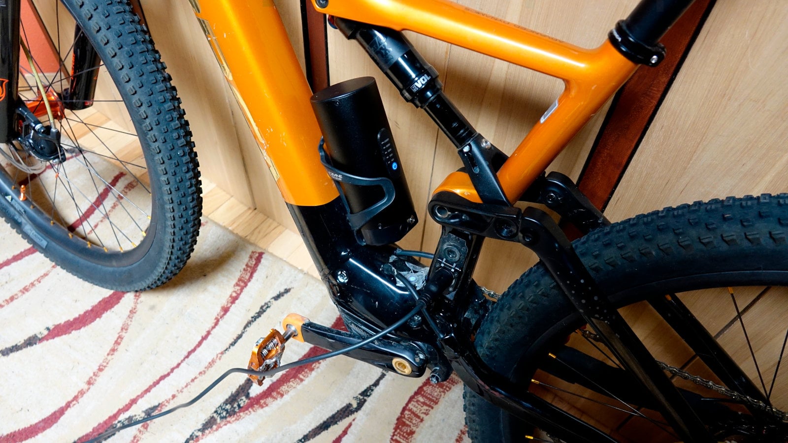

My thanks to Linda and her engineer for confirming that my bottle battery "guess" was correct. Just arrived from Aliexpress and here is an image of it on my Orbea Rise for perspective. The dimensions are 188x77x77 and I don't think any bigger would fit.

The battery is 3.35 lbs and is the 36v 7ah, with Sanyo cells, which I think is the largest you could fit on the frame. The larger cases are 238-310 in length and I don't think they will clear the shock.

Yes exactly what I had in mind. We do a lot of 2hour rides and my wife is sensitive to bike weight. So 360 whr internal and then depend on external for extended range. The battery is 36vx7ah=252whr. I would have gone for larger but I wanted it to fit nicely and cleanly in the bottle cage. I have a 540whr battery on the rise and I have no problem doing 20 miles with 1000ft elevation change with half a battery. So this should be similar.
