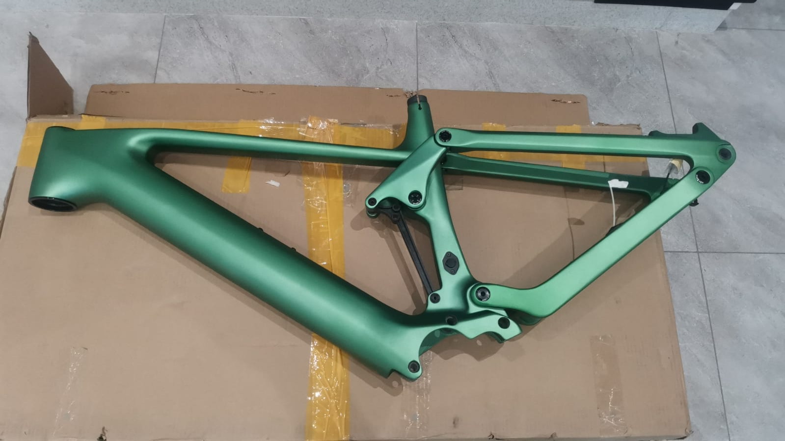

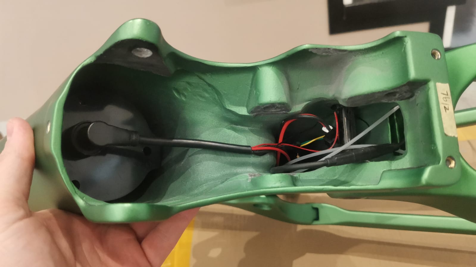

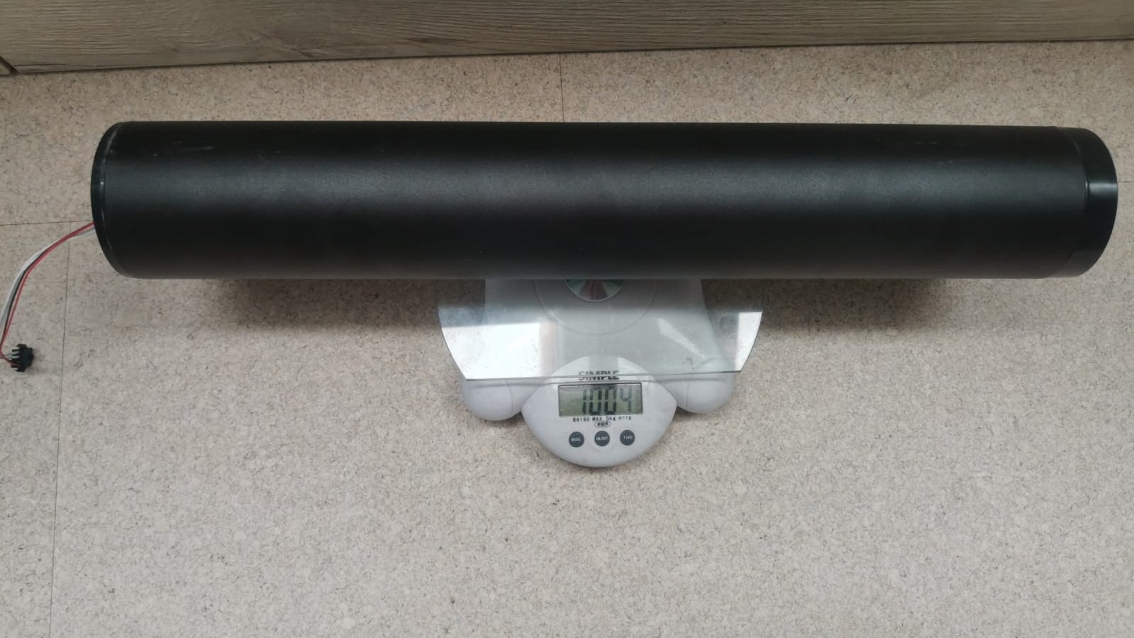

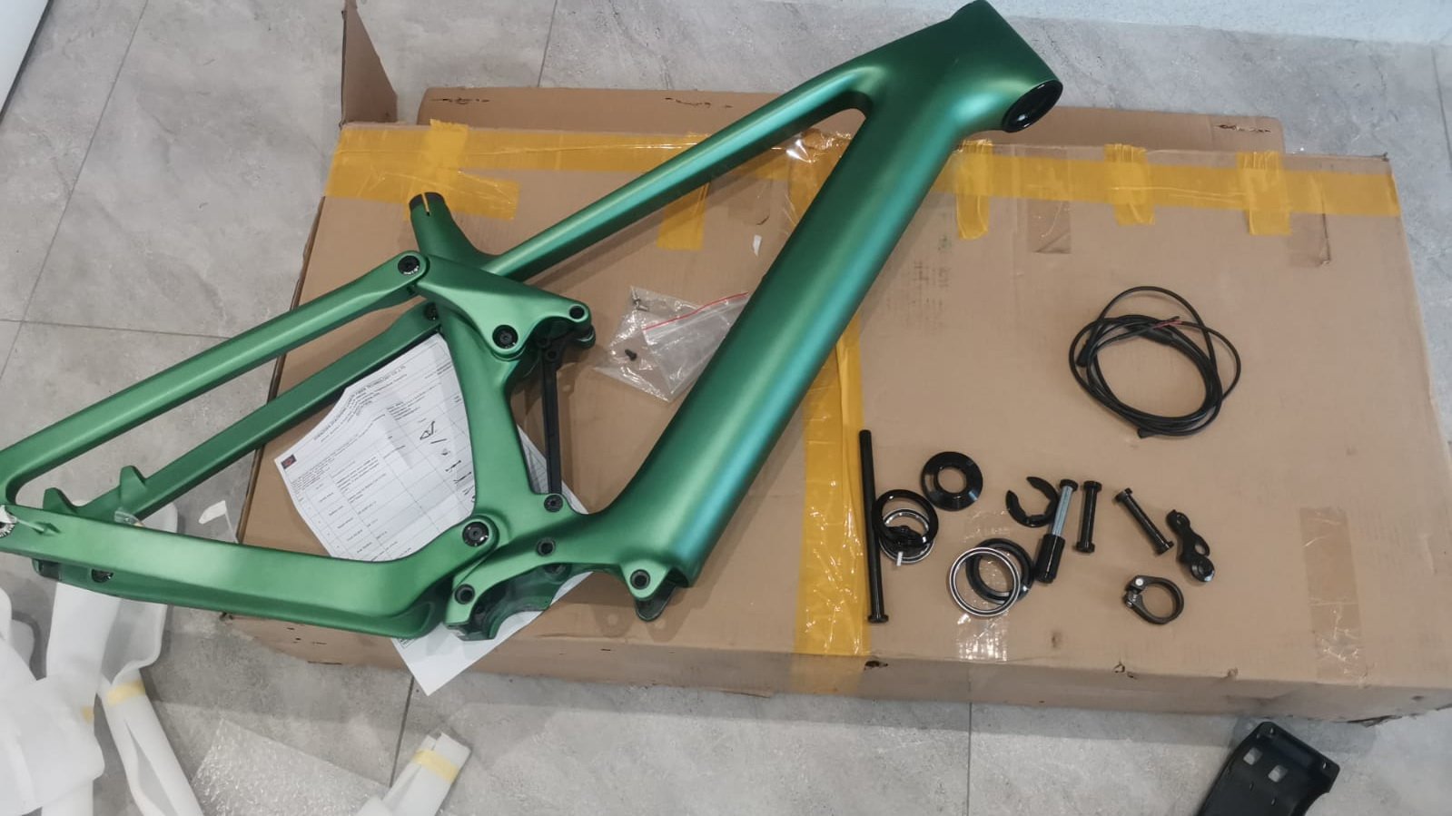

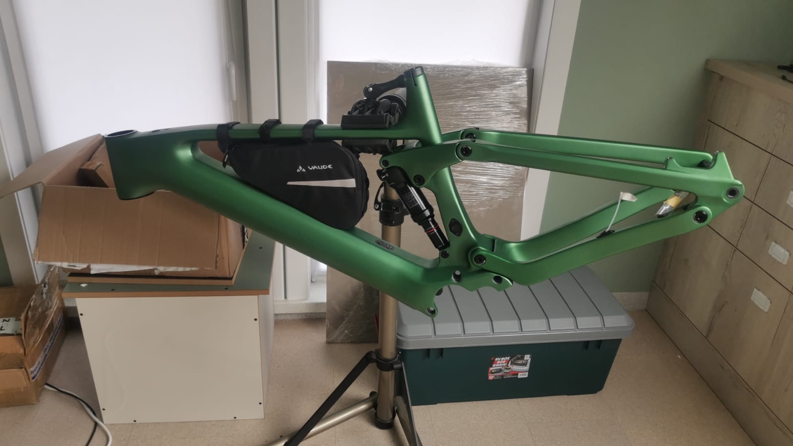

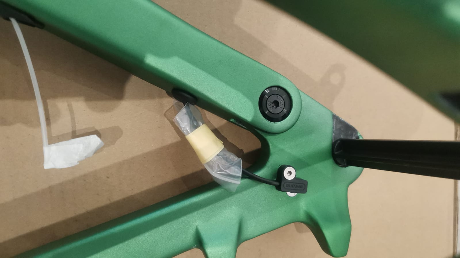

The first frame L has arrived, we are starting to assemble. Please note that the frame has bolts for attaching the motor. The handbag includes 3P
WhatsApp Image 2023-04-24 at 15.04.24.jpeg WhatsApp Image 2023-04-24 at 15.04.41.jpeg WhatsApp Image 2023-04-24 at 15.05.18.jpeg WhatsApp Image 2023-04-24 at 15.11.52.jpeg WhatsApp Image 2023-04-24 at 15.17.28.jpeg WhatsApp Image 2023-04-24 at 15.37.31.jpeg WhatsApp Image 2023-04-24 at 15.38.14 (1).jpeg WhatsApp Image 2023-04-24 at 15.57.02.jpeg

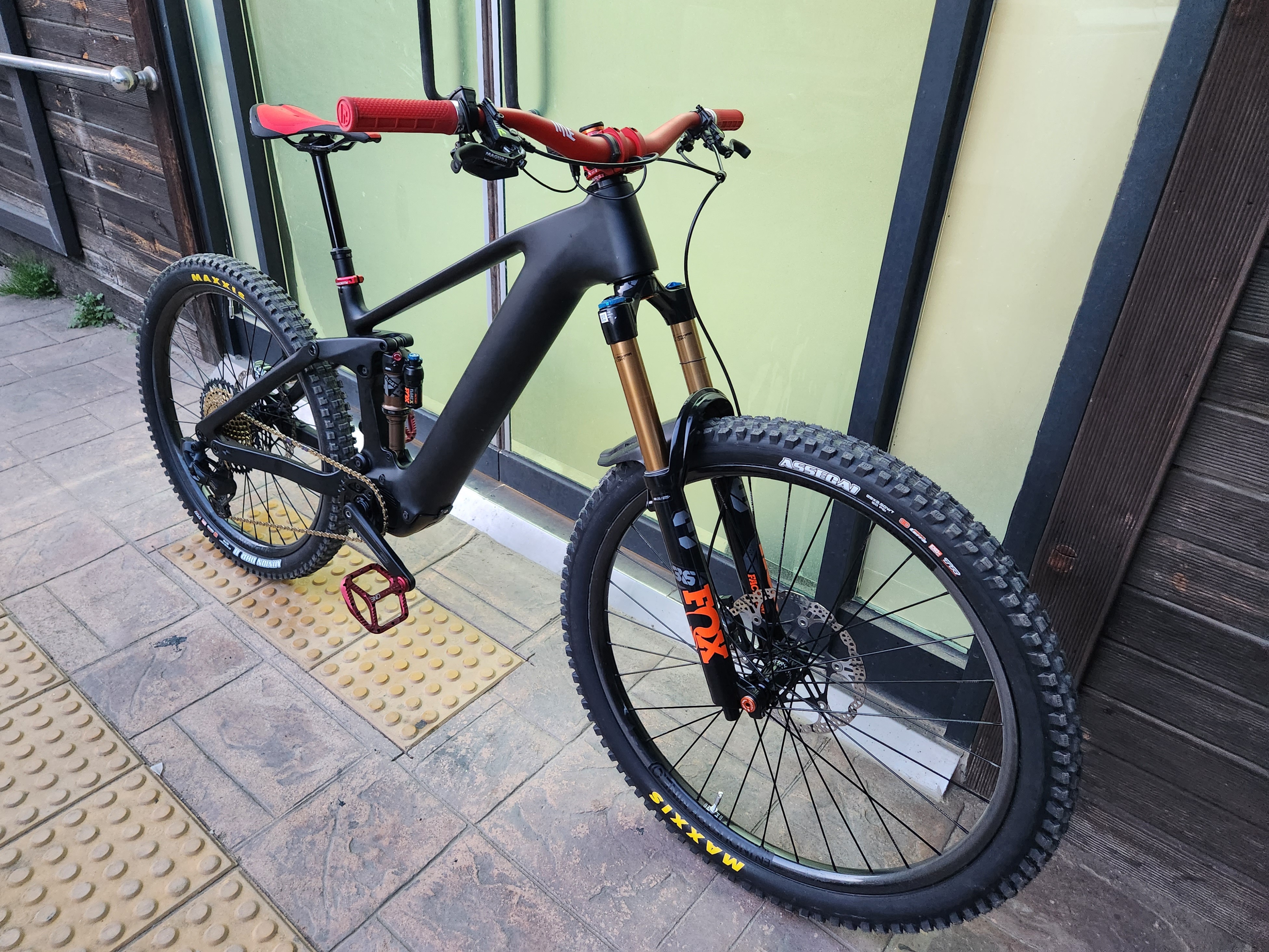

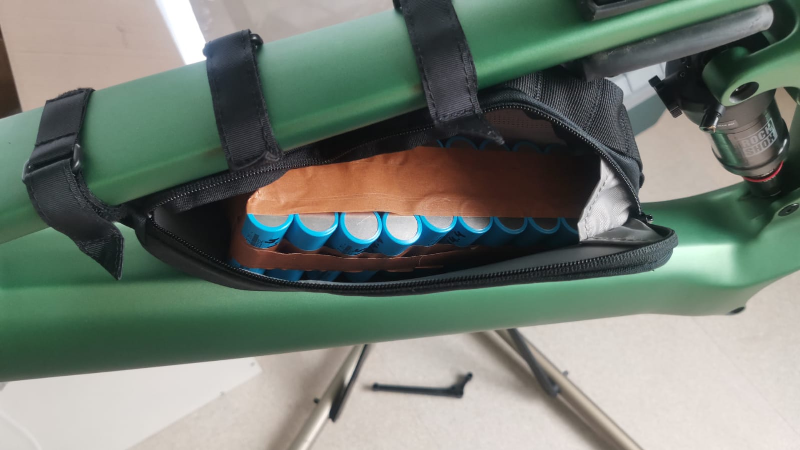

I received the delivery last week, gave up painting and assembled it. The motor seems to be better than I thought, and the frame is... questionable. Going to do a real test in the mountains tomorrow.
View attachment 112236 View attachment 112237
Hey Lee, have you had a chance to get out and ride it? What are your initial impressions? Any comments of the power, max wattage you’re experiencing? The delivery of the power? Last question, how does the frame feel does the quality seem good?

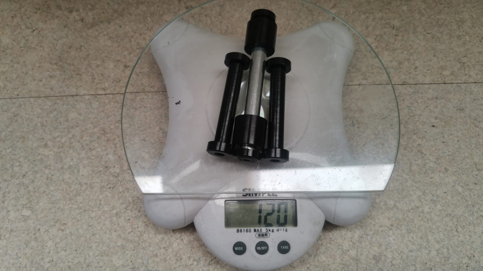

For those ordering it with the Bafang 410w battery you should put some supports to hold the battery (bafang issue commented by Jim on the 930 thread), if not the bat screws will brake.
This DOESNT occur with the 720w battery.
I have designed and 3d printed them and will share it with Linda and whoever needs it. I’ve used petg+cf filament for durability

I rode a 45km mountain course over the weekend. The power was sufficient for me, and the battery was sufficient with 47% left. I'm trying to stay away from the Dengfu e10+m510 I used to ride. However, the completeness of the frame is a little disappointing due to the fine gap in the bearing part of the headset. I'm glad if it's just my frame. It is in a state of disassembly to solve the frame painting and headset gap.
