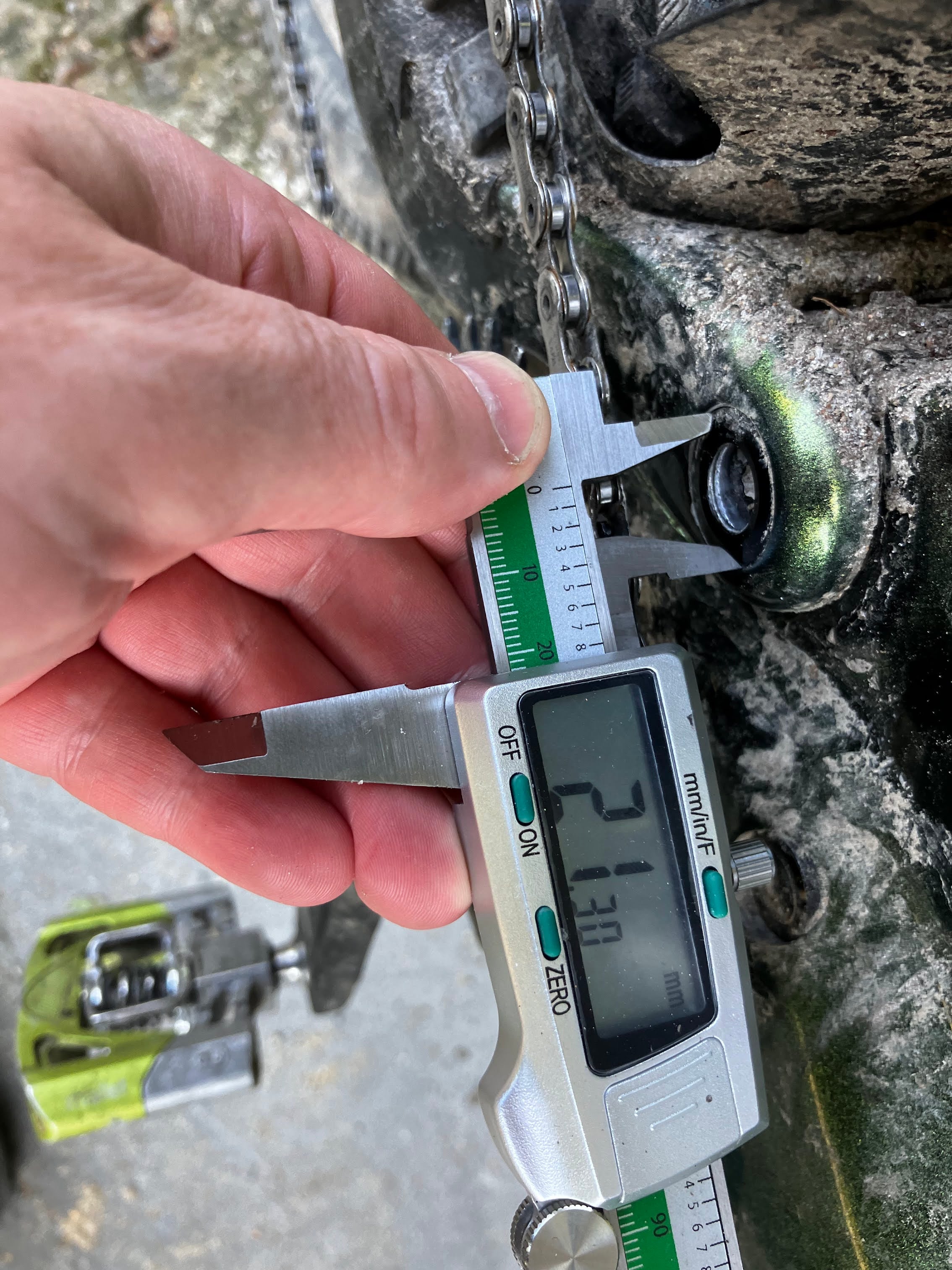

Hi! I tried offset bushings to fit CC DB kitsuma - but it doesn't fit the v1 frame.
Penso che la camera d'aria sia troppo larga, i 2mm\1.5mm che ti dà offset non sono sufficienti, nella versione Cef 50 v2 o
v B come la chiama il produttore va anche senza offset della boccola
Ger@anio63
Sep 6, 2024
83
54
Italy
I think the air chamber is too wide, the 2mm\1.5mm it gives you offset is not enough, in the Cef 50 v2 or v B version as the manufacturer calls it also goes without bushing offset

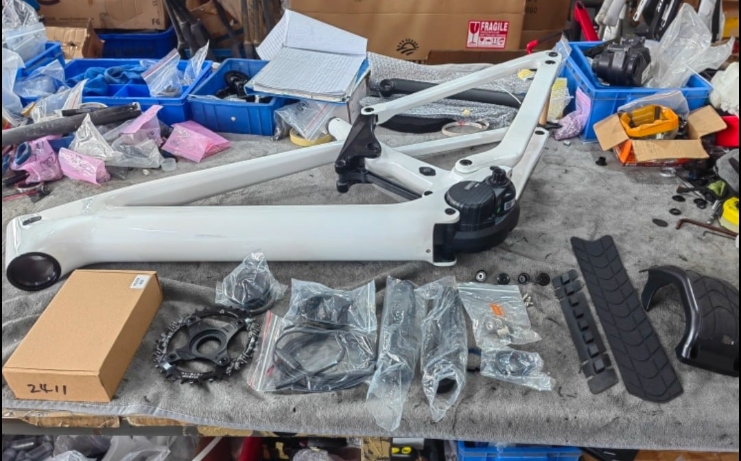

First, thanks for all the massive info here I decided to jump on the DIY train. I've built up many bikes, but this will be the first ebike build. Just waiting on my frame to be delivered. They were nice enough to send me video of everything hooked up and working perfectly. Also got ports cut for cable routing because I'm not dealing with headset routing. That's a deal breaker for me.

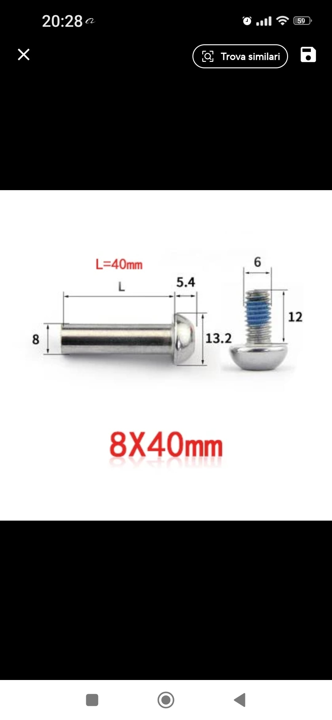

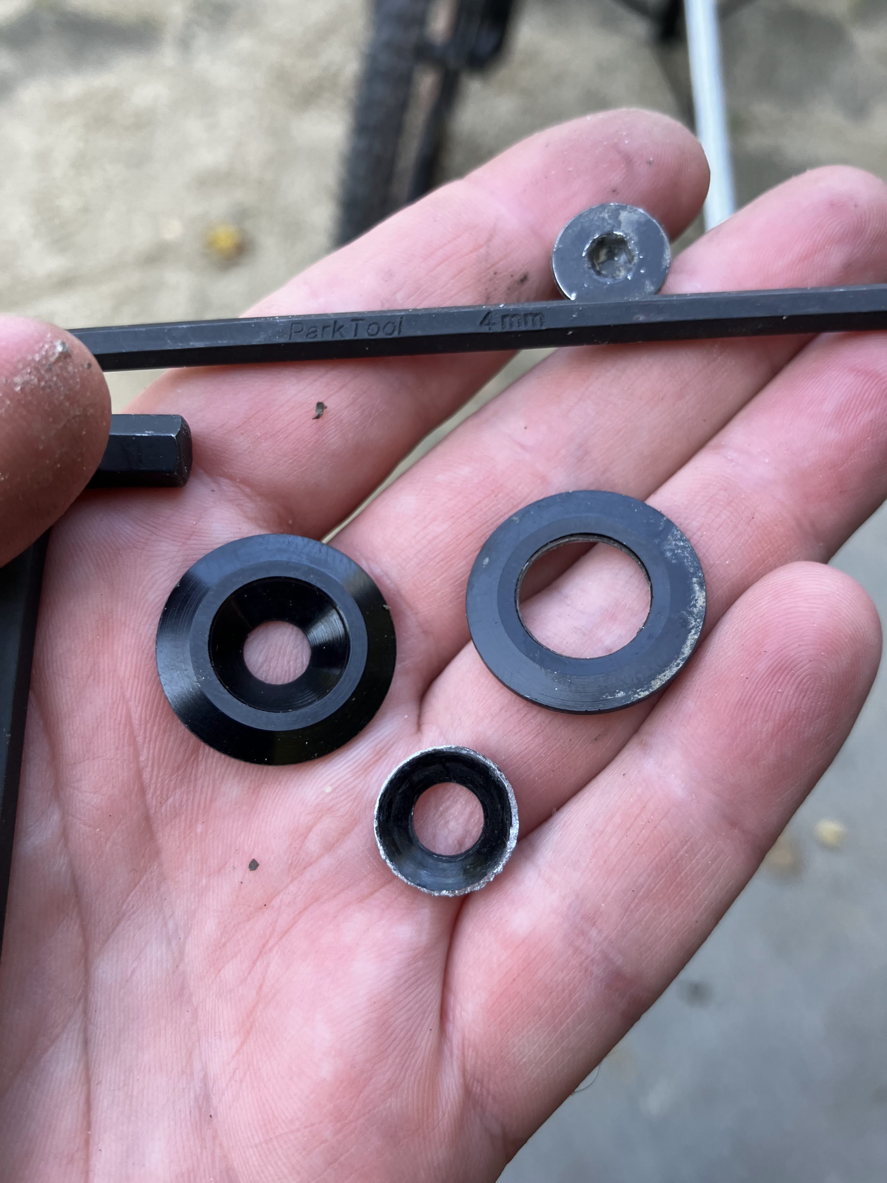

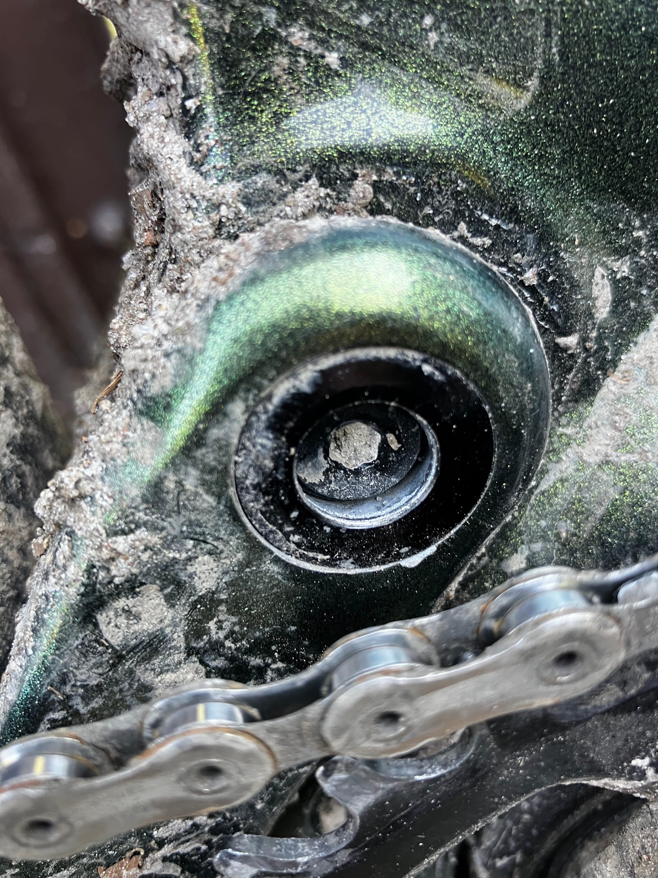

I just noticed one of the gaskets in the suspension hinge has broken. These gaskets are made of aluminium and seem to be very fragile. I was very careful not to overtorque them when assembling the bike so I used calibrated torque wrench set to 12Nm. Seems like the material fatigue. Thankfully, there are 2 spare gaskets in the kit from SZZT. Anyway, just to remind you, be very careful with those aluminium gaskets and better order several spares just in case, to have uninterrupted fun.
TCFlowClyde
Feb 26, 2022
1,378
898
Mesa, AZ
Yep, I didn't like 'em...junk! Especially as a heavier rider.
Probably can find a local machinist in your area to make aluminum mating bolt. The OEM thrubolt (pin) is good, which is most of the cost.
Likely get high-grade 7075 Al for $20-25 per X 6 = $120-150. 💸 Maybe half that much with 6061 Al, so $60-80 instead?
Bonus...never lose the beveled washer which is hard to replace.🍻

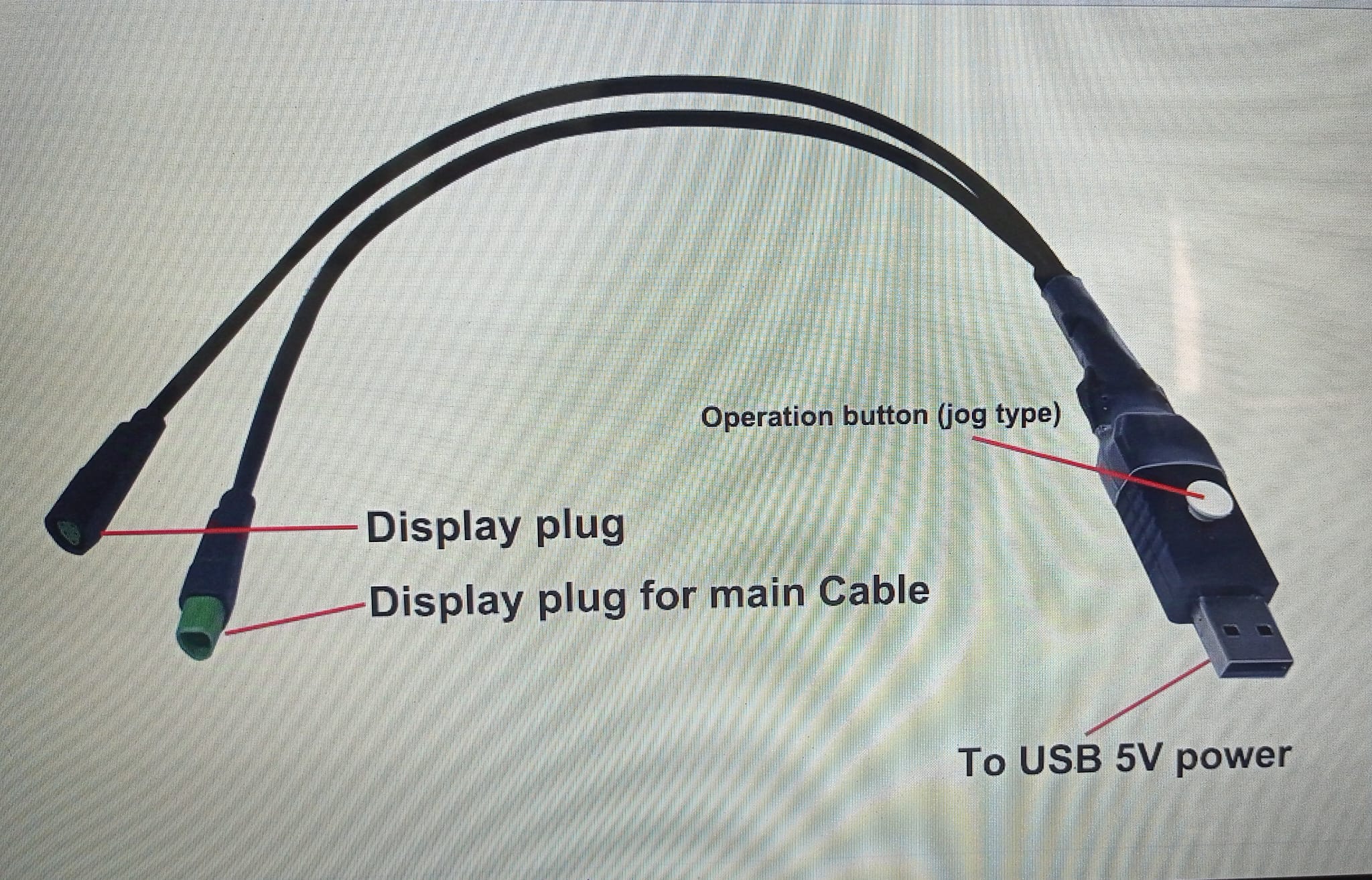

I don't think that will work. It is a serial cable. I think the only thing that works is a bluetooth connection to a handlebar device like the 245v3.
Ger@anio63
Sep 6, 2024
83
54
Italy
This is the answer to the question of compatibility
The M820 can be used, but the DPC245 does not have a USB plug,
so you need to plug the USB into a computer or charger for 5V power
