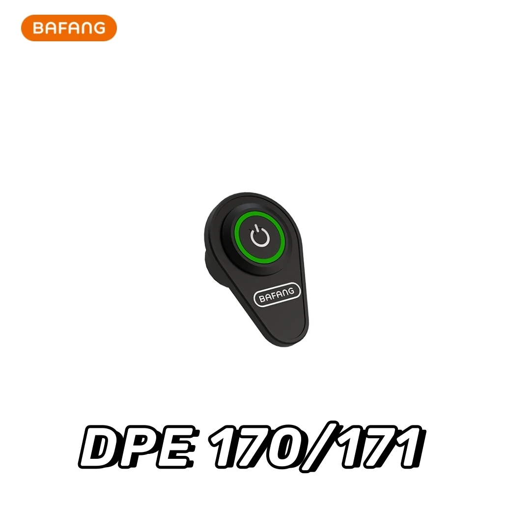

Anyone got and uses Bafang DP E171 smart button display? And where to get them from?
I had used it on the handlebar for the beauty of DIY :geek:. Replaced. To be honest DPC245 is more efficient and easy to use

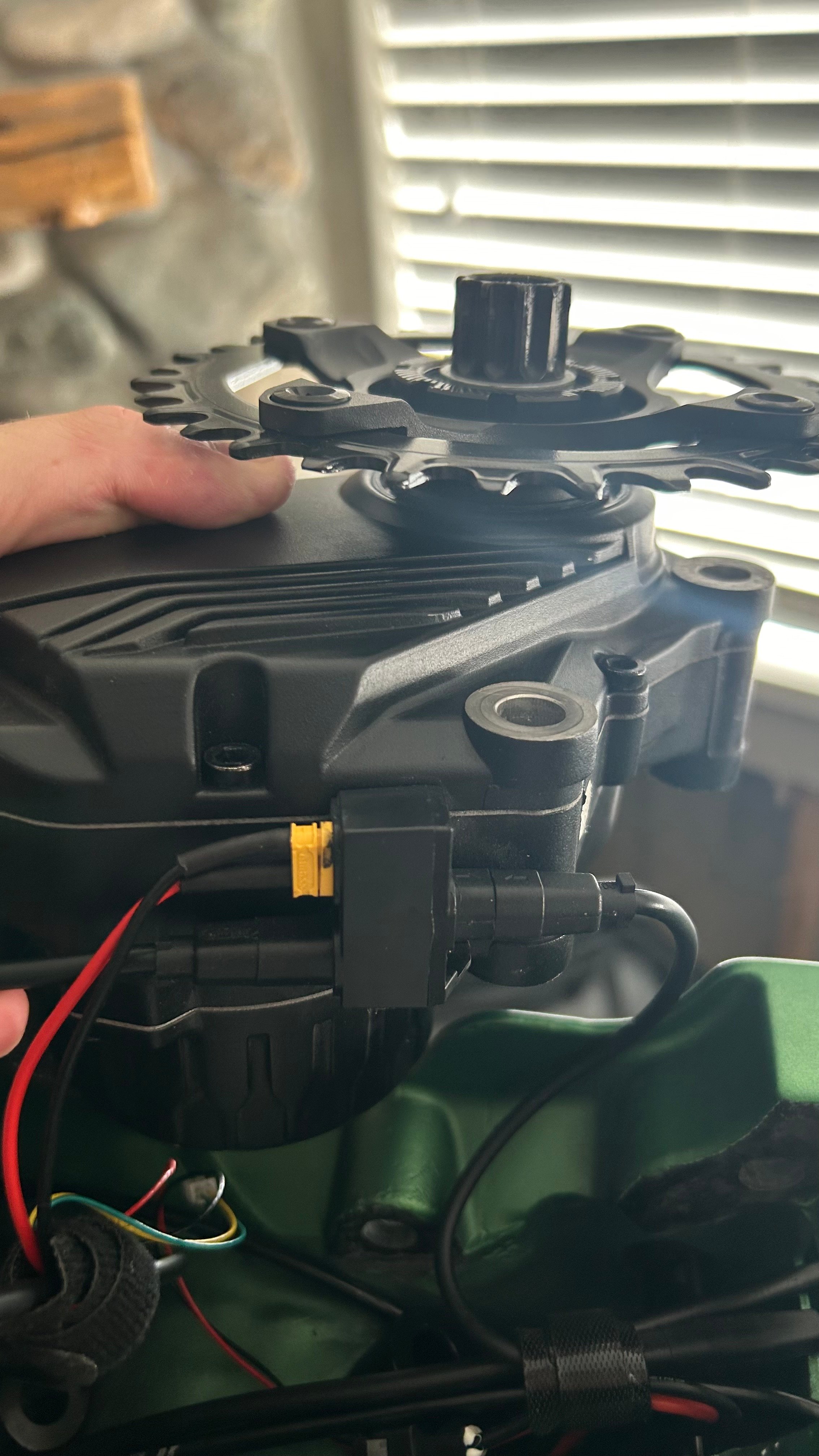

Potential buyers beware. My CEF50 appears to be dead-on-arrival. The blue power button on my frame will turn on, but the motor/display will not. Everything is plugged in correctly/snugly. I bought it through Jean on Alibaba and have reached out to her regarding the issue. I haven't heard back, but even if she sends replacement hardware, I'm looking at a 1+ month resolution in addition to the 7 weeks I've already spent waiting to build this bike. I'm extremely disappointed and would not purchase this type of thing from China again given my experience. Hoping I can return the frame altogether at this point honestly.
-Plugged in charger for 8 hours.
-Made sure cable that connects the battery to both the charging port and the motor is plugged in tight at all terminals.
-Made sure that the cable connecting the speed sensor to the motor is plugged in tight
-Made sure the cable from the motor to the display is plugged in to both the motor and the display snugly.
-Power button on frame will light up but no power is being sent to the motor/display.
No idea if the it's the battery, the motor, or one of the connector cables causing the problem. The power button on the
thumb control unit also does nothing.

what HMI do you have E181 or C245 ? have you tried walk assist to see if it works ?
Do you have flashing lights with the power button on frame ?
Can you measure the battery voltage with a multimeter ?
Show us your setup ?

Looks like it's plugged into the motor correctly. If it's getting juice to the frame power button it still could be the battery itself or the connections are just bad wires as you're deducing. Sounds definitely frustrating. 😔
While it could be the Bafang M820 motor itself, I'd argue that they're are generally reliable. Their QC is on par with Bose, Bosch, Shimano. But it's possible.
Since most of us have SZZS (3rd party) batteries, its more likely the battery and its associated wires harness. I'd keep after Jean on that angle. I've had two separate frame warranty issues that SZZS did replace, but it took persistence with a lot of photos and video evidence, with diplomacy, and then finally threats of refund request to rectify it. It absolutely drains once patience.
The battery takes longer to remedy due to logistics and slower overseas container boat shipping.😝 Fortunately, the frame stuff took just 2-3 weeks by air. So, 6-8 weeks to your door, if they warranty replace it for you by sea.
Overall, I'd pursue battery + wire harness. It's sucks, but the CEF50 really has turned out to be a surprisingly nice enduro build... I luv it 🥰. It's my preferred e-mtb to ride solo. So, the hassle has been worth it for me.

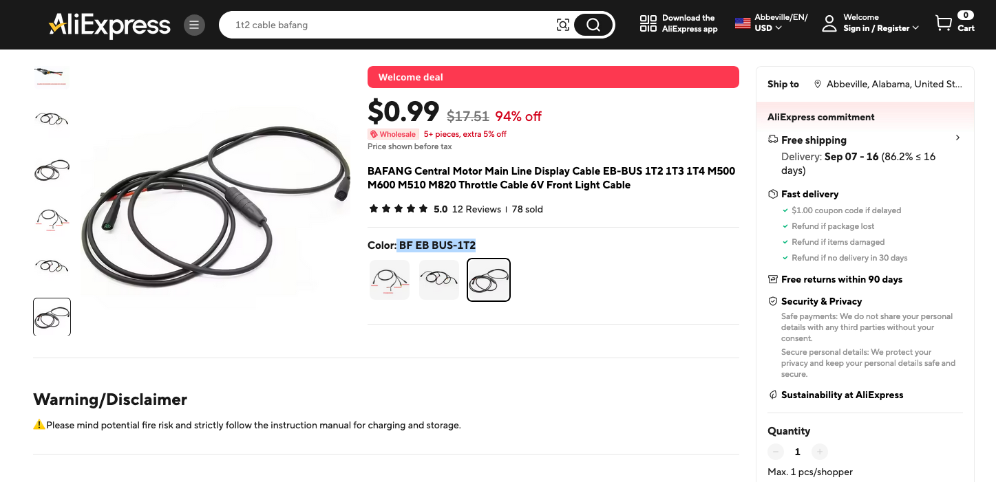

Hello gkparker85, did you solve the problem? The cable that goes to the display may not connect if it is not inserted firmly, so I think it's better to insert it firmly again. Also, I don't see many cables with power buttons on this forum, so the cable itself may not be compatible. I think the cable that came with my frame kit was BF EB BUS-1T2. I hope the problem is solved soon.
BAFANG Central Motor Main Line Display Cable EB-BUS 1T2 1T3 1T4 M500 M600 M510 M820 Throttle Cable 6V Front Light Cable - AliExpress 18
PaulH
Apr 23, 2024
35
28
Dallas, Texas USA
It3, but I suspect the it2 would work with a non-canbus battery, i.e. DIY.

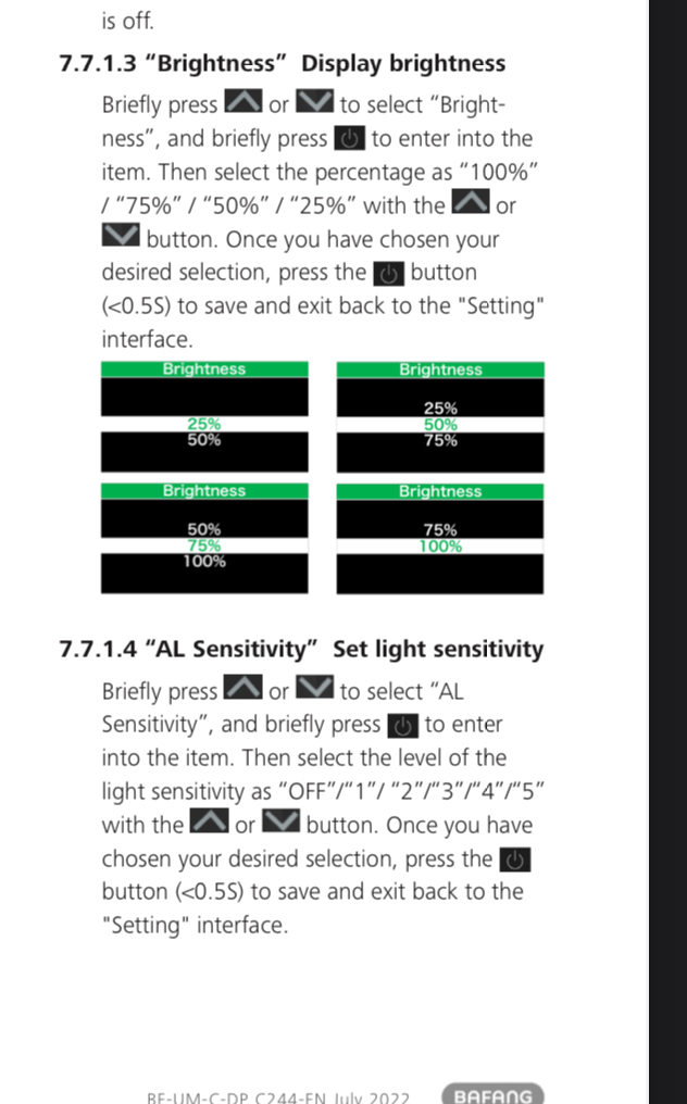

Thanks for all the replies offering to help me troubleshoot my problem. I finally managed to get the display to turn on, but now I'm running into a whole new issue. Whenever the bike is pointed downhill, the headlight icon turns on and the display goes dim. Pointing it back uphill causes the icon to turn off and the display to get bright again. The unused accessory cable for a light is completely unused - dangling free with the terminals not touching anything while this happens.
Joshack92
Aug 27, 2024
Uk
Sounds like a loose plug or something along those lines. Check the connections
Rusty-spokes
Aug 20, 2024
7
11
Canada
I had this and it’s an auto dim, the light sensor is just sensing different light. Go into display settings and go to AL sensitivity and select OFF

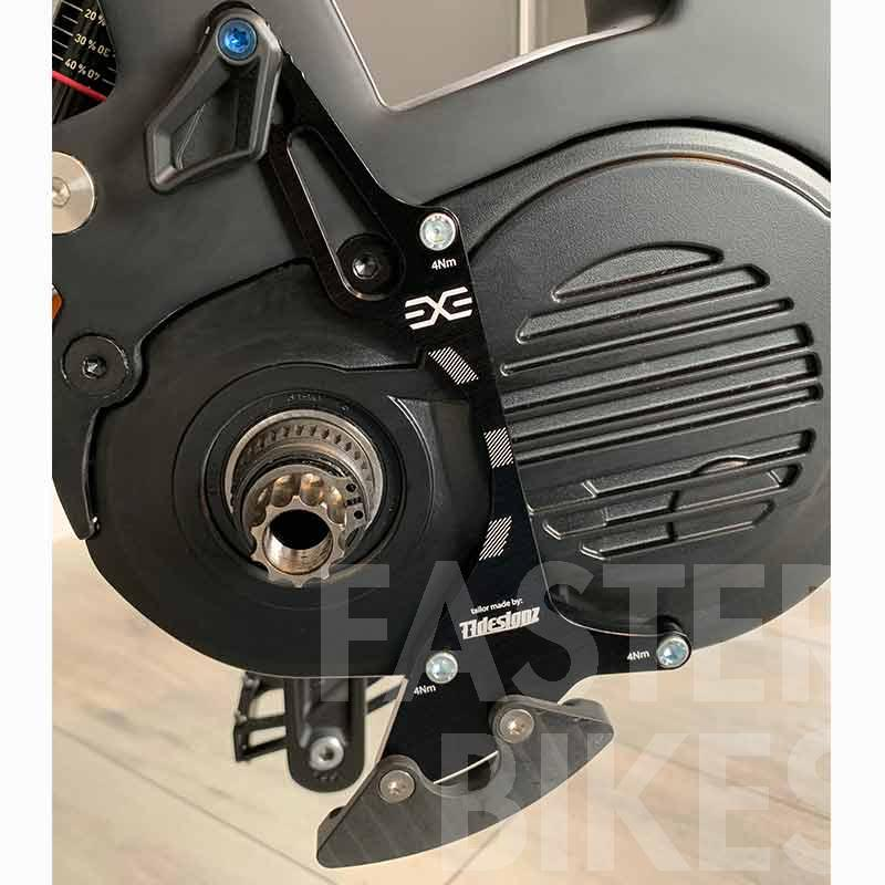

Did anyone try the following chainguide / rock guard?
Might it fit the M820?
Or Maybe this chain guide:
Will try this one Ztto Fahrradkette führung iscg03 iscg05 bb Kettens chutz mtb dh am Ketten führung Kettenblatt 32-38t 1x System Kettenrad - AliExpress 18
