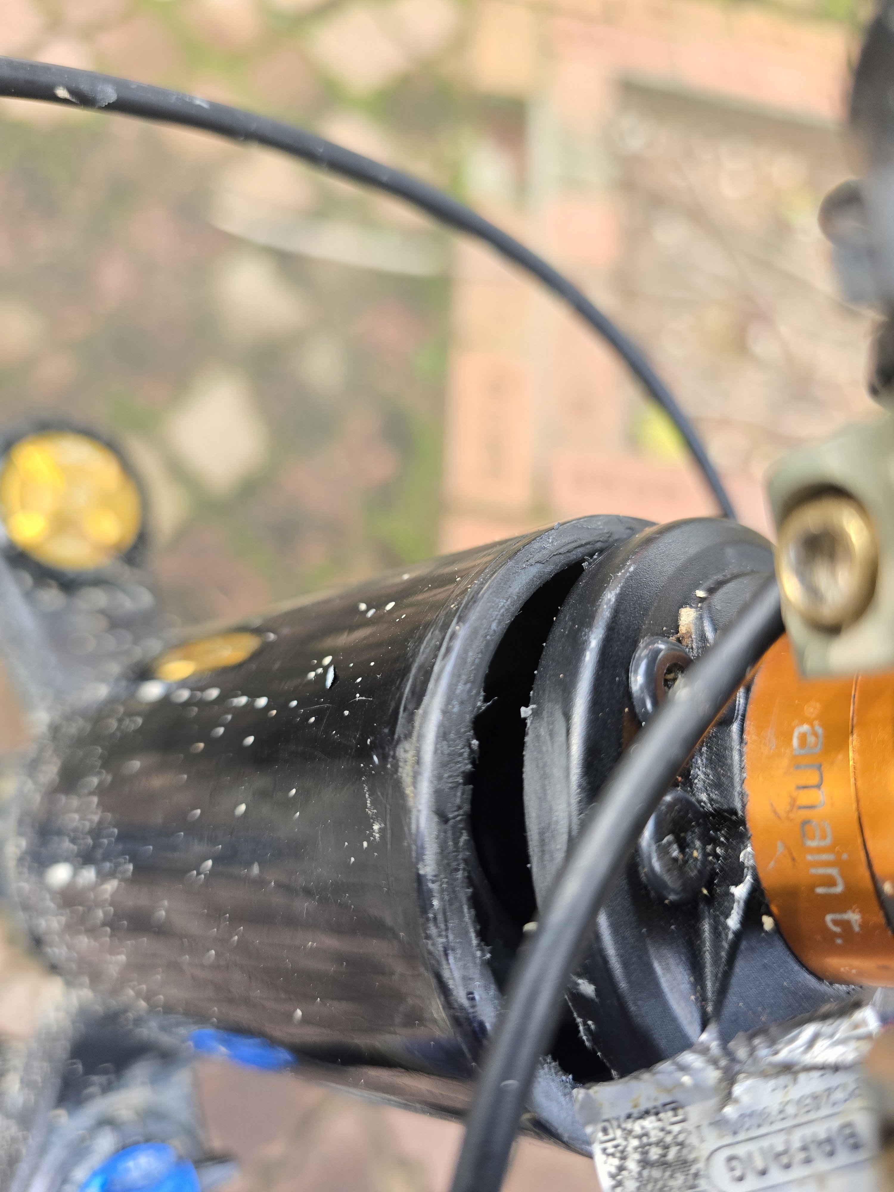

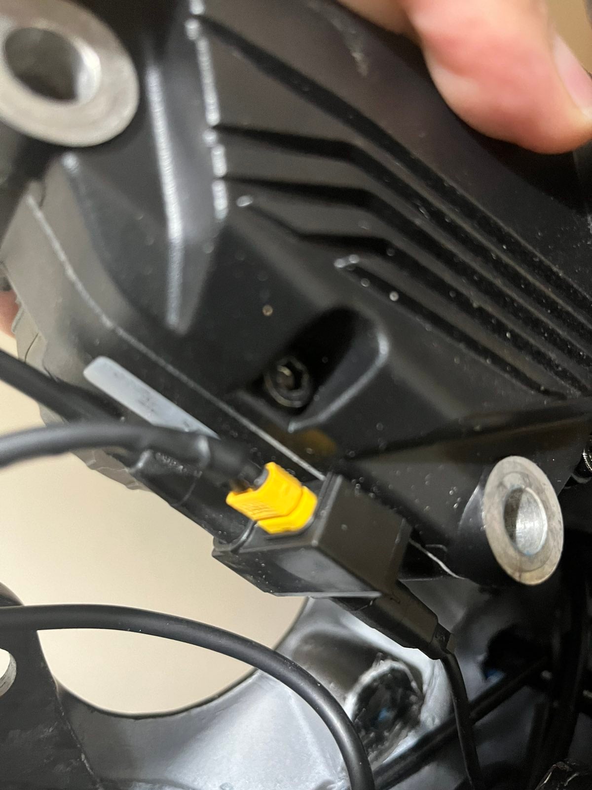

Hi guys, thank you very much for all the information that you have posted here. It was the first time in my life that I built a bike in general and with your help I was able almost to finish the building. The frame has side cable channels, FUNN components non-ICR headset. I have an issue that I have read many of you had also. I have no speed indication on the monitor. When I start pedaling, I have for a small duration the bike motor support but after a few seconds I get error 21. There is distance between the speed sensor and the magnet and they do not overlap. I am providing you some photos of the magne and and the speed sensor on the frame. How you did overcome this issue.

I tried both mounting positions and finally worked correctly after several tweaks....mine is on the top as well.

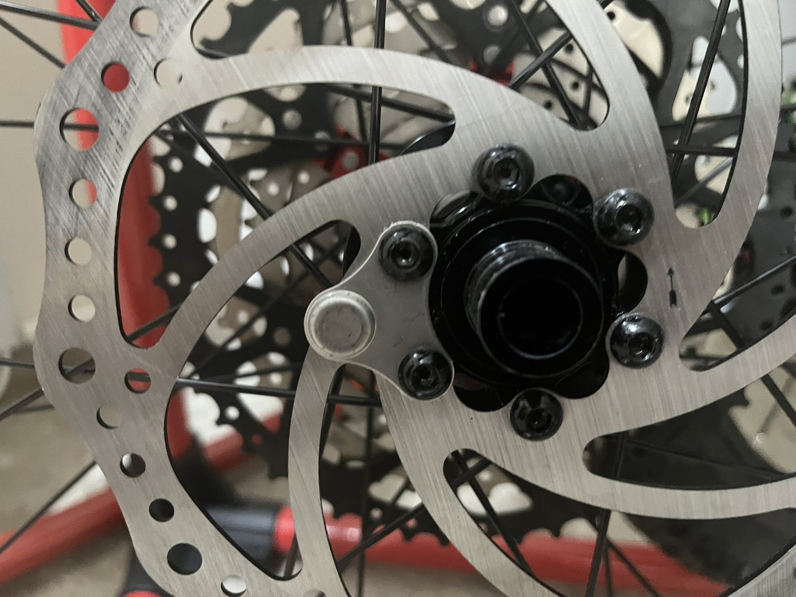

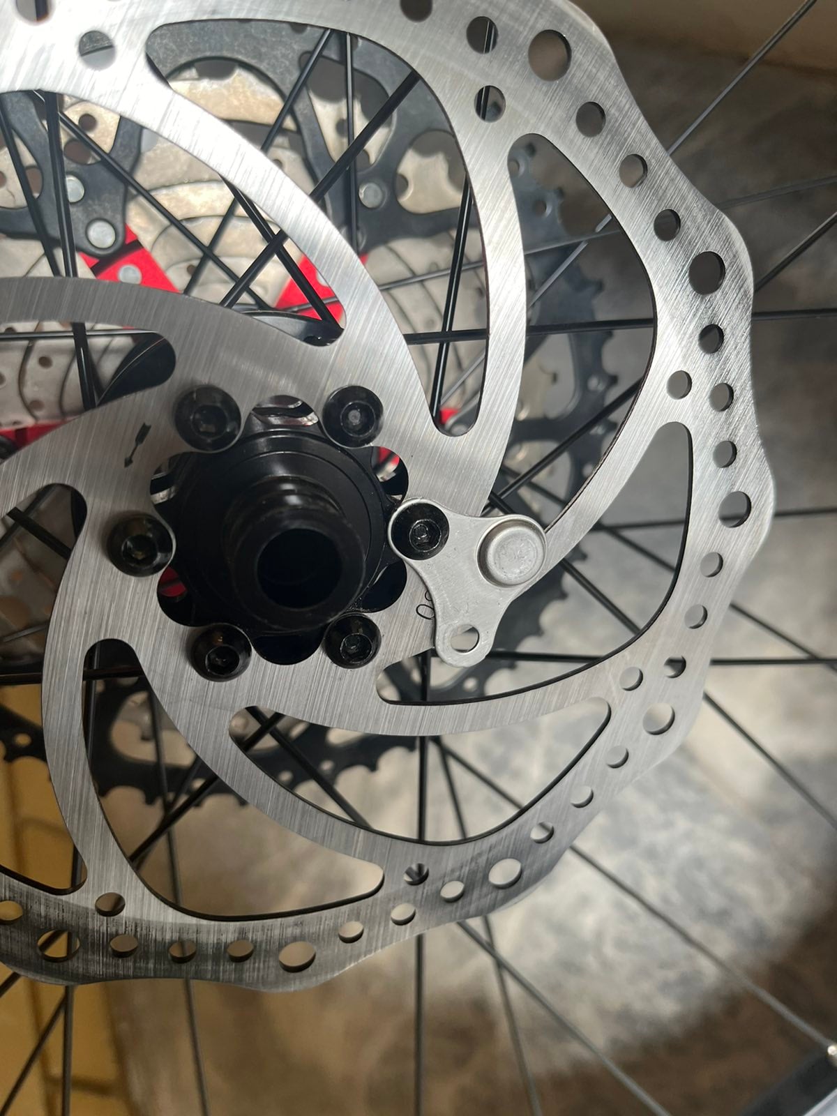

I found a solution I mounted the magnet only to one of the bolts and minimized the distance :oops:
Sadly now I have another issue :( . I took a very short ride to test that I fixed the previous issue and after 5 minutes I got error 30 and battery indication from 70% went to 0. Now that I placed it on the stand no issue again 70%. I have to check the connections on the motor but they look fine.

I found a solution I mounted the magnet only to one of the bolts and minimized the distance :oops: View attachment 147787 .
View attachment 147788 View attachment 147789
Why would speed sensor change cause battery issue? I think probably not related. For the sensor you running size disk rotors? but shouldnt make a difference still. My kit only arrives next week so will go through the install and will see :)

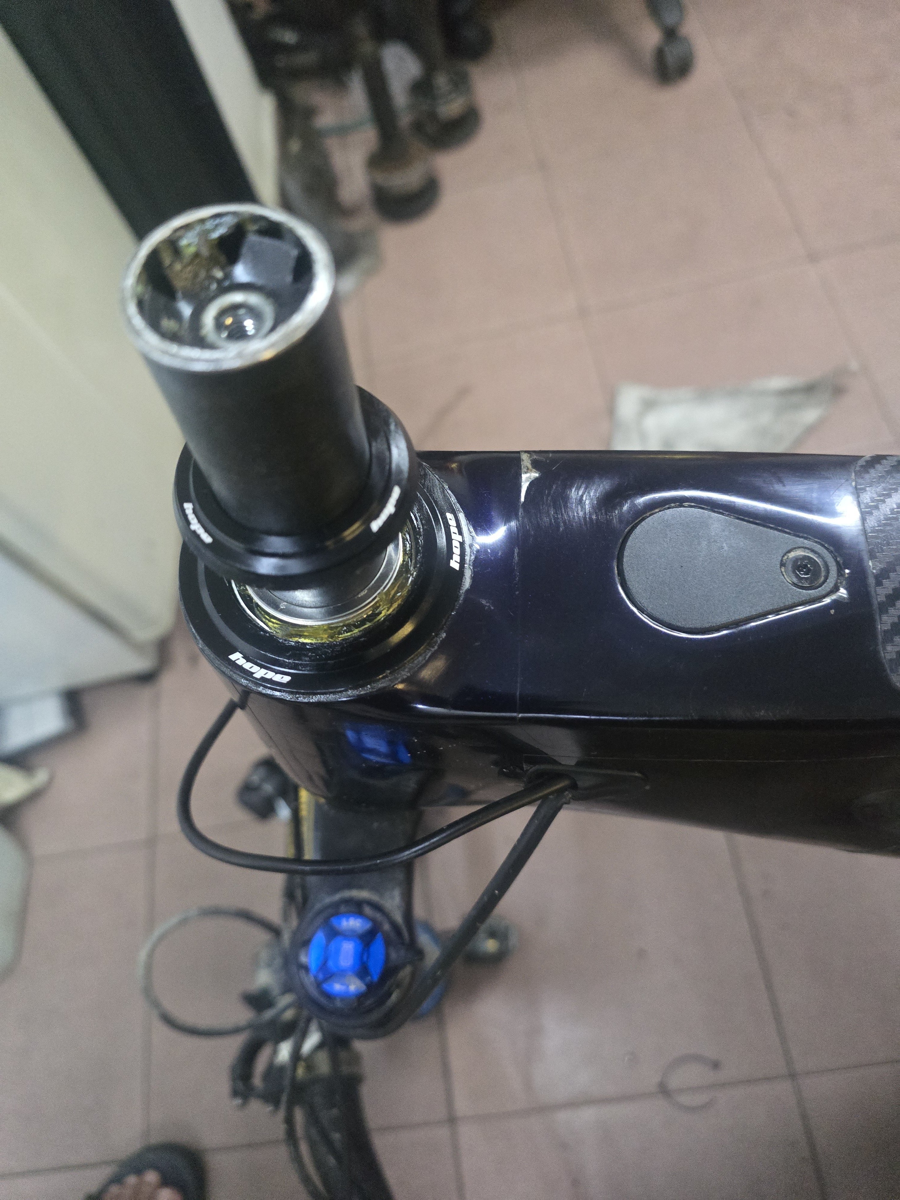

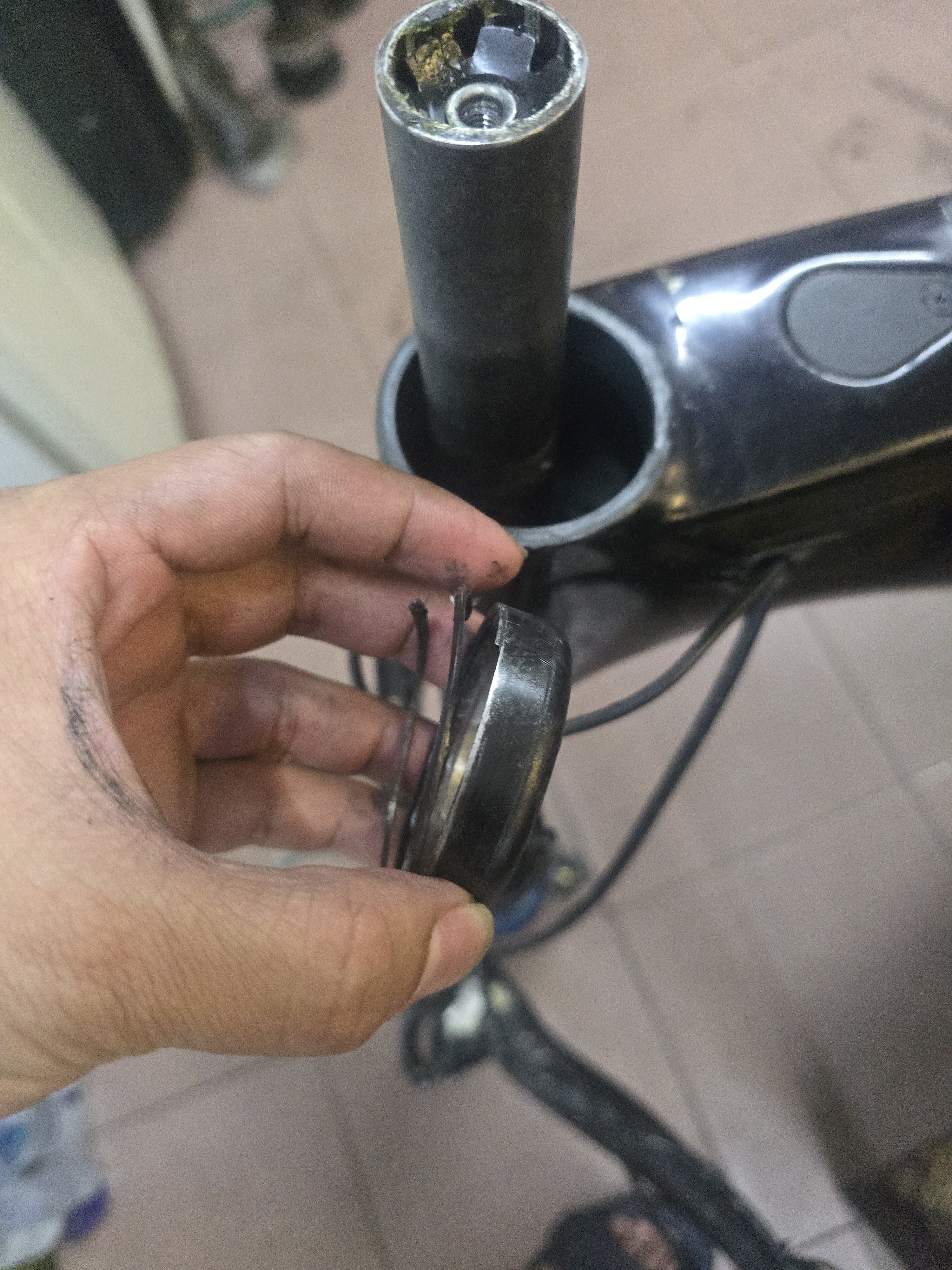

Your speed sensor it's waiting to be break once your frame it's fully compress. As for error 21, just pull out all speed sensor connector [inlcude the join or extension too] and push it back in. It's normal for Bafang motor, i install 5 bike and all has this similar problem when new , after several pull n push and problem gone.

It is normal for Bafang connector has connection problem when its new, i think during manufacturing , its has been cover by some layer of protection so when you first install , it has several error and by push in and out several time, it break the layer. My own bike when new i been having connection problem and now after 6 months plus, the problem gone.

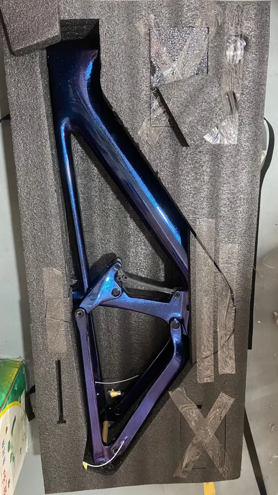

Just received the frame and I put battery in... Problem is frame inside was not smooth entry have to force it to get it on so it's not coming out without special tools :) otherwise would of send you the measures. Sorry mate.

Quality is good....except battery doesn't fit well :) and shock bushings 22mm only is 22.2mm you need to brush them to reduce the size. Also motor to battery if not working just disconnect and reconnect properly :) so far not bad still 😭
