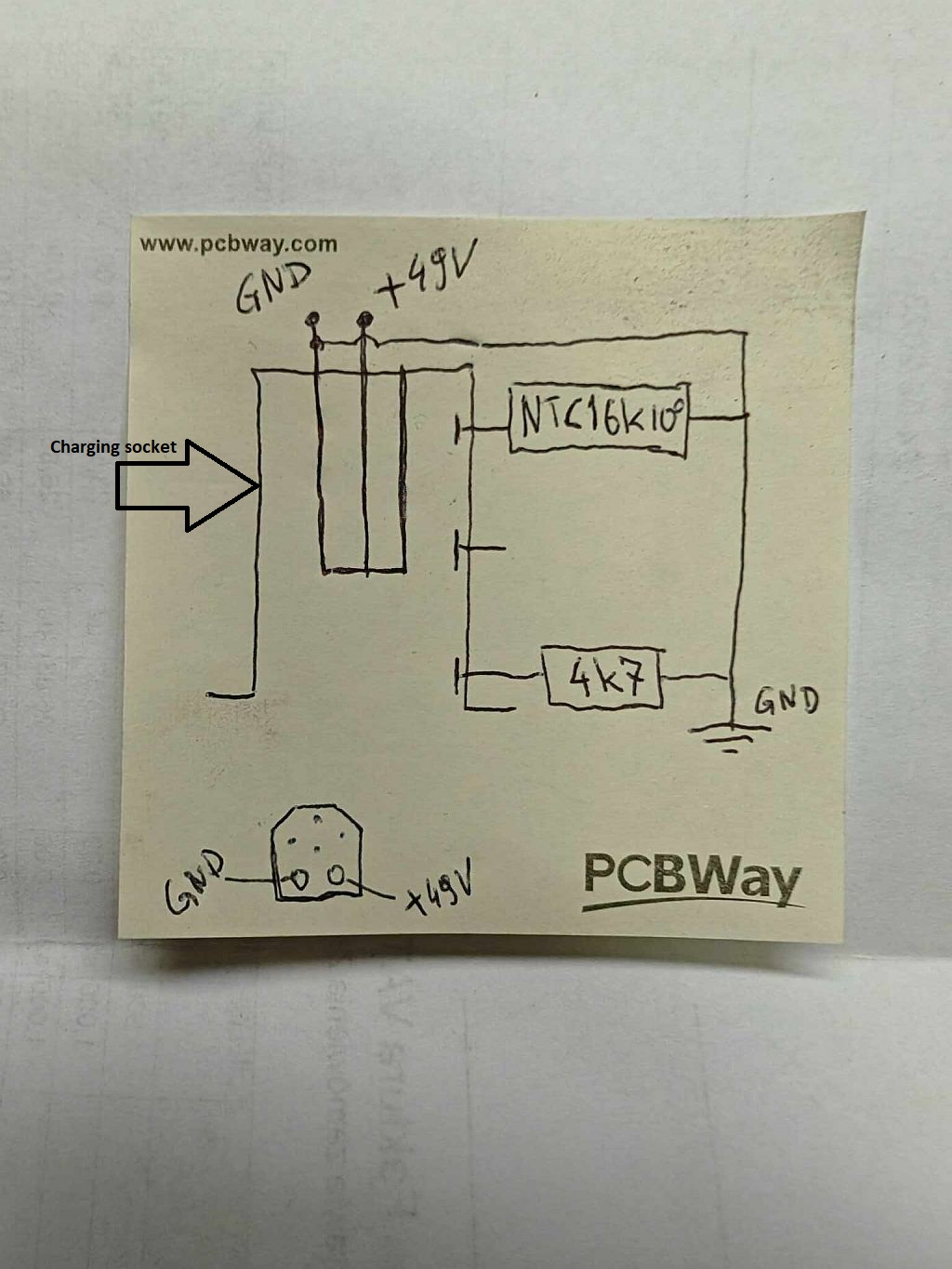

Yes, you can fitt 5,5mm connector. In order to use it there are two options.
1. Buy lab psu 60V 5A.
2. Modyfiy ori 2A bafang charger, you will need 4,7kR and 15kR resistor, both 0,6W. Next solder then in the charger an replace bafang cable wit standard cable with 5,5mm plug.

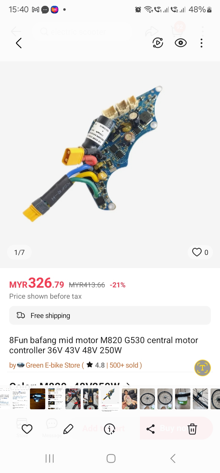

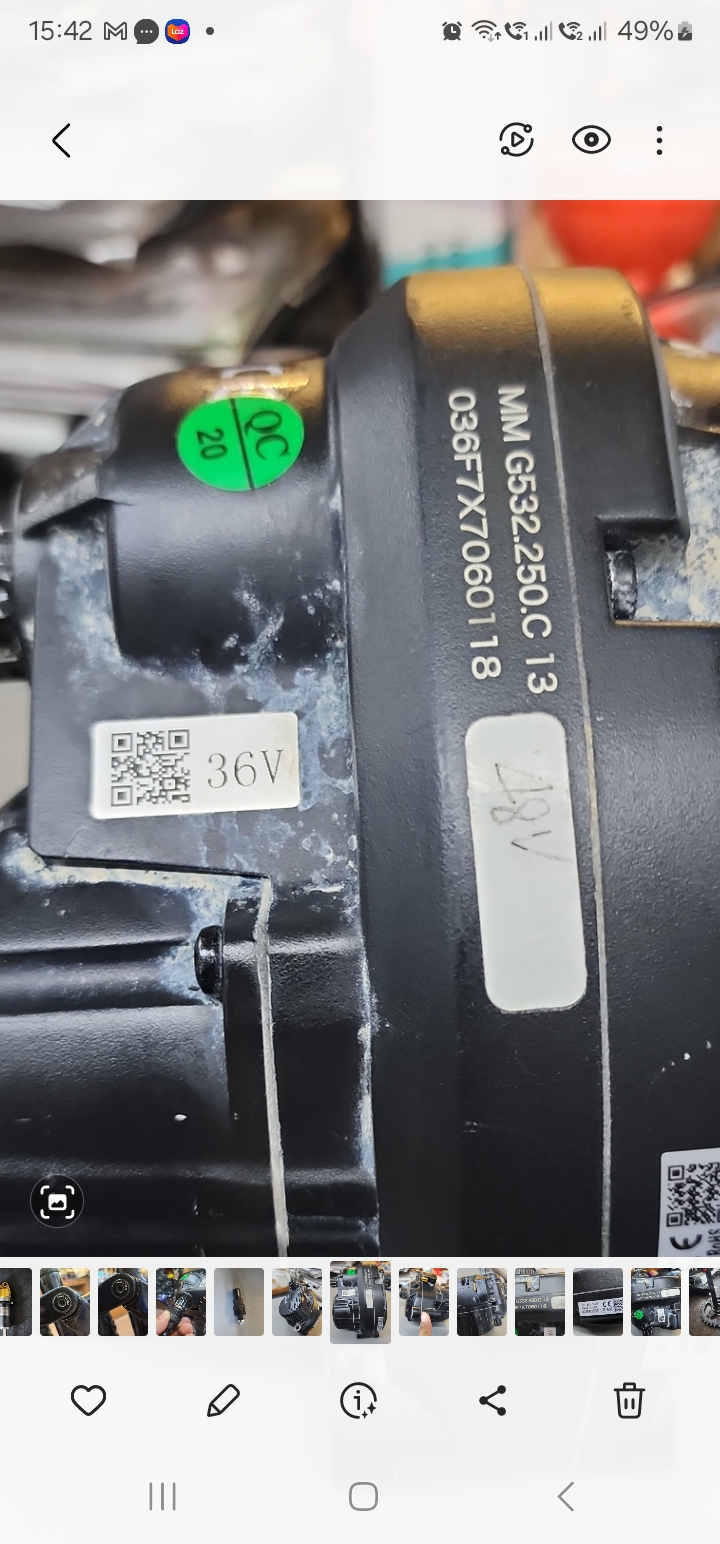

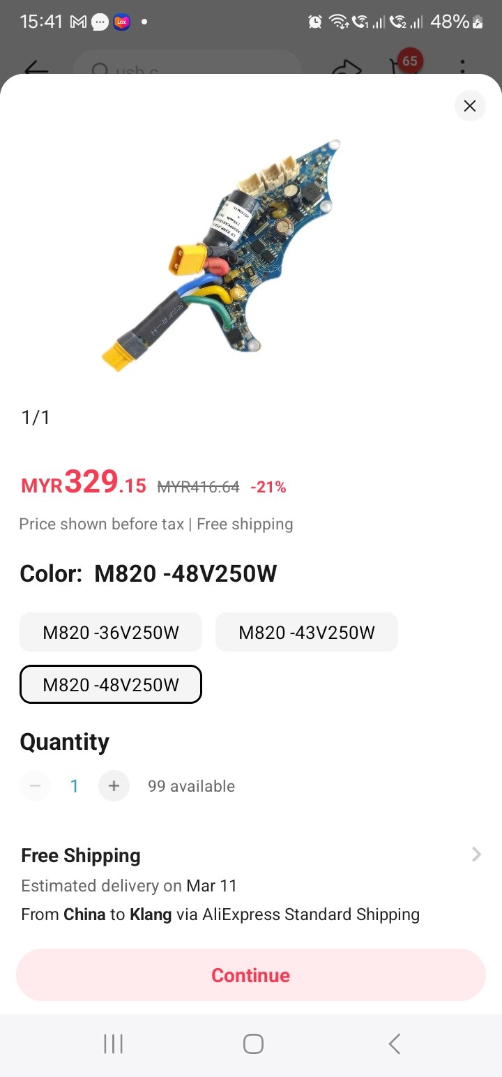

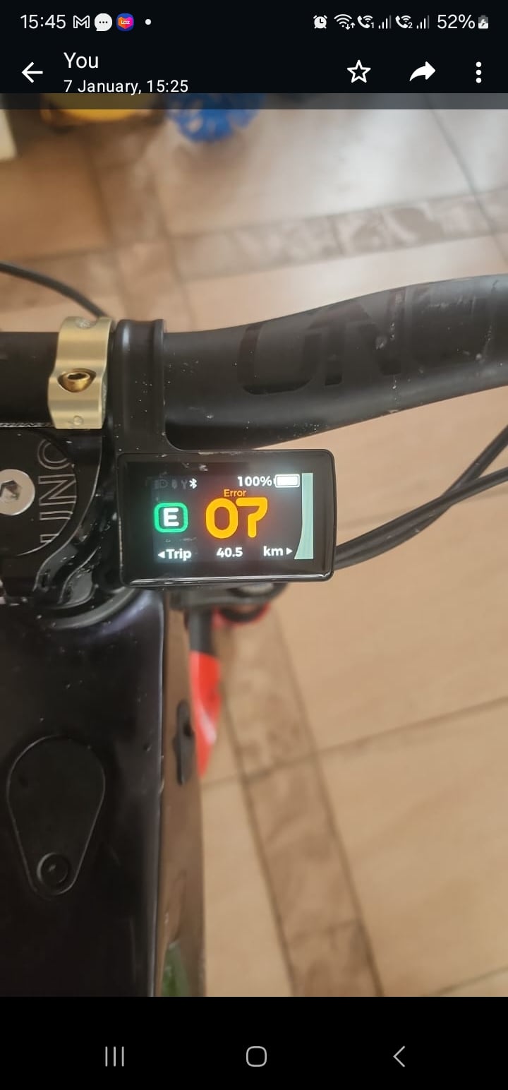

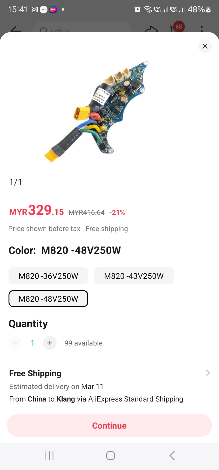

Quick question for those with a 48v motor , when you bought your bikes, did you also have to pair it with a 48 volt battery or can you run the system with 36v battery?
My motor originally its 36v and then linda upgrade it to 48v. When i update using Bafang Go+ firmware, its update 36v and i got error 07 which is over voltages protection because my battery its 48v so i need to use Bafang besst to manually update its back to 48v.

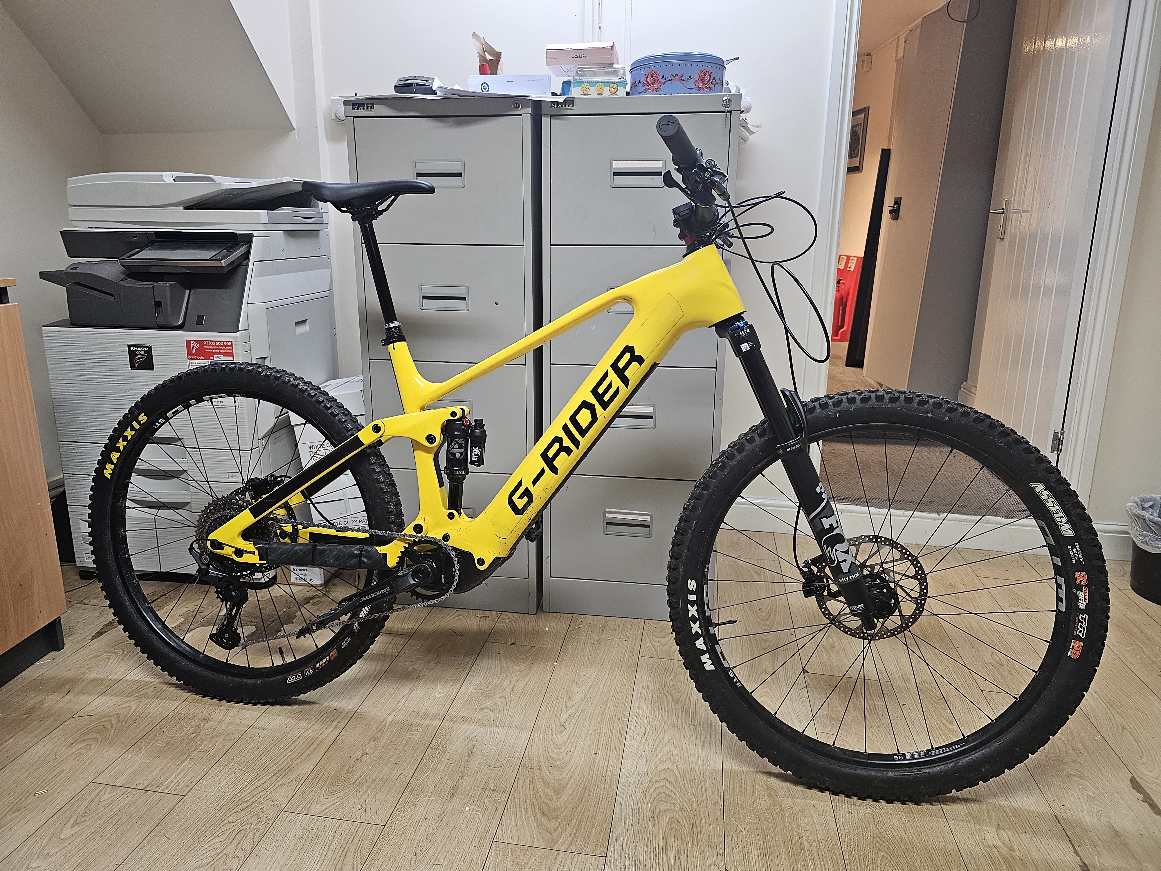

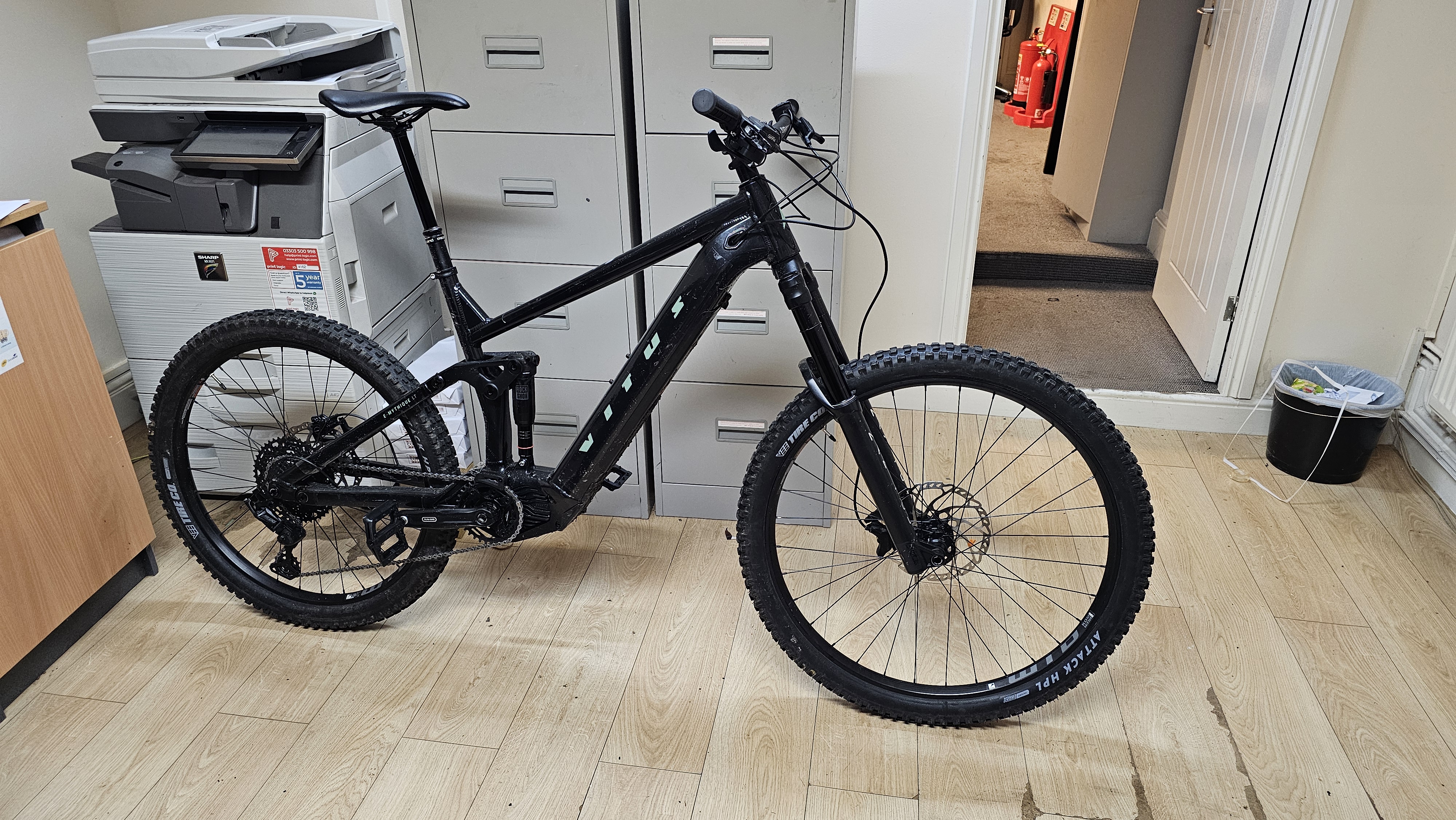

I'll need to take better pictures (as well as upgrade/program a couple of choice components). But
you're looking at two 2024 X-large emtbs which use the entire Bafang systems, which can both be ridden hard.
Rejoice my tall DIY enthusiasts. We now have more options👏🏿👏🏿👏🏿

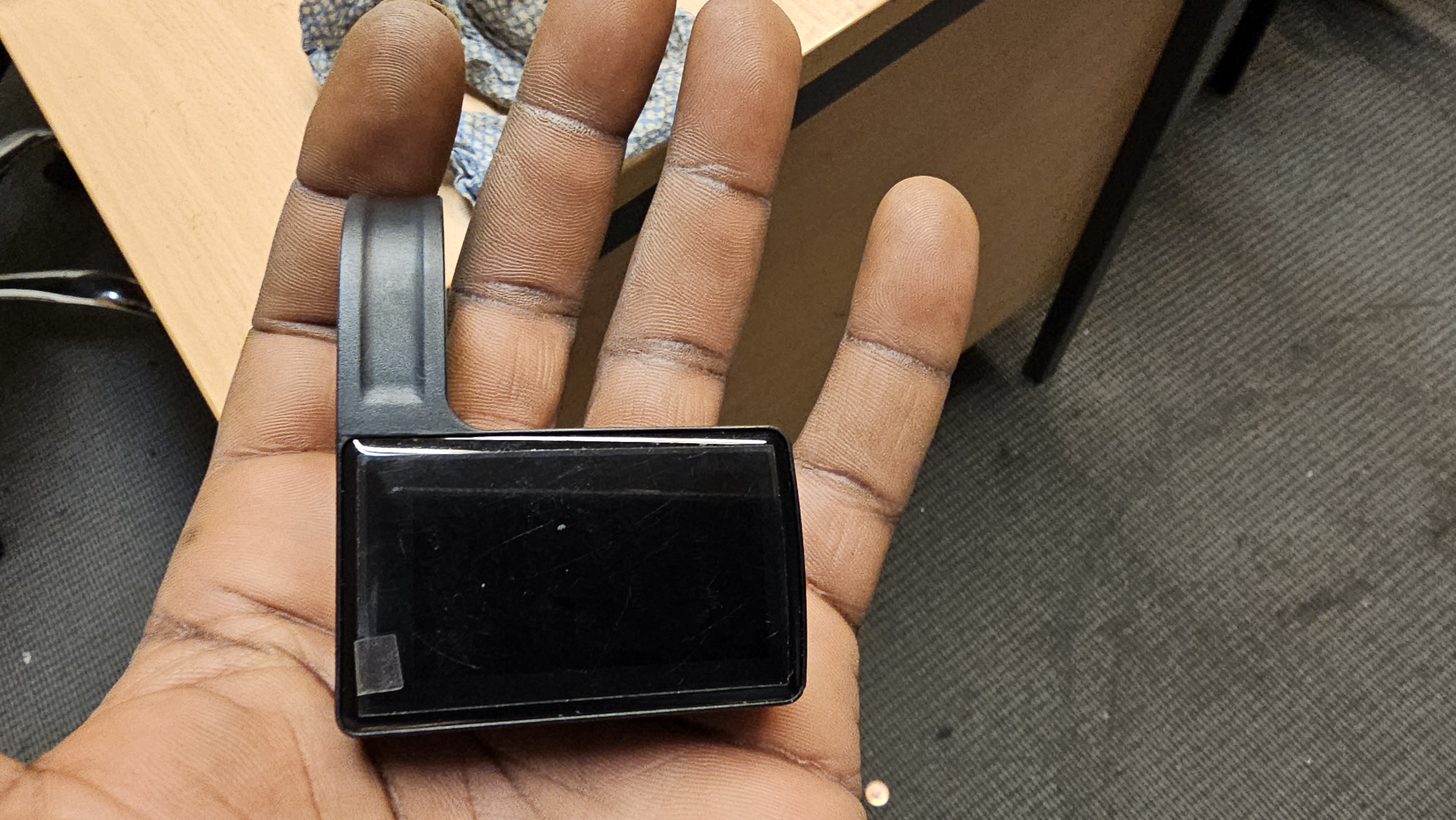

Interested in what you come up with on the e-mythique. I getting ready to order either the BESSET tool or the K1 box to program my wife’s. She is really struggling with the factory programming.
I hear you👍🏿
Before I deep dive reprogram the M510, I wouldn't mind trying a 32t chainring. This is the chainring size I use on my E10. I have a feeling that the motor response (the start current) and the motor over-run (stop decay), 'might' benefit from a using a smaller chainring to compensate the existing motor tune.
I'm not saying it'll rectify this issue. But it's worth trying before I start testing numerous 36v firmwares for the M510.
If you go into detail as to what your wife finds unpleasant about the M510 motor, I can factor that into my experiments over the weekend👍🏿

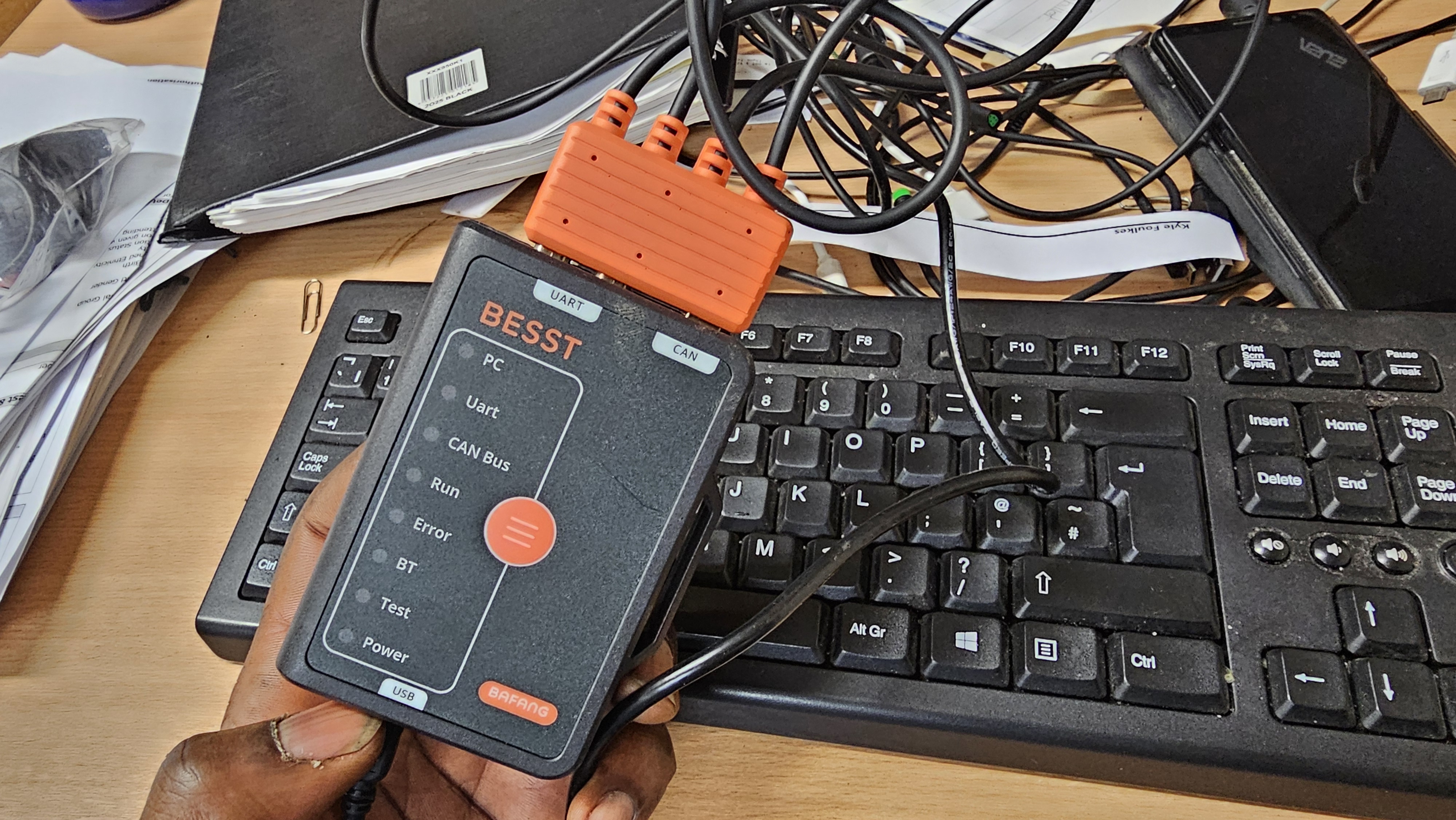

I have debated on getting a BESST tool and trying to work out a key or the work around or getting a K1 Flash. There's not much documentation on how to make adjustments with the BESST tool but the K1 seems to be pretty user friendly. I'm leaning toward the K1 but I'm still unsure.

ho much extra settings do we get from BESST, compaired to GO app??
my 48V motor unable to access Go+ funtion (Set personalized ride) only besst can do. For calibration you need besst and manual update firmware. Don't update your Bafang Go+ firmware if you dont have access Besst USB, else u will be like me. G0+ update wrong version automatic and i have have to manually fix it back with BESST,
ahh I was told my 48v motor could be setup via GO+ , sounds like this is NOT the case.....bugger.... thx for the answer!!
