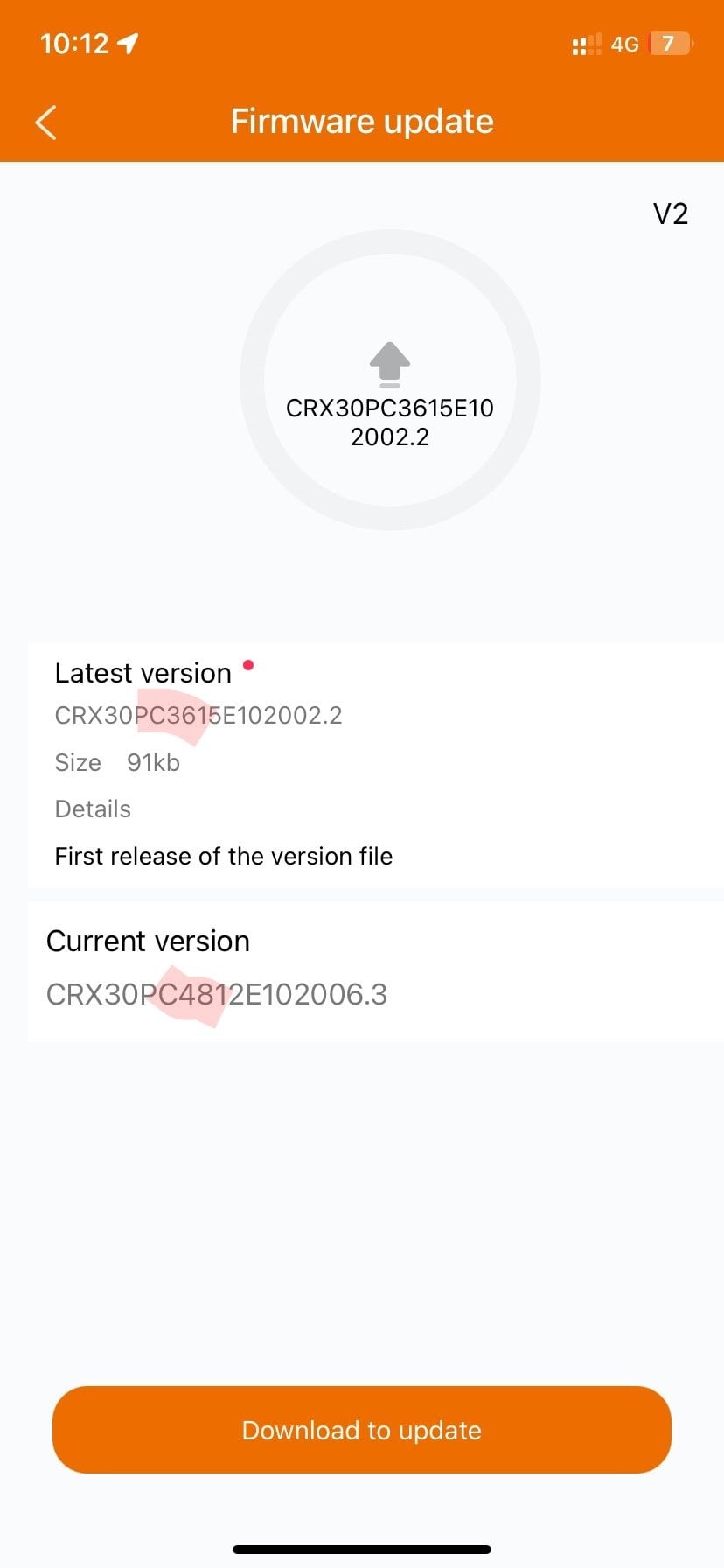

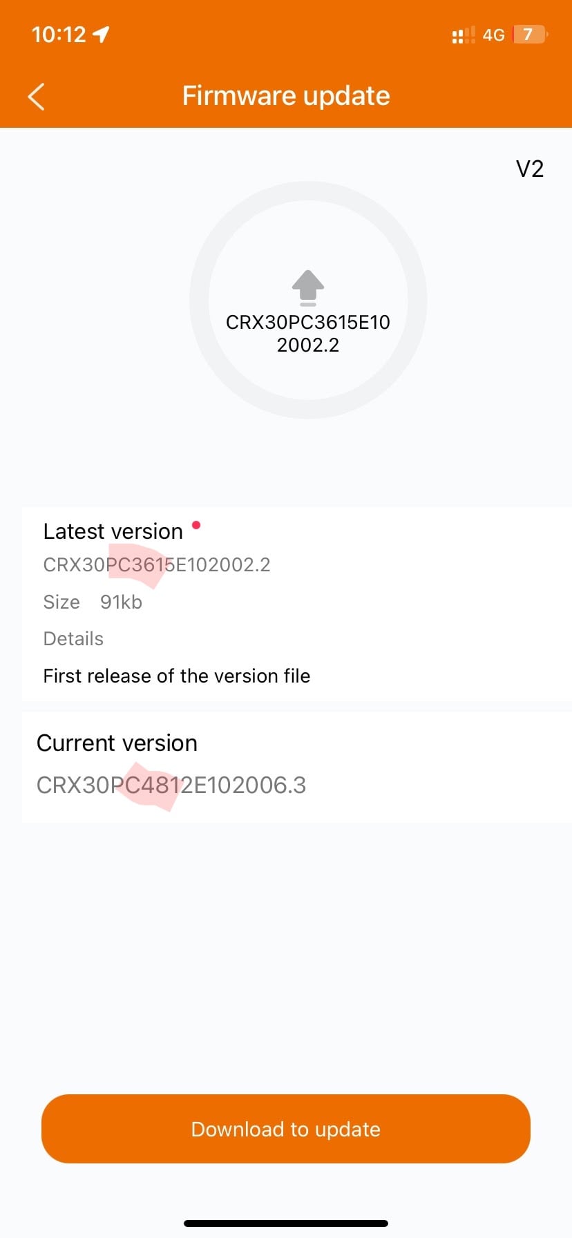

But Go+ works as long as you dont update firmware?
I have 48V version and I updated the firmware via GO+. It was Jim from LightCarbon that sent my motor ID to Bafang so I get 48V firmware. Previously I only got 36V version.
You can check for new firmware in GO+ and before updating you will see the firmware name, it tells you for what voltage it is. This is a screenshot of the wrong update file I had before Jim fixed it:
Ktronik
Jan 15, 2024
55
29
great, thx again for the help, I really don't want to brick it the first day....
