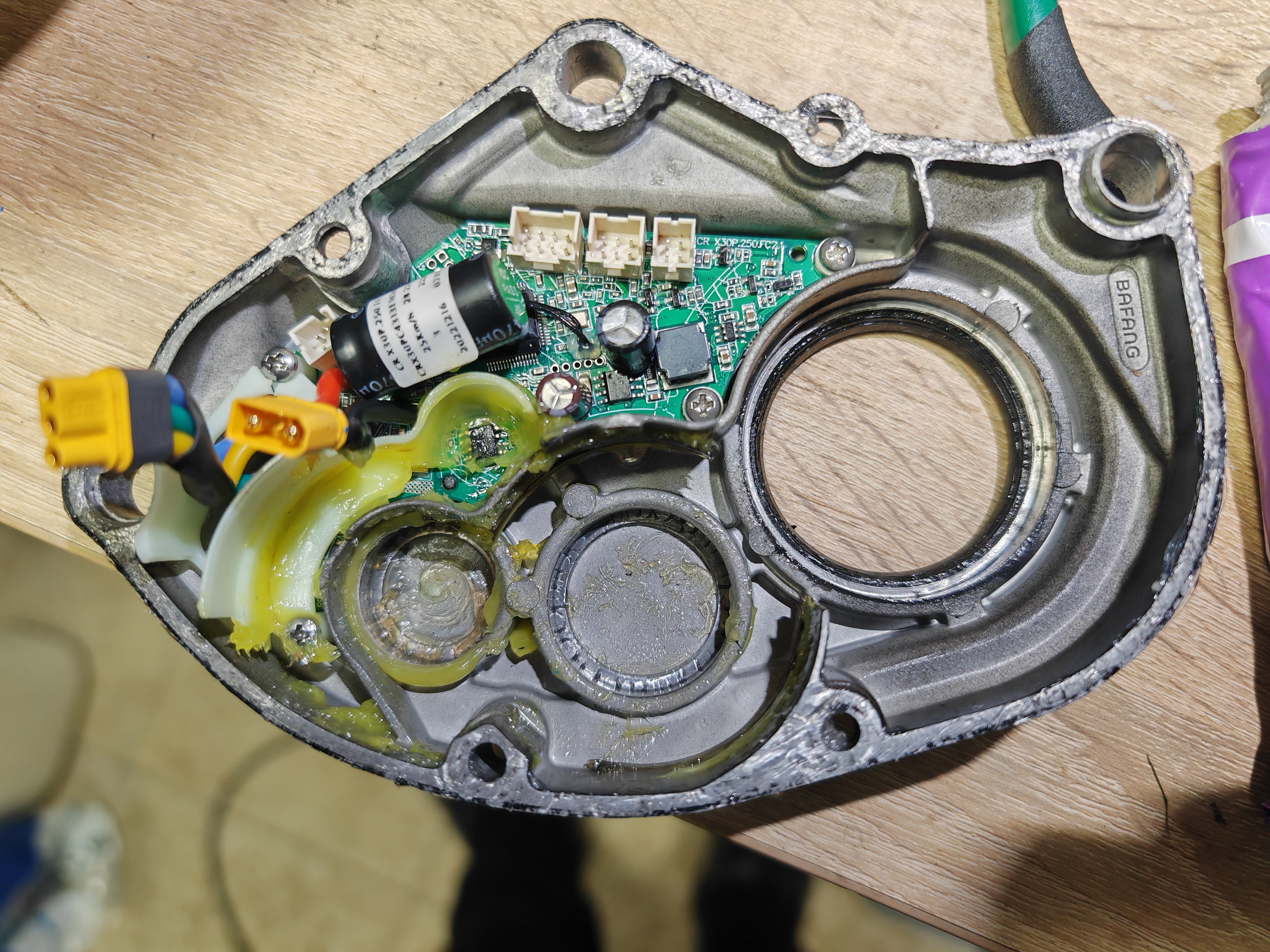

sure, air is mostly a insulator, and on the TSDz2 motor, they found that there was a poor 'thermal path' for the heat to travel to the outside, as the hot bits, did not connect to the metal case well, in this case, the parts of the motor was over heating, as it could not dissapte the heat well, in this case of the TSDz2, it would thermal regulate its self.
After heatsinking pads was added. that came in contact with the case, the issue was fixed, not saying this is happening, just it might still be a possablity till we count out.
Missing a gap pad is just a terrible design but what does that have anything to do with a cold motor? Or are you saying the motor housing being cold is caused potentially by a missing gap pad? That i agree with, thats why im hoping to get some pics to troubleshoot.

in this case, I was meaning a cool motor shell, after use, may not mean motor is not overheating some chips on board, as it could be due to unpotted electroincs, it might be a possability till we have a good look inside....
at work we always use a thermal camera so we can tell if we are hitting thermal regulation on the chips we use... if needed we add better thermal paths or extra heatshinking, I know this was the case some motors in the past, so its worth looking into.
I would not expect this to happen on low power, but if on higher power, it happens, then it might be worth looking at
maybe there are some pics of it open around???

In my experience, if they do not do thermal calculations properly, you can run into overtemp conditions that can compromise thermal transfer pads, depending on which type is used. Some have a soft substrate that can run if it is overtemped, causing an air gap eventually. Thermal grease can also exhibit similar behavior. Thats why i am so interested in taking a look inside the unit.

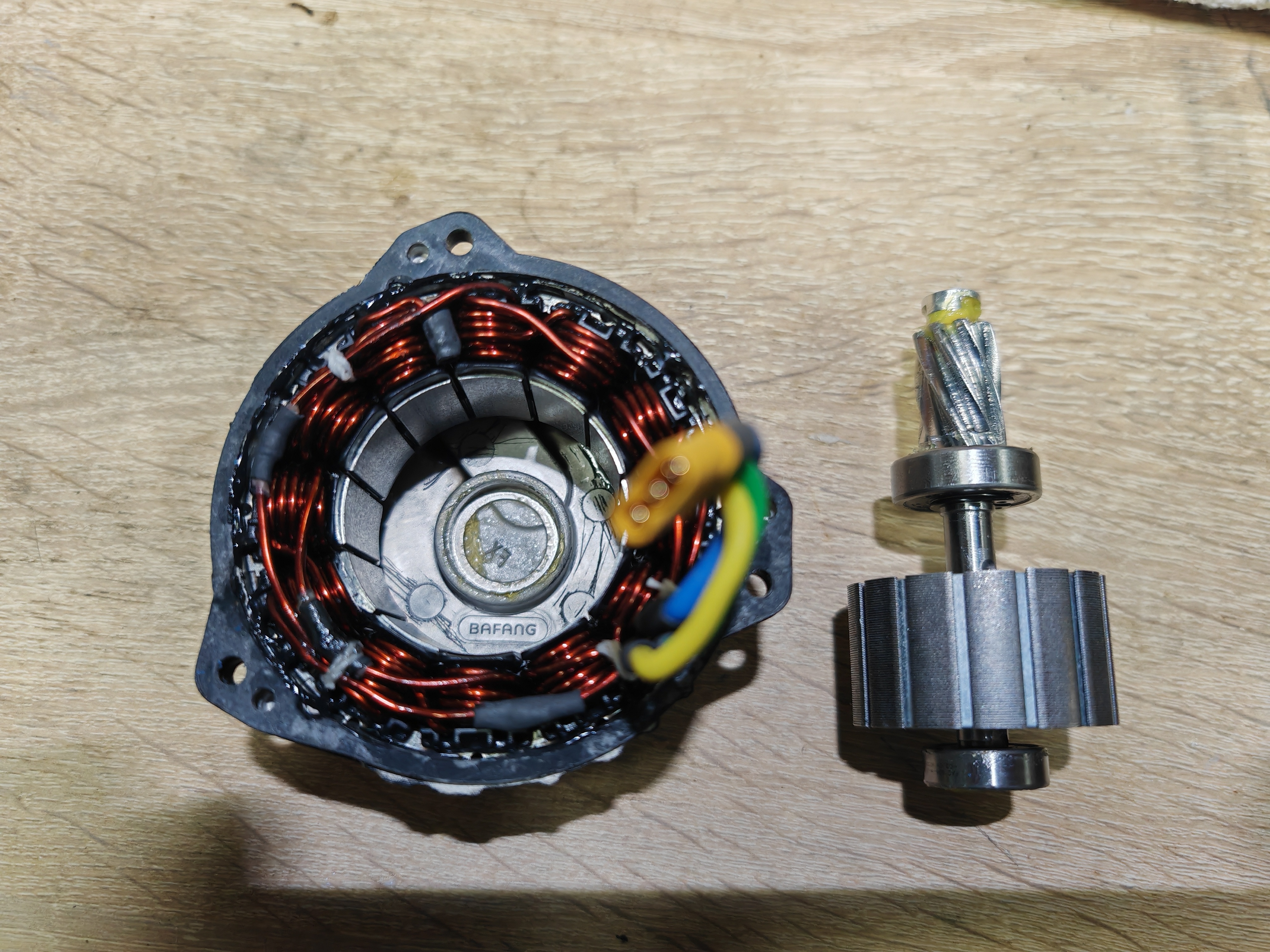

for what is worth its a inrunner motor, at least its not a out runner, so I am guessing this is part does not have a heat issue...
Ktronik
Jan 15, 2024
55
29
I think this is a M820's inside.... worth adding some conformal coating if there is none...

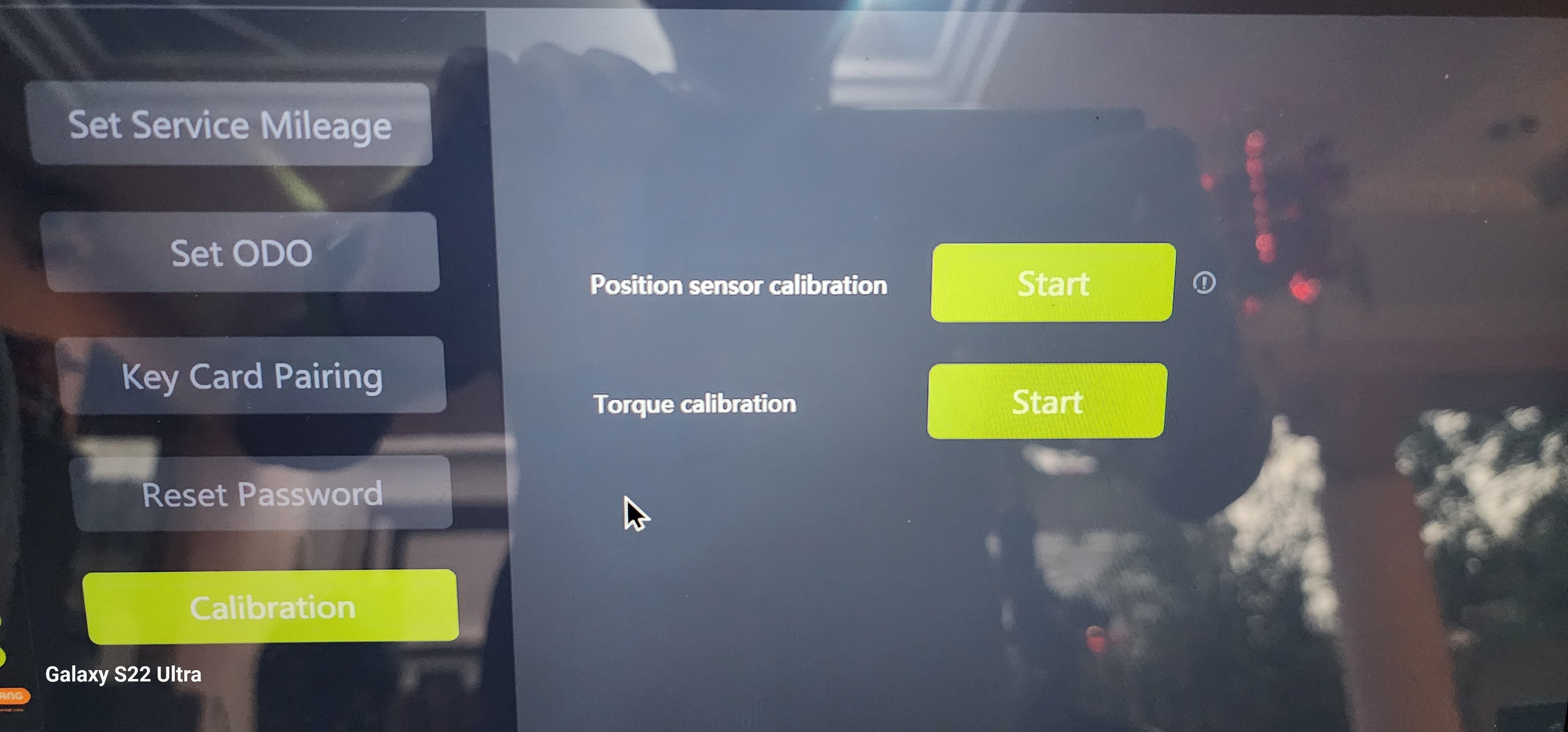

You can test the torque sensor functioning ? how ? since the M510 i can't read torque sensor characteristic and calibrate it.
I just tested both besst function yesterday and its pass the the test. Maybe u can try this. There another motor diagnostic function but i am lazy to test it because i need to rise my rear wheel up n pedal it.

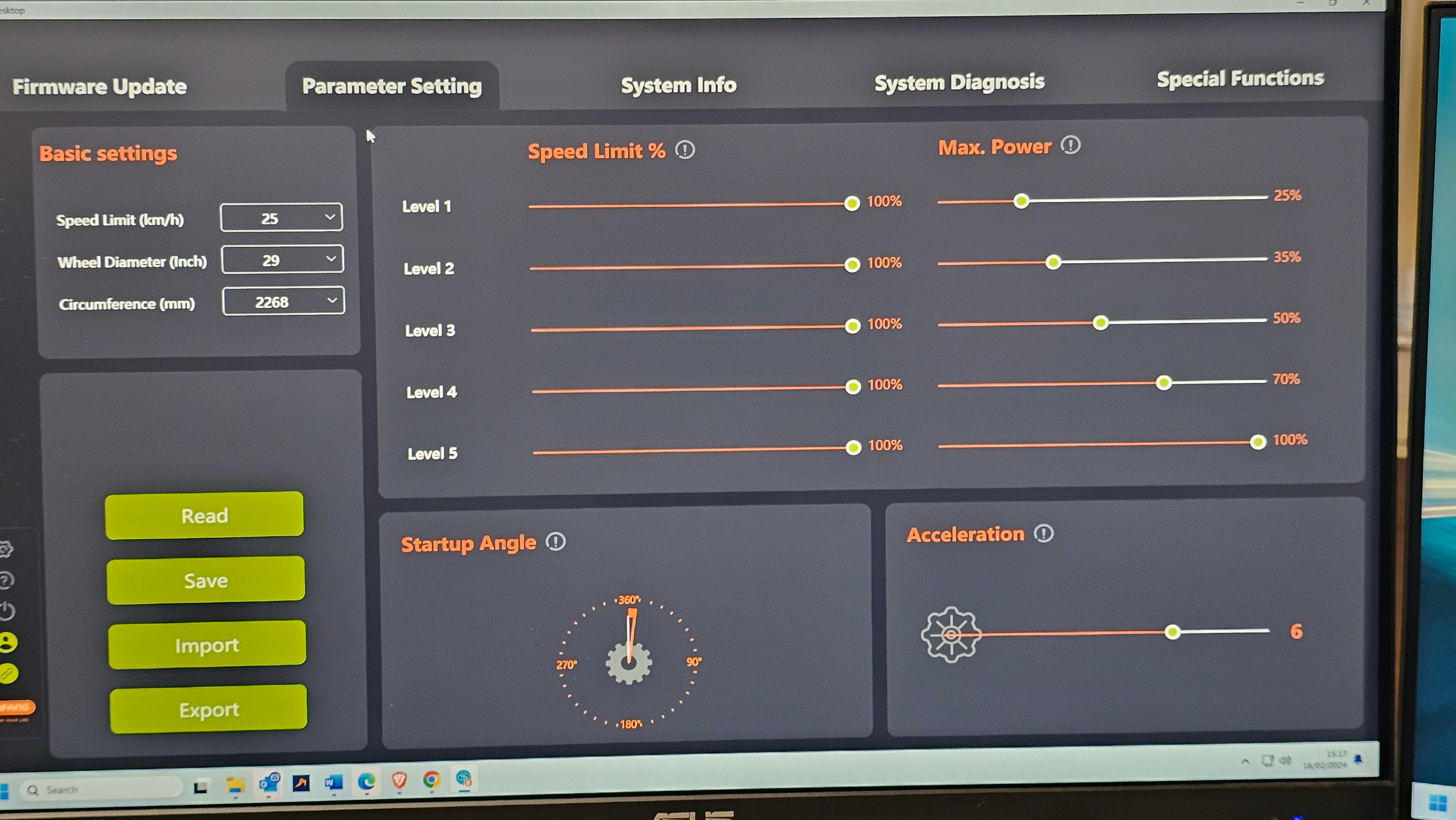

Is there a way to tune the M820 motor overrun? The motor seems to keep running a second after she stops pedalling.
Sometimes my wife even has to brake while pedalling uphill around a corner :eek:
Lower the power and u should have this problem solve, i dont feel it on E or reduce acceleration timing by using Bafang go+ or besst.

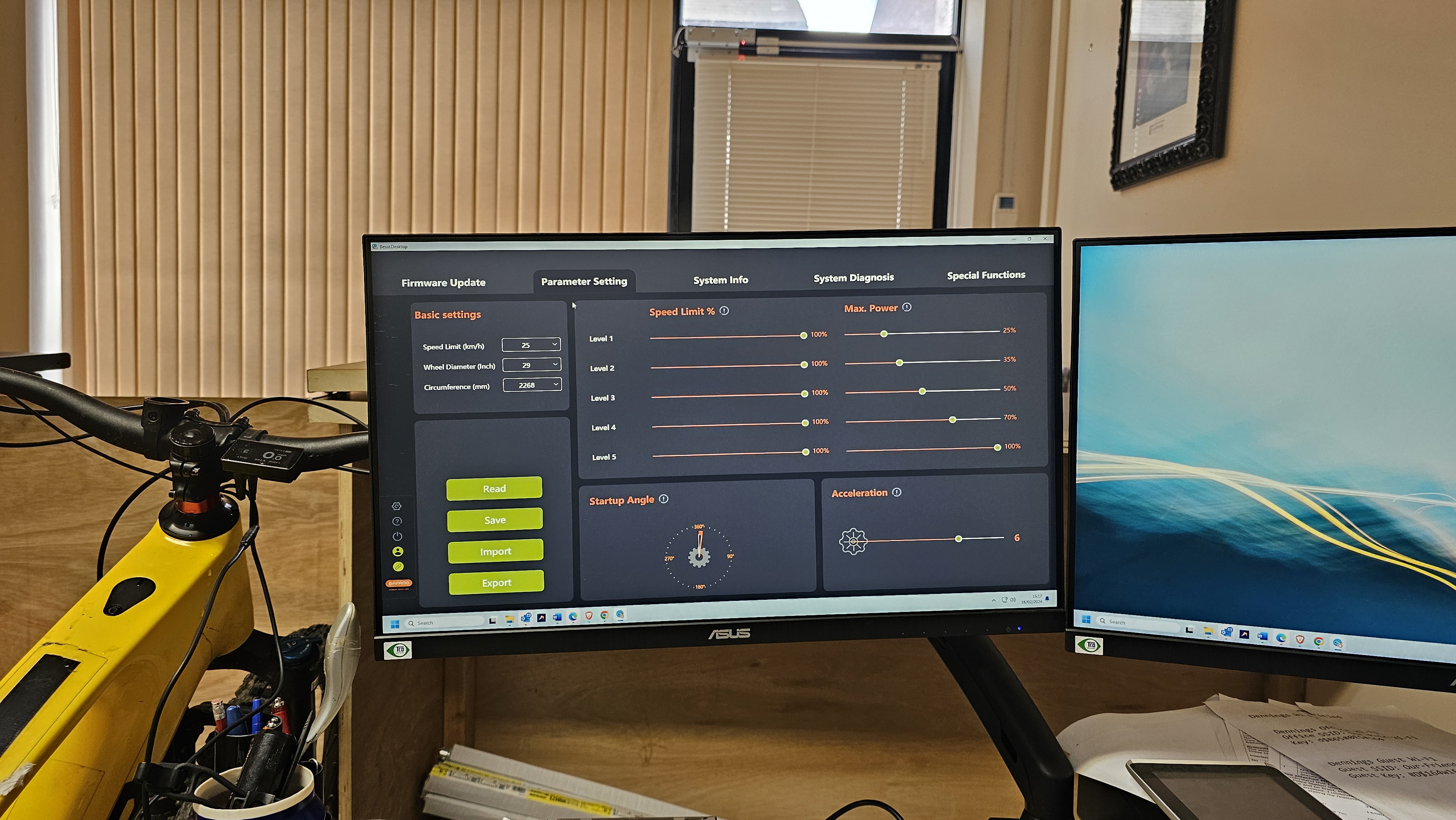

This is how I prefer to run my M820 on my CEF50👍🏿
My startup angle is set so that the motor engages instantly. But the acceleration has been dialed back to give the motor more of a natural feeling. I use a 32t chainring and see no point going higher (imo).
Truth be told, I find that I use thr bike overall in level 2-3 (Sport & Sport+). Boost is for riding with full-fat emtbs for fire road climbs👍🏿 20240216_151838.jpg
