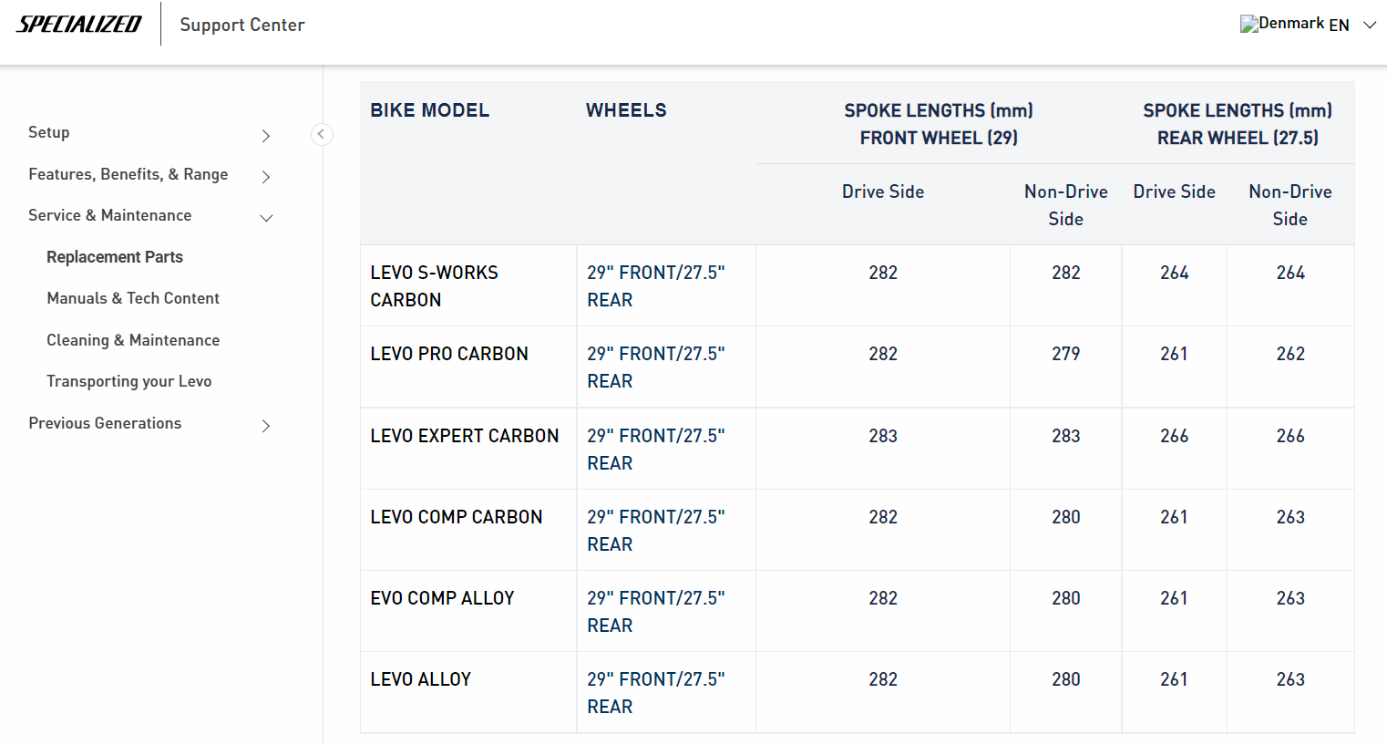

Anyone know the spoke lengths for the 27.5” Comp rear wheel?
You can find the data here: Specialized Support
