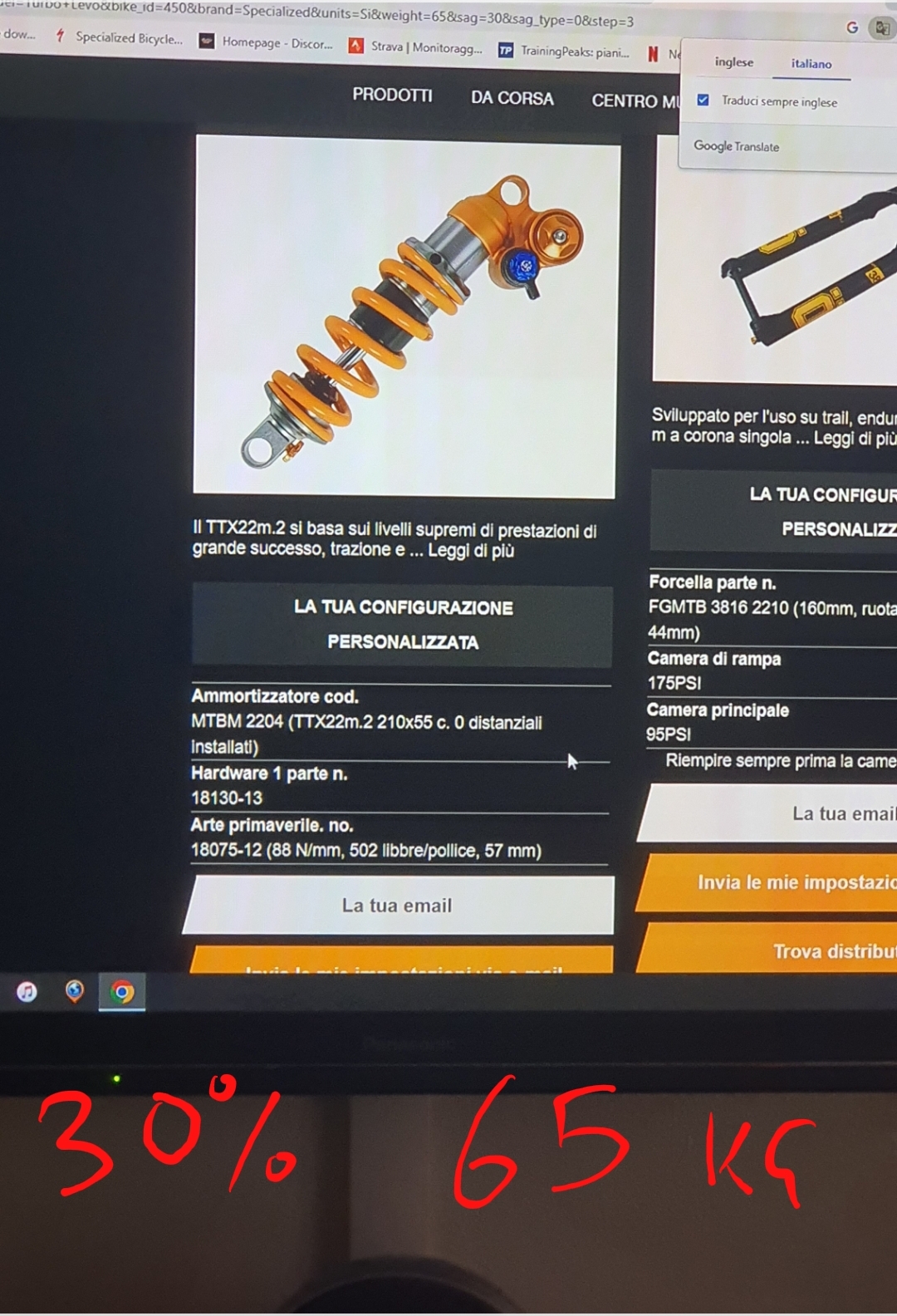

what I don't understand is why the ohlins online setup even recommends a 507 lbs spring for the turbo levo 22 for my weight...

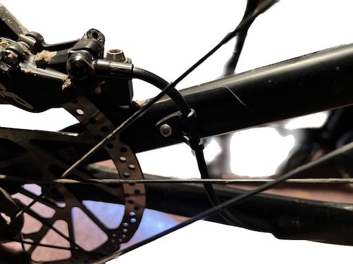

It looks like your brakes need aligning. If you use some washers you will use all of the pad on the rotor.
Agreed, that is why I have the proper stack height adapters on order as mentioned. This initial test was just to verify clearance on frame and the 2.3mm thickness rotors in the caliper.
