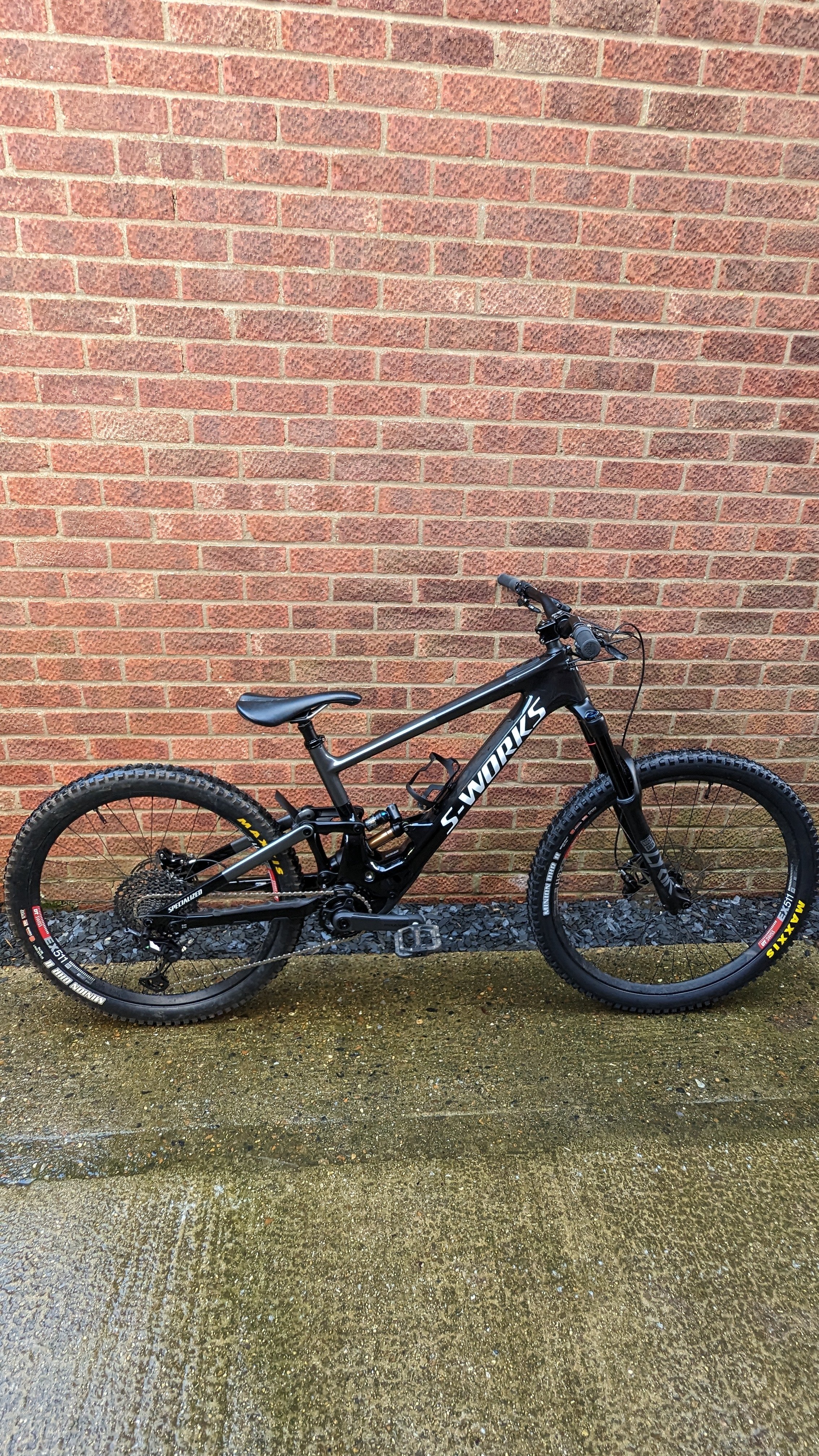

Well Ive basically finished up my build today, waiting on abit to re bleed the rear brake. Weights in at 18.9kg as is with what I'd class as a not overly weight conscious build
Took it for a spin up the road, so far so good 😂 hopefully I'll get to hit the trails next weekend!
