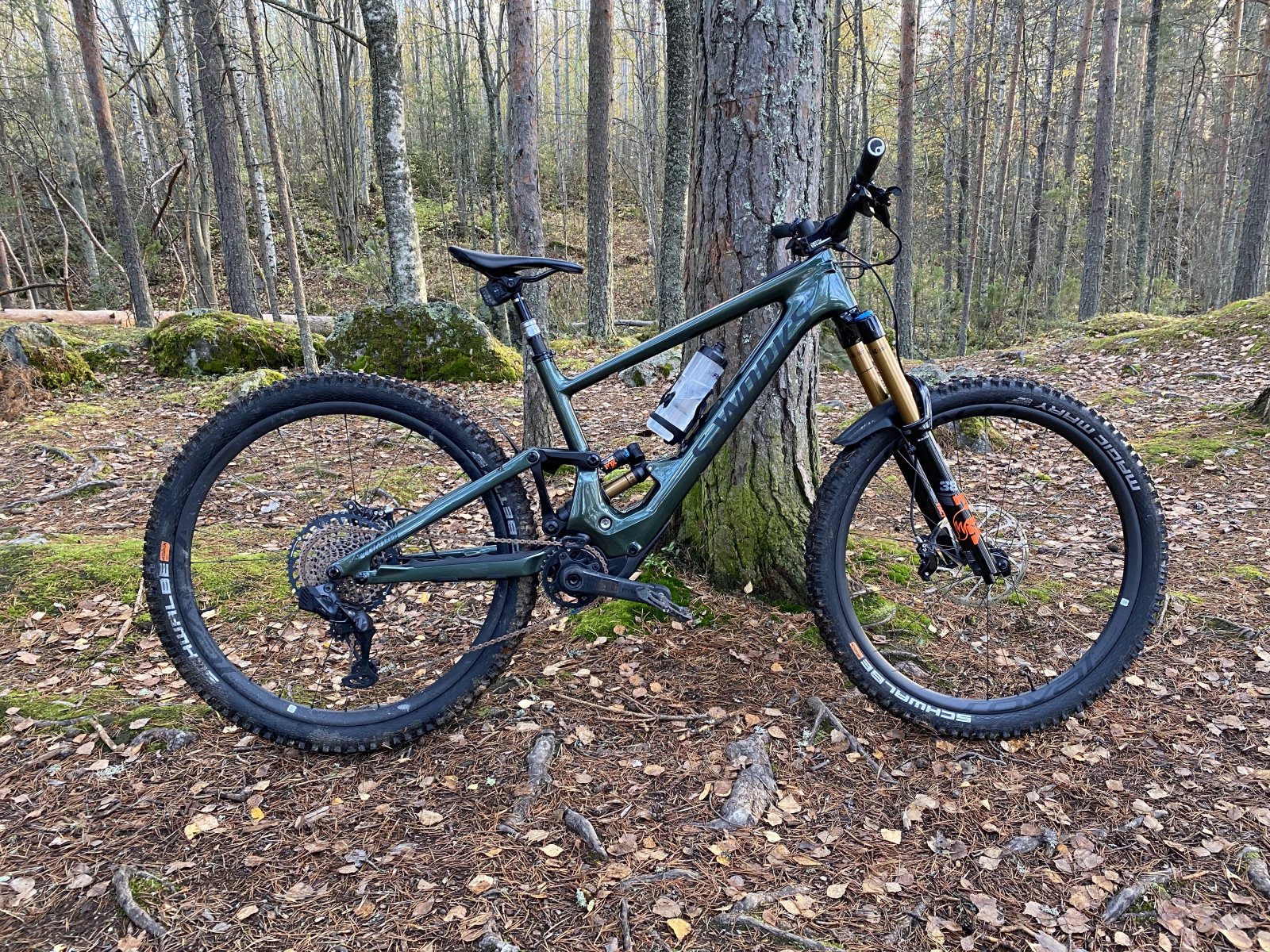

I have now done couple rides with KSL. In first ride everything was a little bit wrong. Too much air in the fork, tool little in the shock, handlebar was too high and even seat tilt was wrong. Those axs at least worked nicely and the motor was as nice as I expected. I almost had buyers remorse. :):).
For second ride I lowered the handlebar and adjust the air pressures in the fork and shock and ride was much better. Tires were gripping nicely and the fork and shock seemed to work quite well. I still got some wrist pain. I will change the grips first and if that one doesn't help I'll swap handlebar to Renthal Fatbar.
Maybe after couple of additional rides and some tweaking I can say that it is the best bike ever😀😀

When you raise the bar, when you adjust your seat forward, those both shorten the reach. Check also after adjustment your brake lever position.

Here is my bike. I changed the grips and now the wrist pain is gone. I also added a little bit low speed rebound to both fork and shock and it calmed bike down. It gets better in every ride :) :)

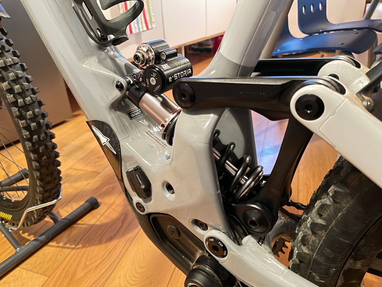

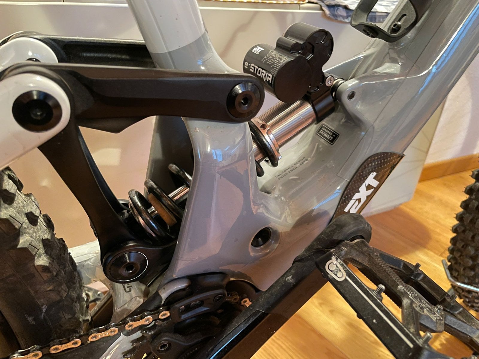

oh man we are going to need ride impressions ASAP. That’s the first e storia I have seen in the wild. What spring length did they give you as it looks fairly short?
Also did you go for 62.5mm or 65mm stroke?
The spring is the original EXT and the lenght is choose from Ext calculated on my weight and characteristics.
My EXT is 230x62.5
Here unboxing and mounting:
