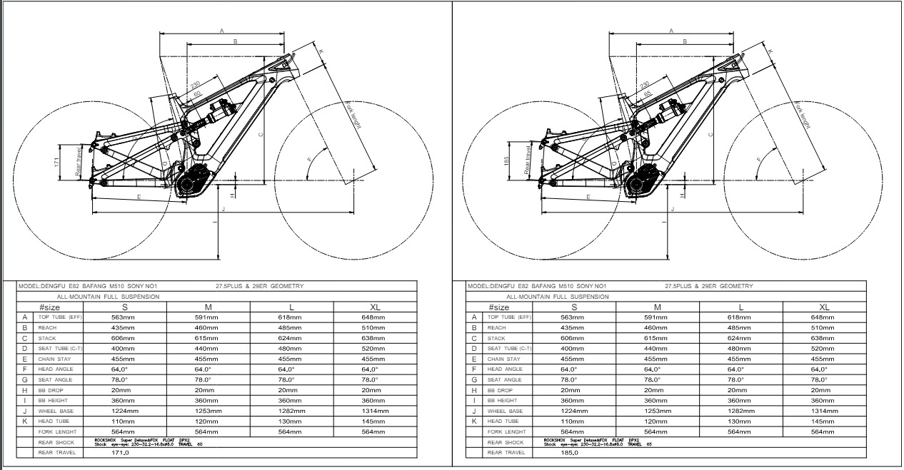

More chat with DengFu today and I discovered that this frame also accept a 230x65mm rear shock, thus reaching 185 mm of travel as per attached geo chart; interesting if building it as a big enduro/ freeride bike when paired to a 180mm fork IMHO.
Another important aspect is that they're now providing E82 frames with a conventional internal cable routing instead of the ICR. View attachment 142673
This is a very interesting frame, but the geo chart is weird. 185mm travel would be nice for a full enduro with 180-190mm fork. According to geo chart axle to crown is 564mm, that is a 150mm travel fork. Even with less travel shock(60mm) that is not enough.
Of course you can just put a longer fork but that would mess up the geo. It is not very confidence inspiring when manufacturers cannot even get the geo chart right!
Yeah, I've noted it...pretty common with chinese manufacturers.
By the way, I'll try to clarify that A/C length and geo chart numbers with DengFu; it sounds a bit strange to me that they "put" a 150mm fork with a 170mm rear travel.
I think 180 fork and 170 rear travel should be enough, even for the gnarliest trail surrounding me; clearance under the motor seems good too

After some more chat with DengFu, this is what they told me...with a short stroke rear shock of 210x50mm (they call it "E-Suv") configuration, they recommend a 150mm fork.
With 230x60 the reported A/C length is 590mm, that means a 180mm fork, way more appropriate.
I think there's at least a typo in the long stroke geo chart; by the way they said that it will be updated after the new frames will be finished.

interesting to know BB height (and wheels size) with all of these configurations ? Performed with exactly same frame assembly (links ? flip chip ? base ?) ?
From what I know, DengFu have 3 different yokes, I imagine that a customer could ask them to swap it.
When I'll build mine E82, I'll post measurements; at the moment my plan is a mullet/MX, 170/180 fork and 185 rear stroke, but this could change in the next weeks, as I don't have any components yet and I need a Large size.

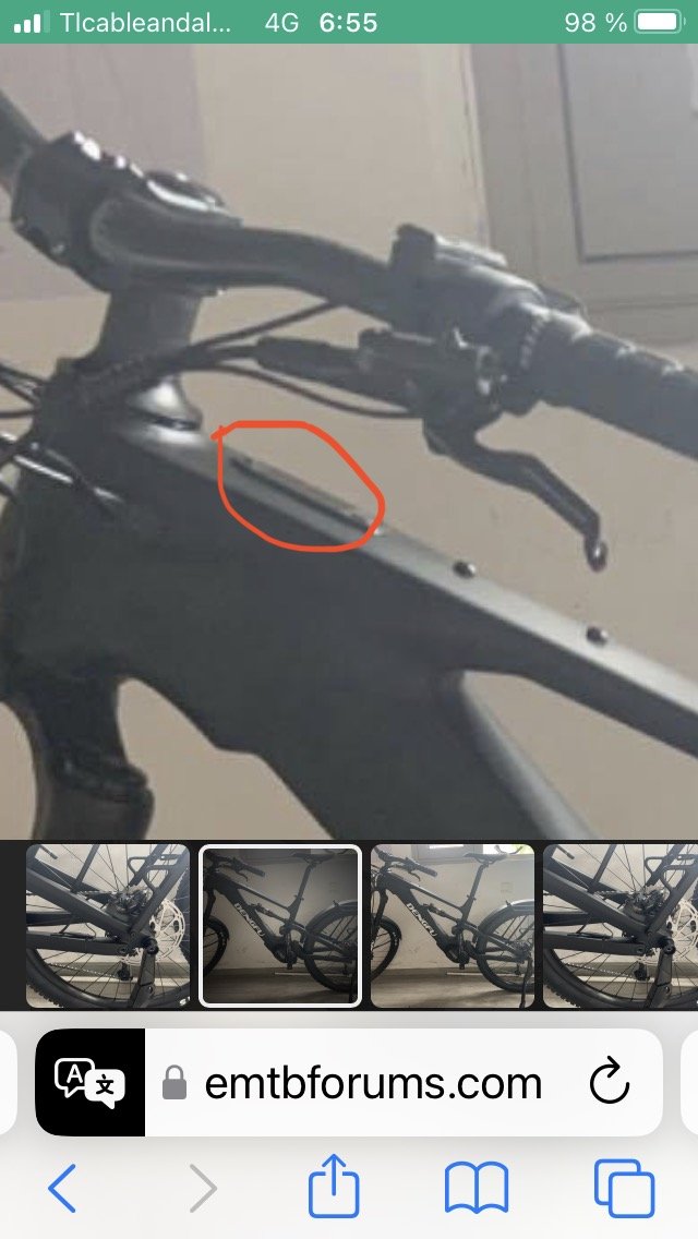

My other concern is the headtube cable routing. I'm aware alessio77 posted on the 24th of June that Dengfu was offering a solution with normal internal routing. I've contacted Dengfu regarding this and I was sent this picture to show what that would look like. I do prefer the look of the headtube routing although I'd rather avoid issues. I am not concerned with the servicing aspect. I'm wondering is the redesign of the headset solved the problem satisfactorily?

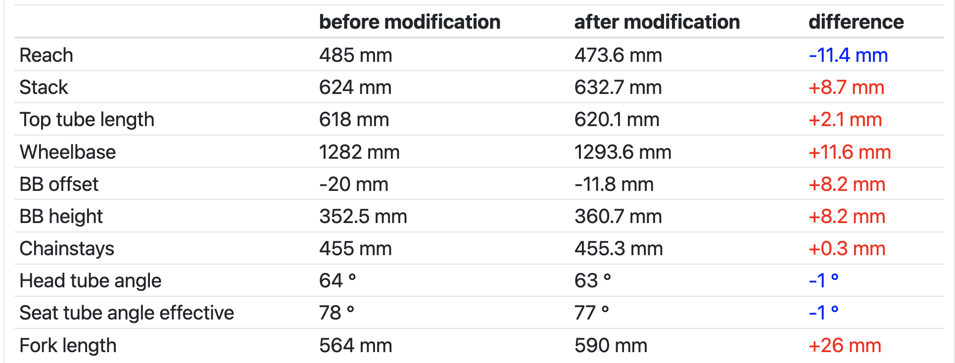

Ok, I noticed the same. I chatted with dengfu, and they told me there are two version of frame ( SUV and PRO), BUT the frame is the same, only rear shock and shock yoke are different. Travel goes from 150mm (210x50mm) to even 190mm (with 230x65). BUT fork lenght stays the same 564mm. They told me that in the PRO you go with 590mm fork, but it changes geometry like in my photo.. (BB drop only -12mm, and steeper HT angle, also shorter reach etc).
It would be perfect if any manufacturer make a frame with 170mm or more rear travel but design it for the longer fork from the beginning. You cannot simply put longer fork and call it PRO.
