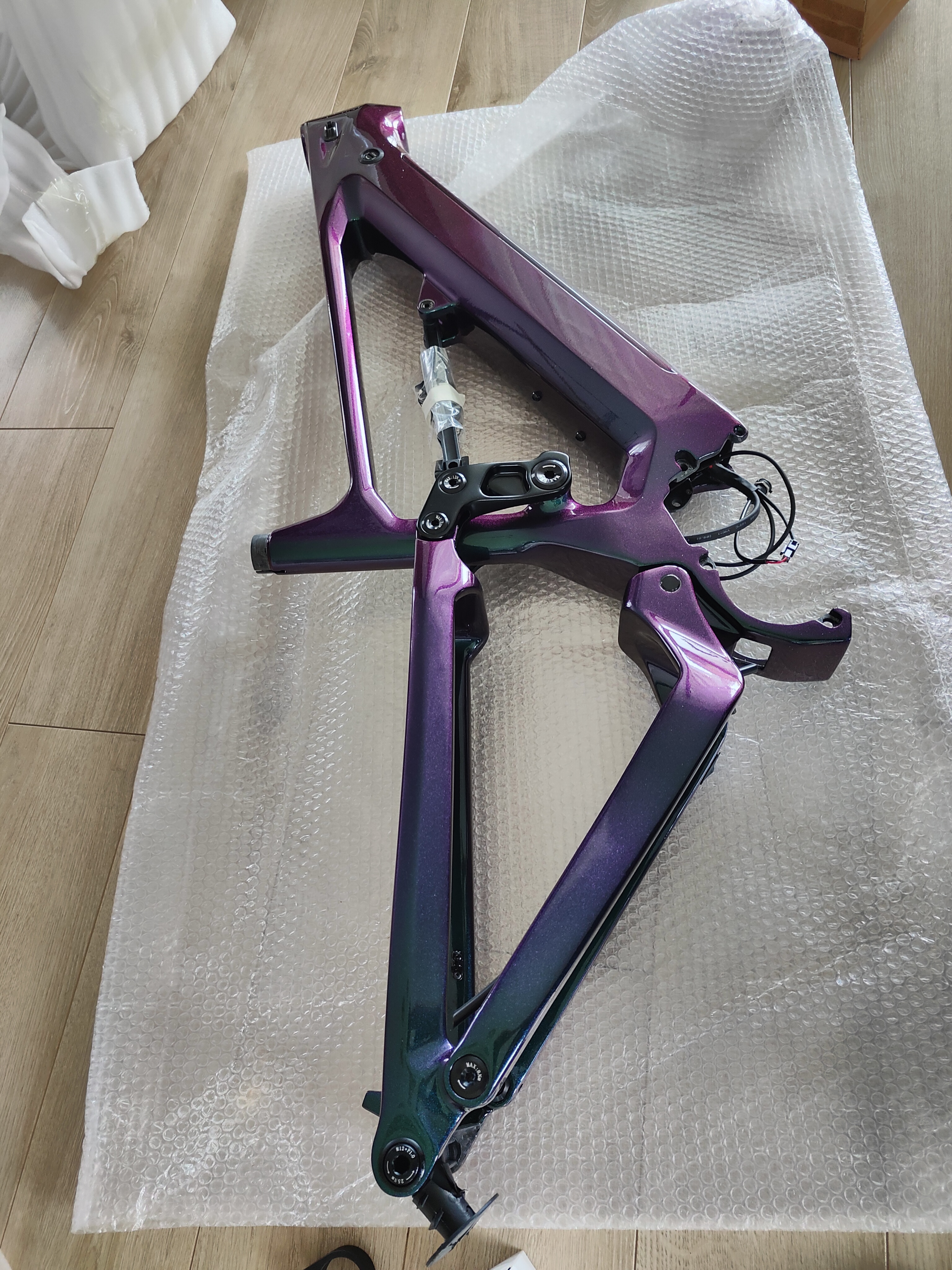

I've received second frame from Dengfu. When I first ordered the frame came in pieces, now it came assembled.
In addition, I have now received rear shock bushings.
It looks like they painted your battery to match the frame, is that anything special you need to ask for? My battery is in the mail but I just assumed they didn’t paint it because it shipped only a few days after my order and separate from the frame.

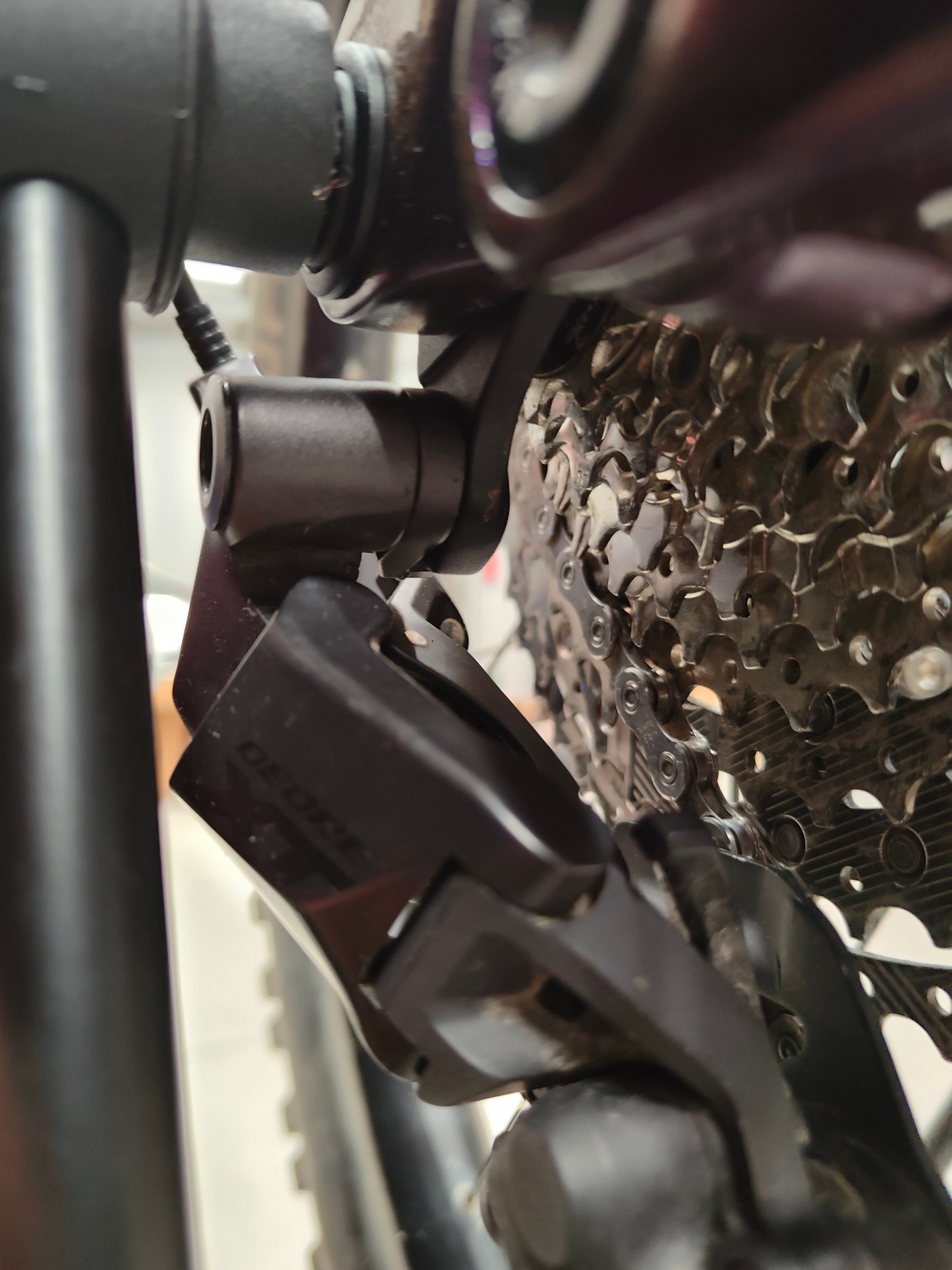

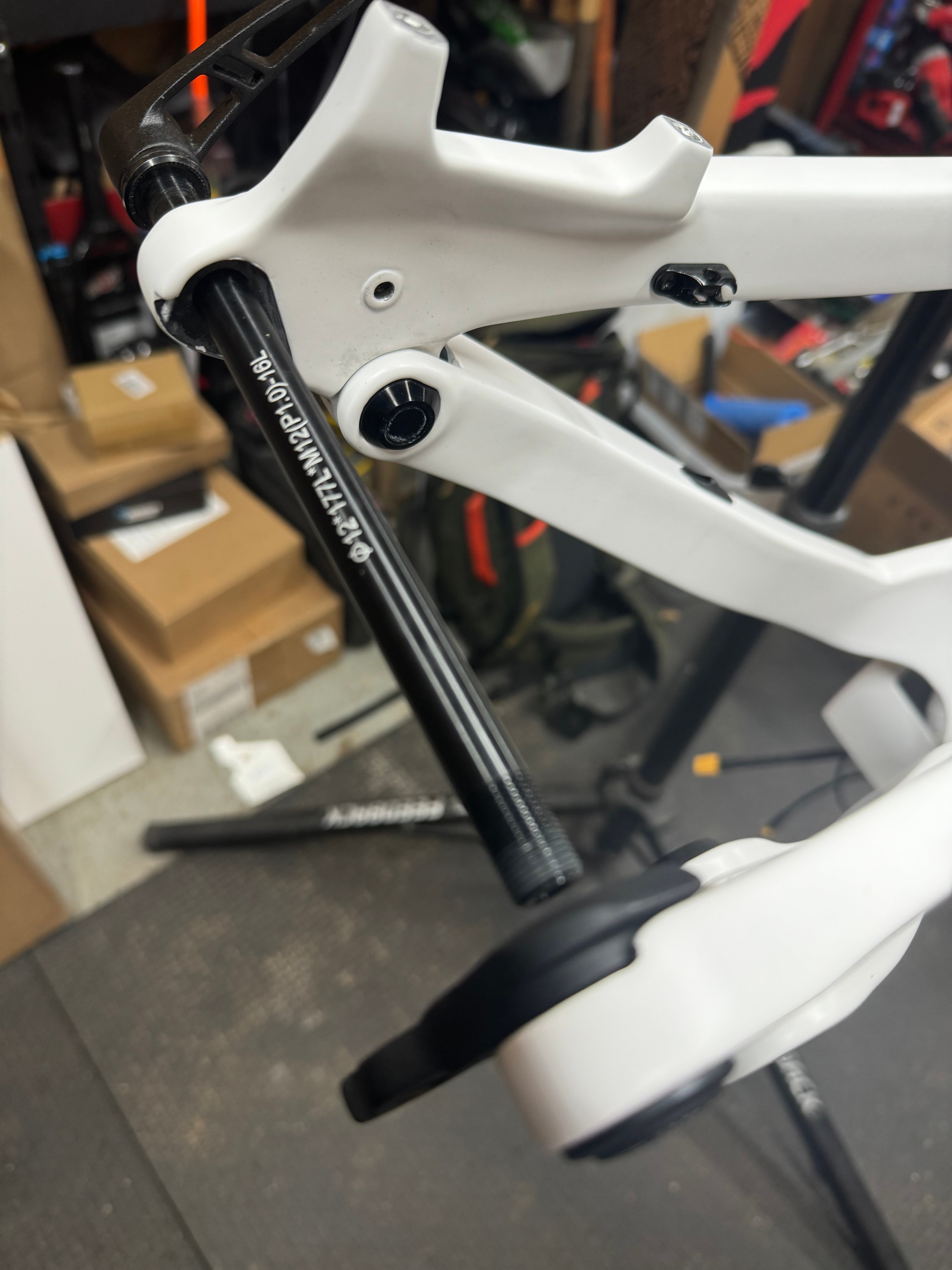

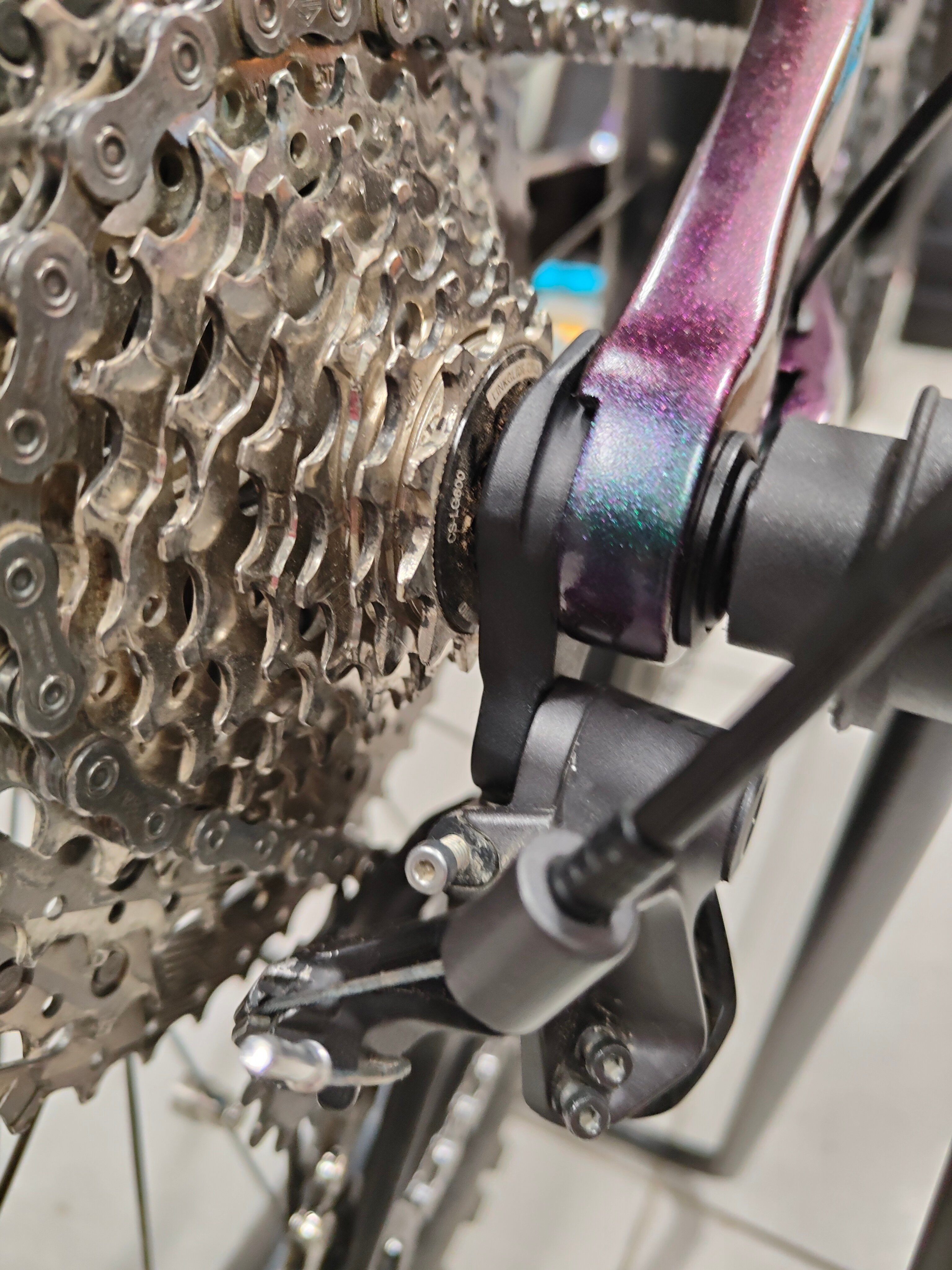

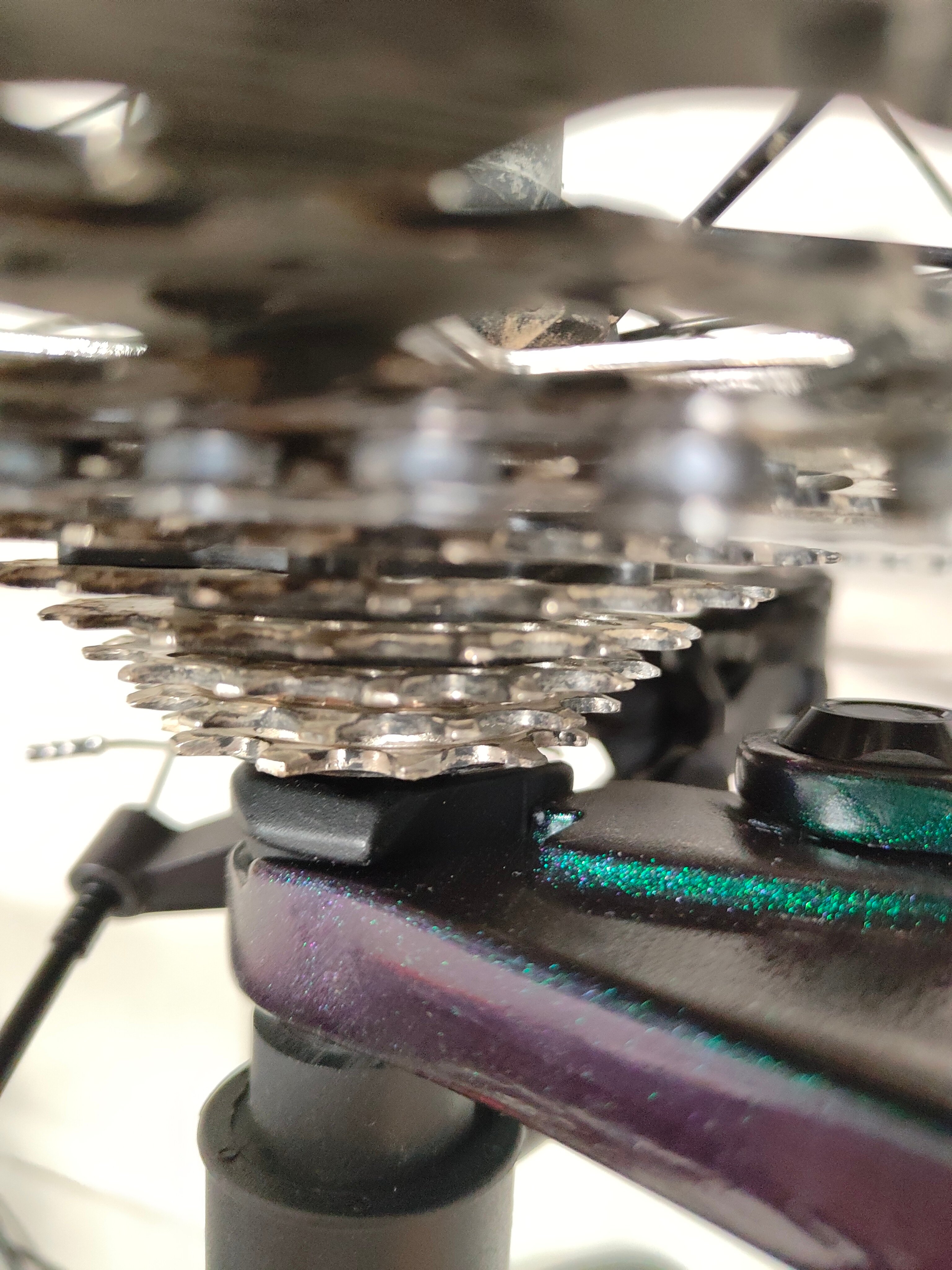

I just got my E82 in and am not understanding the rear triangle UDH compatibility... I thought the t-type transmissions were supposed to be compatible with anything that was UDH and Dengfu advertises this frame as being UDH compatible, yet there is seemingly no way my derailleur could mount to this frame... The bushing is a totally different size than the hole in the rear triangle, and the thickness seems off too. What am I missing here?
_gregor
Mar 16, 2024
68
91
Poland
xtraman122
Mar 2, 2024
273
214
This is not a SRAM t-type, they mount quite differently, removing the hanger completely and having the TA go right through them. They are supposed to be compatible with any UDH frame though.
After a lot of back and forth with the Dengfu rep at the conclusion of which we agreed to disagree, I have a UDH rear triangle now on the way. I never knew this frame was offered in anything but UDH, but apparently you can order it either way.

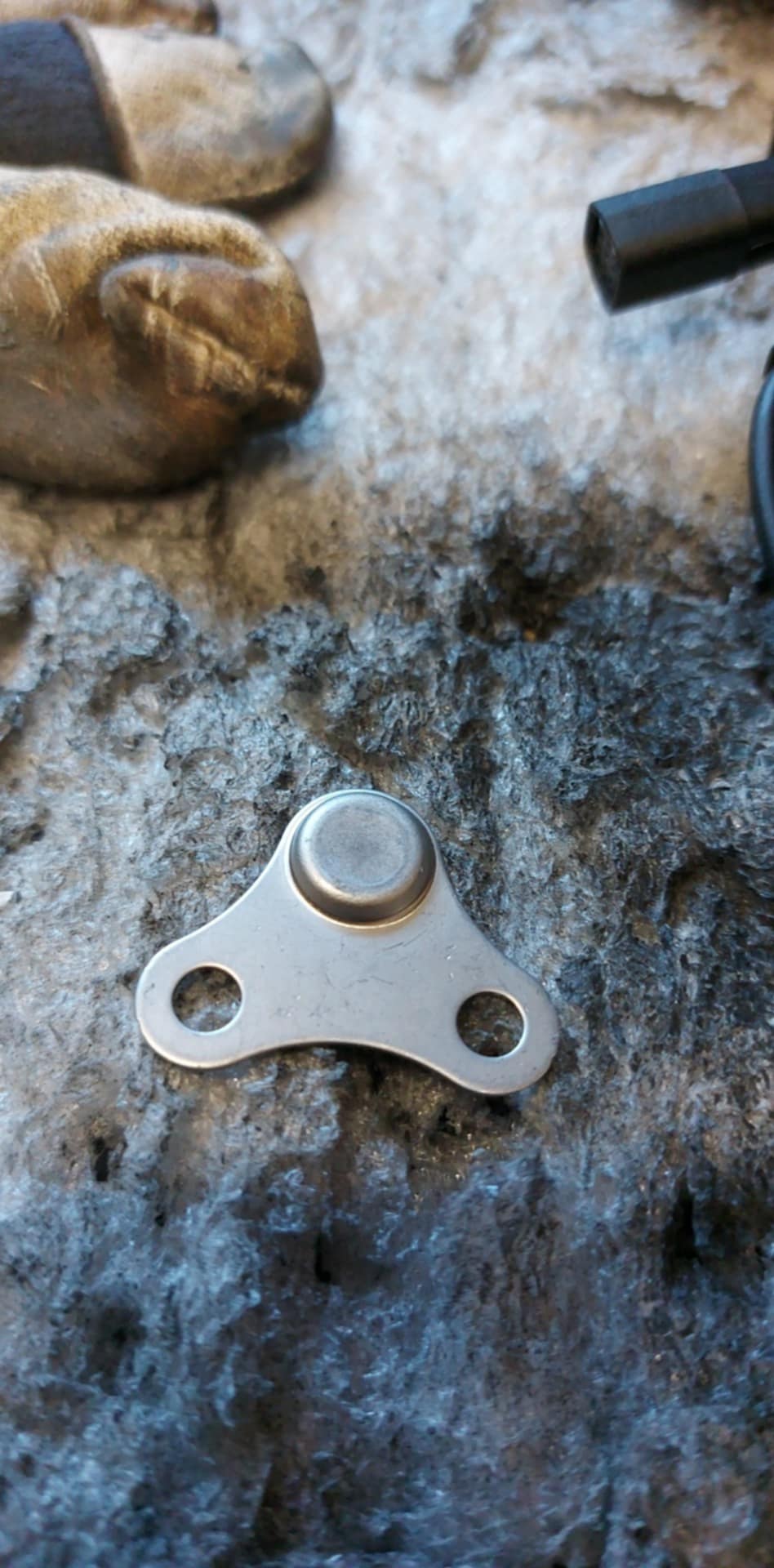

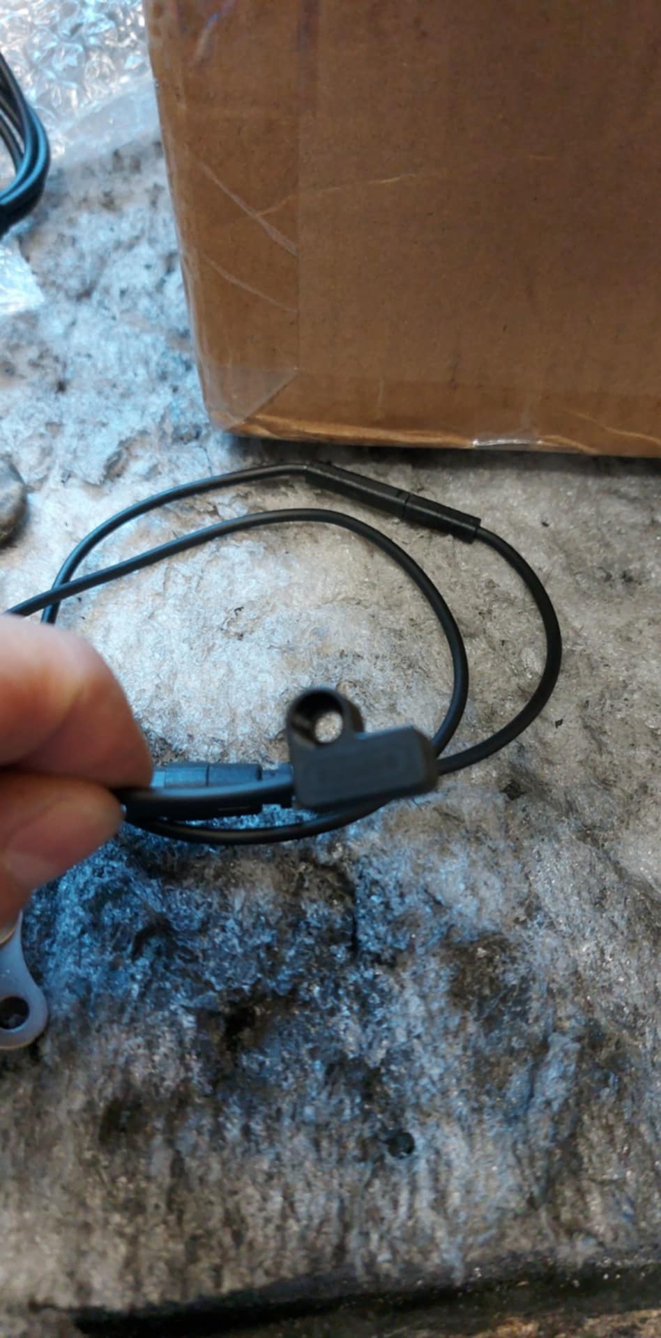

@_gregor I saw you had used the more traditional speed sensor setup, do you know where to even get the rotor style one from? I was hoping Dengfu would have included it, but no such luck.
Sorry, but I don't know. I think Shimano has rotors with magnet but you also need special speed sensor.

Yeah the sensor is what I’m struggling to find, I wonder if Bafang discontinued it or something, none of the usual places show it for sale at all. Can’t even find a part number.

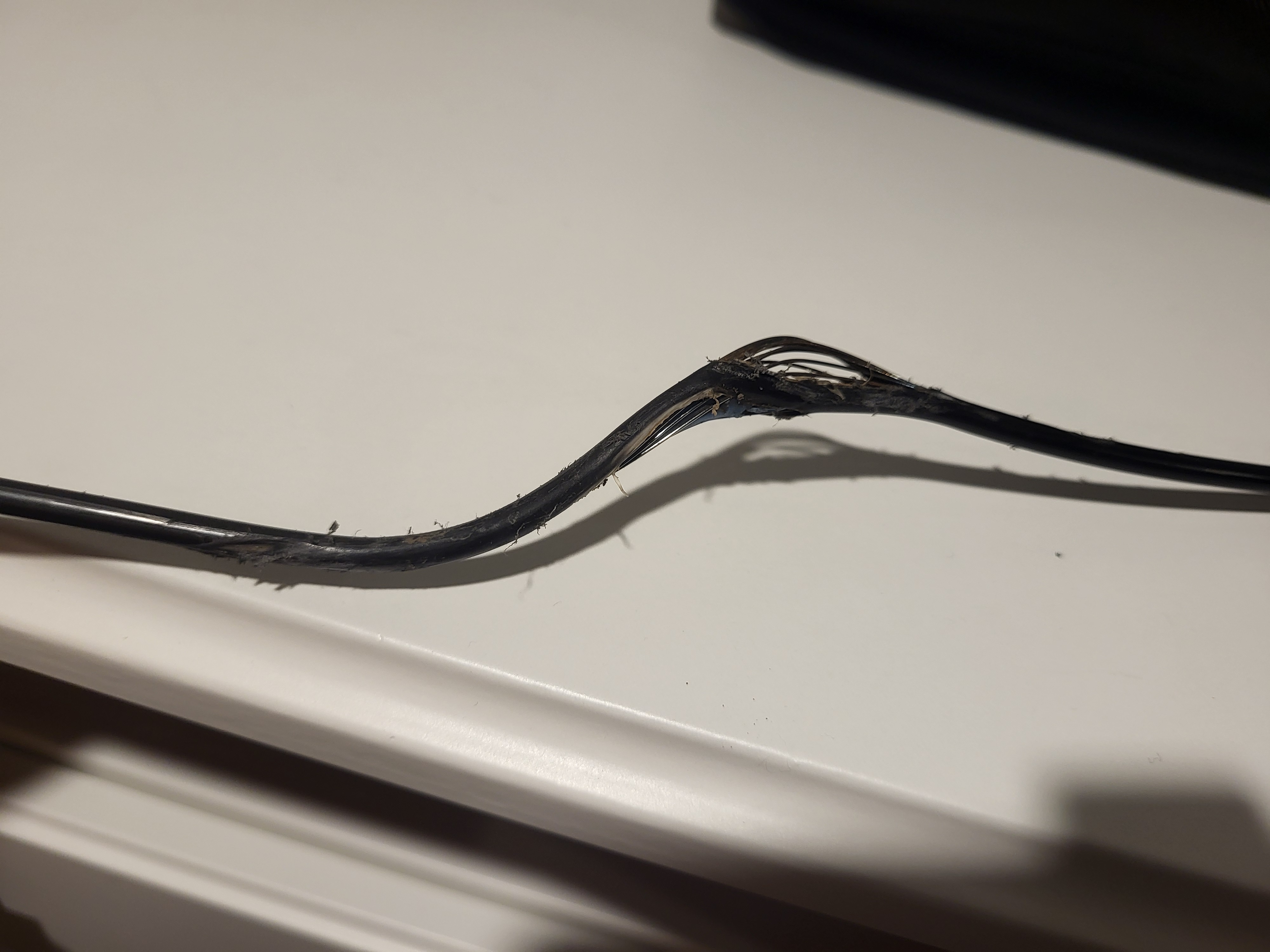

I had a problem with my LCE971 rear triangle recently. Little bit over a month ago I did some work on the routing and noticed the gear shift cable housing had a slight damage. It was quite small so I didn't think much of it.
However... I recently chose to upgrade to Shimano XT linkglide (from Microshift Advent 9-speed). The Microshift is truly earned their name as extremely durable. The rear derailleur took few massive hits and got pulled into the cassette twice. After these hits to the derailleur I was still able to ride the bike home instead of having to carry it. It even shifted some of the gears! My friend who was with me then said that if that happened to his gx there was no way it would have worked again. I rode the microshift months but this last damage to it was too much and couldn't be repaired. Got a great deal on XT linkglide (cassette, derailleur, chain, shifter) and chose to upgrade to it.
When I was doing the switch I wanted to check on the cable housing and this time it was in horrible condition. The damaged cable housing was in the front part of the rear triangle.
I contacted Jim about it and let him know I will be taking a look inside when I will get hands on a borescope. The inside was really nice looking and smooth except were the cable damage was located. There were some defects from manifacturing process. I took photos of that and sent them to Jim.
After 8 hours ( guess the work time in China) I received a message from Jim saying they will make a new rear triangle for me. Though it will take some time since they are still working on the new version. For now I will route the cable outside the rear triangle so the bike will remain usable while I wait for the new rear triangle to be done and shipped. Lightcarbon proving once again that they are a serious brand and they stand behind their product.

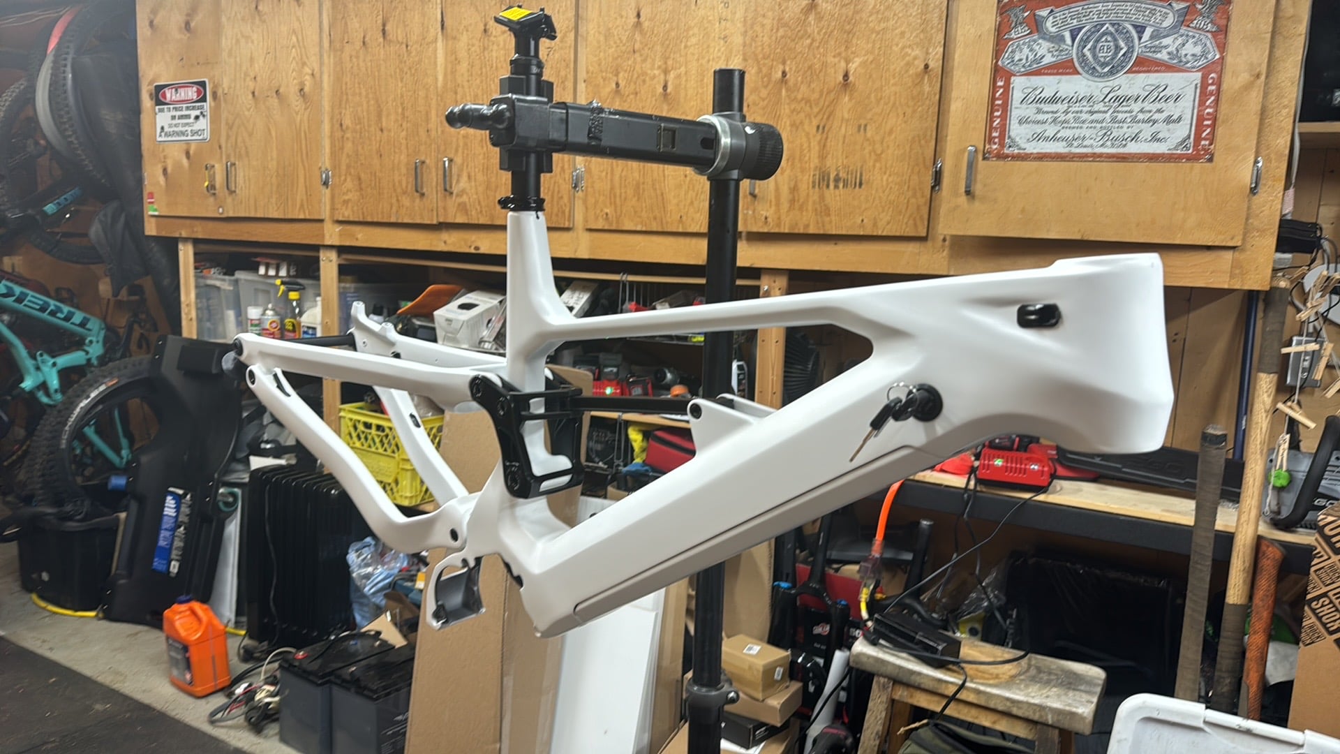

Fresh off the truck. Now the tricky part.
Appears to be as described with UDH, Headtube cable routing. Few bits to amass yet and the battery is close behind.
Frame weight with cables and battery hardware was as mentioned in another post. ~4.1kgs

Looks good, is that the matte finish? Wish I didn't let them talk me out of matte. Did you have to specify you wanted UDH? I had quite the disaster with that....
That’s right, the matte white. I couldn’t decide on a more creative colour so this will work.
I simply ordered off their webpage. I did make sure via email that they were sending what was described.
